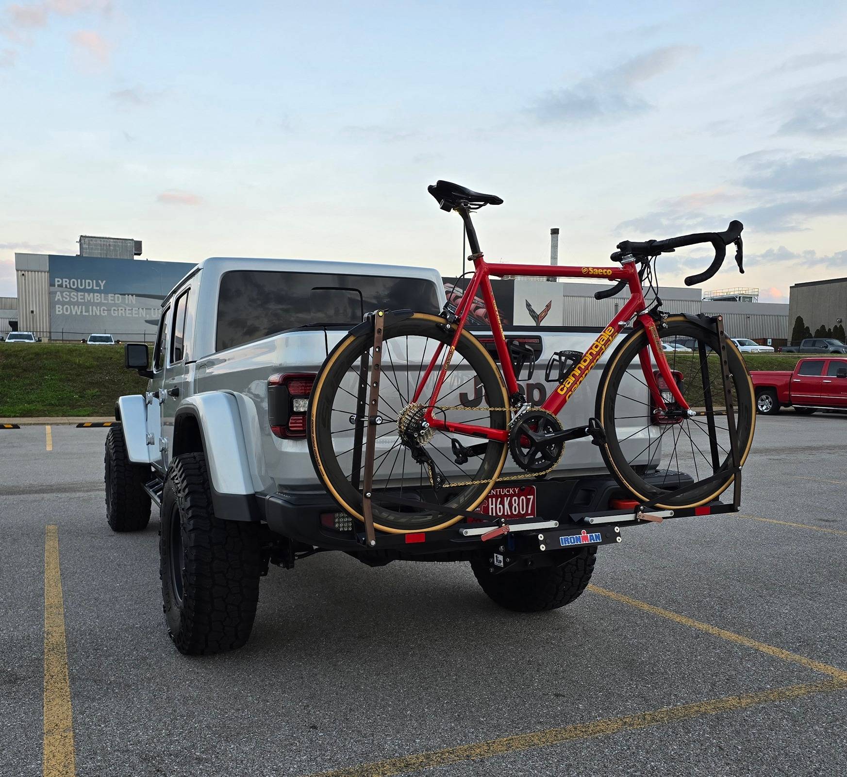

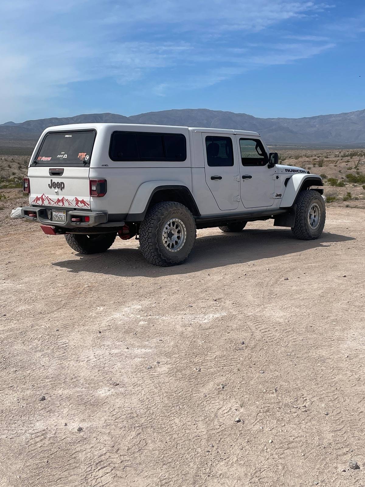

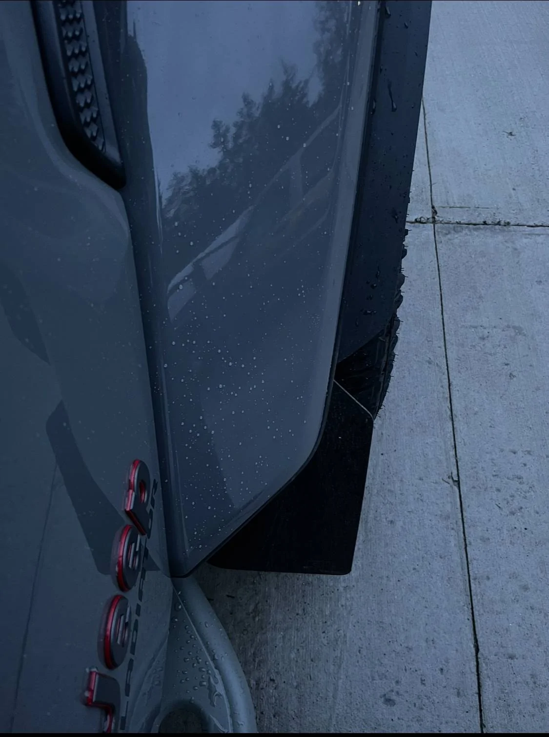

The 0 offset Methods is what you want. I have them with 37s and 2 inch Mopar lift. No rub at full stuff and lock to lock.

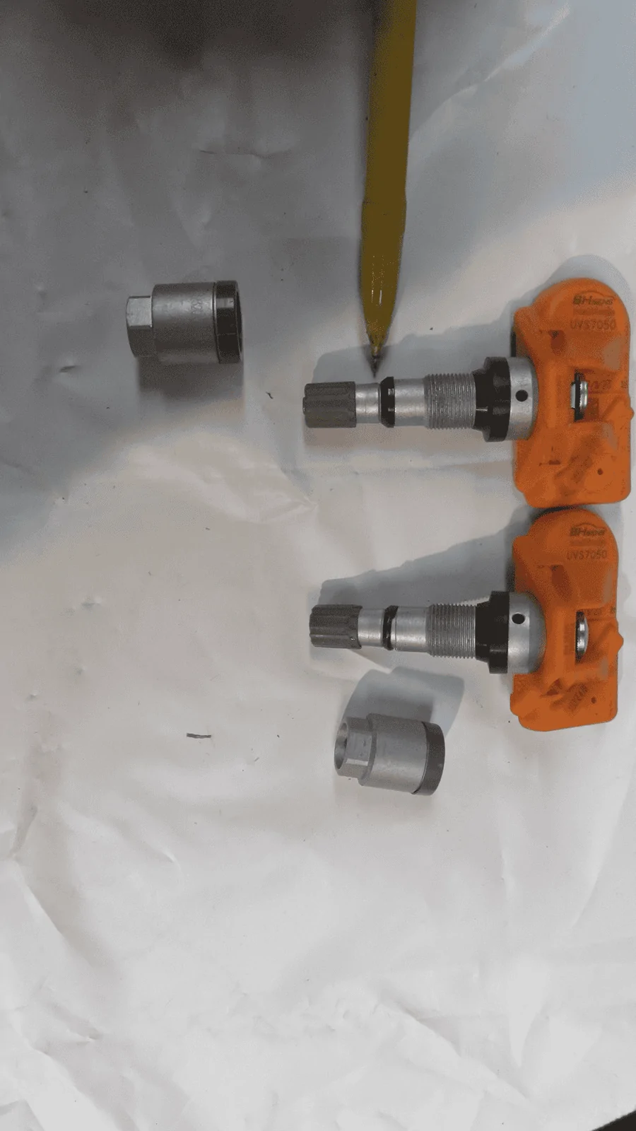

Now this really gets me by the balls. Tried fitting the new TPMS in the new rim. It don't fit. It won't tighten up. Screwed the barrel nut down and it bottoms out on a shoulder. Leaving about an 1/8" gap. So it's loose, flopping around. :facepalm::mad:
Measured the TPMS. it's .250" between the seats. The rim thickness at the hole is .169". So there is a .081" difference. :facepalm:

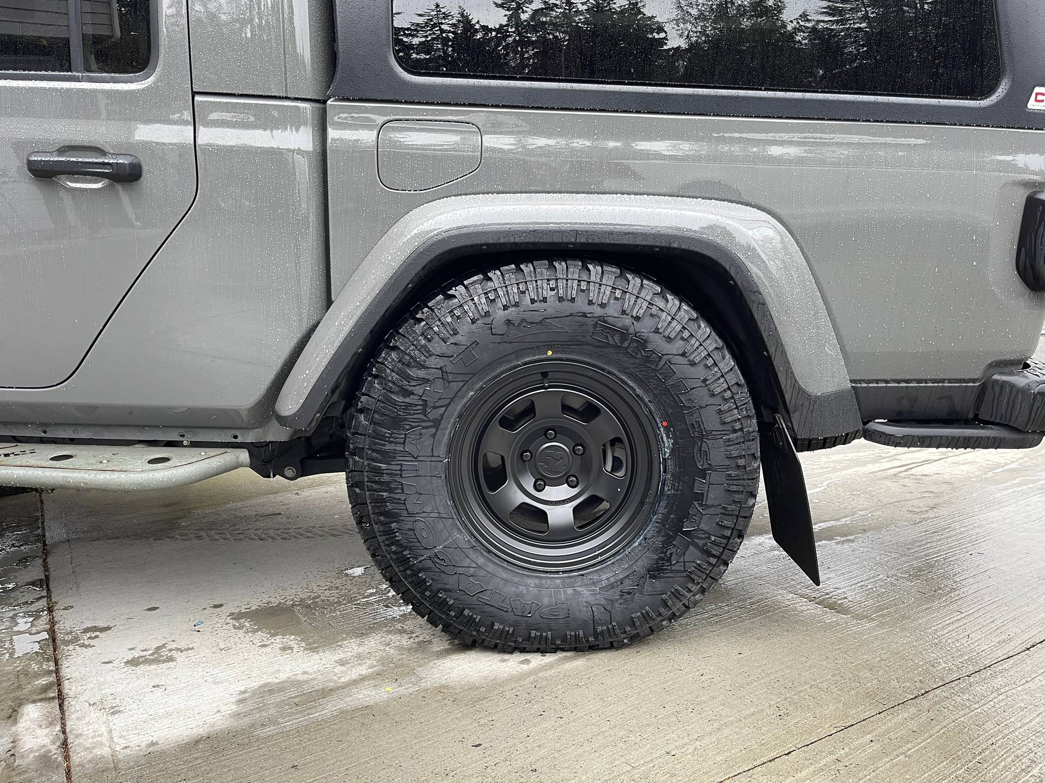

I'm rocking the Pro Comp 97 Crawlers with 4.25BS, they weigh 32 lbs each. On 37x12.50R17 Falken AT4W HDs that are 78 lbs a piece. So in total about 110lbs a tire for HD 37s on steelies. The stock Rubicon rims weigh 27 lbs... I'm not fussed over 5 lbs per wheel. These allow me to do trail repairs and they're dirt cheap, plus the old school look is awesome in my opinion!
I try to be as weight conscious as possible in areas it makes sense, all balances out in the end.

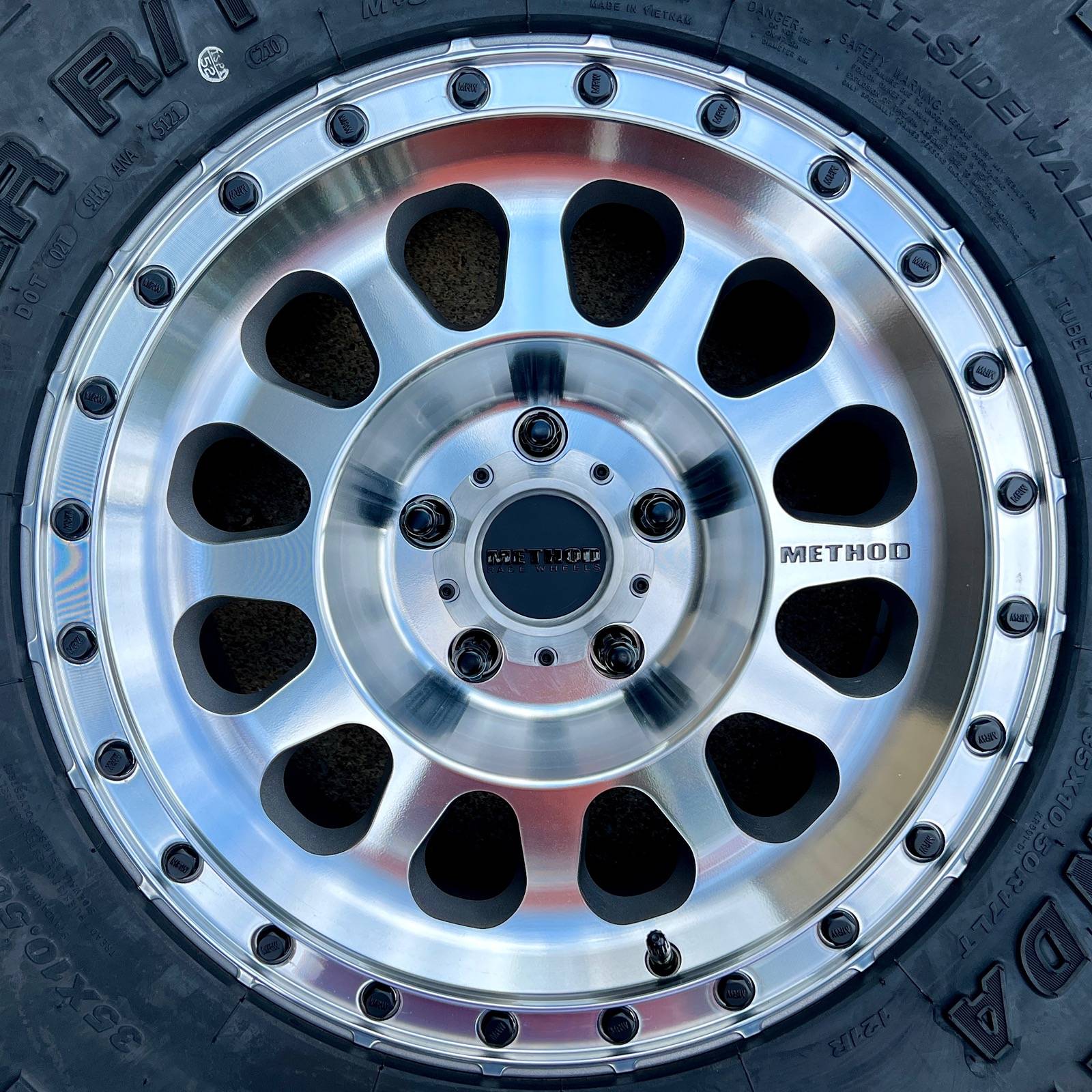

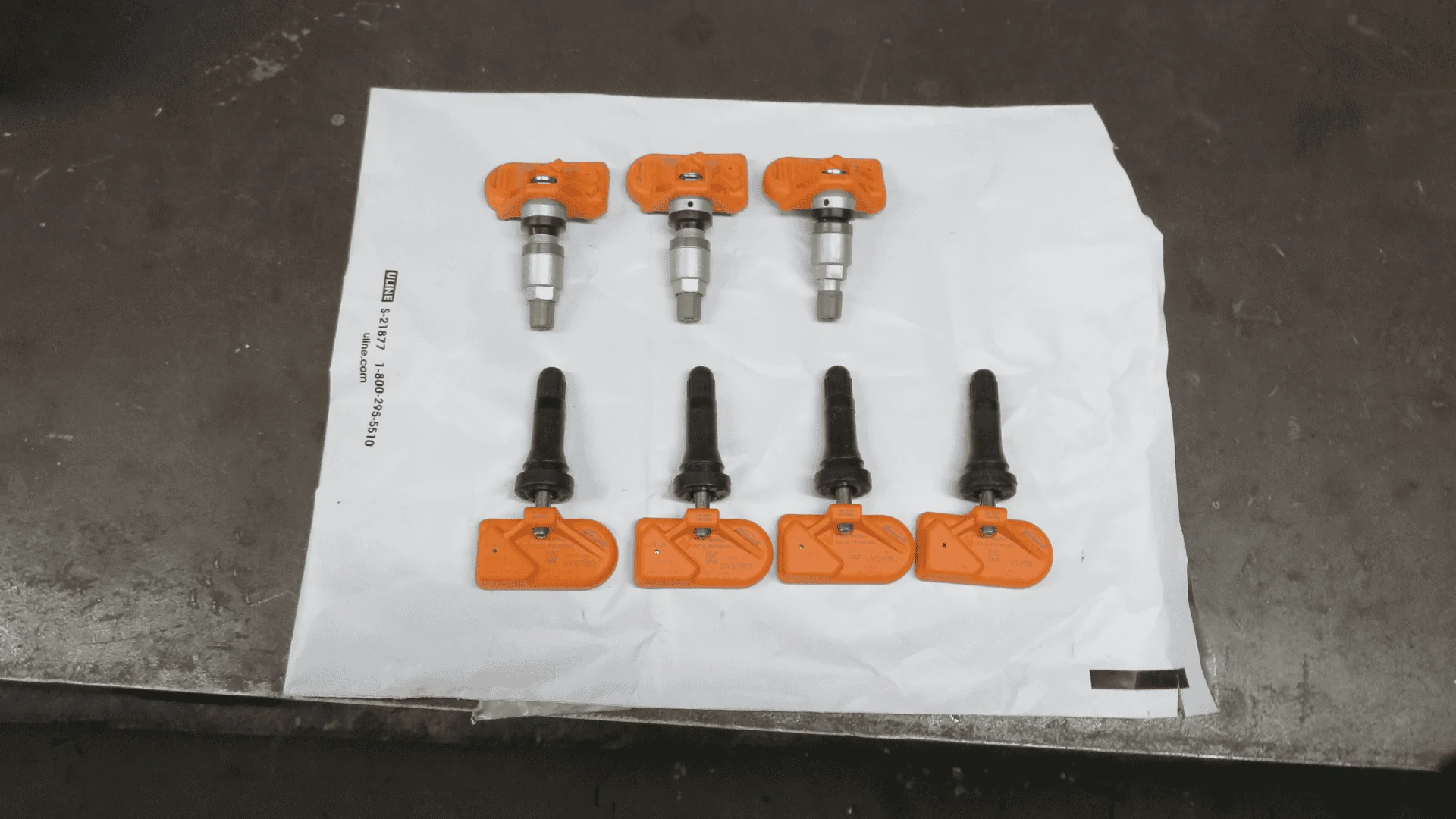

Could had the new rims installed by now. But thanks to FedX losing the lug nuts and TPMS sensors. I'm still in limbo. Called @Discount Tire . They were a big help. They sent out another order of lug nuts and sensors. The day I called. FedX delivered the first order at 5pm. Looked like the plastic bag was opened and resealed. Missing from it was 3 sensors and the socket for the spline drive lug nuts. The second order from @Discount Tire showed up the other day. It has a different style of TPMS senor. Got 4 of those, plus one of the other style. So I got 4 with the rubber valve stem, and 3 with the barrel nut.
Big thank you to Ty, Lynn, and a really big thank you to Joe @Discount Tire.
Bottom picture.
Couldn't figure out what was going on with the sensors with the barrel nut. Screw the nut down to tighten up in the rim. Seem like the nut was bottoming out on the shoulder where the black seal is sitting. Pencil pointing to it. The torque is only 35 in lbs on it. I ended up putting a bit more muscle into it. And got the nut over the black seal. That worked. But it was more than 35 in lbs. It seems that the seal is a one time deal. Once tighten up. It keeps the barrel nut from backing off. In the bottom picture. You can see the top sensor seal is untouched. The bottom sensor had the barrel nut removed. It don't look good.

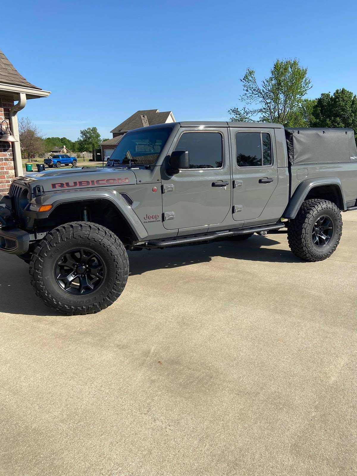

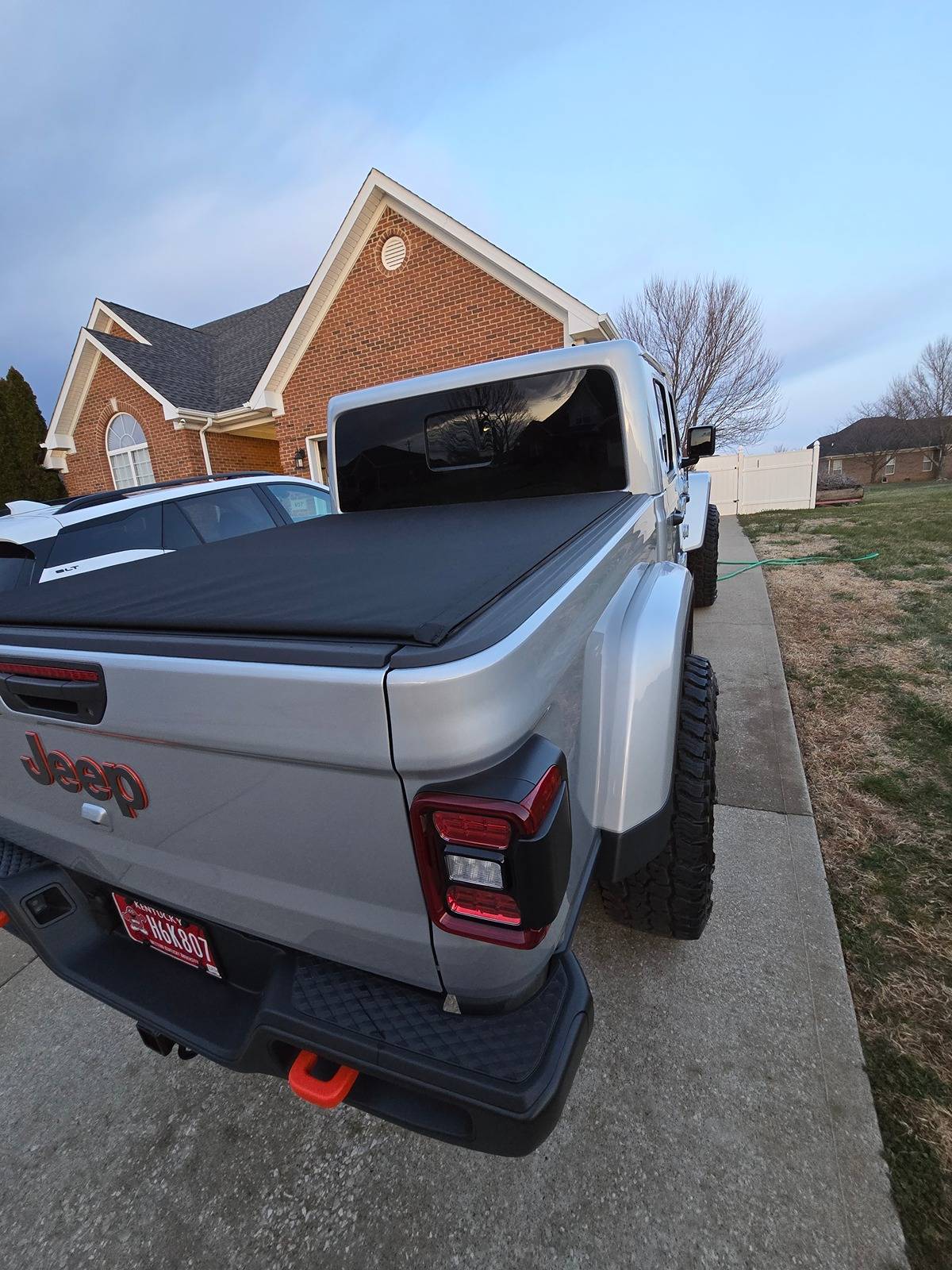

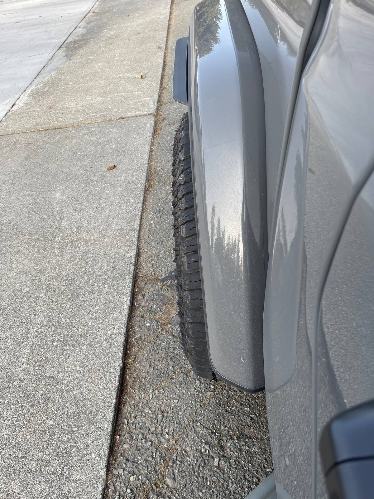

Jumping in late, but the Quadratec line is a great value and look great. I just switched from the Hardrock to the Morphic in black. 17x8.5, 5.2 bs. Pretty tucked in and keep the Jeep factory styling vibe. $220 a wheel before forum discounts. I’ve had them on two Jeeps.

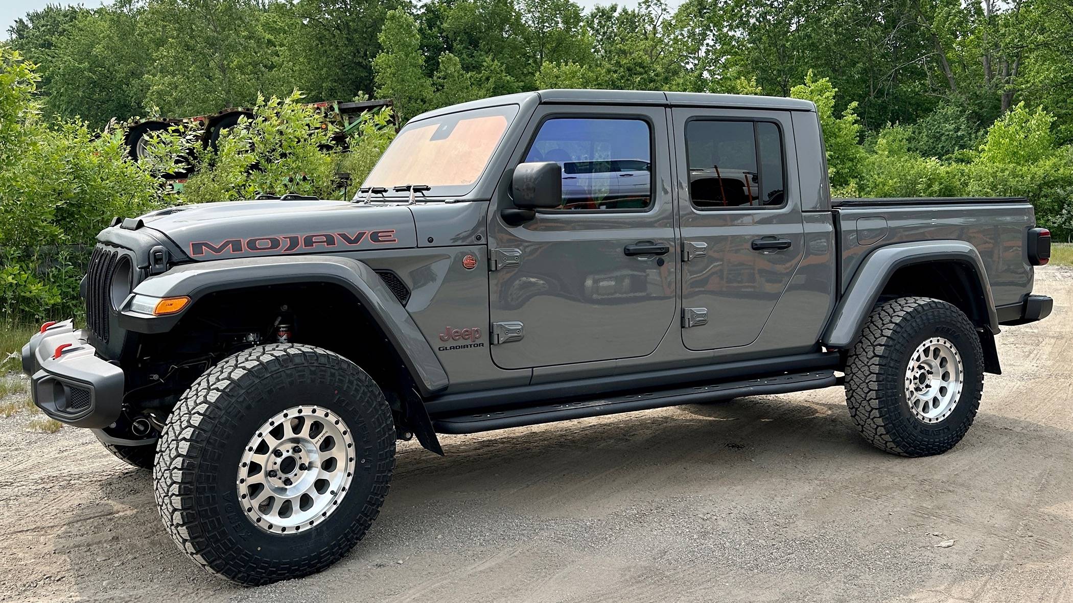

Plus one for the Method 315 machined.
17x8.5” 0 offset.
Method black lip replacement bolts.
Method black splined lug nuts.
Method brushed aluminum center caps.
I had bought my tire/wheel package online and ended up having to swap out their supplied TPMS for Mopar.
