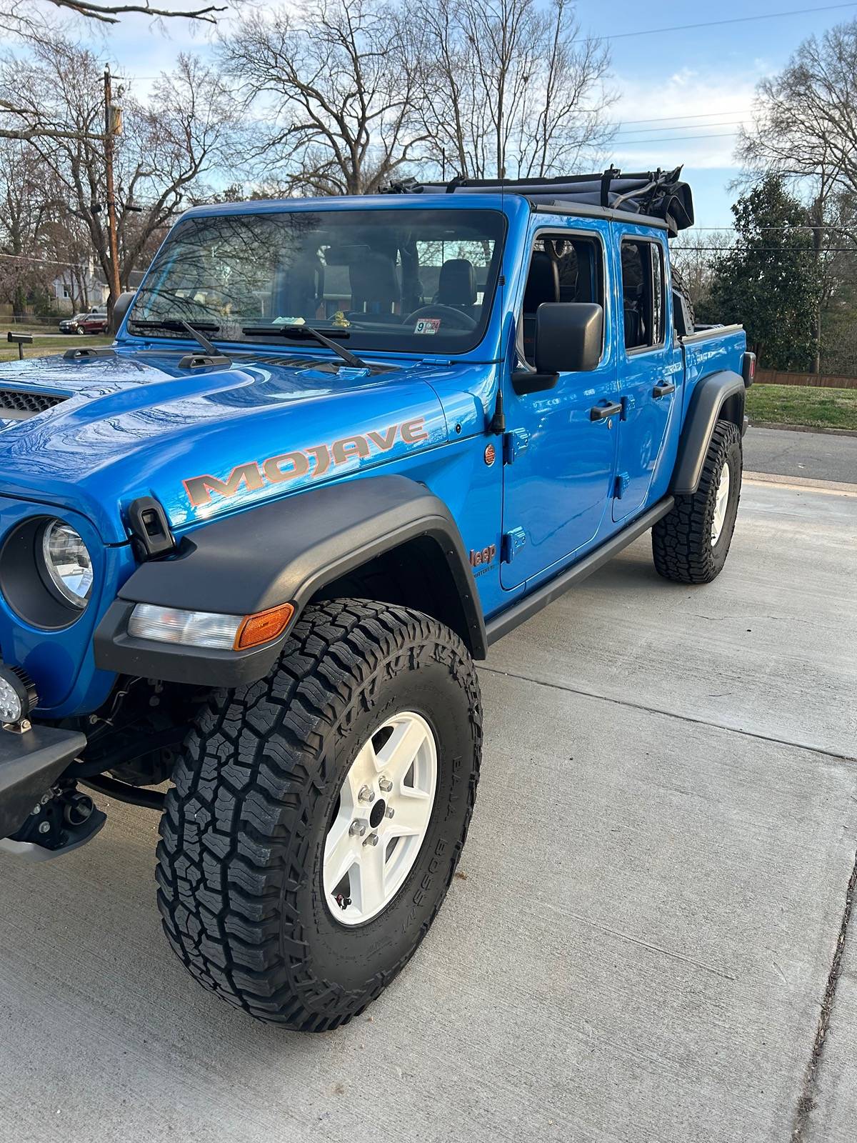

Do you have any pics of those MT's on your stock wheels, fitment, poke etc. ? I have the same tires ready to go, just need to decide on wheels.
Jeep Gladiator Deciding on rim specs IMG_2016
This is sport OE wheels. With a 1in spacer
I think this looks great, and the narrower rim helps with tire retention aired down…. I just never had any luck with good tire wear on setups like this. Usually wears out the center or I drop the pressure too much and end up having scalloping. ?
27 psi wears great. Drives a little wandery. I only use em for the trail tho. I run my 33s to daily

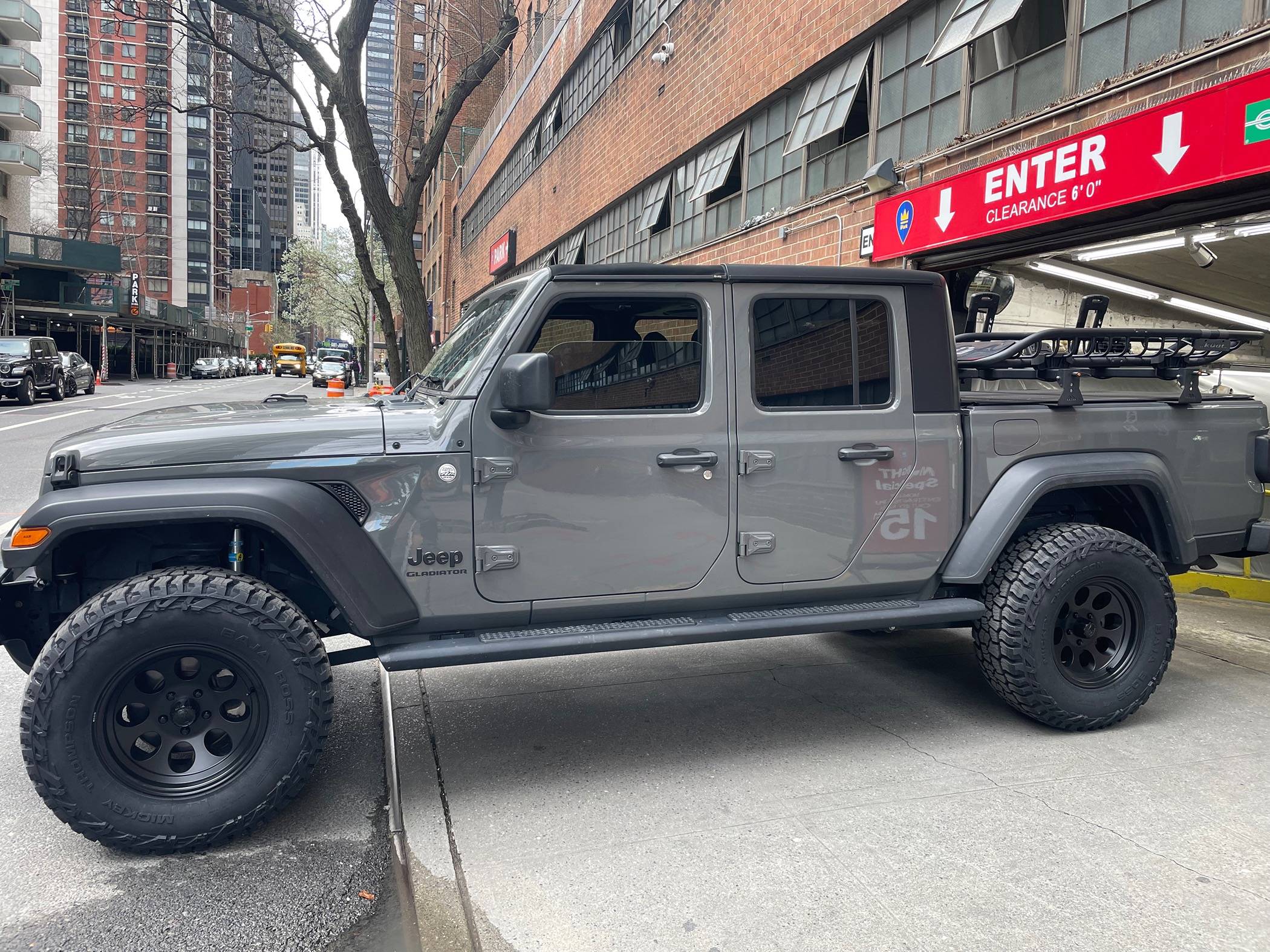

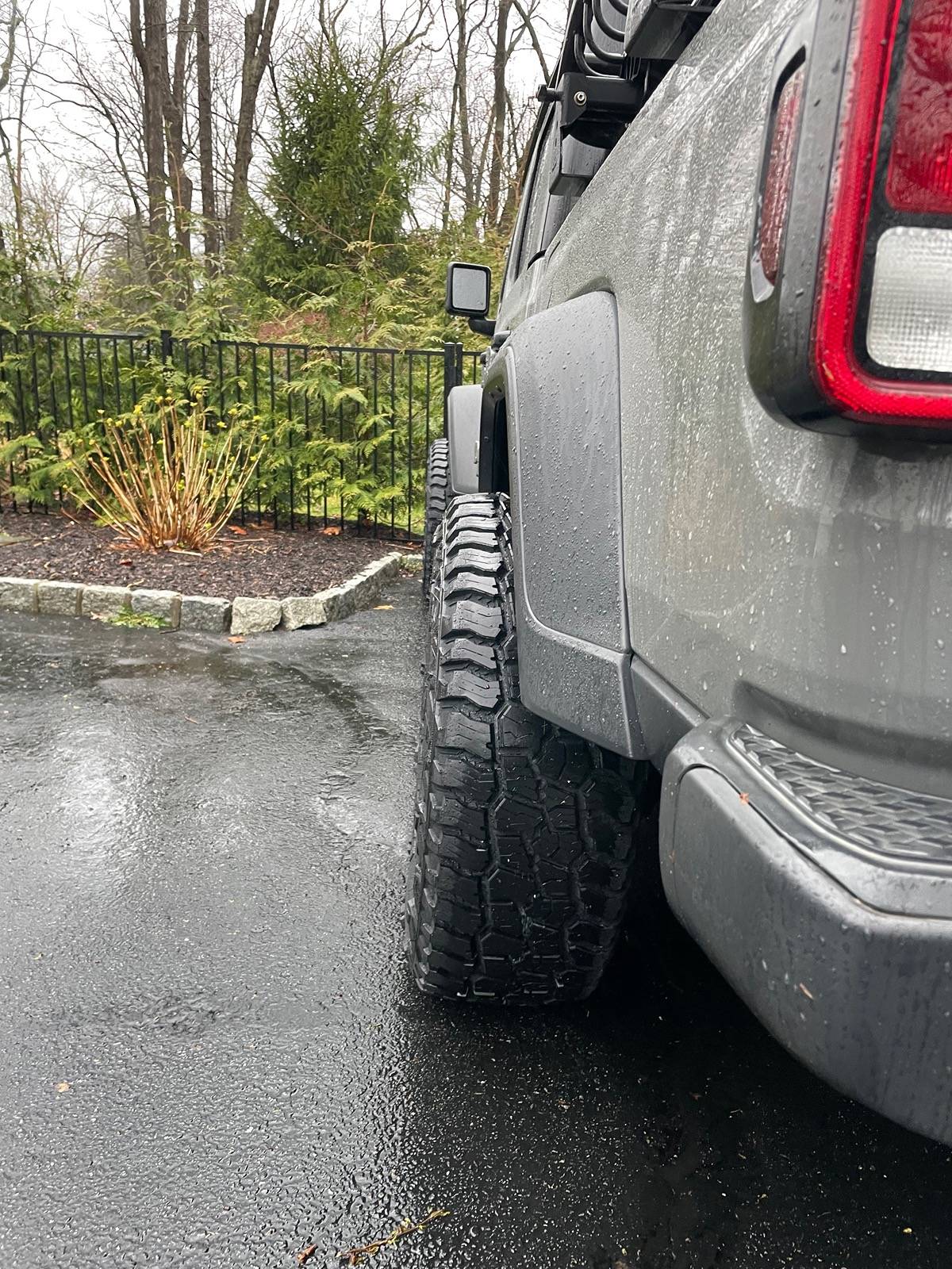

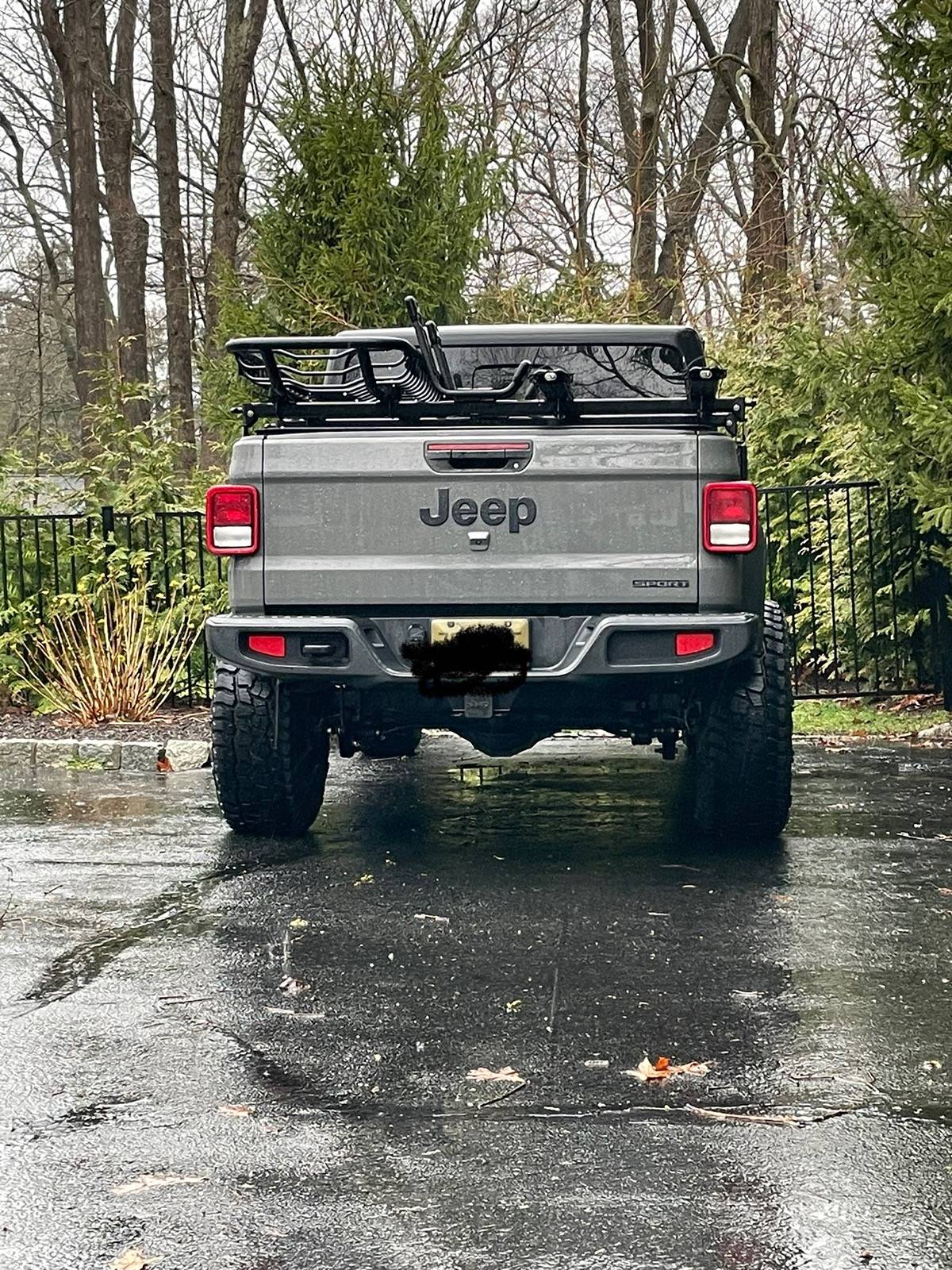

Rims are not as fancy as Methods but for sizing I have 17 x9 4.5backspacing -12offset
Mickey Thomson Baja Boss AT 35x12.5x17
I’m mostly on road and prefer the look of a little poke.
