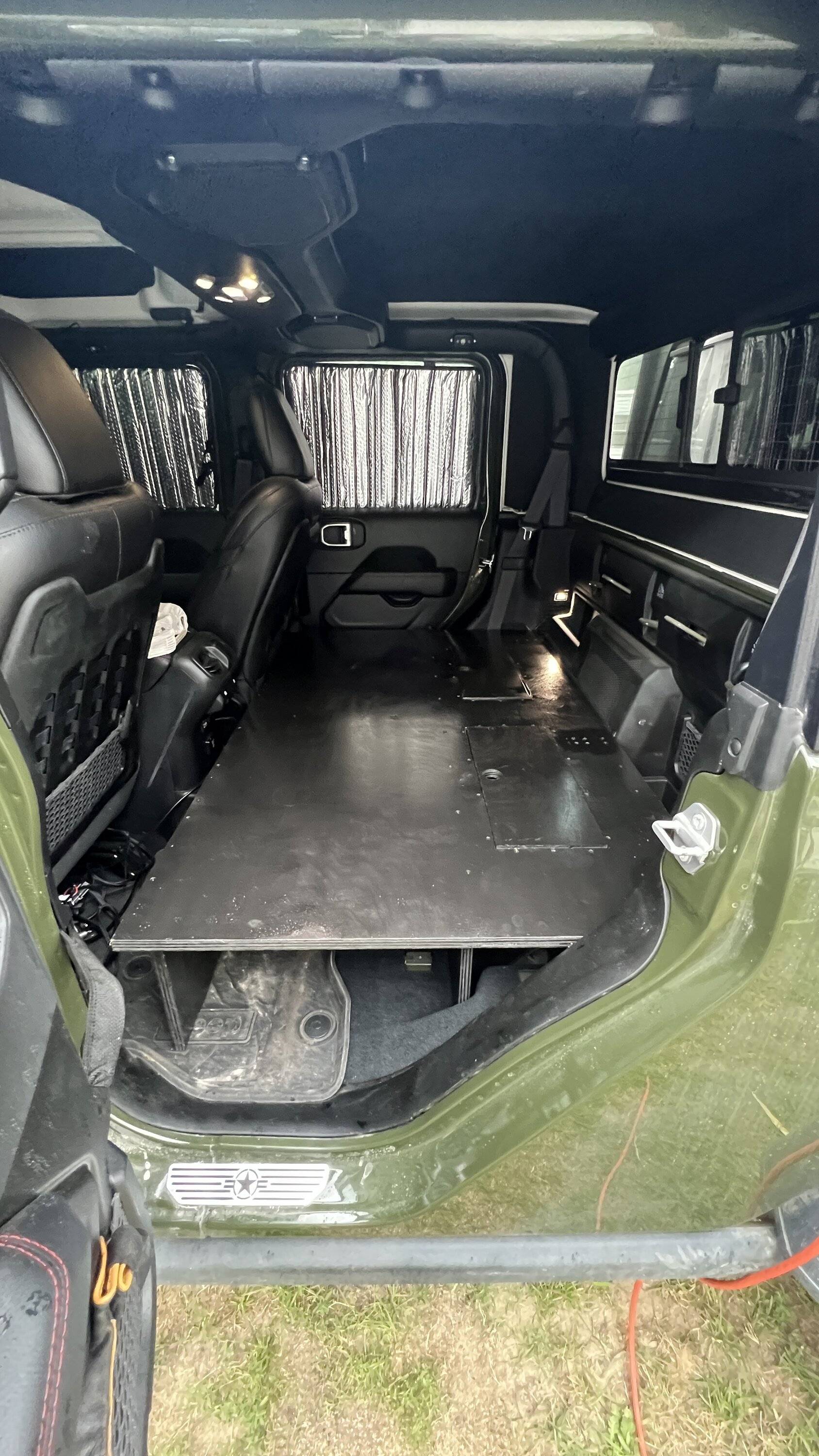

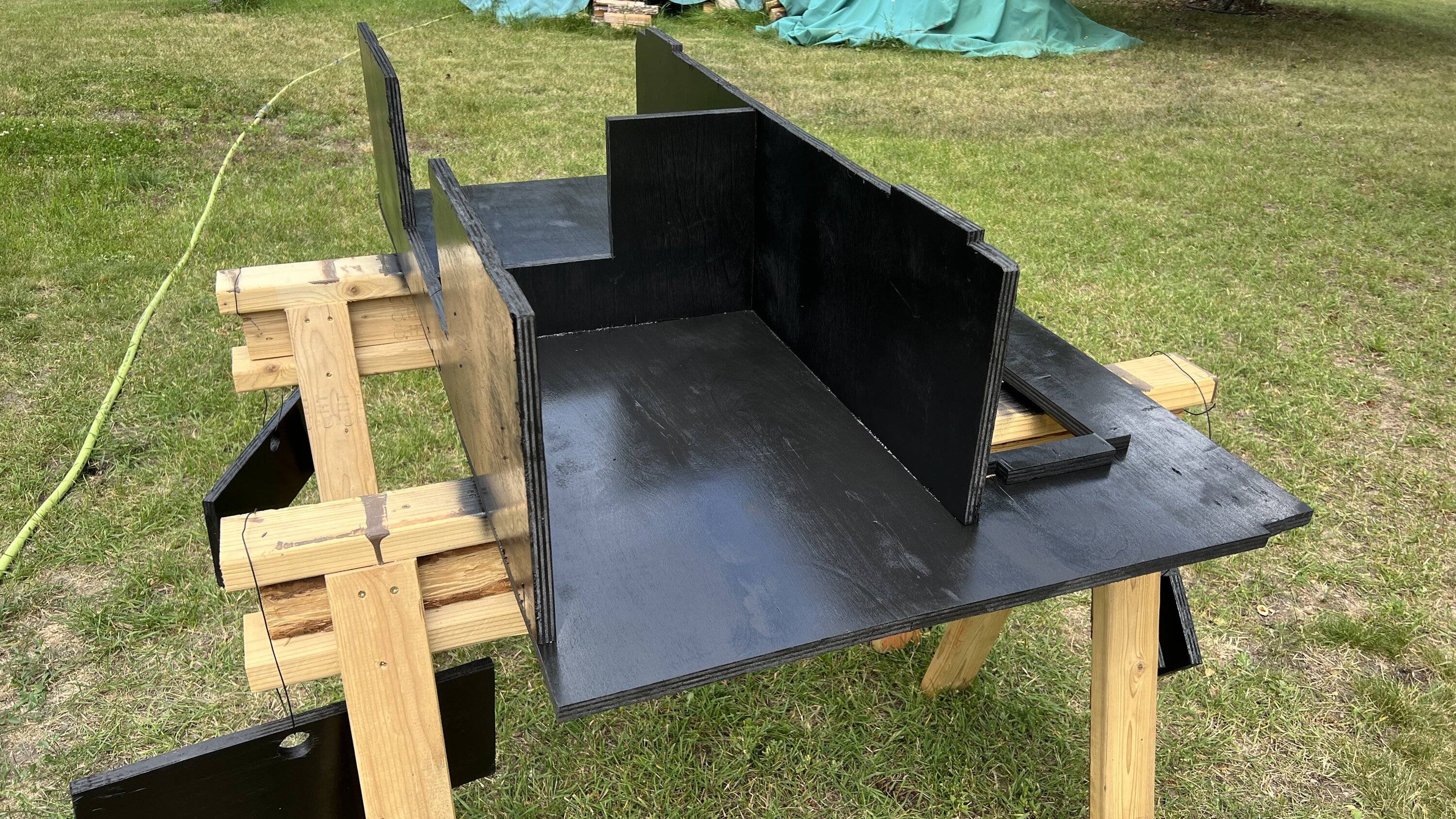

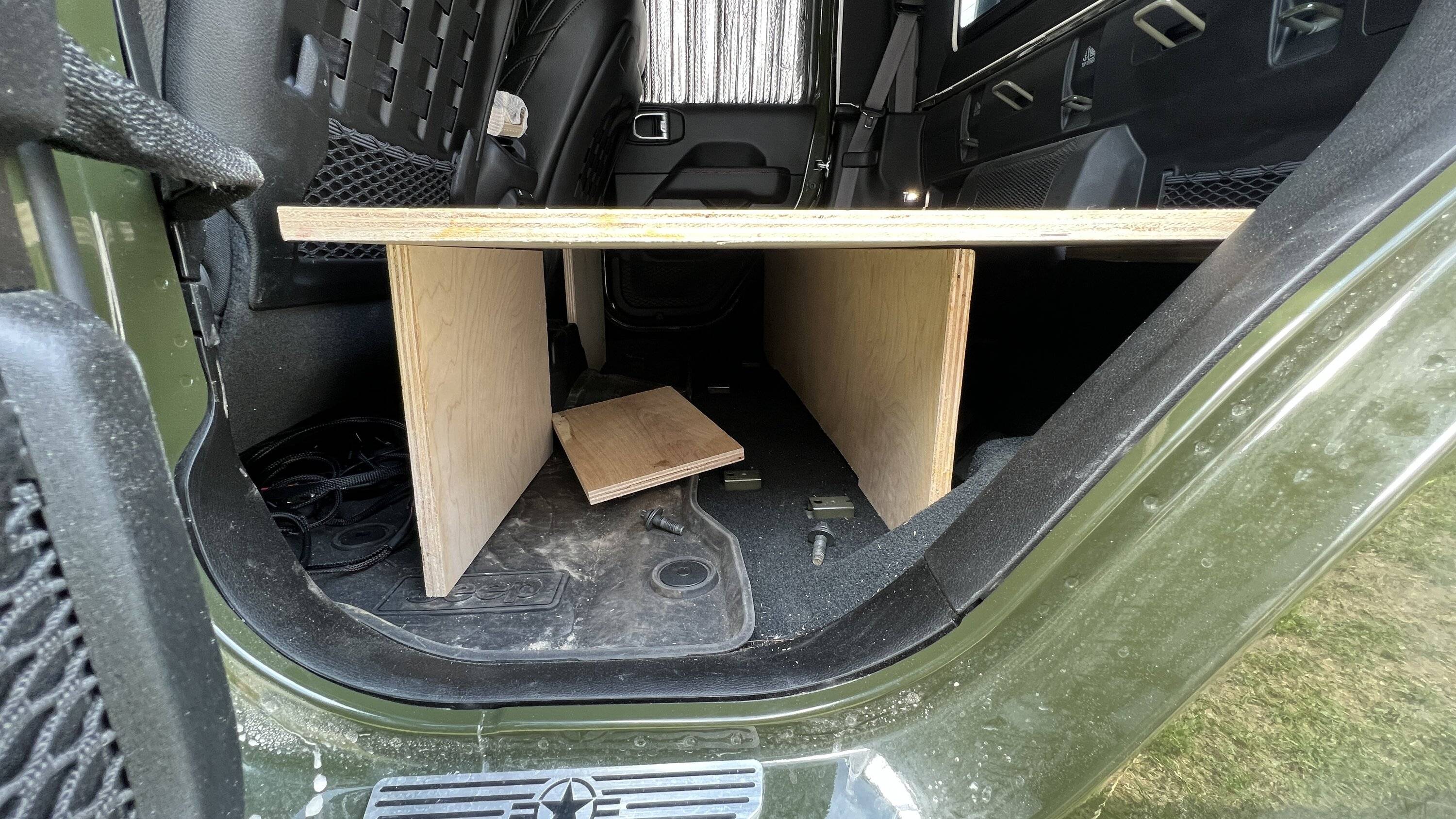

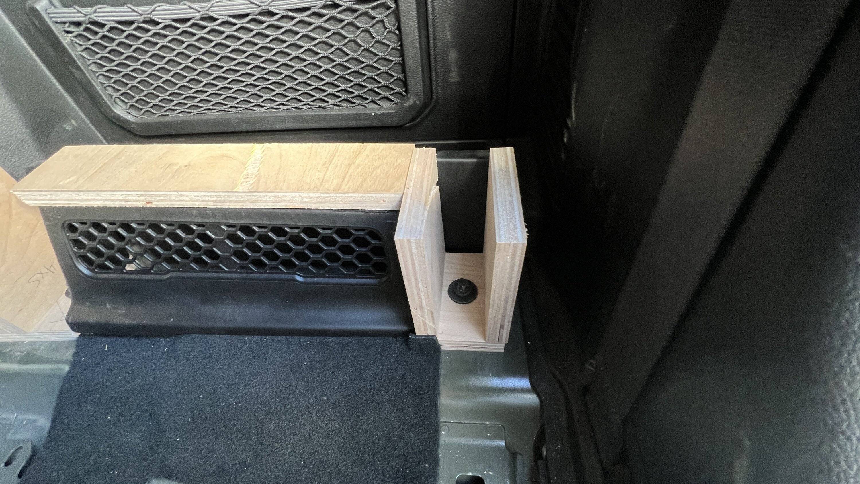

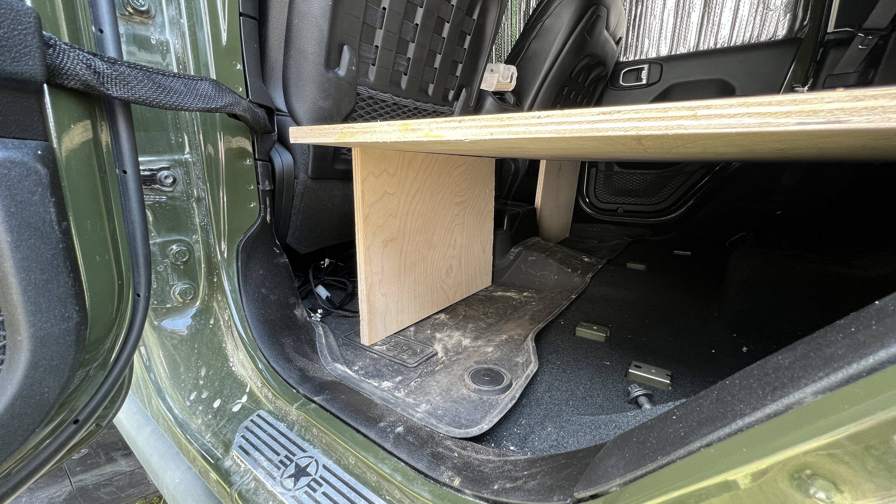

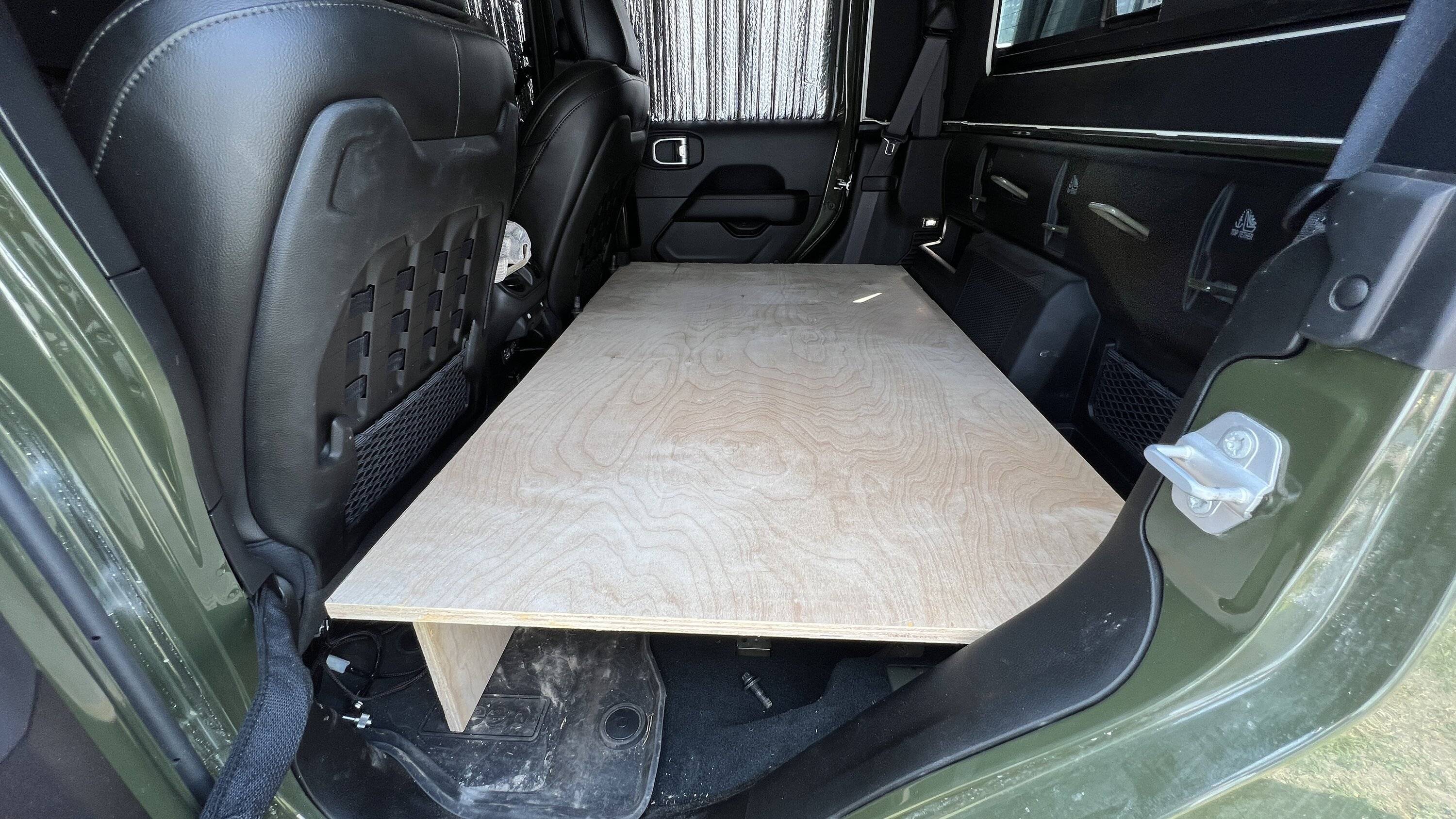

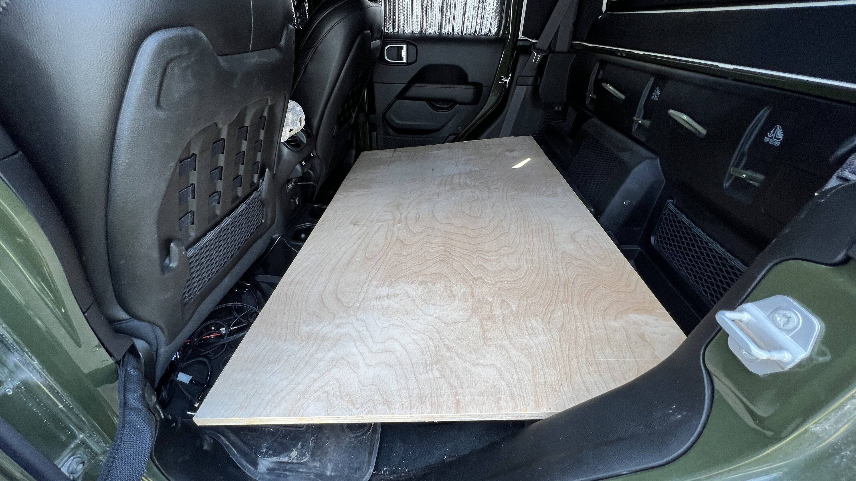

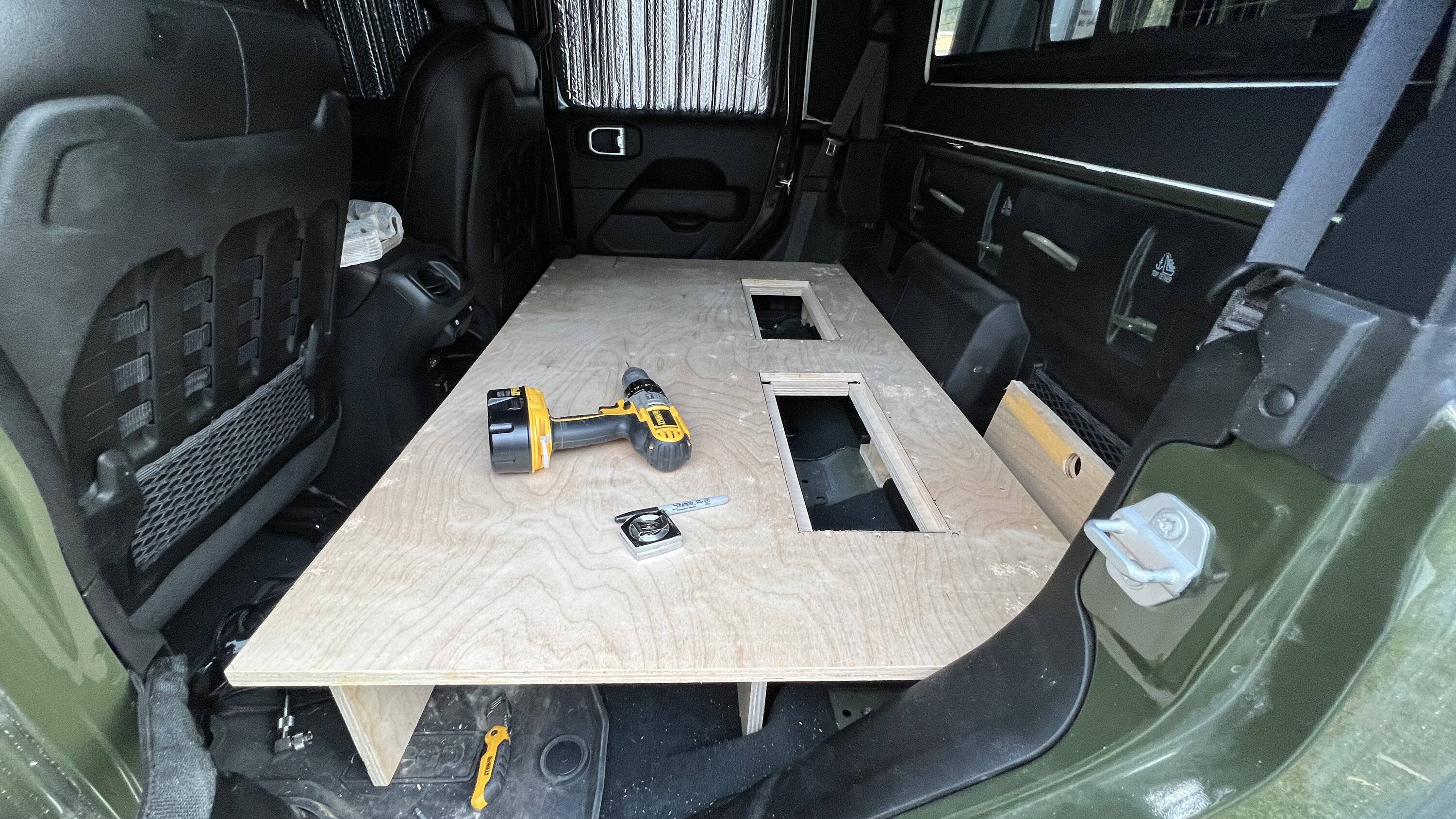

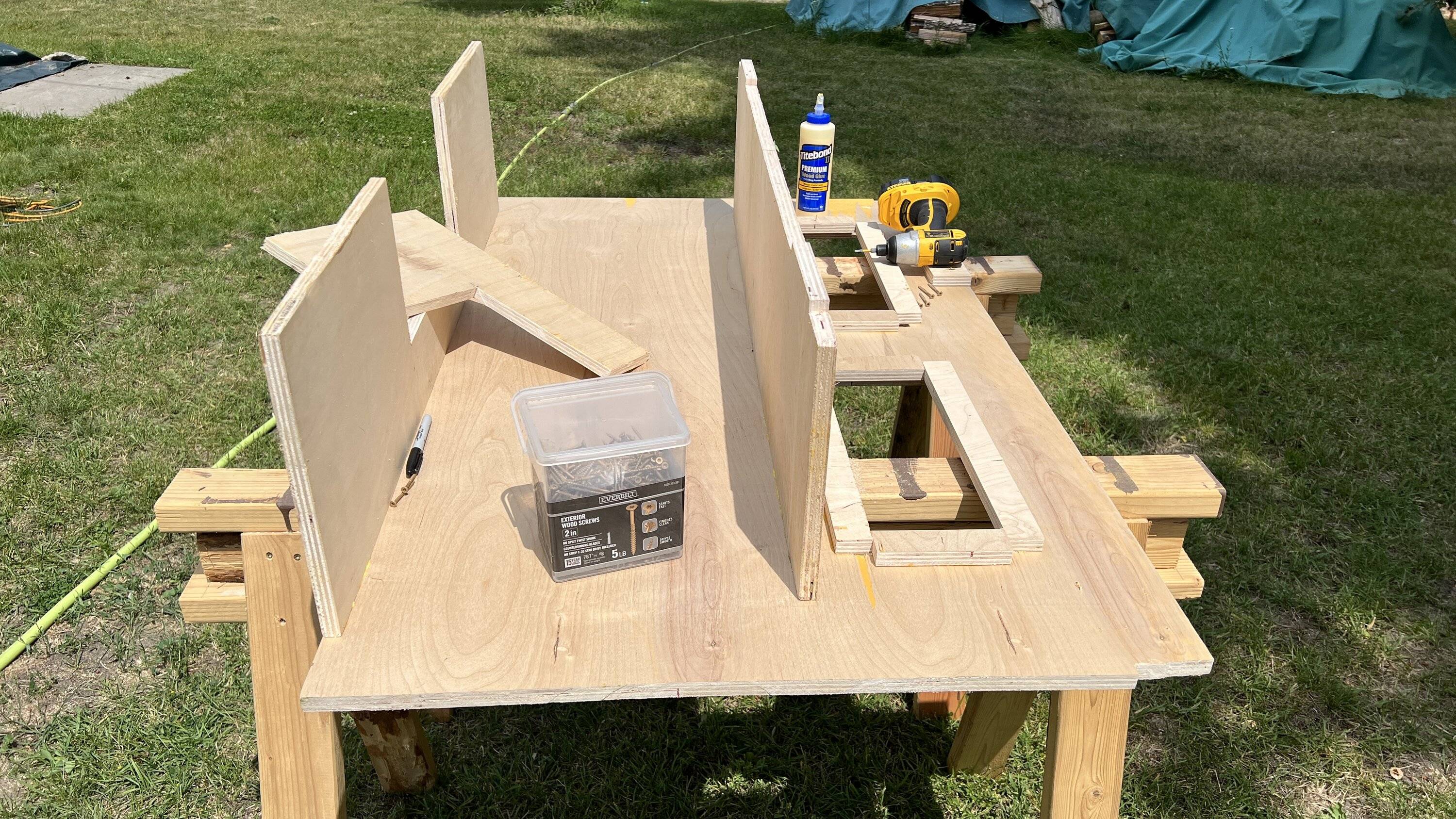

After a few camping trips already this year and a 8 day trip coming soon I decided to change up some storage options in the cab.

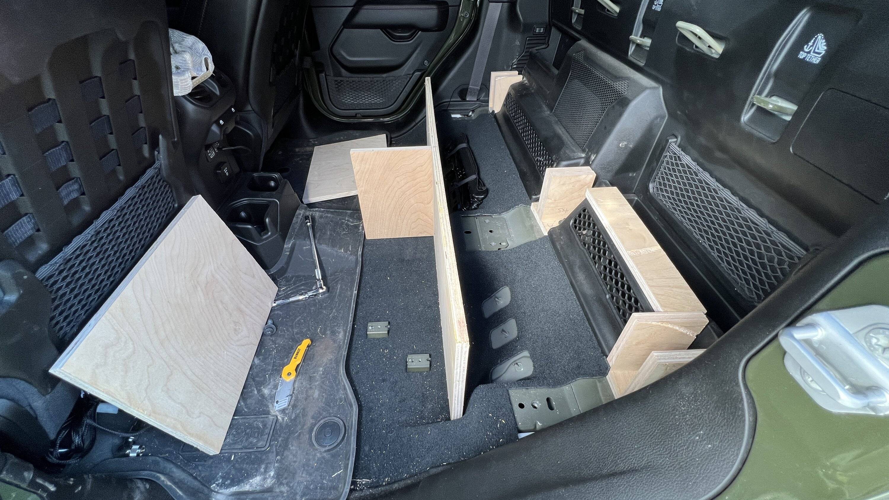

If you recall in post # 35 & 39, I previously installed a home made 40% seat delete. At the time I didnt want to commit to a full delete thinking I might have room for a third person. But that is very unlikely and I could really hse the space since the rear seats take up a lot of space.
So, out the went. Along with the center divider
I really wanted a simple system that I could finish this weekend as I have a fee more things arriving that must go on before thursday night. So taking some measurements I cut a plain flat piece And went for a test fit.

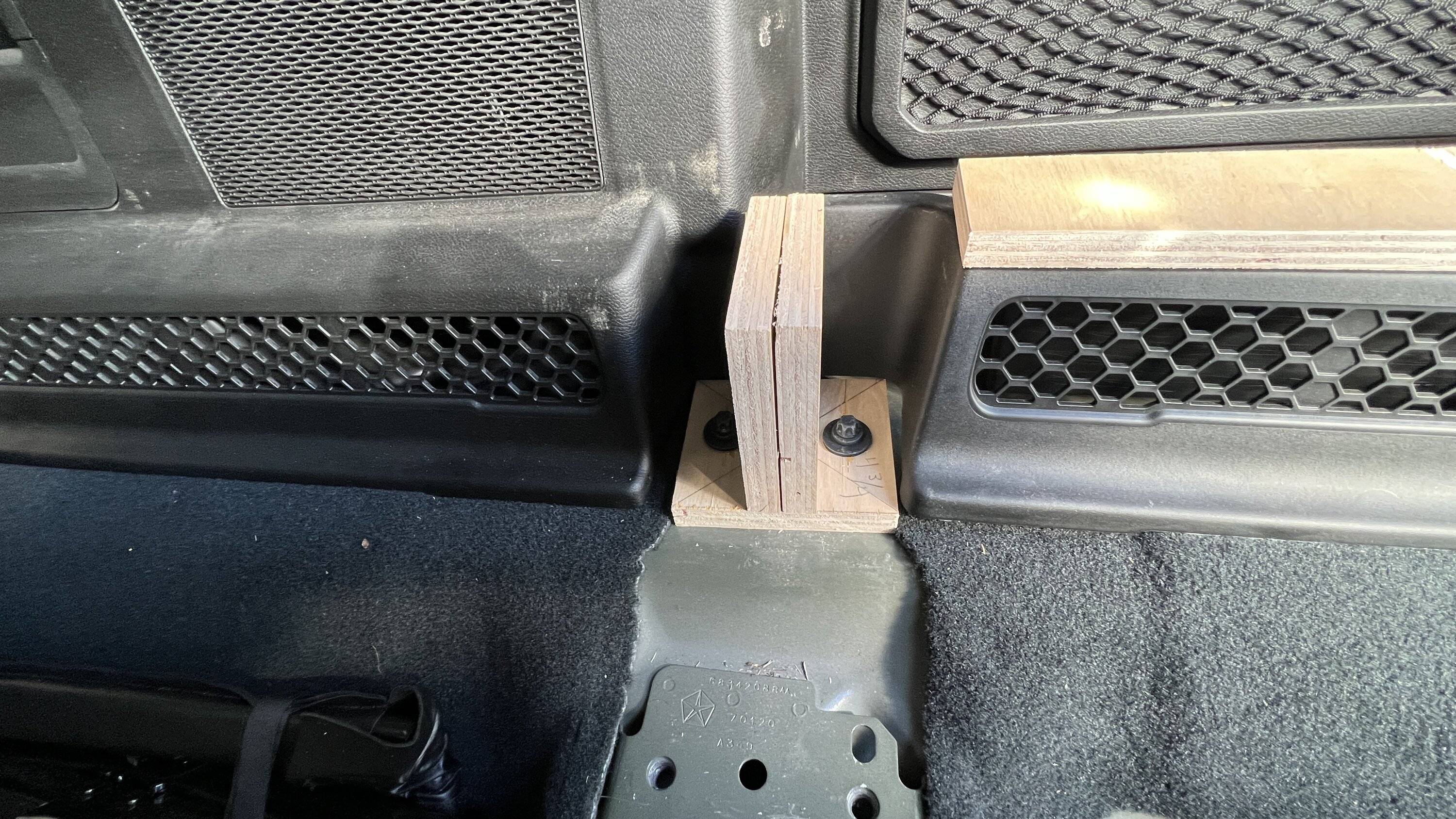

Making a couple temporary front panels I wanted to level it out.
It is a perfect fit. So far. I wanted a taller platform to retain a good amount of storage underneath. I really despise having to move things around to grab something, and the floor based panels require you to pack all your stuff on top of itself - which IMO is a terrible design. This should work well
Thinking it would be good to have another support, I cut a center section
I was using 3/4” birch. Which is all the local store had and it turned out to work great. Initially I wanted 1/2” but now that it is together I would have had integrity issues with only 1/2”. At the rear it was resting on the plastic panels. But I wanted to find a way to secure it to the truck unlike the 40% panel I had before. So I made some quick brackets that bolt to the body, and the top could be screwed into. I also needed a 3/4” spacer for the frivers side as this plastic panel is just under a inch shorter than what is on the passenger side
Next I cut out some access panels, and glued and screwed support brackets for the panels. I only wanted access for the rear portion that would be covered by the center support as the open sides allows plenty of access to the main cubbies.
Nest was more gluing and screwing of the support panels. I opted to make a hald center support as well so the panels are structurally sound. Even though the whole system would be screwed down I didnt want the supports to have any wiggle room and risk buckling and failure.
Finally it was time for 3-4 coats of paint before a crazy rain storm dumped half an inch of water!
So in it goes. I am very pleased with how this turned out especially for being done in a day and a half. It is very sturdy, has opened up quite a lot of storage space and is secured well. In the future I probably will add some L-track but for now it will do. It also gave me a spot to mount the CB and GMRS so theyre not just sitting on the floor anymore.

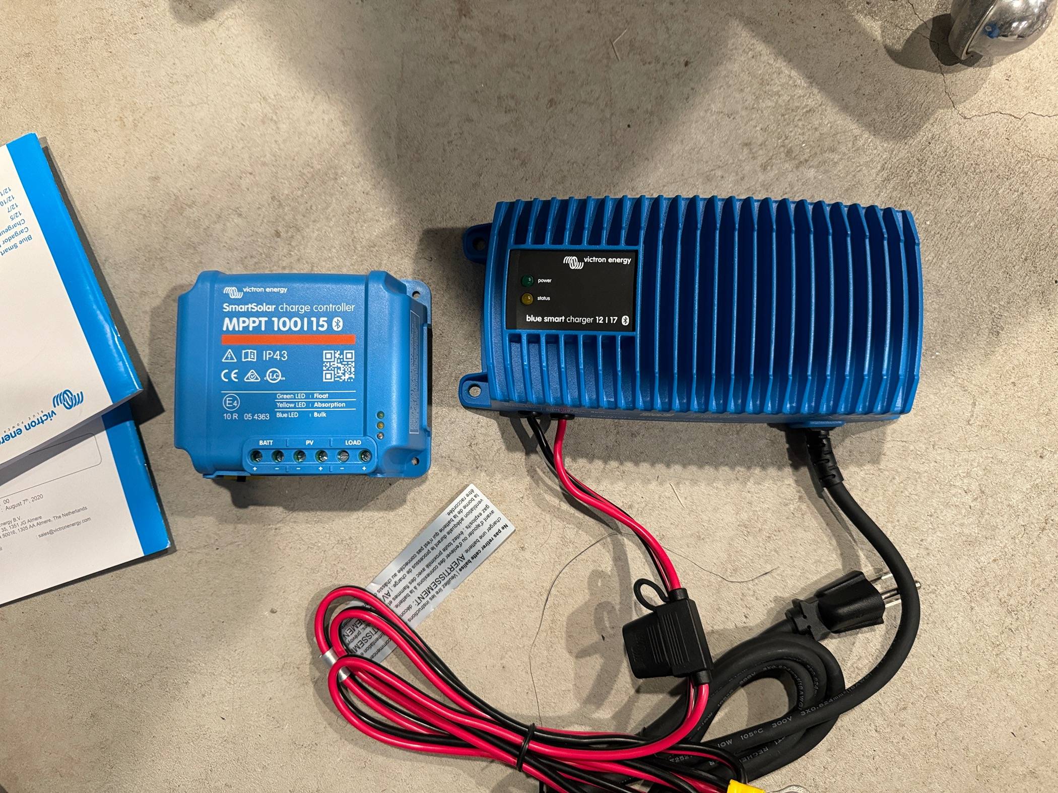

A few more things came in the mail today as I continue to work on the bed overhaul - hopefully some big progress made this coming weekend. Thanks to @Turnswrench I picked up the 'mobile' version of Victron's charger/maintainer. After seeing how nice the graph results are and information provided I opted for their perm on board option. This one is only a 17a charger. I will say this charger is very heavy and beefy compared to the previous. All aluminum compared to all plastic. This should be beneficial for me though as last year during sunny days the CTEK charger got so hot I debated unhooking it. The 25a charger was an additional 60 bucks and I don't really see a need for a 25a charger considering my battery capacity is only 230a and I have solar as well. So the mobile one I was testing went on the LJ, while the CTEK will go on the TJ. I also opted for a 15a solar controller - again because they offer a graph and data. It should work fine with the ZAMP solar panels. I opted for a 15a as I only have two 100w panels and there isn't enough real estate currently for a third. The ZAMP dual battery charge controller works just fine, and is nice and simple, so it will likely be repurposed to the TJ. Also, the 30a controller again was an extra 60 bucks. If later on it is needed I can put this on the LJ.
Not pictured is a Victron smart shunt. To keep things consistent I opted for this as well. Knowing it's not really needed I just wanted to play around with various power consumption to see how the batteries perform as it will offer significantly more information than just a voltage readout, as well as having picked up a small inverter.

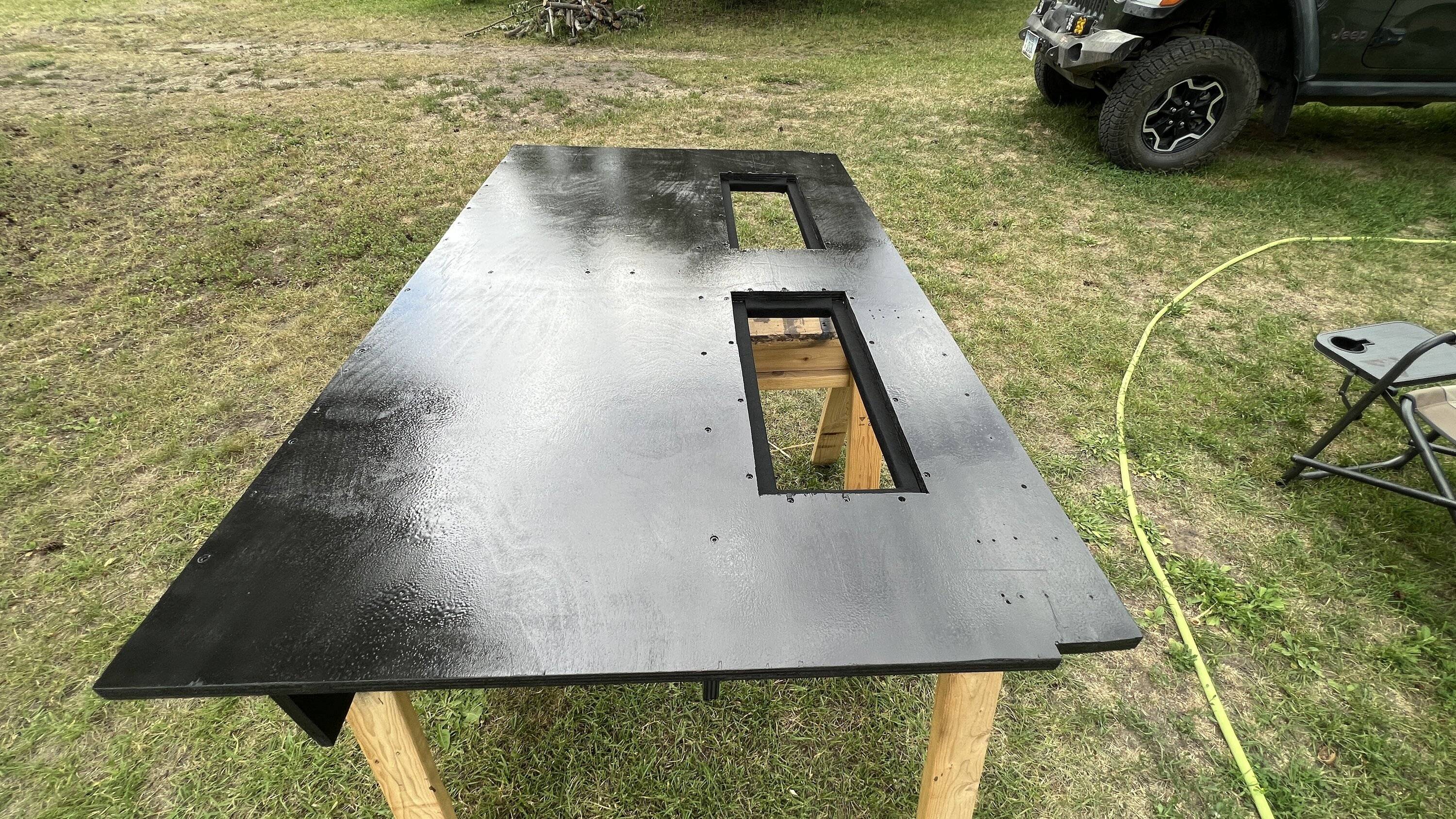

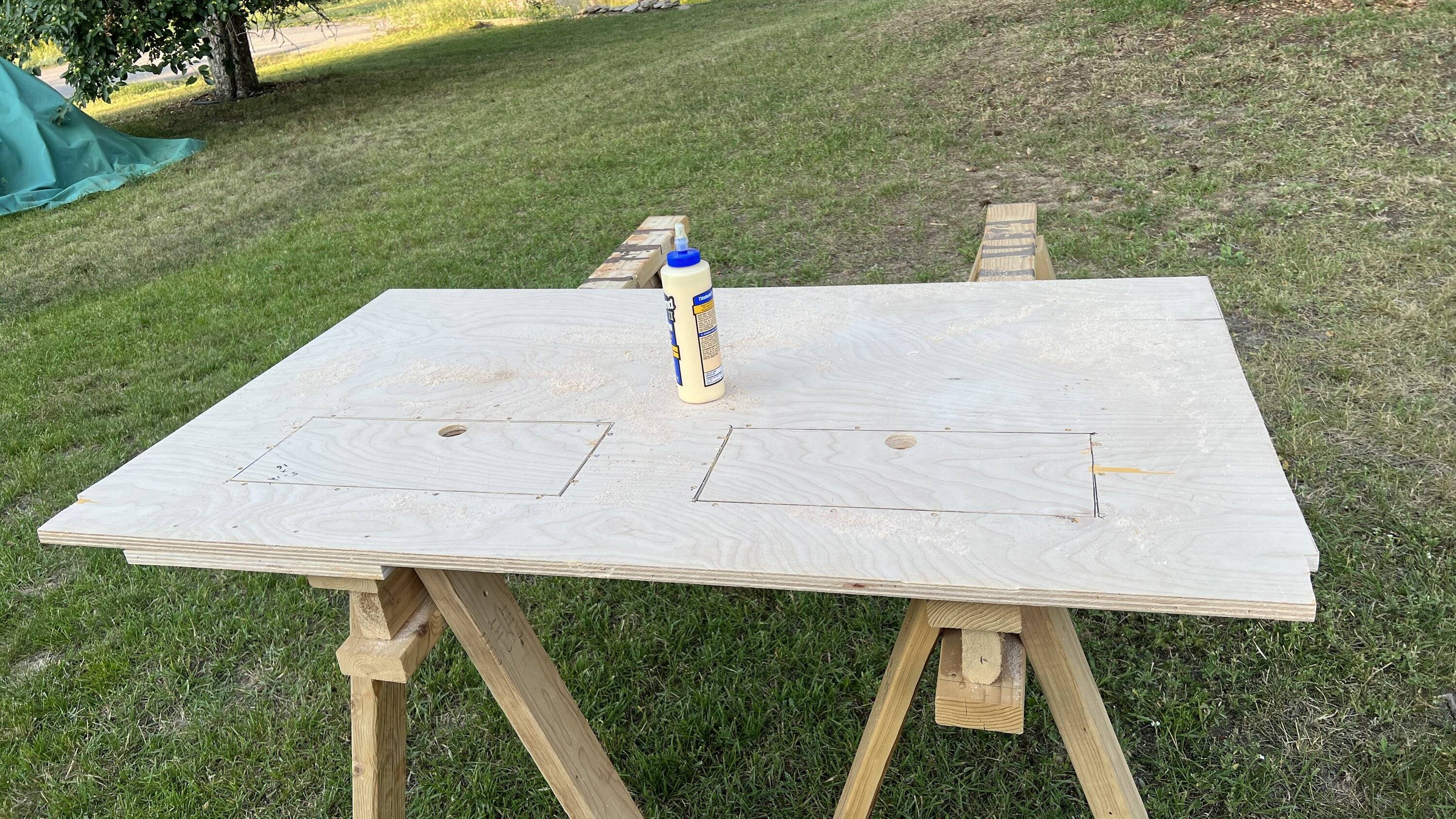

I have been continuing to work on redoing the bed setup but unfortunately it has been going a lot slower than desired. But, today I finally finished up the main electrical. Although I still need to re-attach all the accessories and properly secure the aux batteries cable, and clean up the wires, it is functional! And it looks really clean. Here I added all Victron components. After seeing how neat it was to have the readout of the Victron charger, I relocated that to my LJ and ordered all new components for the JT. Now everything can talk and give great readouts on what is happening. Totally unnecessary, but I wanted to see if my math added up properly in terms of the right aux battery sizing for my application. It will be interesting to see how things actually perform with real numbers instead of basic voltage. So pictured here is a Victron hard mount 17a charger/maintainer (which also has an option to be turned on as a power supply if at a camp ground with power), a Victron 75v/15a solar charger, and a 30a DC/DC. I really was hesitant on getting the DC/DC as my particular application does not need one, and they are quite expensive and unnecessary. But I wanted to do some real world testing - again with numbers that Victron can provide, so took the plunge to test it out. Also pictured is the Victron 500a shunt which gives functional consumption numbers. Not pictured is a second battery selector, and seen is a second fuse block - both items required due to the additional DC/DC and more complicated wiring setup. So far it looks great, and the Zamp panels (2x100w) perform amazing. I am still astonished at how well the Zamp panels perform even with only 1/4 or 1/8th of the panel area seeing direct sun. Even zero direct sun the panels provide enough power to operate the bed lights.

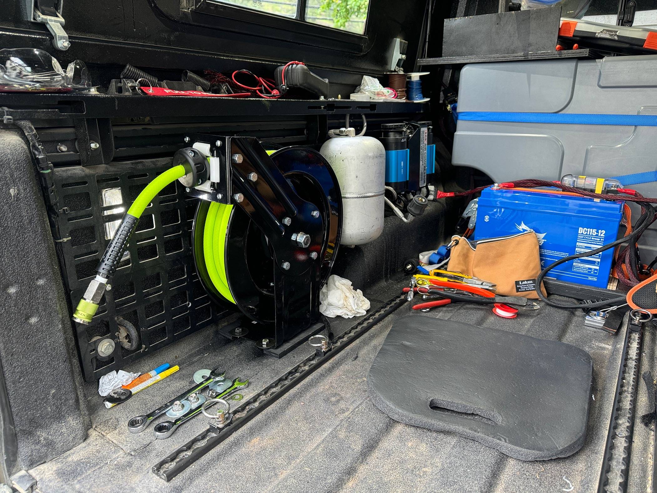

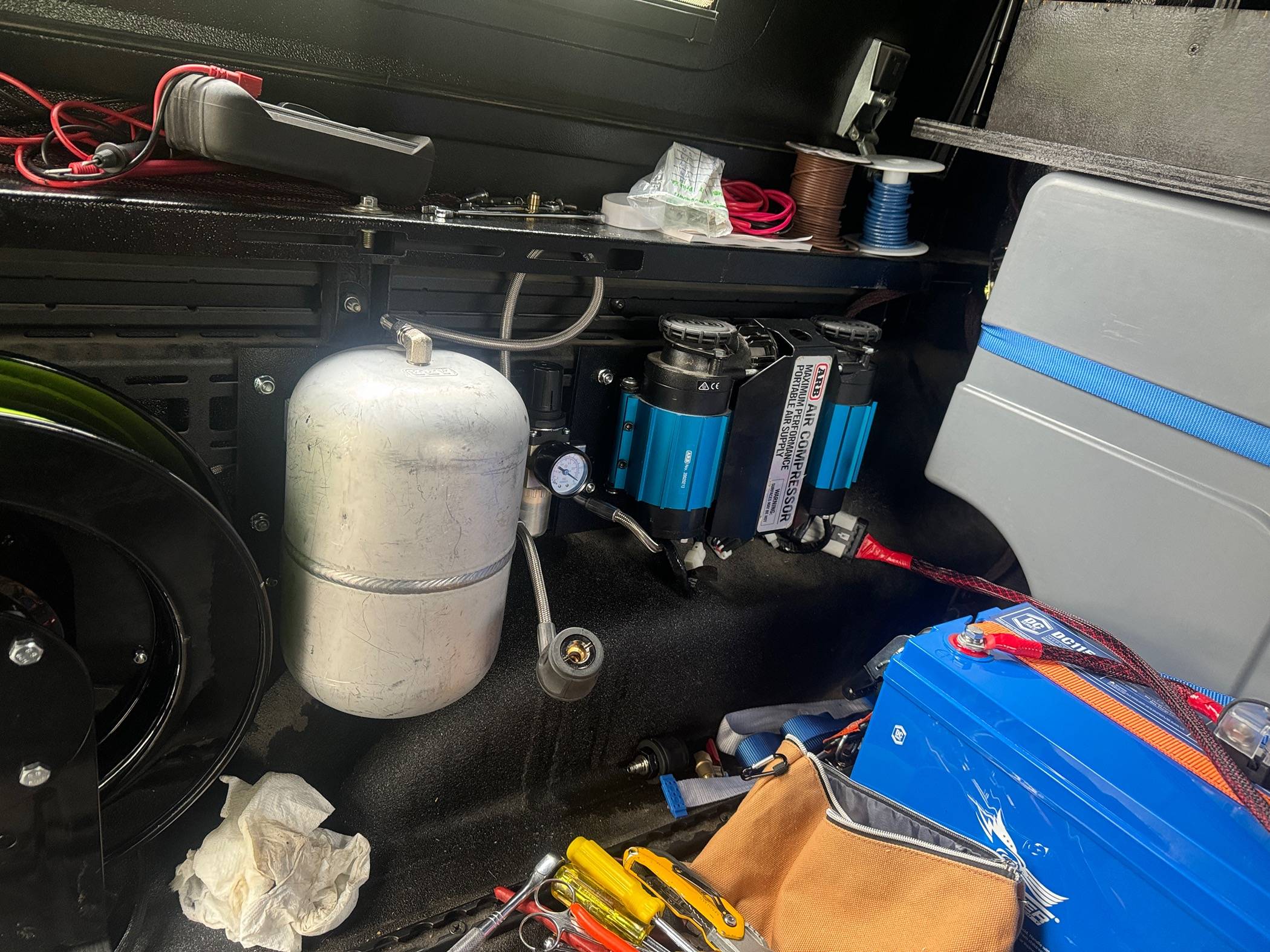

Making more progress today I mostly finished the new air system setup. There are a few small leaks to tighten down and one air line to replace when new parts arrive but for the most part it is set and functional. I now have an air/water separator as well - hard to see. I realized after separating the tank and compressor a couple years ago that the inside of the air lines were already rusting due to the amount of water generated from temperature differences. So this separator should at least prevent water from building up in the tank and getting into the tires and possibly freezing a valve core. The 25' hose reel is fantastic too. It was a bit of a pita and it is a little flimsy for my taste - so that will need to be fixed, but it will do wonders for making the whole process easier. I realized last year that the 4 tire fill-up really is not as functional as they seem. At the end of the day it takes just as much time doing each tire at a time as it does all 4 at once. Plus it gives you a chance to stand up and walk around from a day full of driving. I am happy about this setup and it is consistent with the rest of the build - making things easier and quicker.

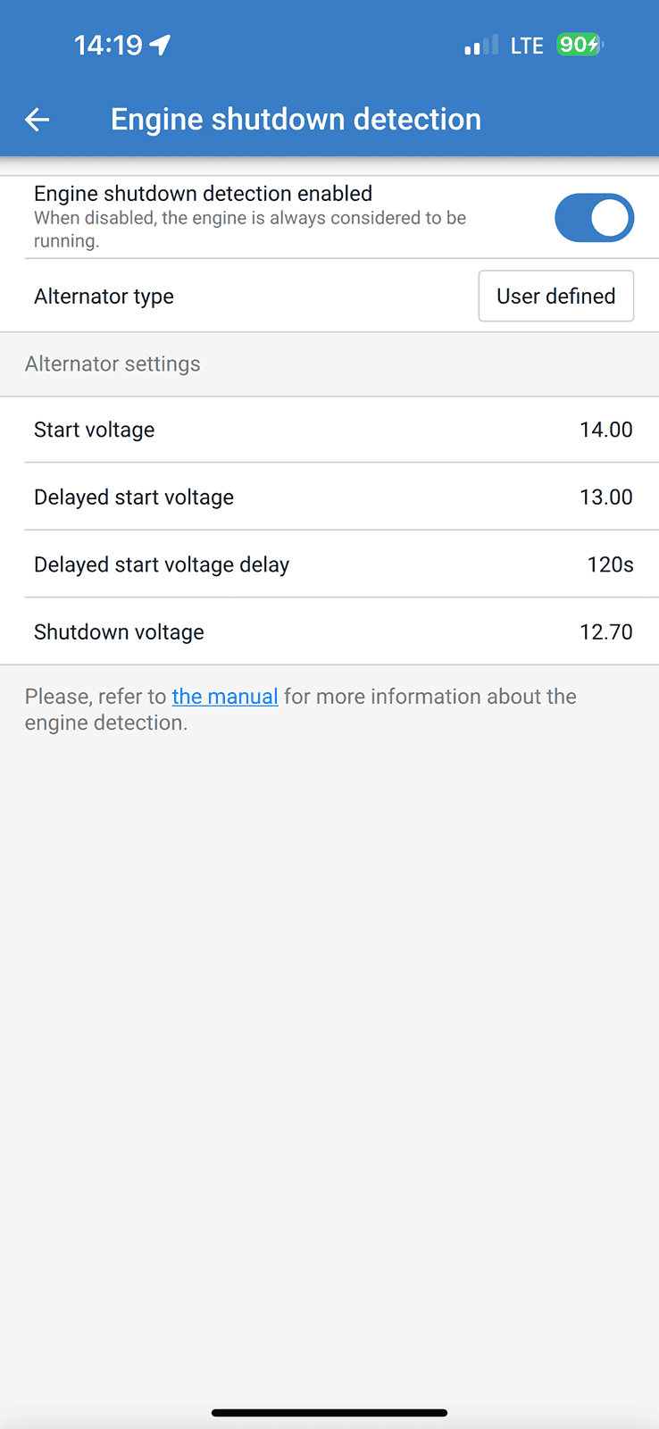

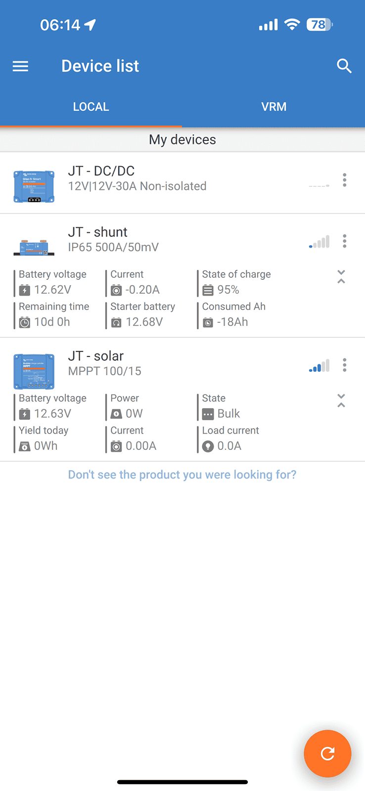

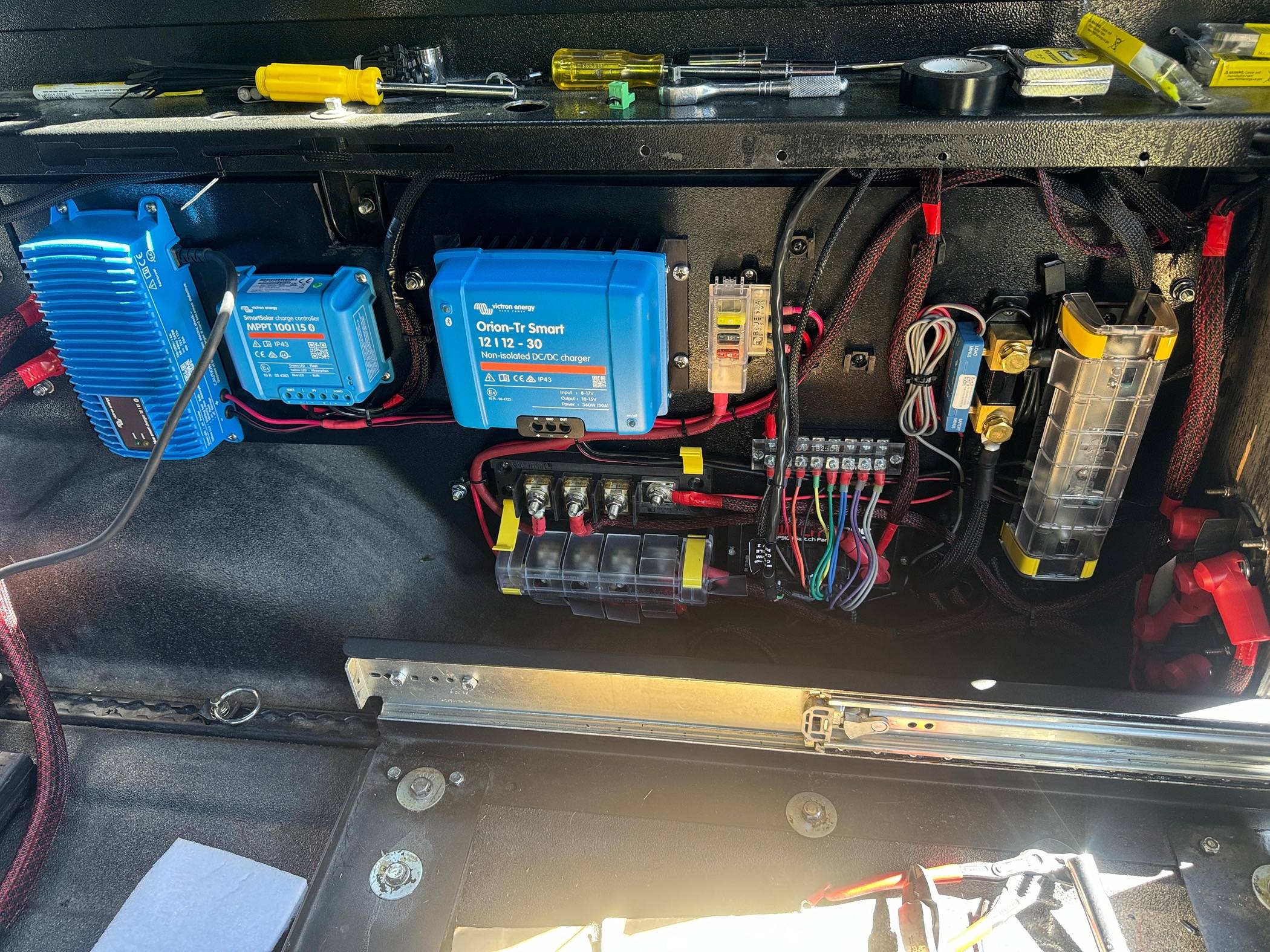

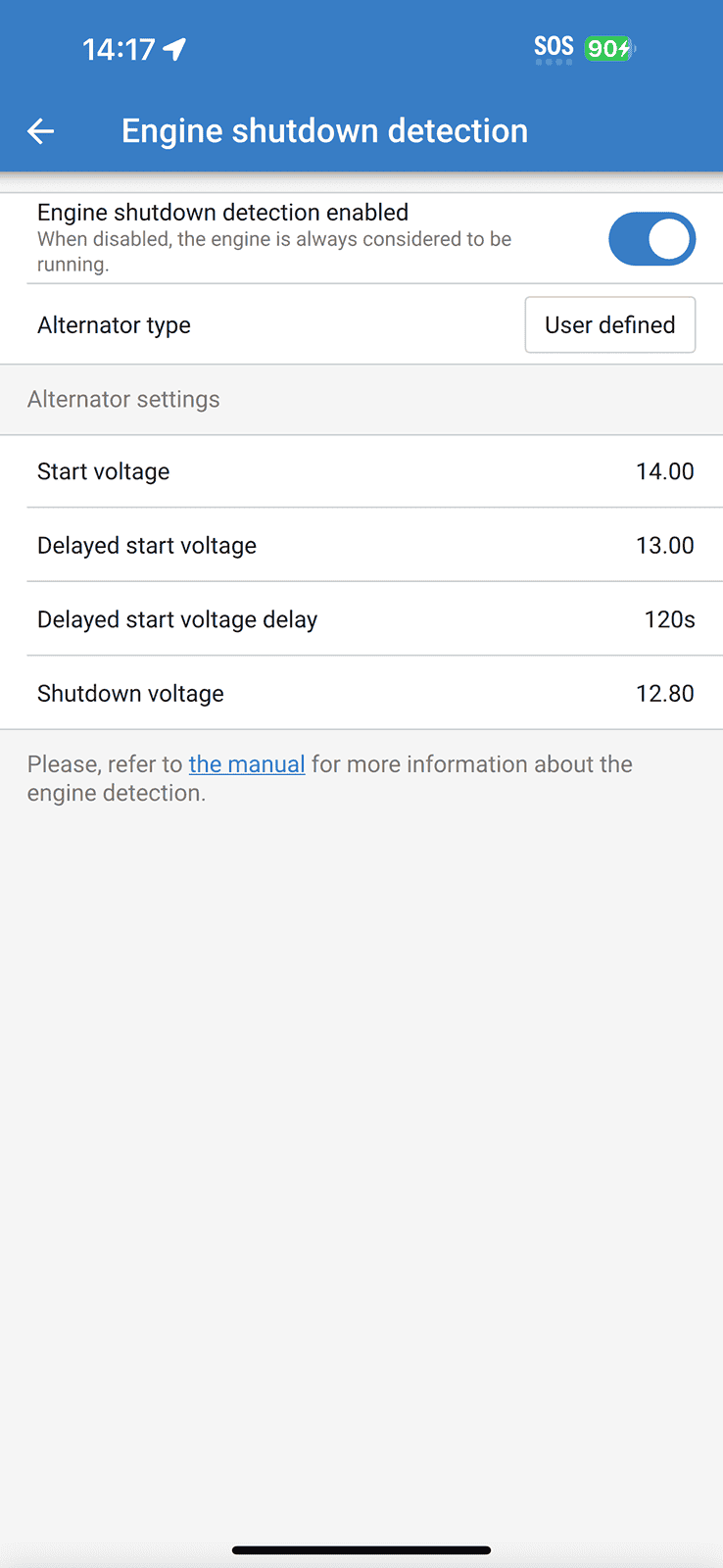

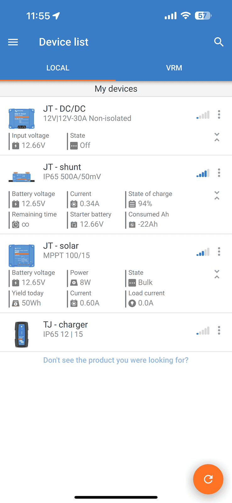

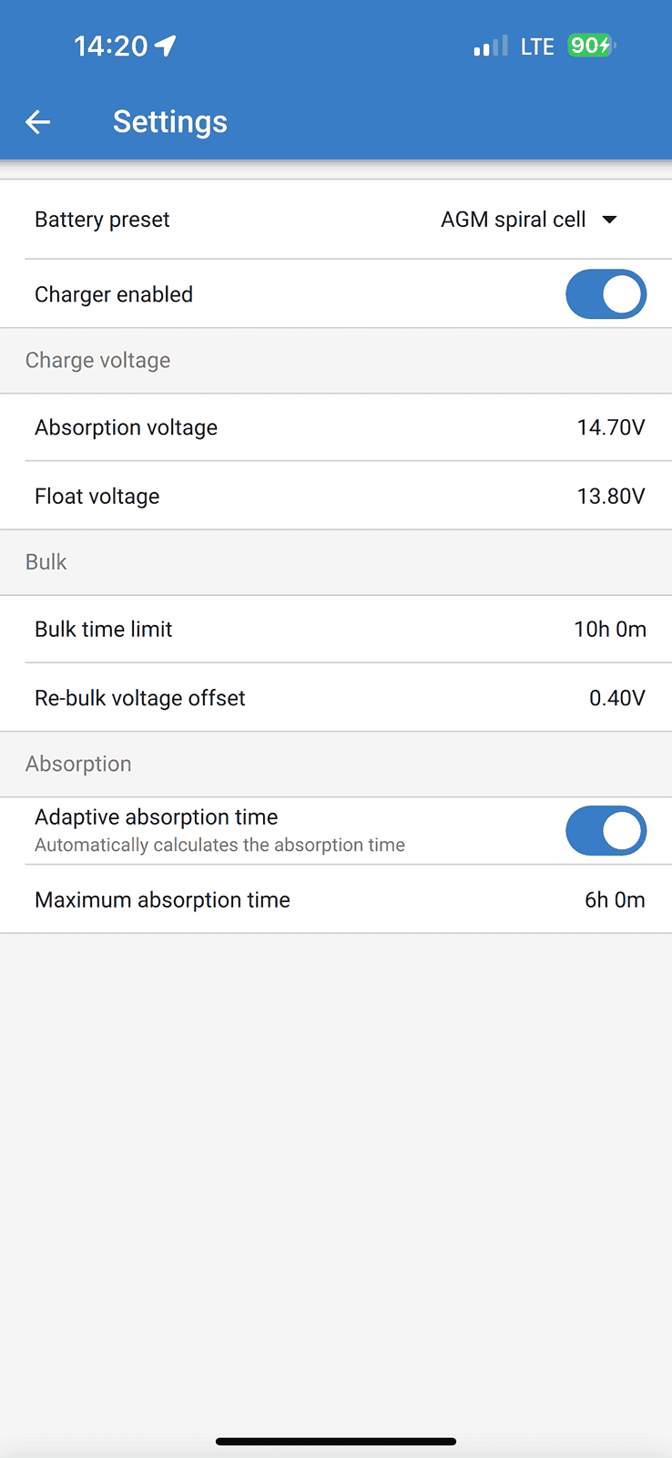

The last few days I have been doing some very very basic reviewing of the Victron components - specifically the shunt. The solar charger works as designed and it is fully able to take advantage of my dual 100w 26'ish volt Zamp Obsidian panels. So far even in the lowest of light the panels still put out, and in good light they max out. I purposefully have the JT parked where it only gets about 2 hours of full sun a day, and in those two hours it is enough to fully recharge the batteries. Although, to be fair I am only running the fridge, with no food in it - so amp draw and duty cycle is fairly low, but with hot temps the next couple days it will have a little strain. The Victron components allow you to fully customize all sorts of things, which is fantastic. The Full River FT and DC series batteries charge best at 14.7v. Most solar chargers use the standard of 14.4'ish to my understanding. So I am able to adjust the voltage output of the solar controller, DC/DC, and shore charger to all be at 14.7v.
The DC/DC offers total customization as well in terms of voltage lockout, starting voltage, etc... Although still not necessary for my application I did want to play around with it and see if it might extend battery life and double dip along with the solar charger to ensure a full recharge if the batteries just happen to get down to 30-50% - and with some basic testing, the answer is yes. Not all DC/DC and solar charge combo's will do this.

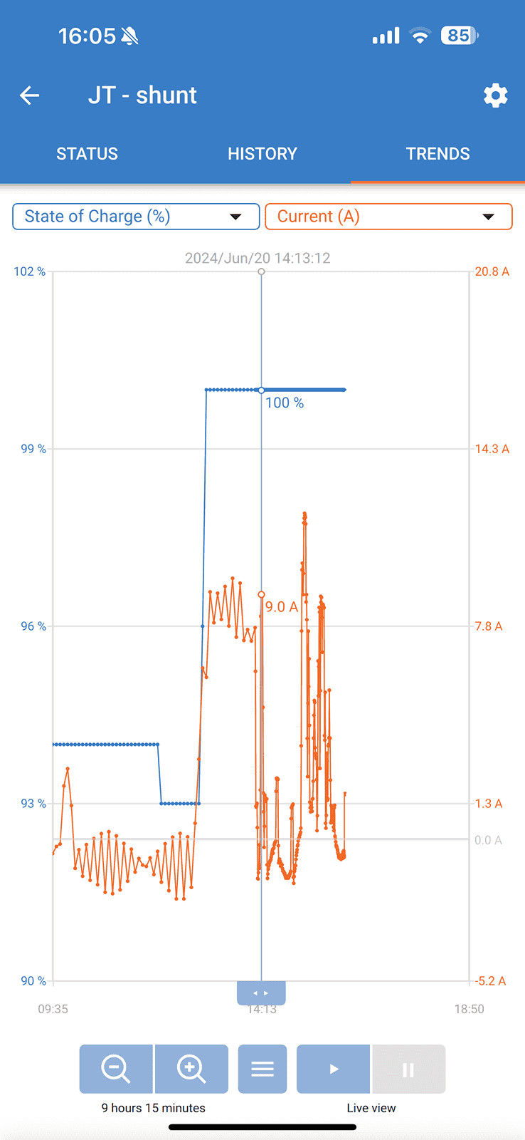

The app lets you see real time the main bits of information which is pretty cool and fun to monitor, without having to go individually into each device.
By this point I have gone about 17 hours without any sun on the panels

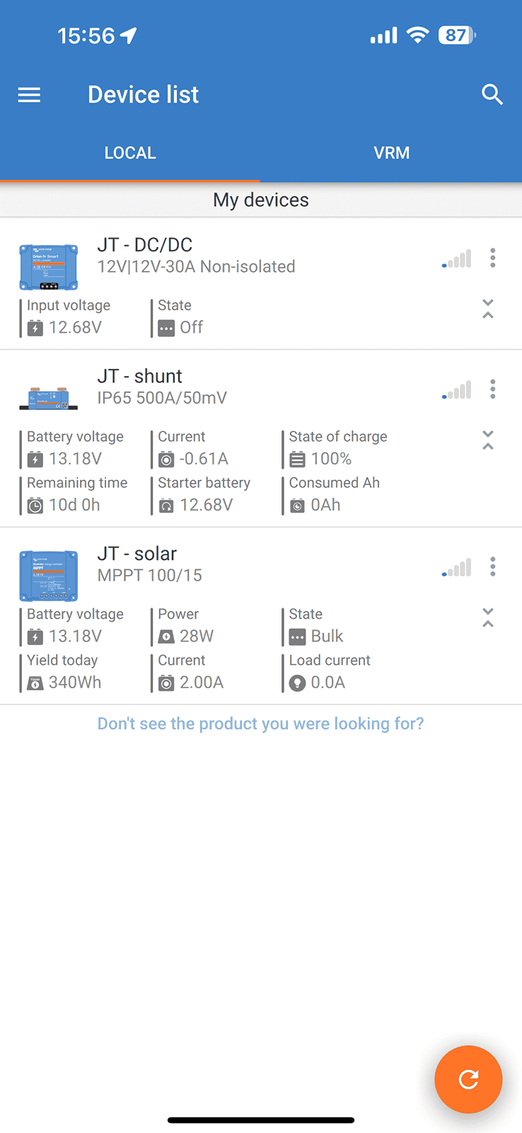

In about 1.5 hours of direct sun the solar fully charged the batteries - not that 25ah of consumption is very much in the first place, but it is quicker than I had expected.
The info the shunt displays is pretty awesome. You can change the graph to show any combination of 5 or 6 different options. I was mostly interested in SOC and current. Knowing that each panel outputs a max of 5.1a, Im' not too concerned about viewing voltage as that's pretty easy to infer. I should also mention this was on a big puffy cloudy day so constant fluctuation of sun/shade/sun - as can be seen by the amperage output.

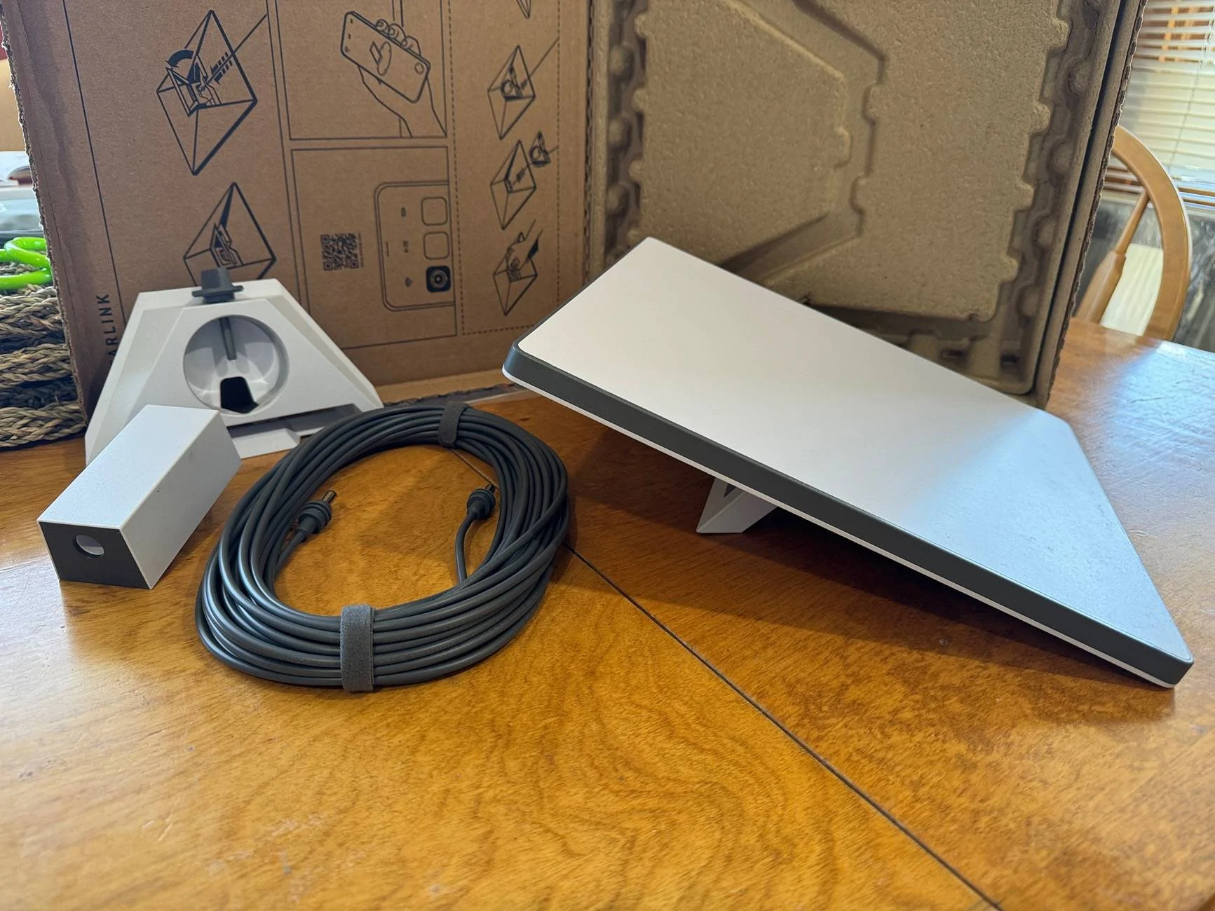

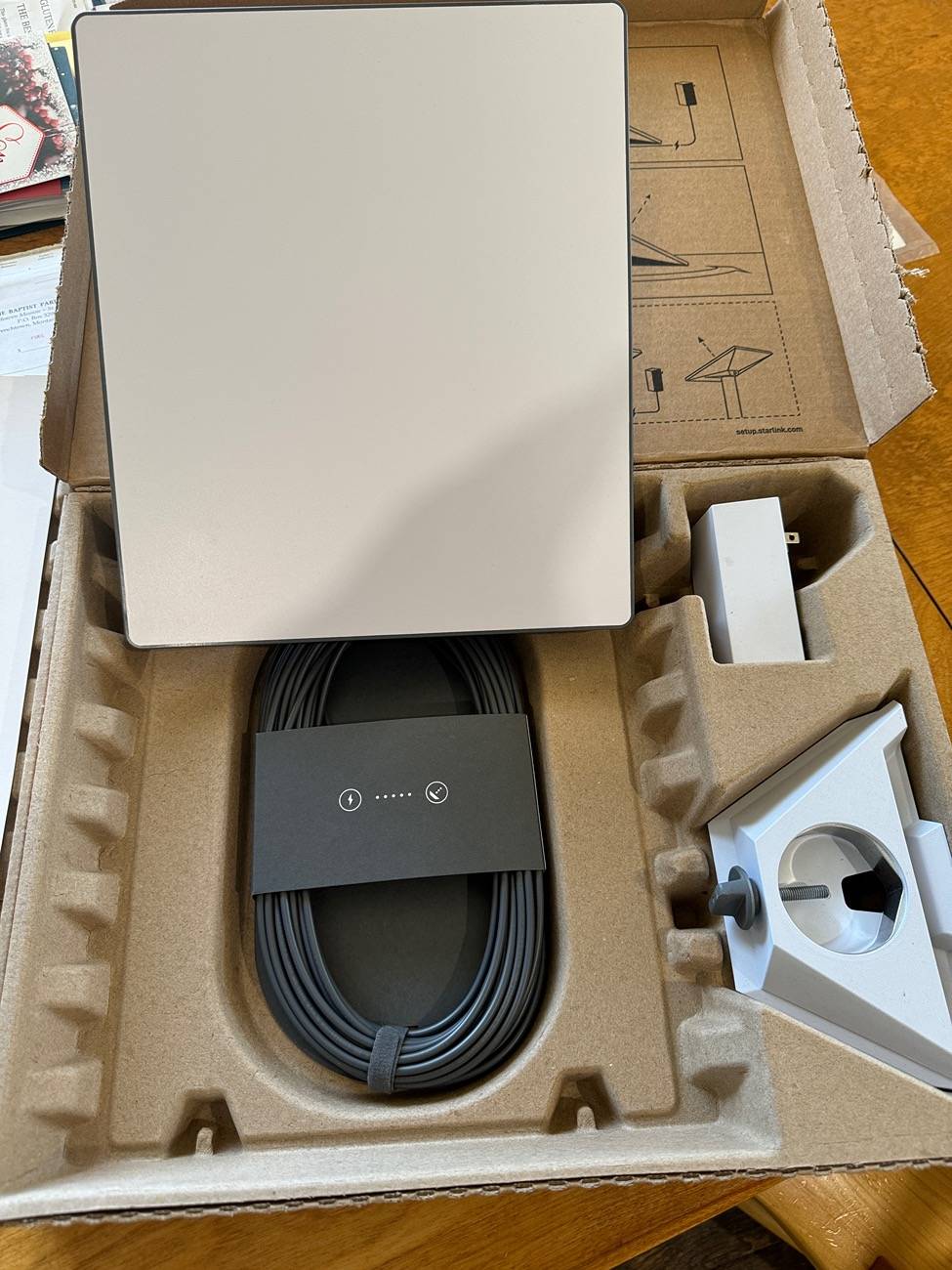

Yesterday, the new Starlink Mini sat antenna arrived. For some initial discussions visit
https://www.jeepgladiatorforum.com/forum/threads/starlink-mini.82693/

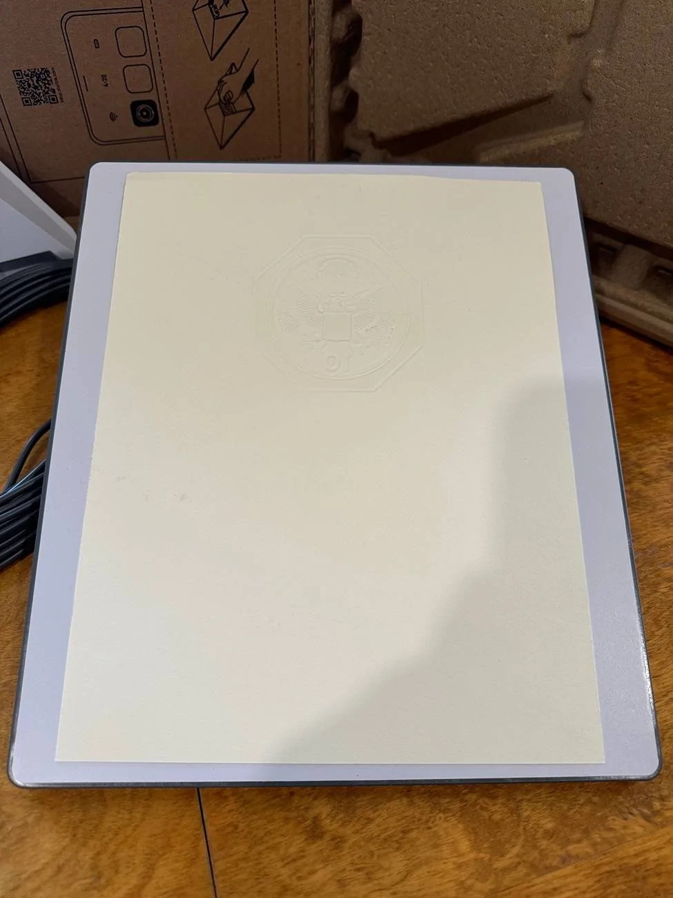

This thing is surprisingly small and compact - which is one of a couple reasons I opted for it. Just over the size of a standard piece of paper, and about 1.5" thick, it is barely a couple pounds.
Jeep Gladiator Destination Unknown - 2022 JTR journal IMG_5161
It comes with a pole mount - which is a little weird, a small 110v power adapter (USB-C cable is being manufactured still), 15m of cable, and of course the antenna. The antenna integrates the wifi router into it, so it's not like the standard sat antennas that have the antenna plus a router and two cables. This is all compact into one. In fact it somewhat reminds me of the small arrays we used in group.
Jeep Gladiator Destination Unknown - 2022 JTR journal IMG_5160

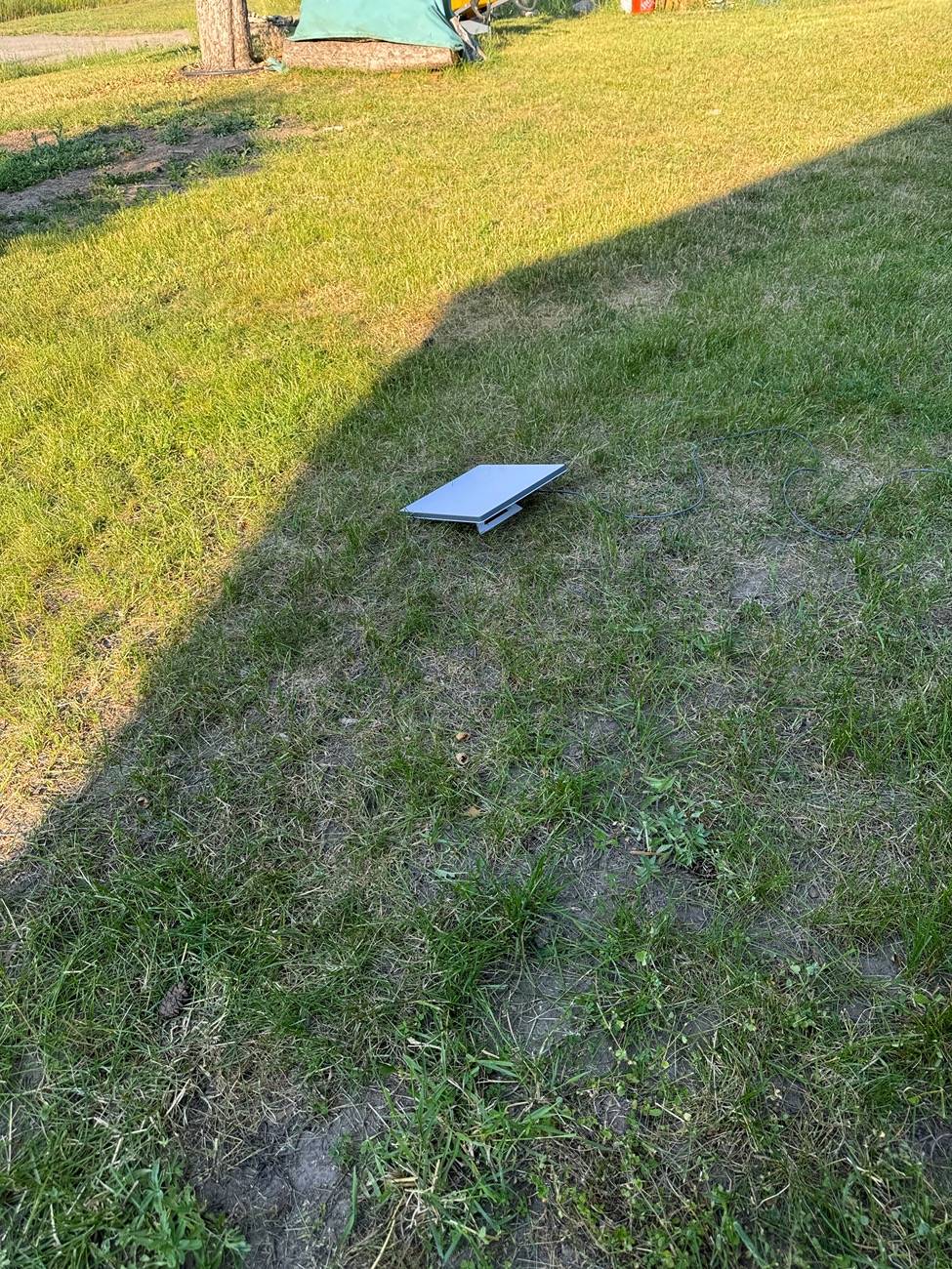

It is not (currently) available to everyone and you have to have received a special email invitation to purchase it. That was the main driving factor for me - limited availability. But I am more than willing to bet in the future it will be widely offered. It's a good entry way to test out if this is something I can get use out of. The standard roam plan is $500 for hardware and $150/mo for service (but can be paused by the month as needed). The cost for the Mini Roam is $600 for the hardware, and the plan is $30/mo - it cannot be paused. The details are important so pay attention. You MUST have a residential plan to have this. It is essentially tacked onto your existing home starlink. The Starlink Mini Roam is capped at 50gb /mo but you can opt into more data at $1/gb. With my job I highly doubt I can actually work while camping unless I can also bring 3 32" monitors with me. Maybe a RV or camper some day. But I see this as a potential replacement for the Garmin InReach. I have the Garmin Mini, and though convenient I have become increasingly concerned about their service. I receive almost daily messages of their satellite network having problems or going offline. Usually it is offline only a hour or so, but sometimes over a day. That is enough to cause concern for a 'emergency' device. My dad also has the Garmin Mini and he hardly ever gets signal unless at the top of a hill with no trees - a hard thing to find in western Wa. Their own SAR coverage is also not great. At $35/yr it's a budget option that only covers up to $100,000 worth of expenses. Barely a rotary flight if needed. There are other options in the $350/yr range that have significantly better 'insurance' coverage.
I see this as a great opportunity to keep in touch with people while camping as needed and even do mild work if a fire pops up without having to end a trip early. Seeing as how I now have a rescue critter at home, I need to have a way to stay in touch with anyone who watches her and be able to drive home as needed. The Garmin will work great for general messaging, but having the ability to make wifi phone calls, emails, pictures, and even video messaging if needed is pretty cool.

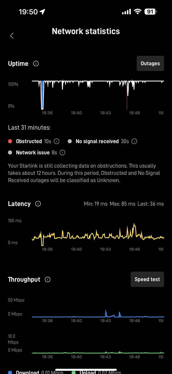

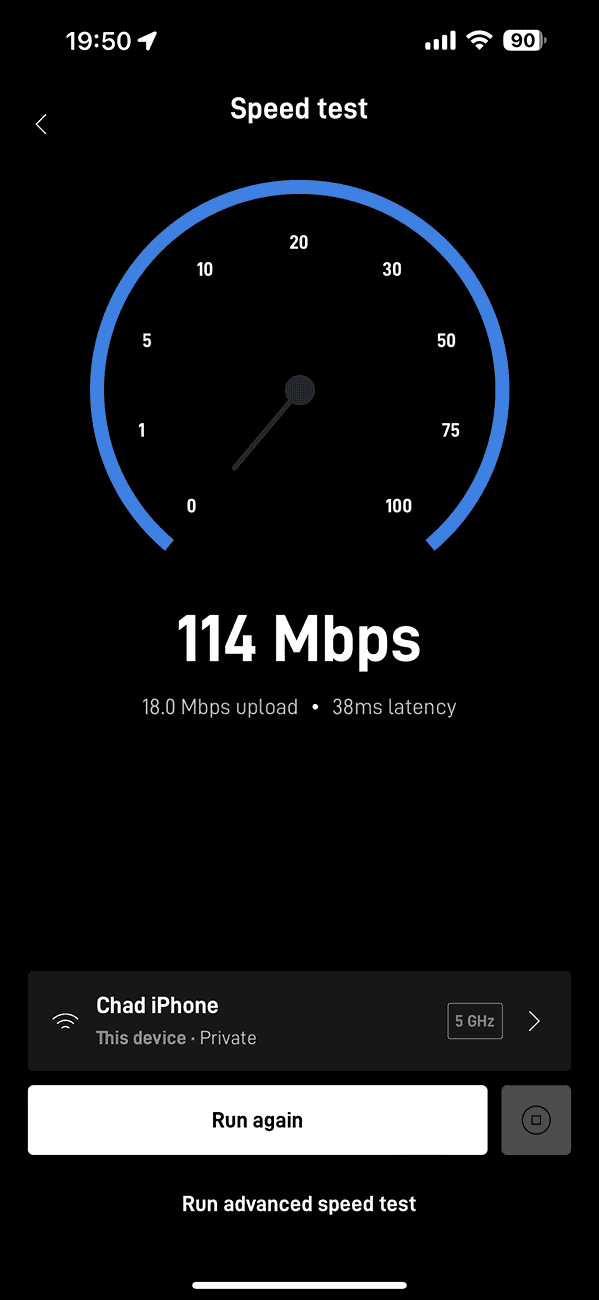

Some very quick testing yesterday proved that it is more than sufficient. This plan is also caped at a slower speed - I think it tops out at 250mbps download. But that is more than enough for emails and phone calls. It's also sufficient for work even though I have tons of data consumption. I was able to send and receive pictures yesterday, browse the internet, make a phone call, stream a small video, all without any issue. The antenna connects to the satellites significantly faster than my home 'standard' unit and has a wider FOV as well, even having two large trees blocking its optimum view, it obtained signal no problem. Overall, I think this will be plenty sufficient for my needs. And did I mention how small it is?!
I will be curious to see how this handles a heavily forested area though. That is a bit of a concern

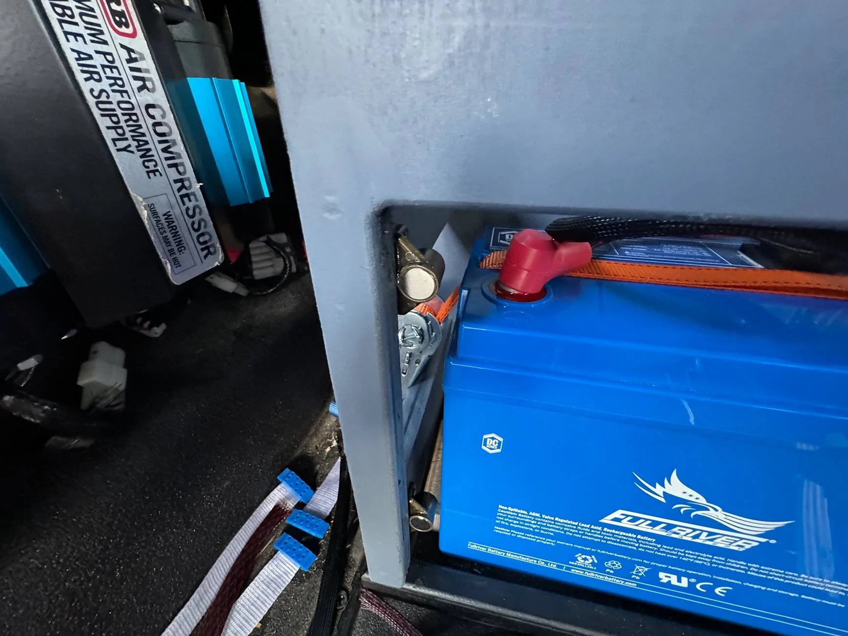

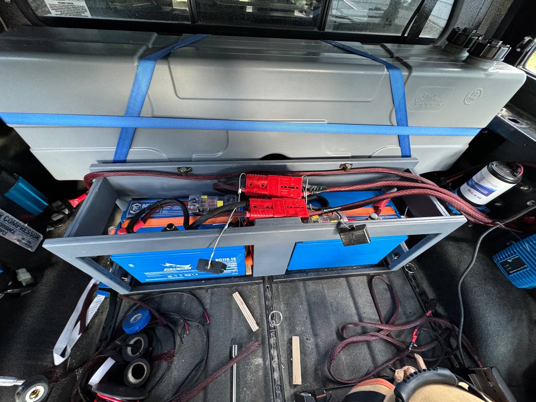

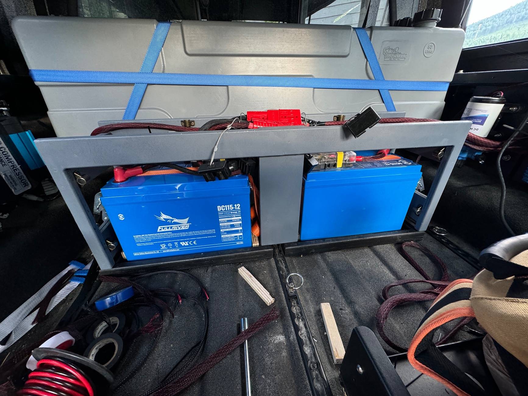

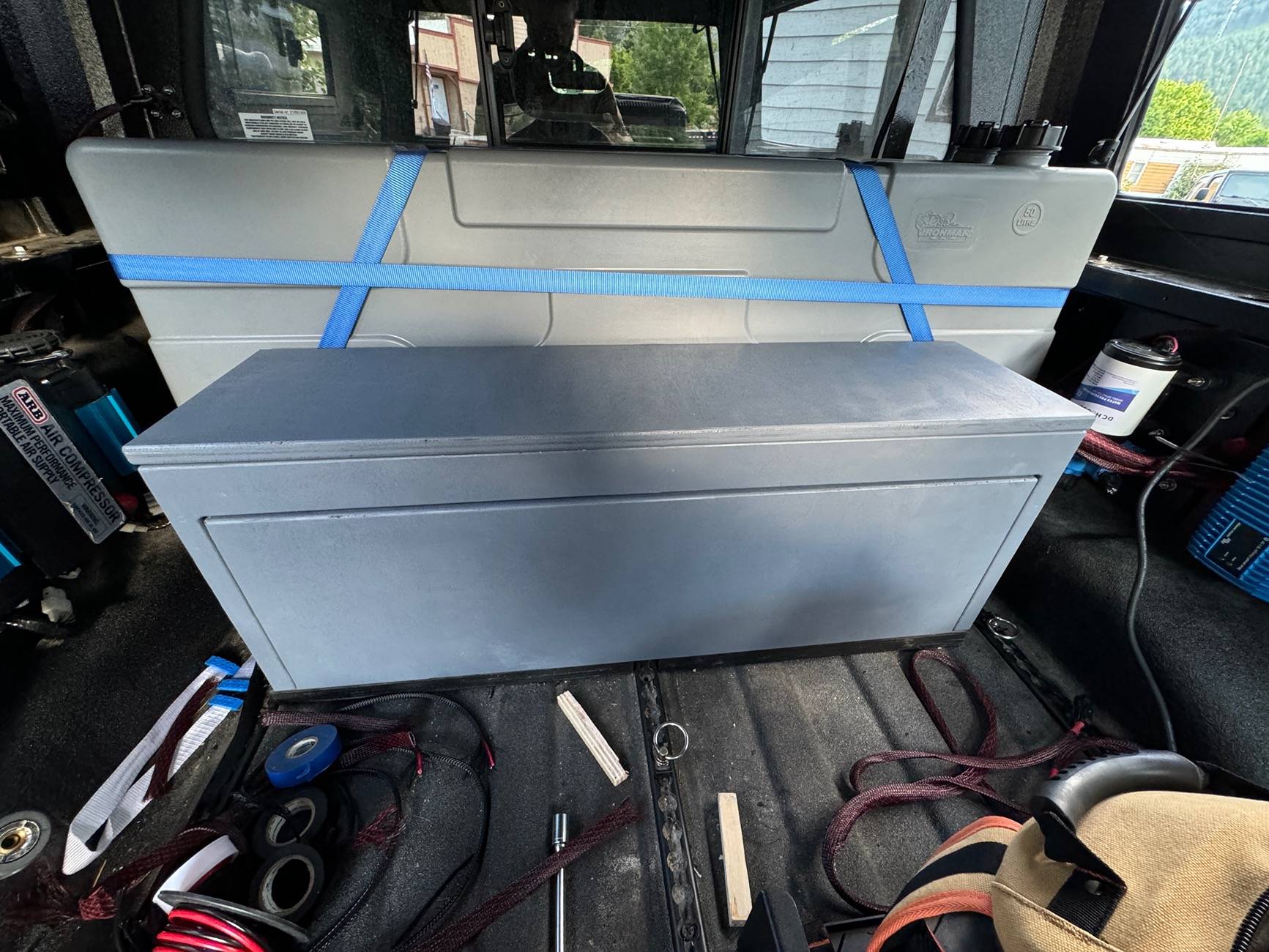

Today I was finally able to finish the battery box despite the crazy heat. I think it works out pretty well. Of course some tidying up is in order still. Because I'm not sure what, if any, changes will be made again in the future for other longer term plans, I opted to use standard birch rather than baltic since it's cheaper and readily available. I wanted to have a frame so that the batteries could be inspected and/or replaced without having to remove the entire box. Not that that is a big deal, but its nice to open things up quickly for a little inspection.
Thinking about methods to secure the lid and front panel, I chose to try some magnet latches. I do have others on hand in case these dont work, but I wanted to give them a try seeing as how there should not be a lot of force acting against the lid and front panel. Also here you can see that the tie down strap for the batteries also goes just over one of the cross braces for the frame. This occurs on the other side as well. So the battery tie down also serve to secure the box. I was hoping this would be the case, but it was by total chance as I completely failed to measure before gluing things.
Jeep Gladiator Destination Unknown - 2022 JTR journal IMG_5170
The top lid also is secured by magnets. It offers a nice pathway for wires to go. I have yet to secure said wires of course. You can see on the sides the top edge of the frame where the lid sits is about 1 1/4" higher than the side braces. This serves as a pathway for wires as well as air circulation.
All closed up the box blends in nicely with the water tanks. I considered some other colors - possibly tan, but that would be too much contrast. And I am not at all a fan of everything being black, it's too closed in and shows dirt too much. All in all I think this will do well. Tomorrow will be a good test for heat as we will have temps in the triple digits in the shade, and the inside of the canopy today was already pushing 115. I might opt to shut everything down to keep it cool in there.
