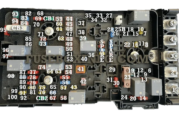

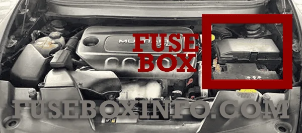

This is my issue. I'm convinced because I'm getting the error now even with nothing plugged in. Which fuse or fuses shouldI pull for 2020 Jeep Gladiator? I looked at fuse map and I'm lost not my expertise..thanks
