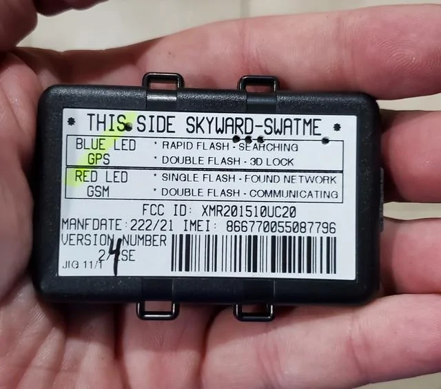

Yep, I had one (silent one) in the JT despite declining the tracking service from dealer. Only reason I found it, was the knee panel was loose, and I saw the device when I popped it off to re-align and install the panel.
Funny thing, is out 2005 TJ had a lo-jack in it too, found it very well hidden behind the glove compartment when I removed the dash to replace the heater core. We have had that Jeep since new from the dealer.
40,514
54,050
Obviously some dealers install GPS devices on all vehicles that come off the transport to their location.

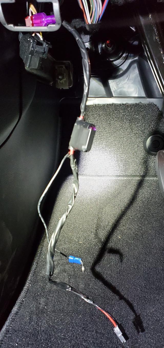

Mine was ordered by me, prepped for me, never sitting on their lot and the papers were all already signed. All I had to do was go in and give them the money and perhaps sign a final paper or two accepting the vehicle. And yet there it was - up under the dash, strapped to the large wire bundle on the far left side.
It was connected only to power and ground of the OBD harness via a piggy-back. No splicing. They pulled the OBD connector out of the bracket, plugged this device into that OBD connector, then the device connector was plugged back into the bracket. Took seconds to take it out and thankfully no wires tapped or poked. I'd have been really unhappy if they had poked any wire. I am a strong believer in wire integrity and get PO'd when someone uses a "tap" and punctures insulation in any way.
Mine was simple GPS and had a SIM card in it.

Freaking LOL @ this wiring job:
Jeep Gladiator Did you buy a new Gladiator and it makes "pew pew pew" noises at startup and other random times? 20211109-165522
Jeep Gladiator Did you buy a new Gladiator and it makes "pew pew pew" noises at startup and other random times? 20211109-163927
Is the OBDII harness just a pigtail I can disconnect further up? Not sure what I can do about the vampire tap. Maybe build a "dummy" spade connector and just insulate the tab on the tap.
OH - the "This Side Skyward" was oriented towards the passenger side. Dealers charge $1,000 for this crap if you "Accept" it. Feel bad for people.
