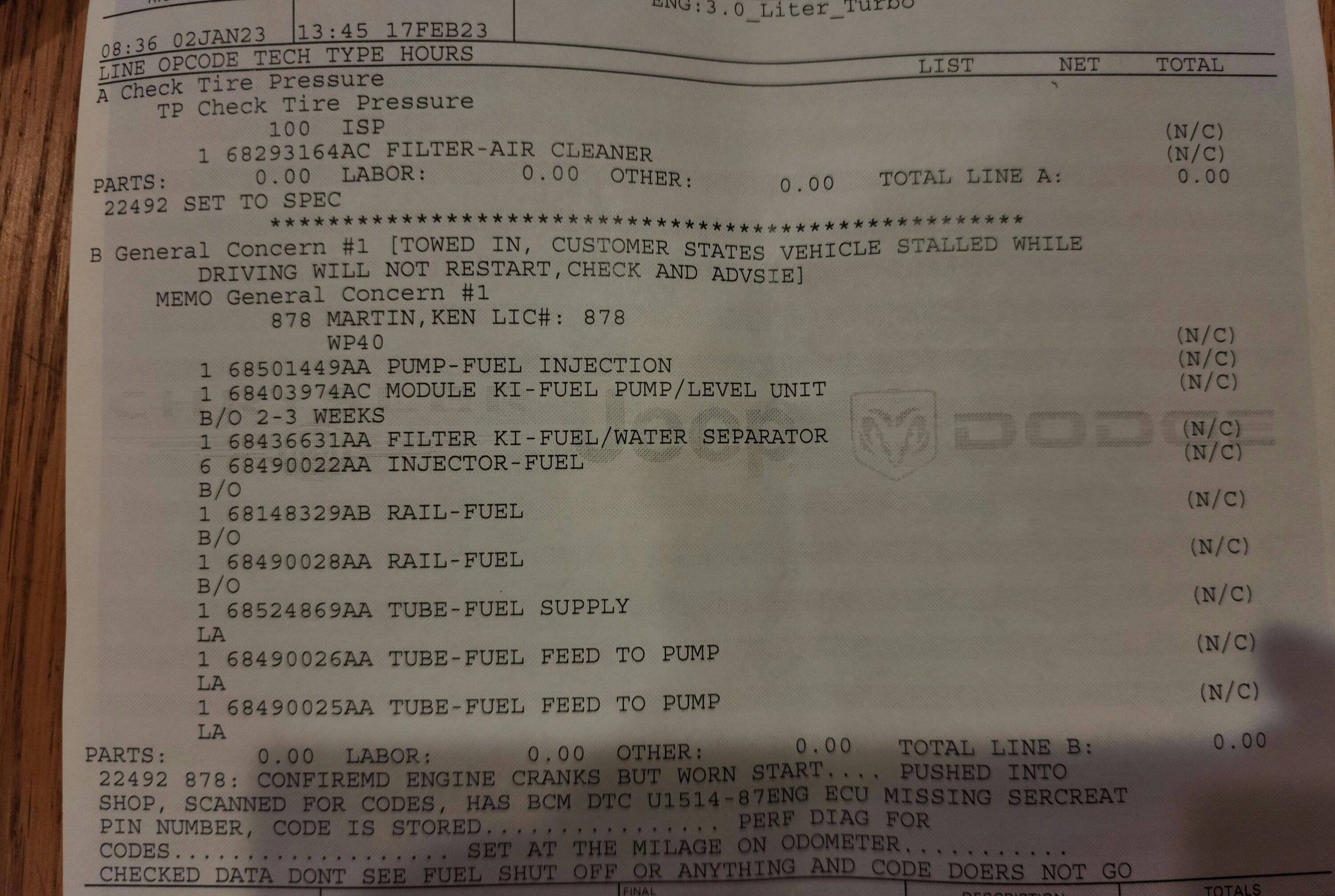

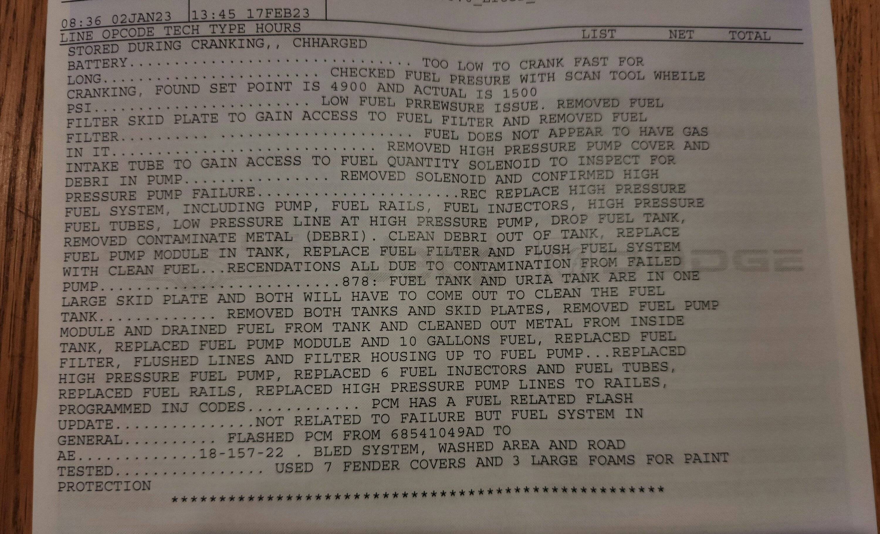

Well finally got my gladiator back. But of course they forgot to put the engine cover back on it, so now have to go back tomorrow to get it put on. For anyone curious here is the write up with the part numbers
Jeep Gladiator Diesel Died 20230217_174809
So they replaced it with the exact same thing that blew up. What's the definition of crazy again ?

Well that lasted less than 24 hours. Picked it up on Friday evening and went to drive to the store Saturday morning and when I get back home it was pissing diesel all over the engine and my driveway.... had it towed back to the dealer and they are supposed to get a new tech on it first thing Monday morning according to the service manager. Plus their "master master tech" forgot to put the engine cover back after they approved that the work was completed and ready to be released.
Hopefully jeep approves my request to extend my warranty since they replaced the fuel pump with the same CP4 pump and the dealer screwed up.

Picked up my gladiator again this afternoon. Tech found that one of the fuel injectors was leaking at the base and faulty from the supplier. They ended up replacing the leaky injector and tested drove it several times and no leaks. Fingers crossed that is the last of it. Got 37s arriving tomorrow that I'm looking forward to installing!
