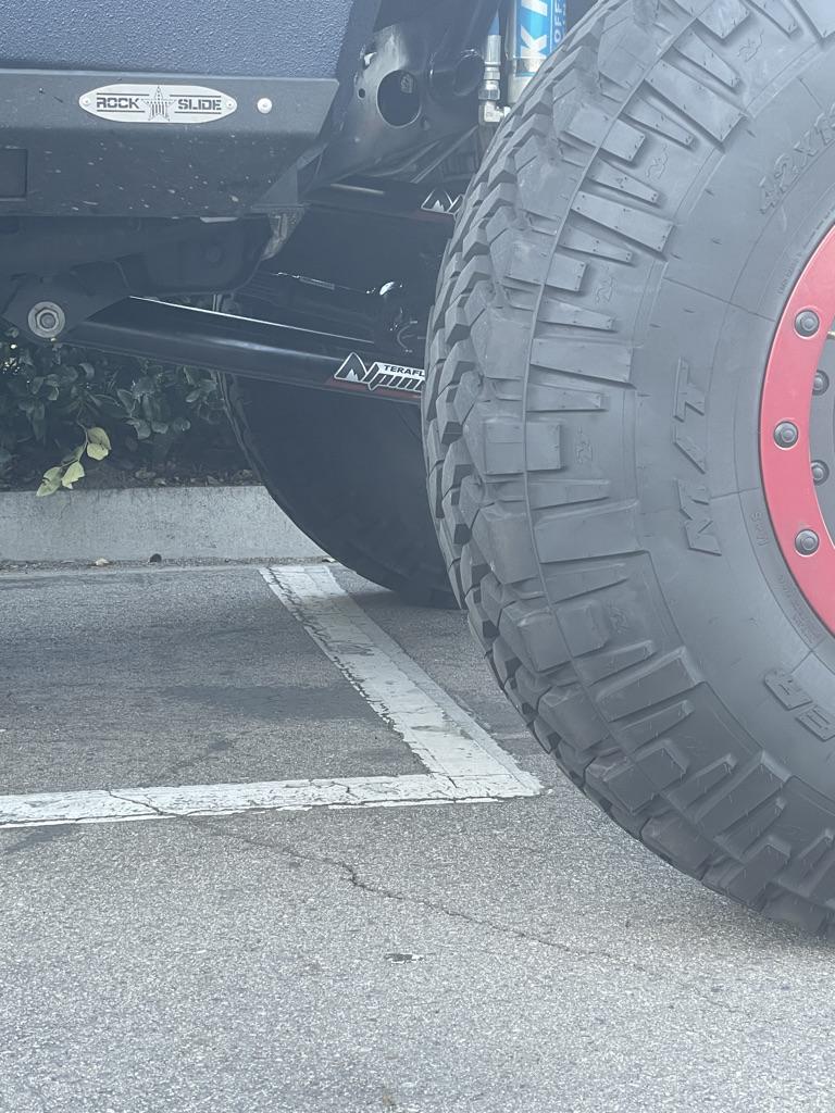

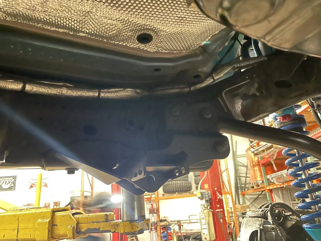

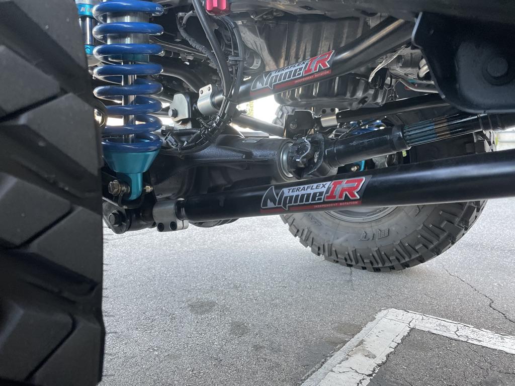

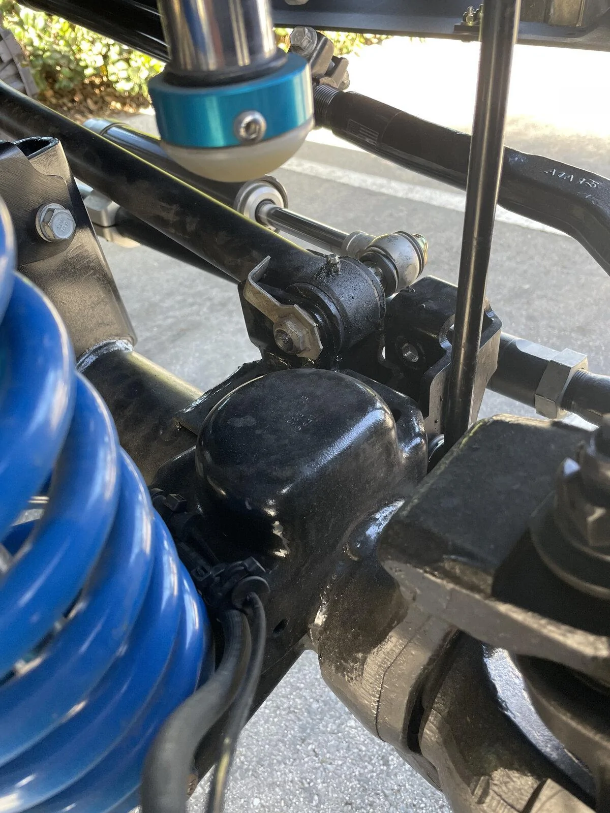

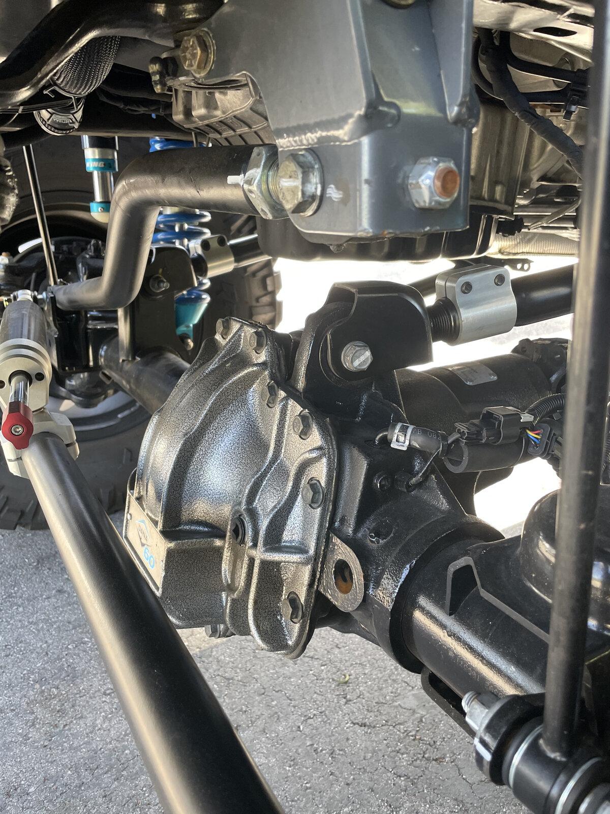

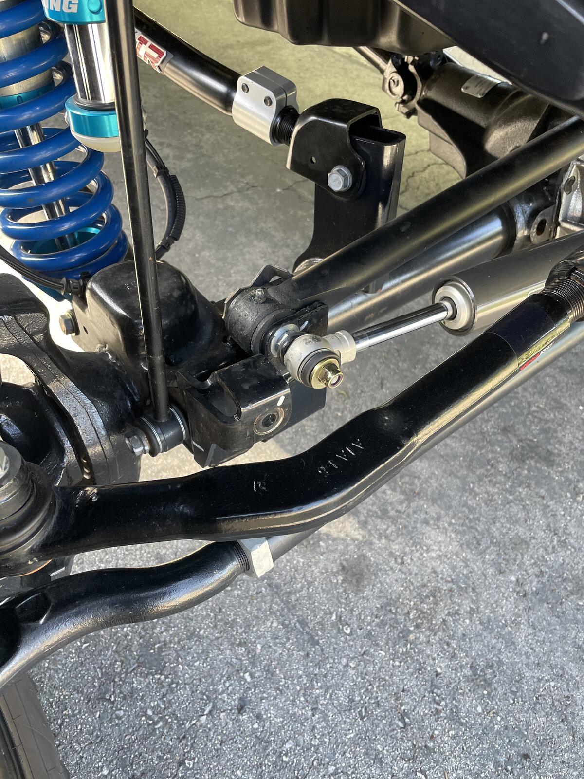

Teraflex IR Long Arms finally in. 3 days to make sure its all in correctly. Had to remove way more than the JT Gas I had. Time to dial it in and report back. Zero rubbing on the 42s now. Axel is about 3 inches more forward. We could not go more as the bump stops are at the edge of the old spring platform at full flex.
Jeep Gladiator Diesel Front Long Arm Install - Day 3 9C87C8C2-862A-4956-8BE7-920DB51A54D5_1_105_c
Jeep Gladiator Diesel Front Long Arm Install - Day 3 FDE36B1F-9546-4F04-9481-C3738326EFFB_1_105_c
Jeep Gladiator Diesel Front Long Arm Install - Day 3 750E5CA9-C365-4ABA-B443-4A5FF402BE72_1_105_c

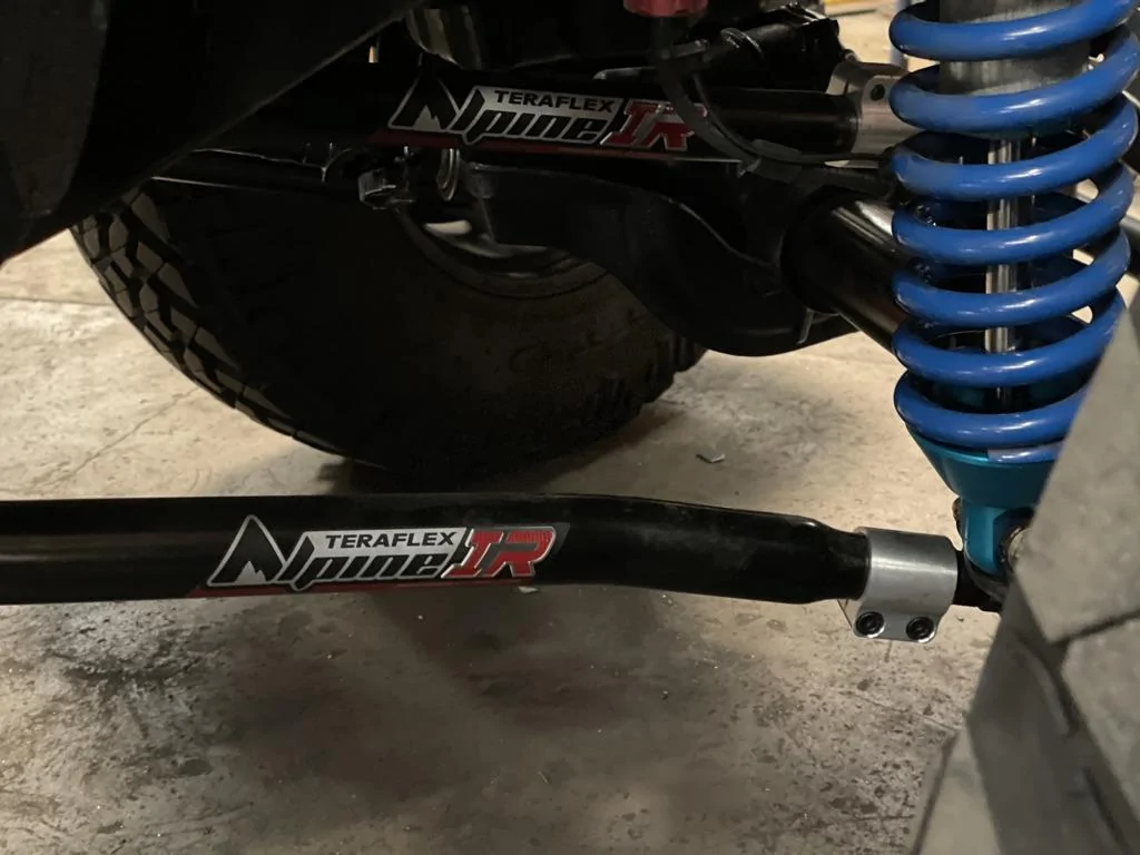

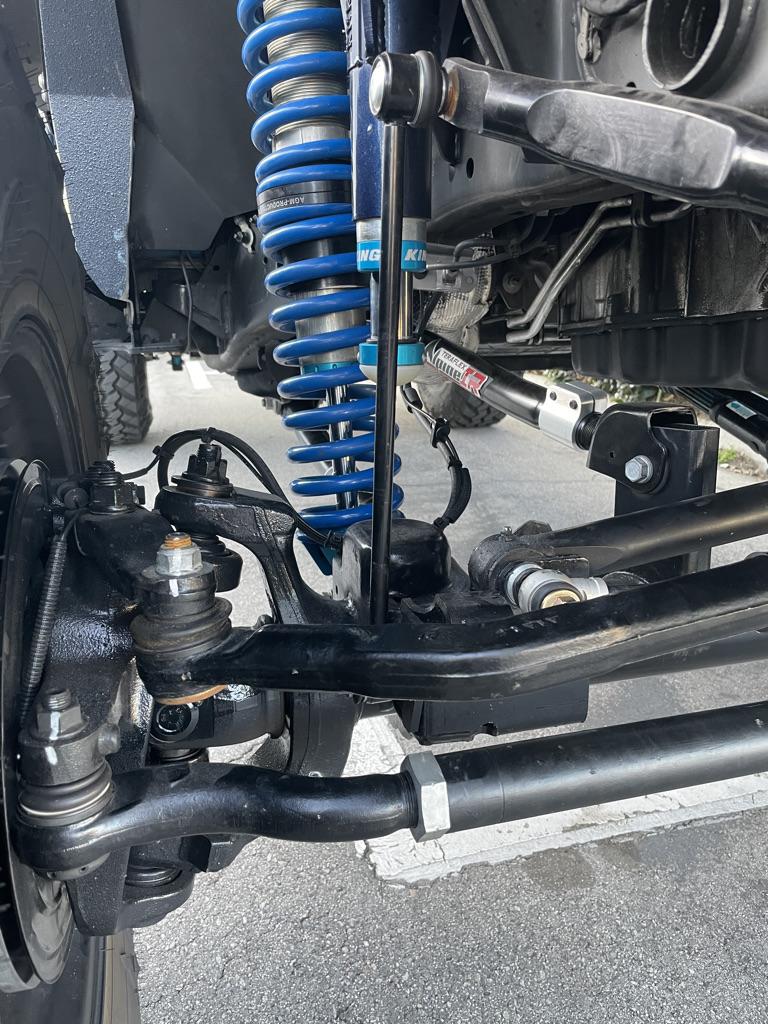

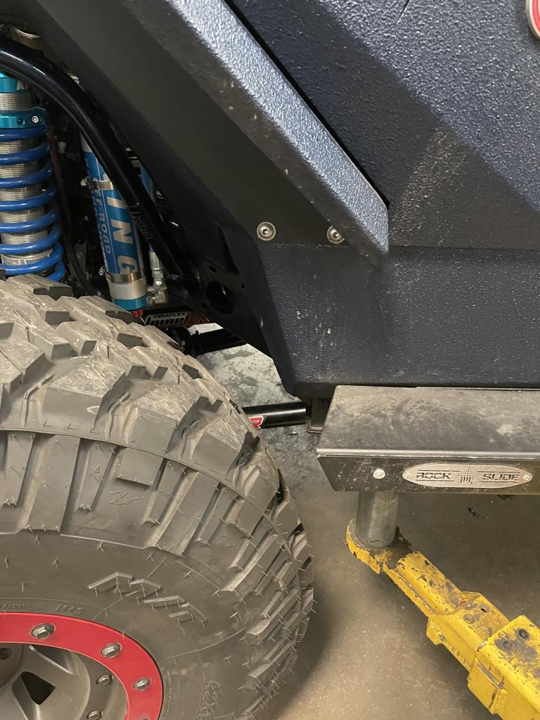

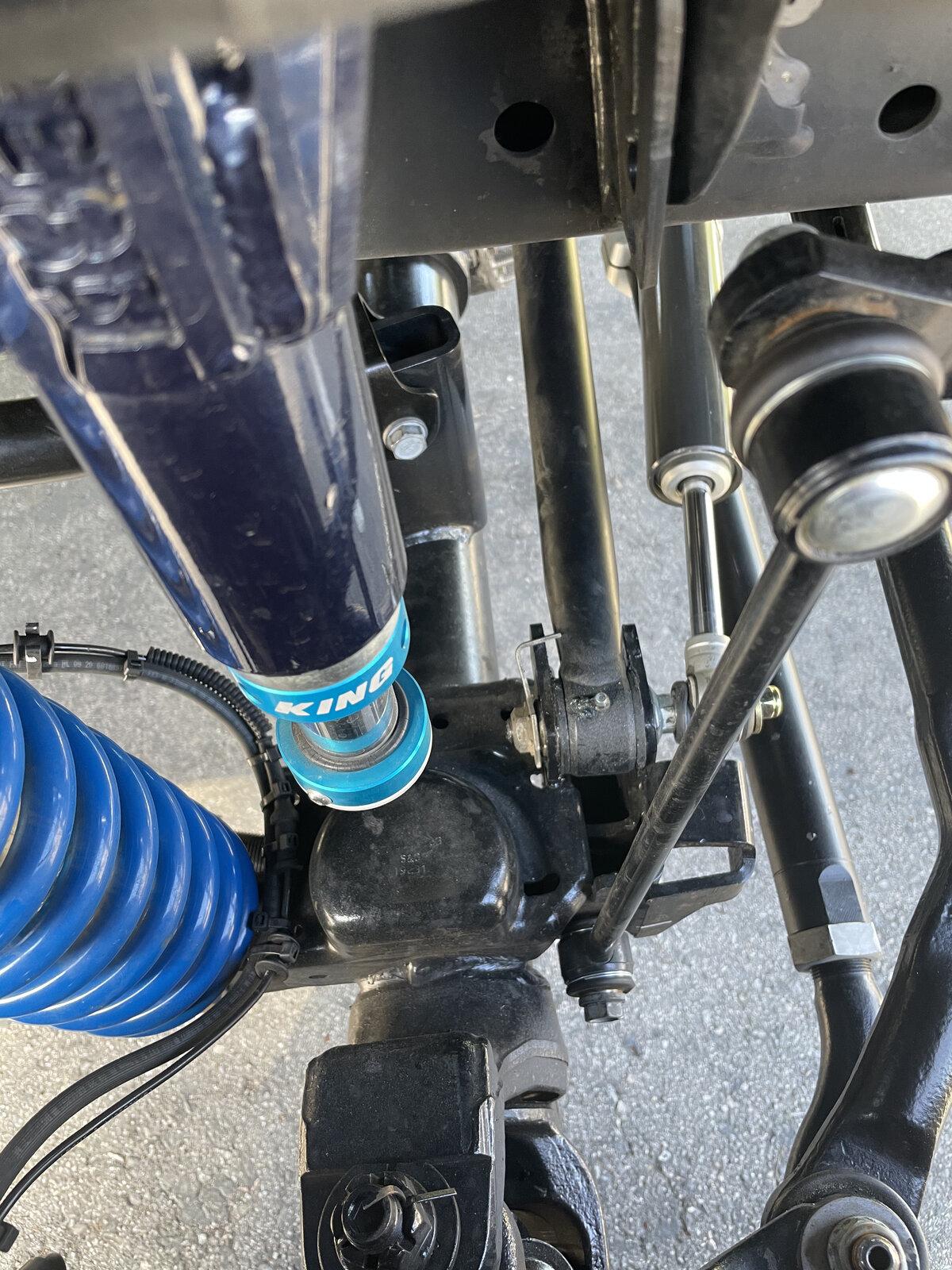

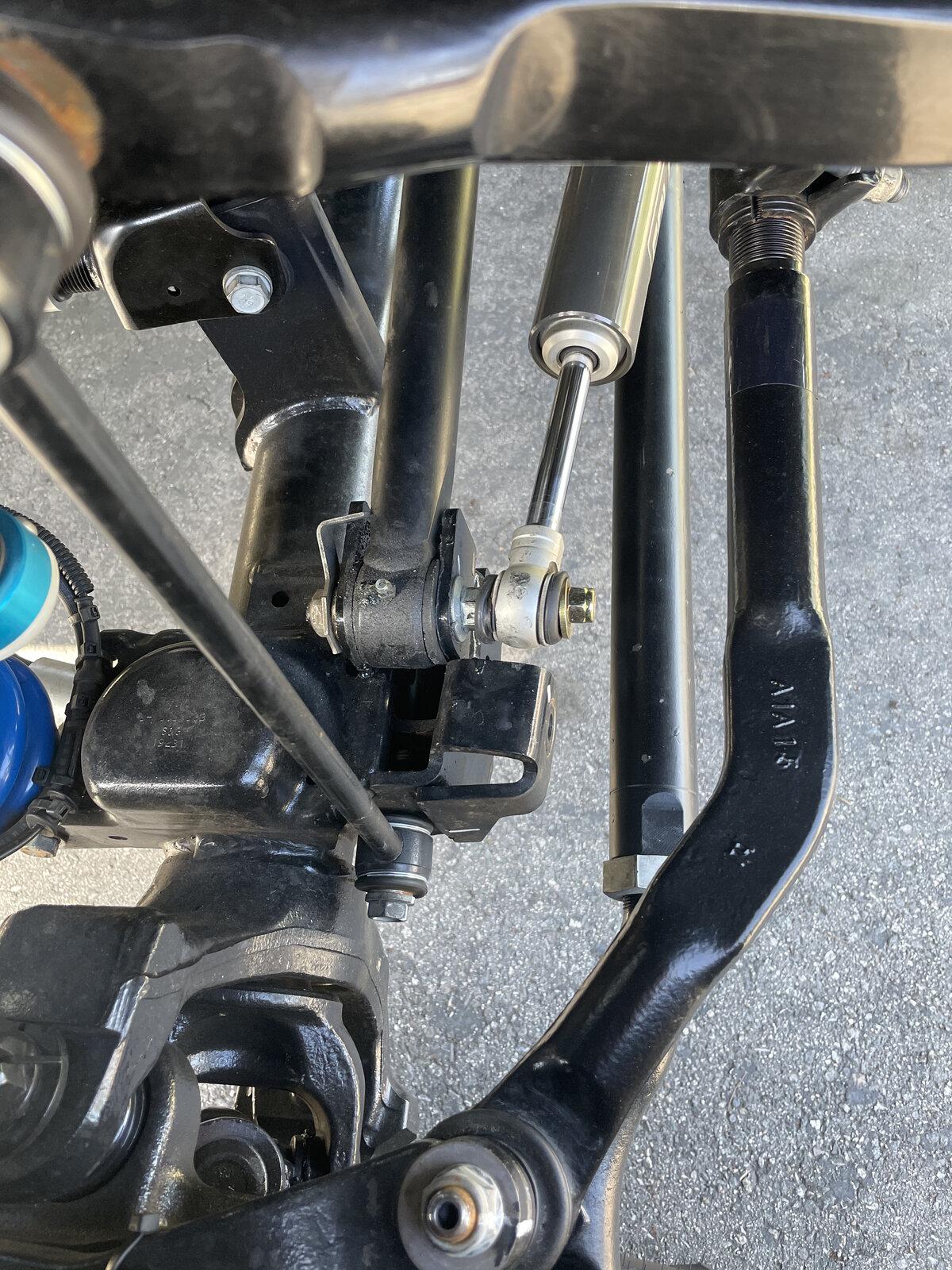

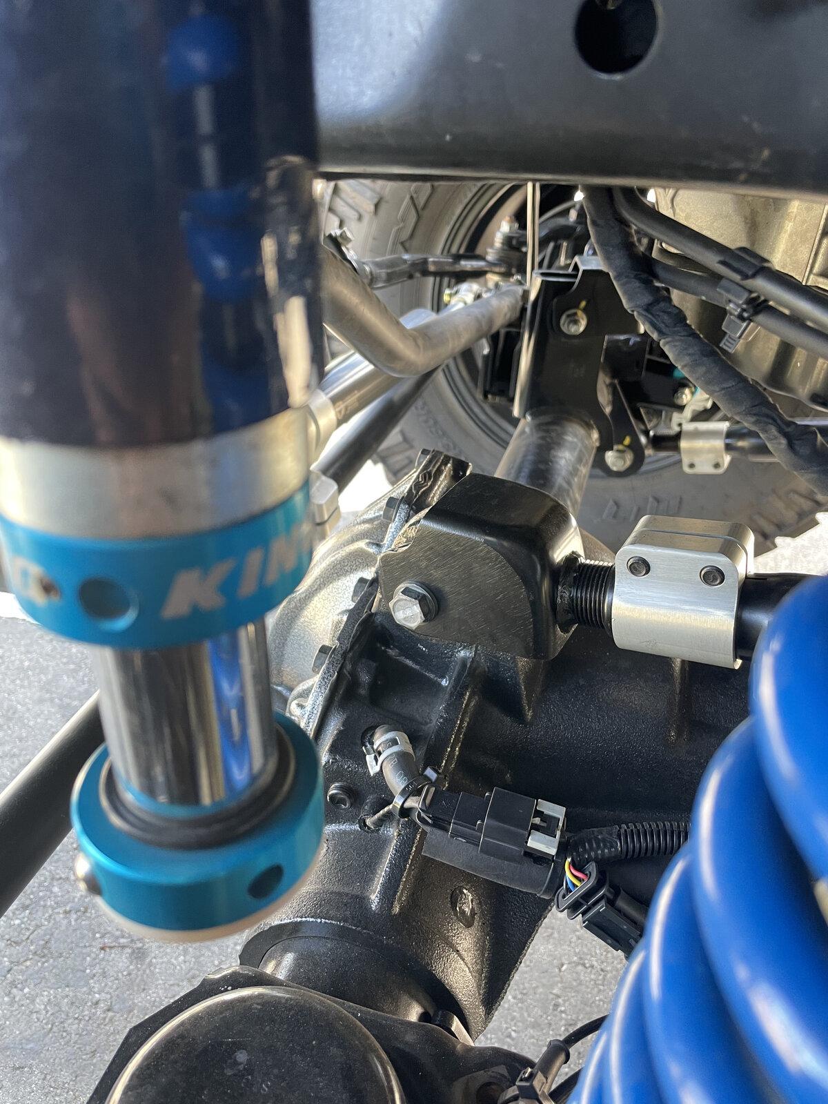

Update. All done. Really improved the road bumps. Will be trailing it this weekend.
Jeep Gladiator Diesel Front Long Arm Install - Day 3 A578F57C-C577-4E11-A083-E5C766A52762_1_105_c
Jeep Gladiator Diesel Front Long Arm Install - Day 3 099B33E5-EBF8-4FD8-B529-95893AA39F83_1_105_c
Jeep Gladiator Diesel Front Long Arm Install - Day 3 9DB48391-CDCB-42B6-9EFF-9E761F9F2096_1_105_c

Did you have to relocate the frame side trackbar mount with pushing the axle forward 3"?
Small adjustment yes. I’ll try and take better pictures tomorrow
