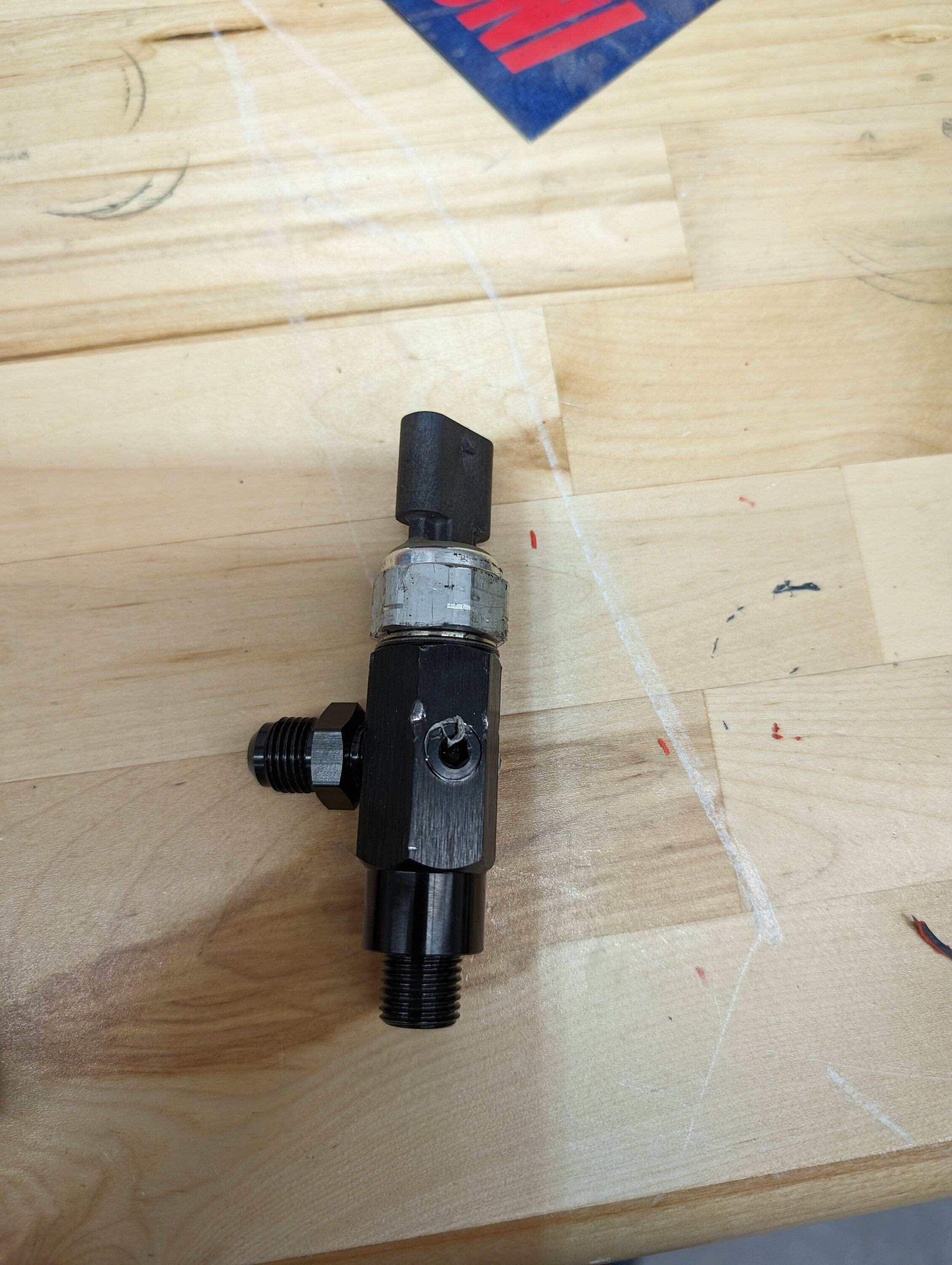

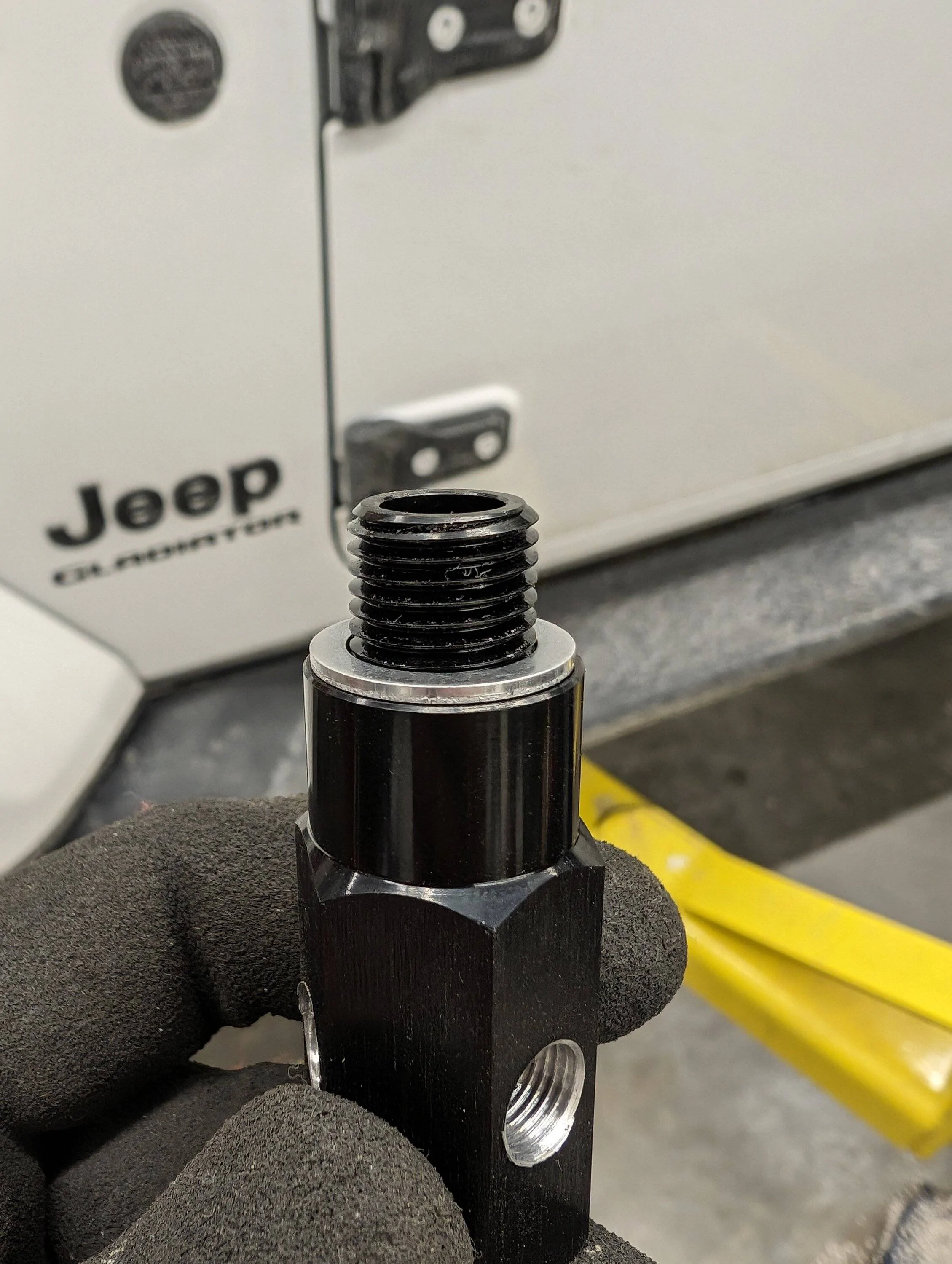

I didn't like the oil filter supply tap so I decided on the pressure sender tap. This is a cleaner install IMHO. However, the elbow fitting included with the tap kit doesn't fit within the available space. Based on the photos in their install guide, the housing must be different in the Ram.
I ordered a 1/8 npt to 6an adapter to tee off the oil sender adapter (shown below). My fitting should be on Tuesday, and I will update the this thread as soon as I finish.

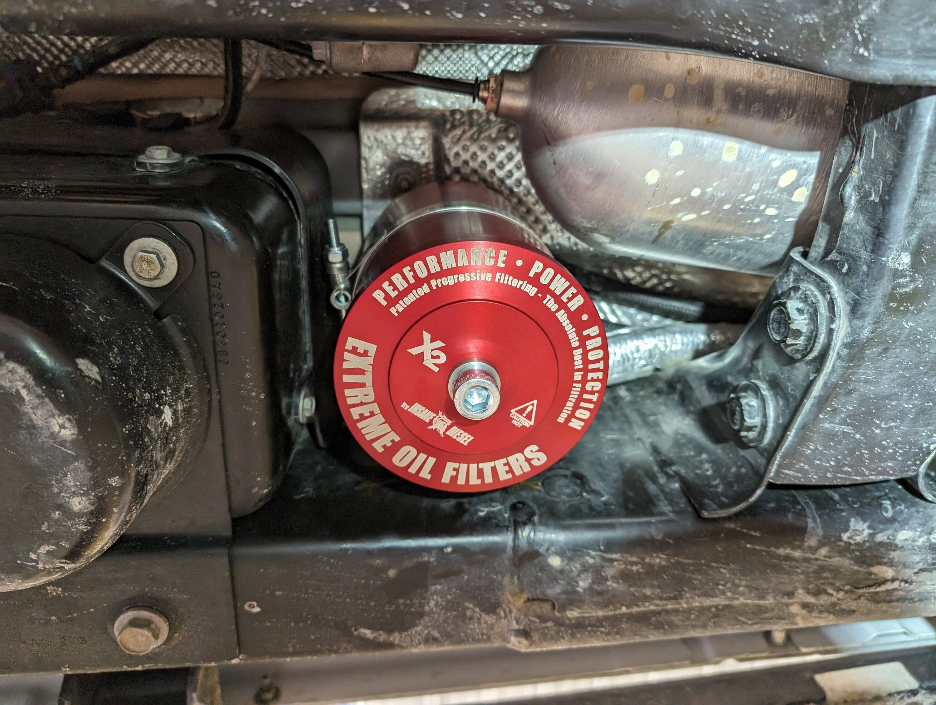

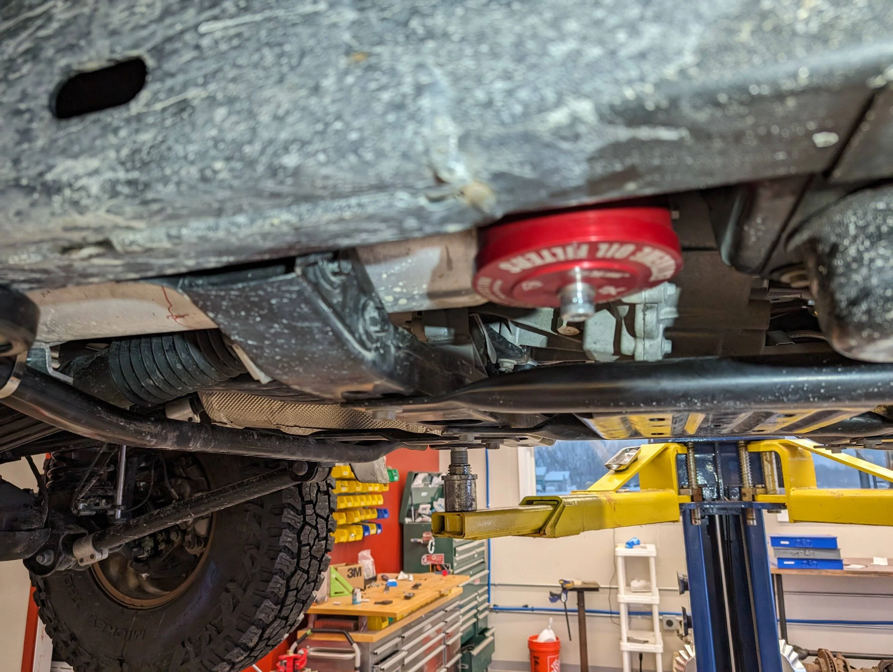

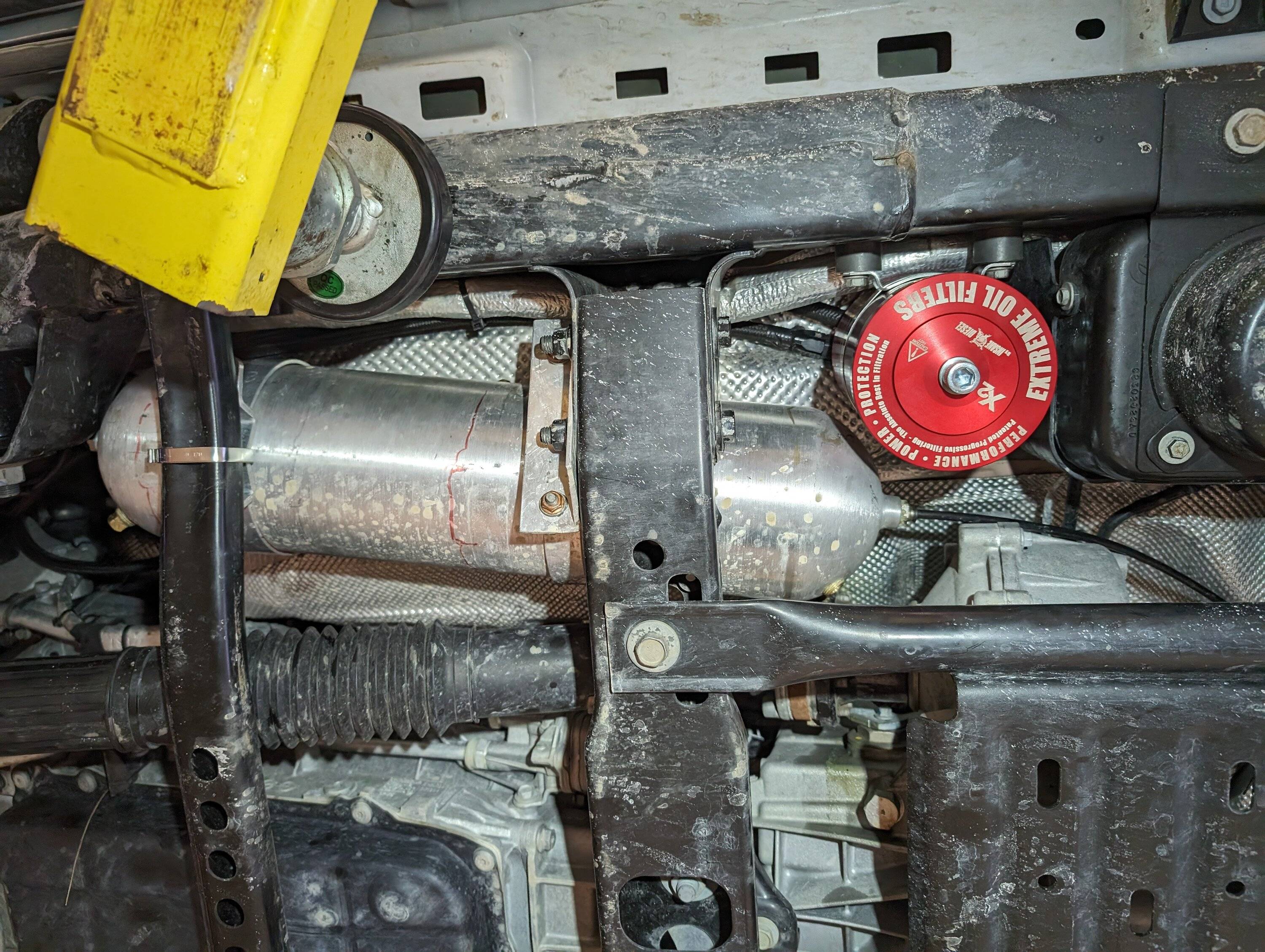

I have onboard air with a tank on the driver side, this prevented me from installing the bypass filter where I wanted. I used a Moroso 23920 accumulator mount to hold the bypass filter and bolted the mount to the frame. I tapped the frame and mounted with M6 bolts. The oil filter sits higher than the fuel filter skid plate but I realize it may be too exposed for some people. For my purposes, it is suitable.
I was initially concerned about the wall thickness of the frame but I think it will be fine. I ran the 6AN oil lines along the brake lines to the engine bay.

Oil sender Adapter

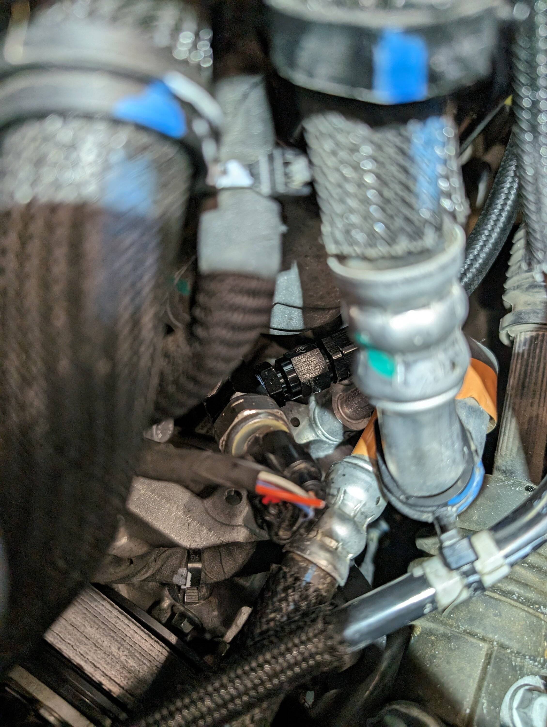

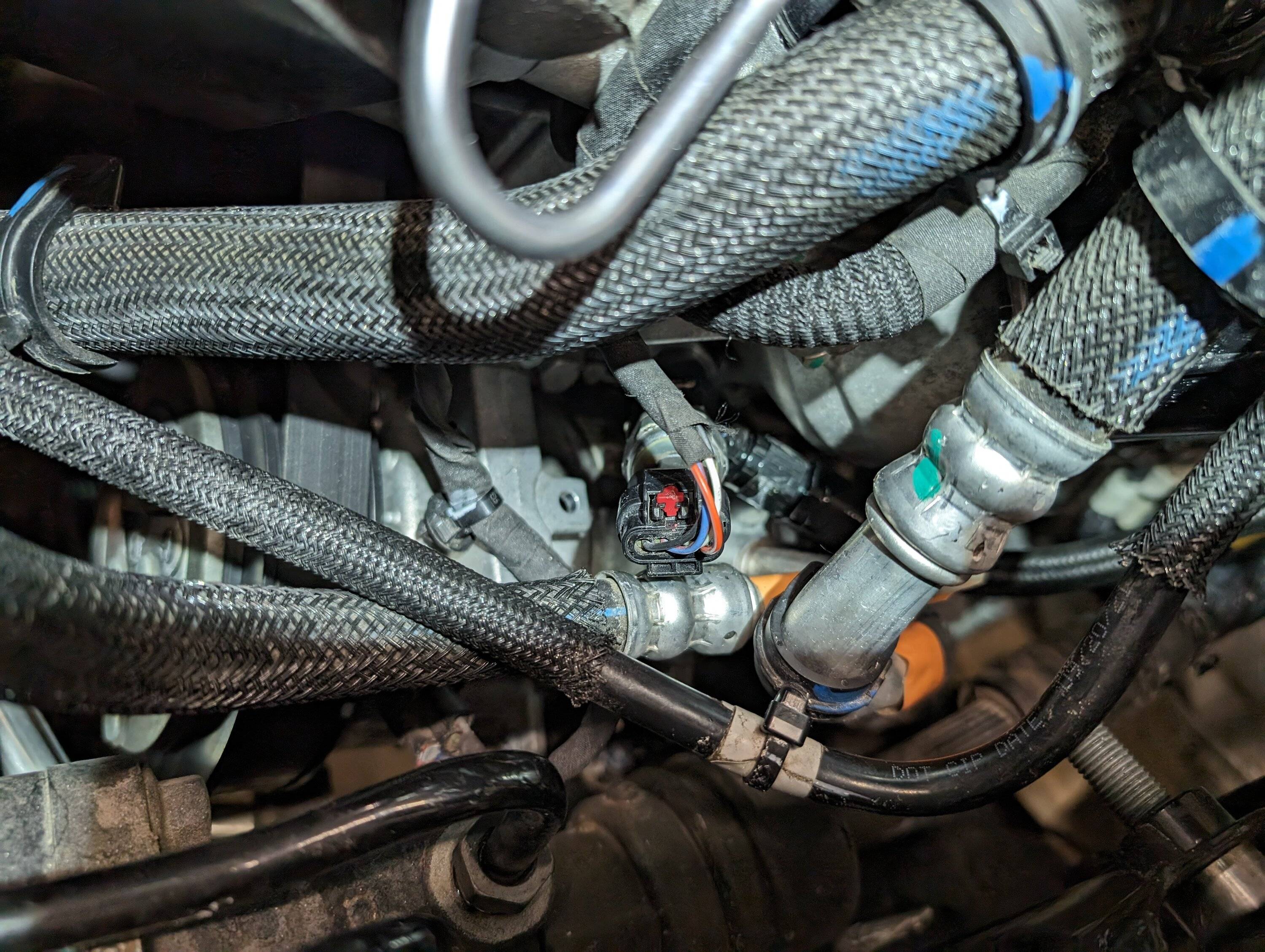

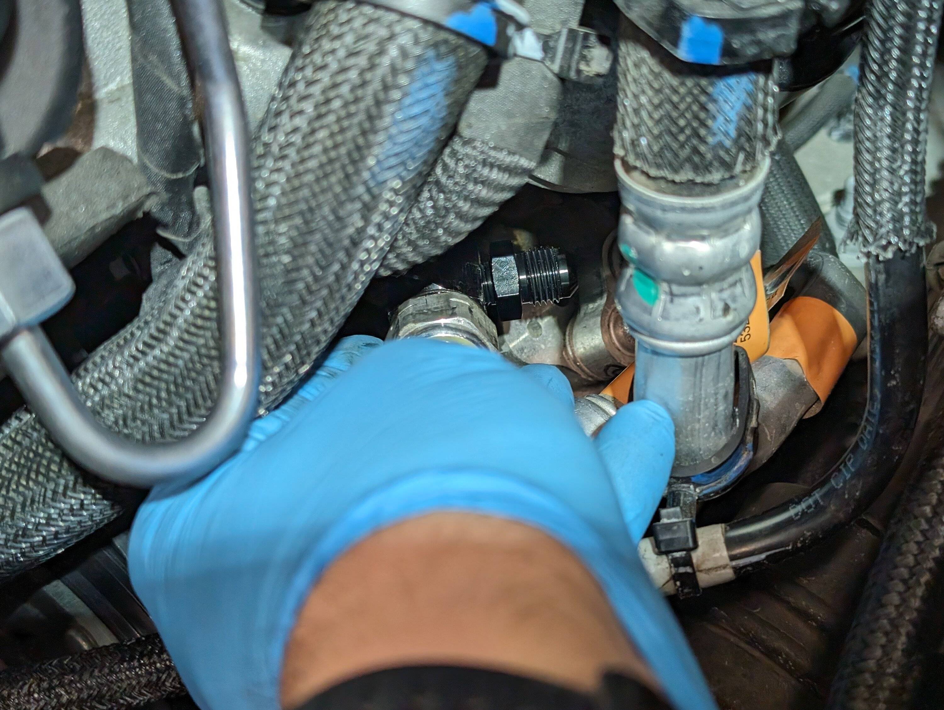

I completed the installation. The installation required more 6 an hose and a 1/8" NPT to 6 AN fitting for the pressure sender tap. The system functions without leaking (so far). I don't expect leaking from the pressure sender tap or hose ends since these are all standard "NPT" or "AN" hardware.
I used about 6' of hose for each of the feed and return. If the filter was closer to the engine, I wouldn't have required more hose. I ended up using about 2 additional quarts of oil.
Oil sender tap fitting with 1/8" NPT x 6AN fitting

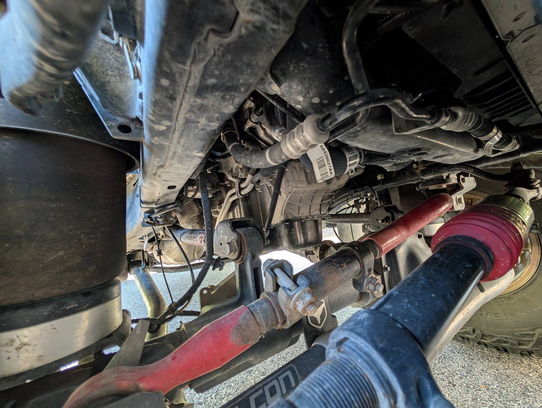

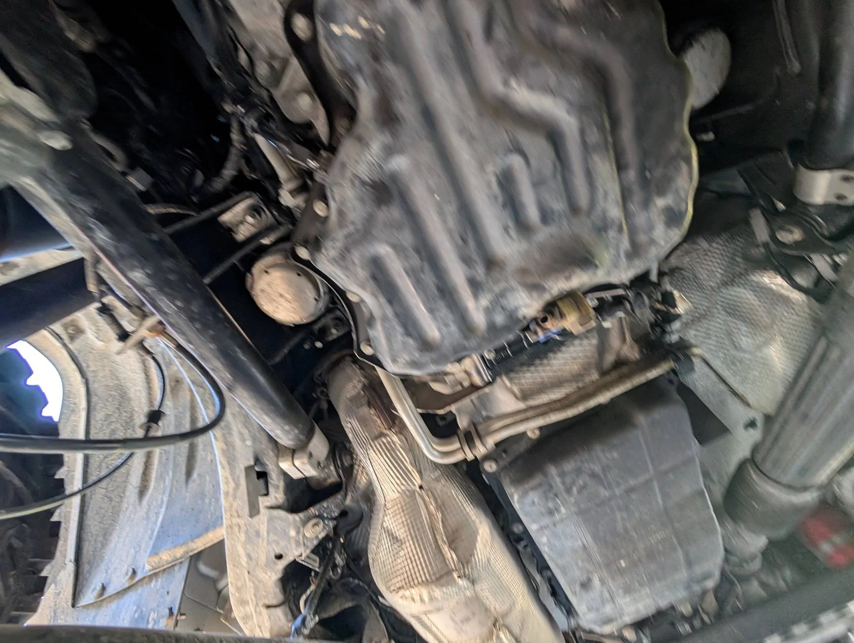

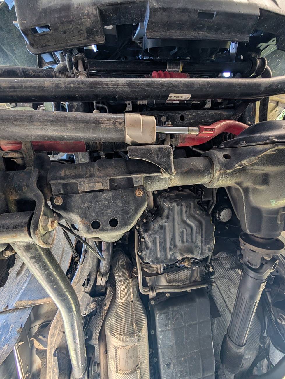

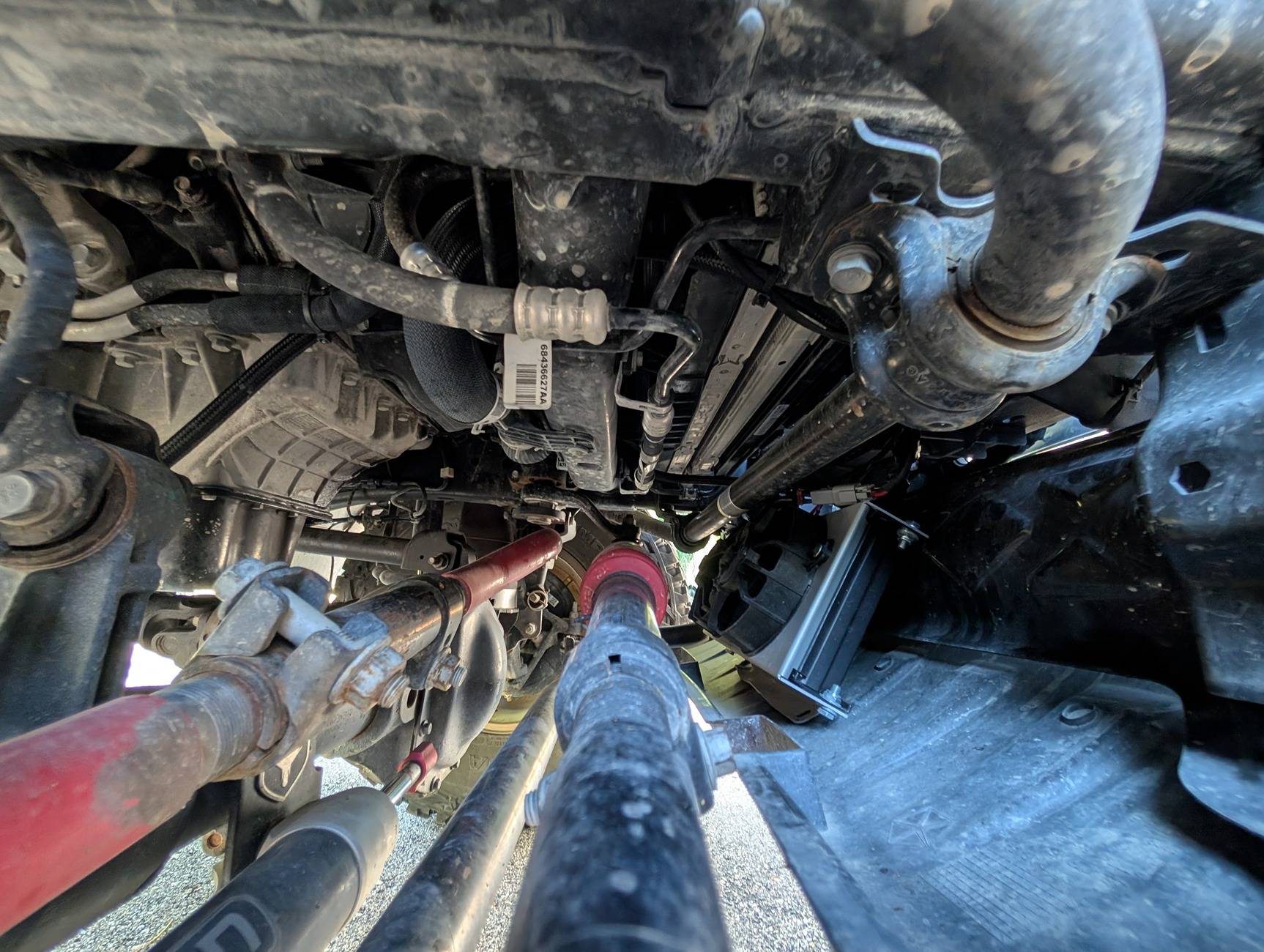

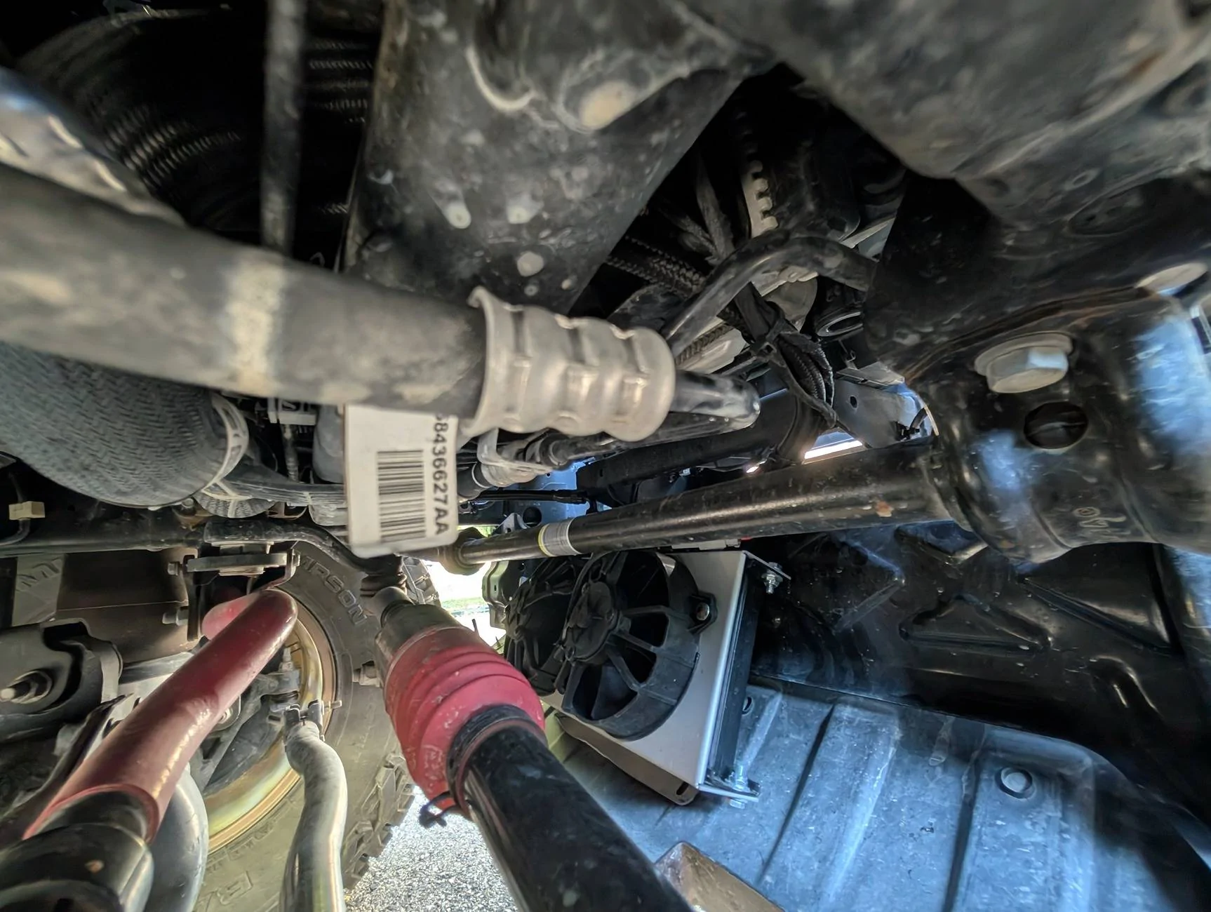

I did install the oil cooler from Insane Diesel. I have found the oil to run much cooler. In normal driving, the oil runs 2 - 7 degrees hotter than the coolant. It's as much as 15 degrees hotter when I'm pushing the truck in hot weather. Since installing the cooler, I have not experienced power derating, and temp recovery is much faster.

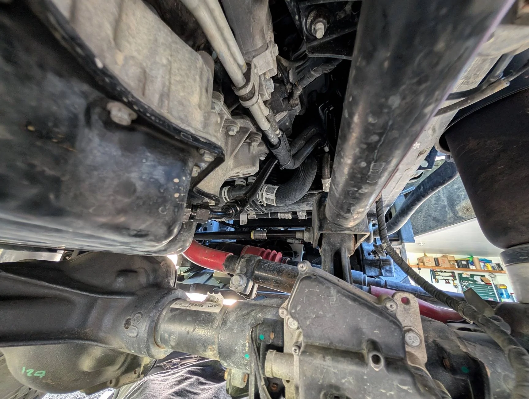

Here are some photos, the first two show the placement of the cooler and the second three show the routing of the return line. I'm dumping the oil into the sump.

I’m thinking of going this route. I’m not trying to be a wise guy, but wouldn’t that location of the cooler get full of mud or if it tried to run when under water possibly crash it?

The system has been working well for me, there are no leaks. There are times where I wish I would have removed the factory coolant based exchanger and plumbed the air cooled oil cooler from there. But besides that I have no complaints with the bypass filter or oil cooler.
