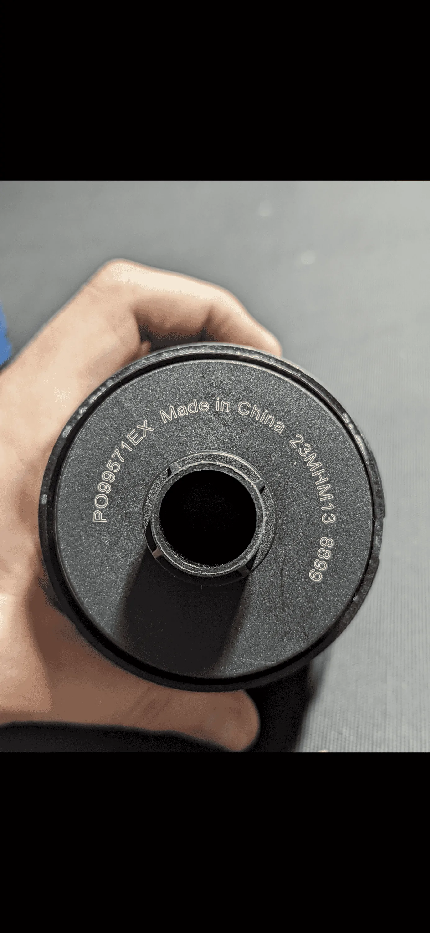

Well, I bought the second filter offered from rockauto this time around. $1 more than the economy listed one. 25$ plus shipping. PO99571EX

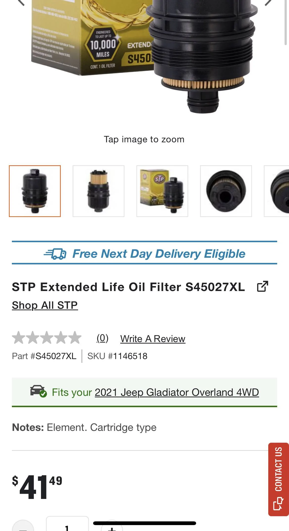

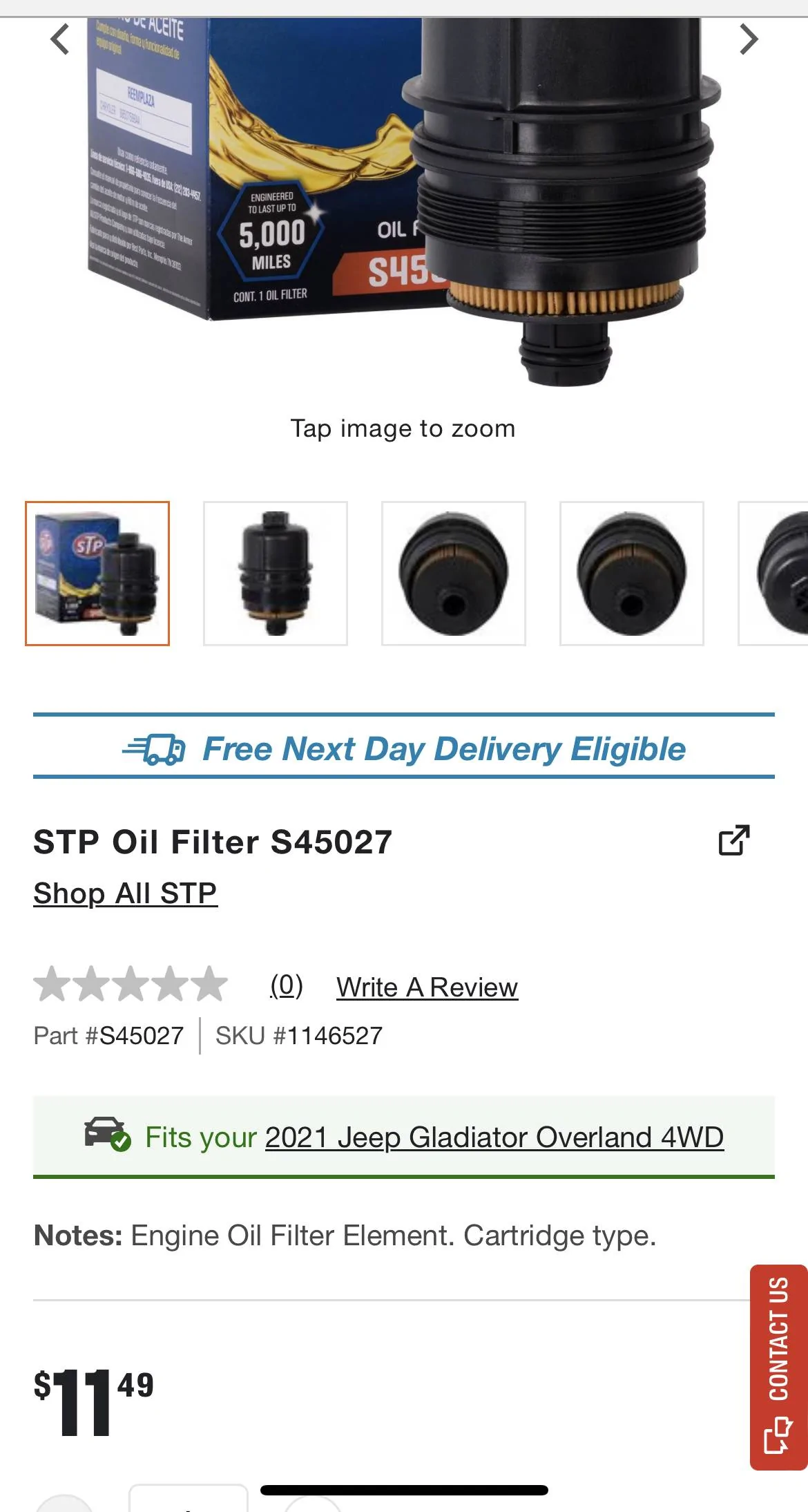

https://www.autozone.com/filters-an...extended-life-oil-filter-s45027xl/1146518_0_0
STP Extended Life Oil Filter S45027XL
Looks like Autozone is the only one that carries these. They also carry STP air filter and cabin filter.
Maybe we will start seeing more alternate brands start selling these filters too.

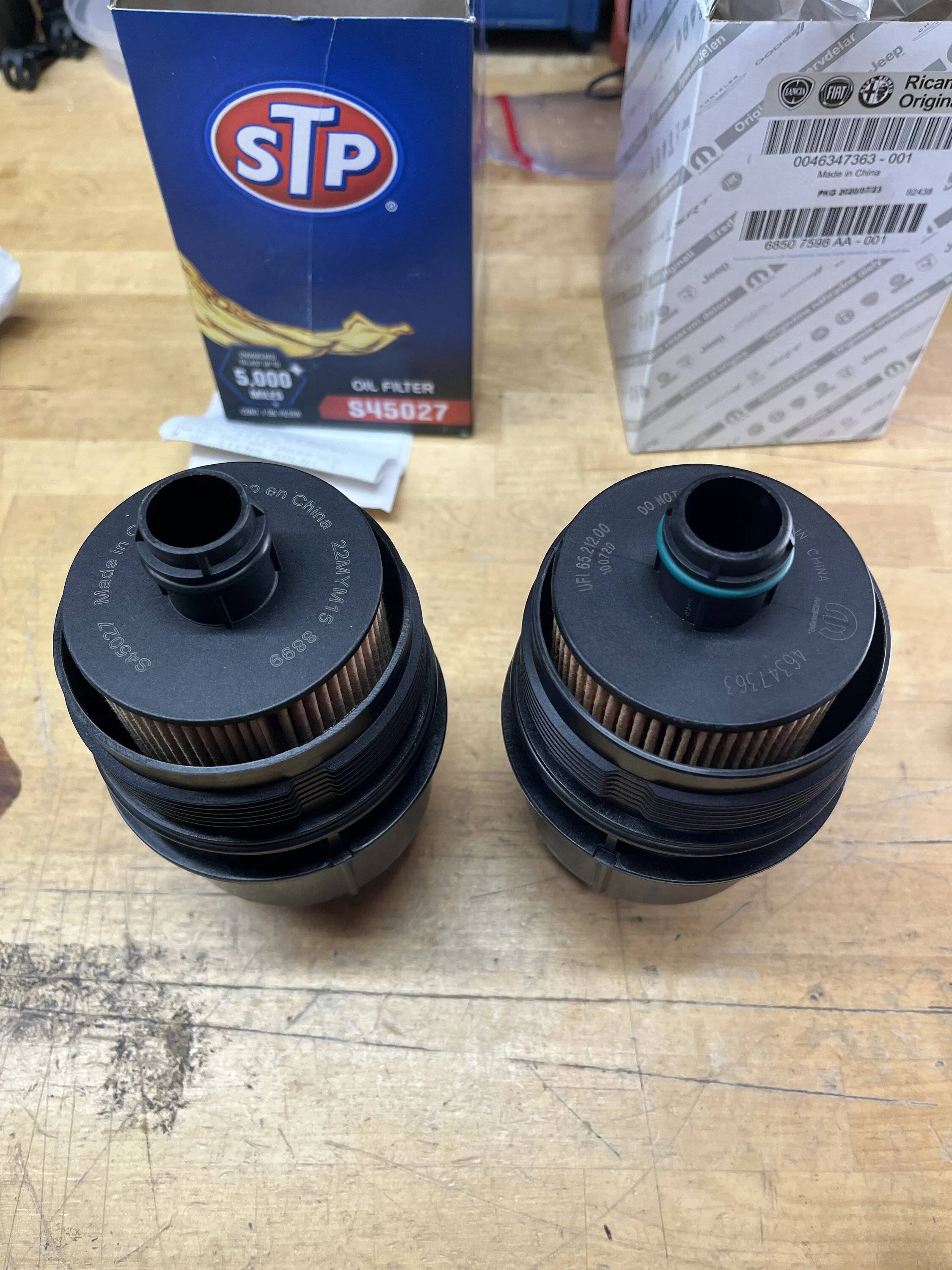

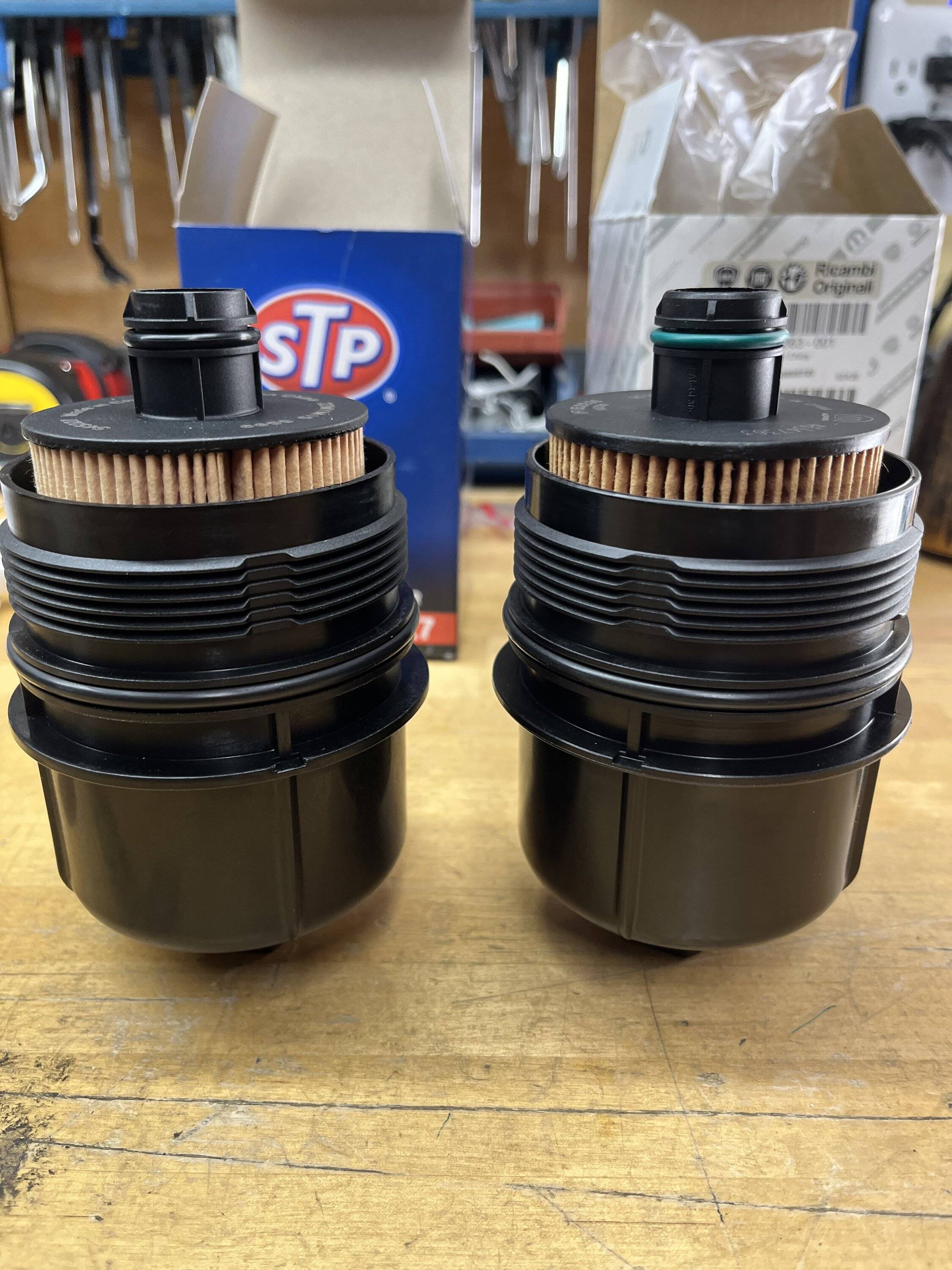

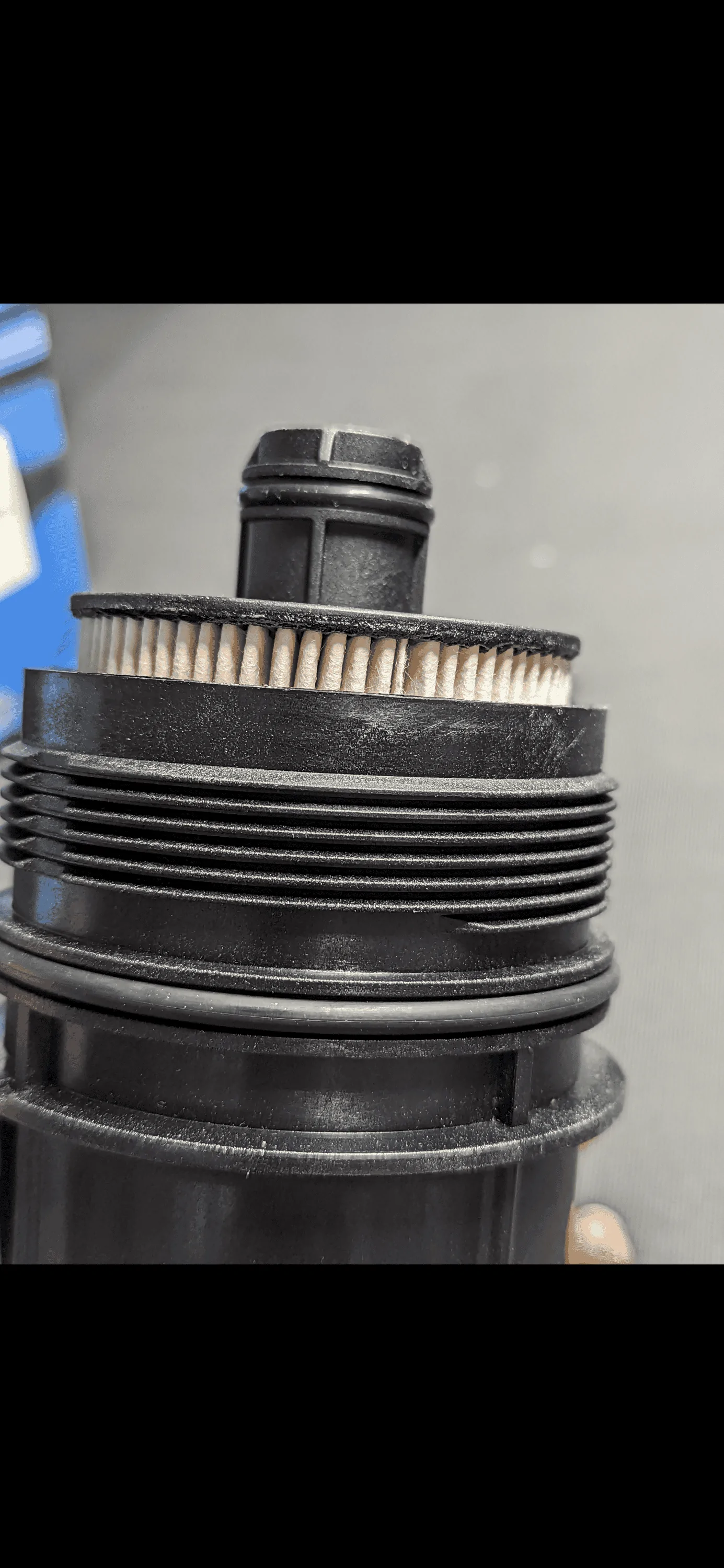

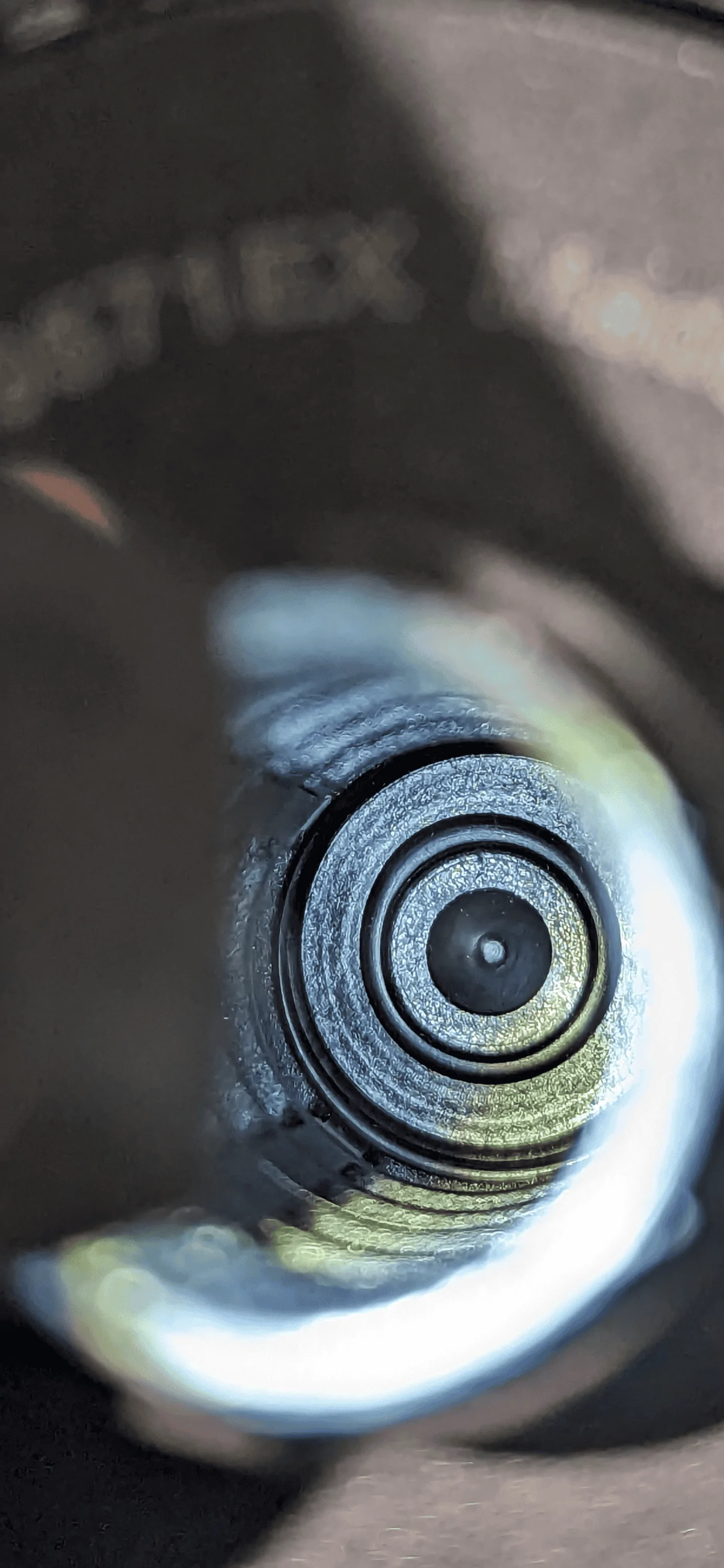

The $11 STP markings looks very similar to the Pronto.

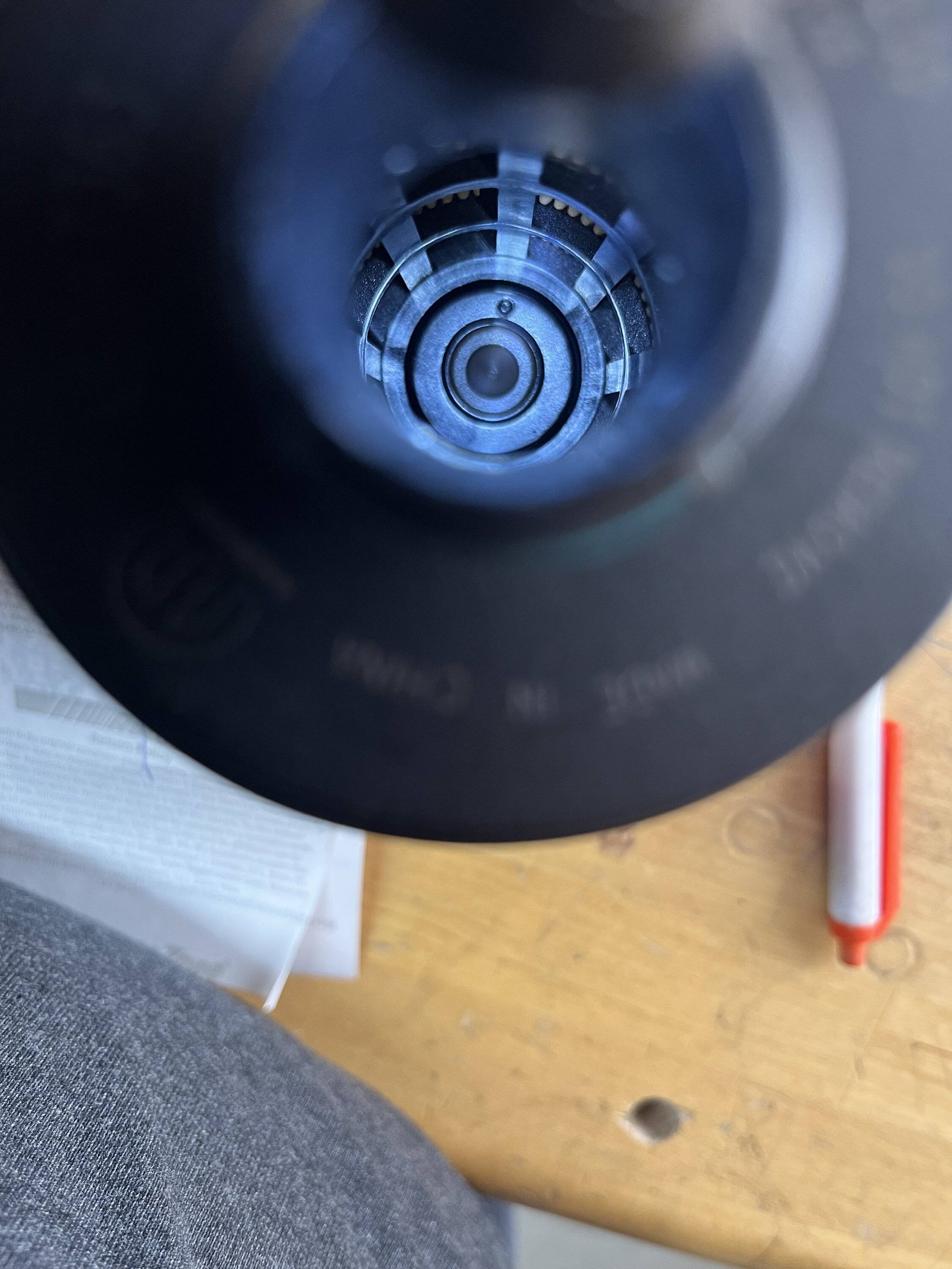

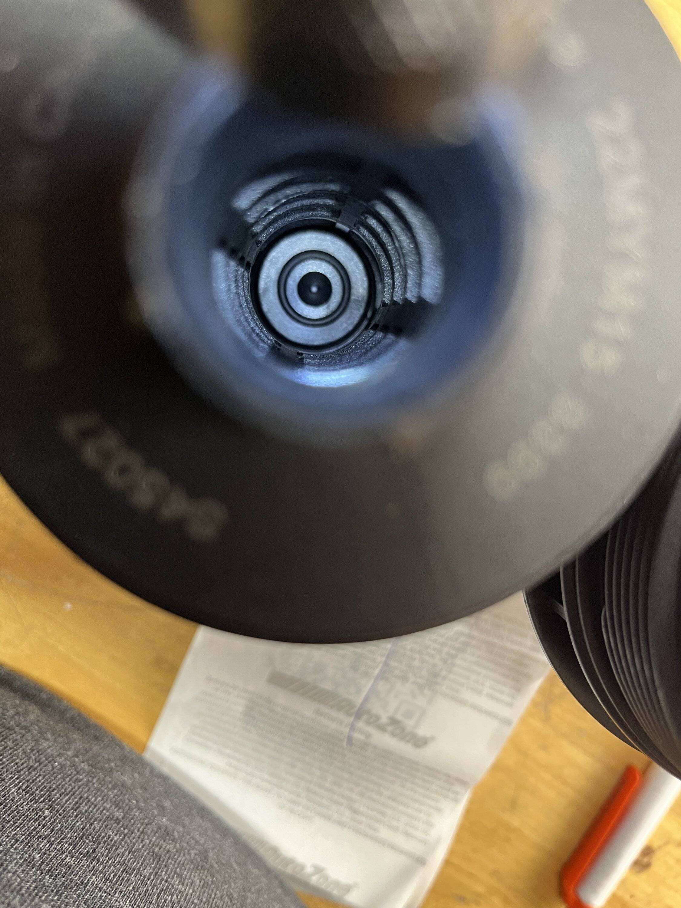

Overall diameter are the same as oem and bypass valve appears the same design as OEM filter as well. The cap appears high quality fiber resin plastic similar to oem. There're 2 main difference that I can see.
1. STP has 69 pleats vs OEM 65.
2. The inner honeycomb diameter inside the cartridge is smaller on the STP. (Note, photo with a dimple marking on the bypass valve is the OEM filter).
I don't see any issues using this filter.
