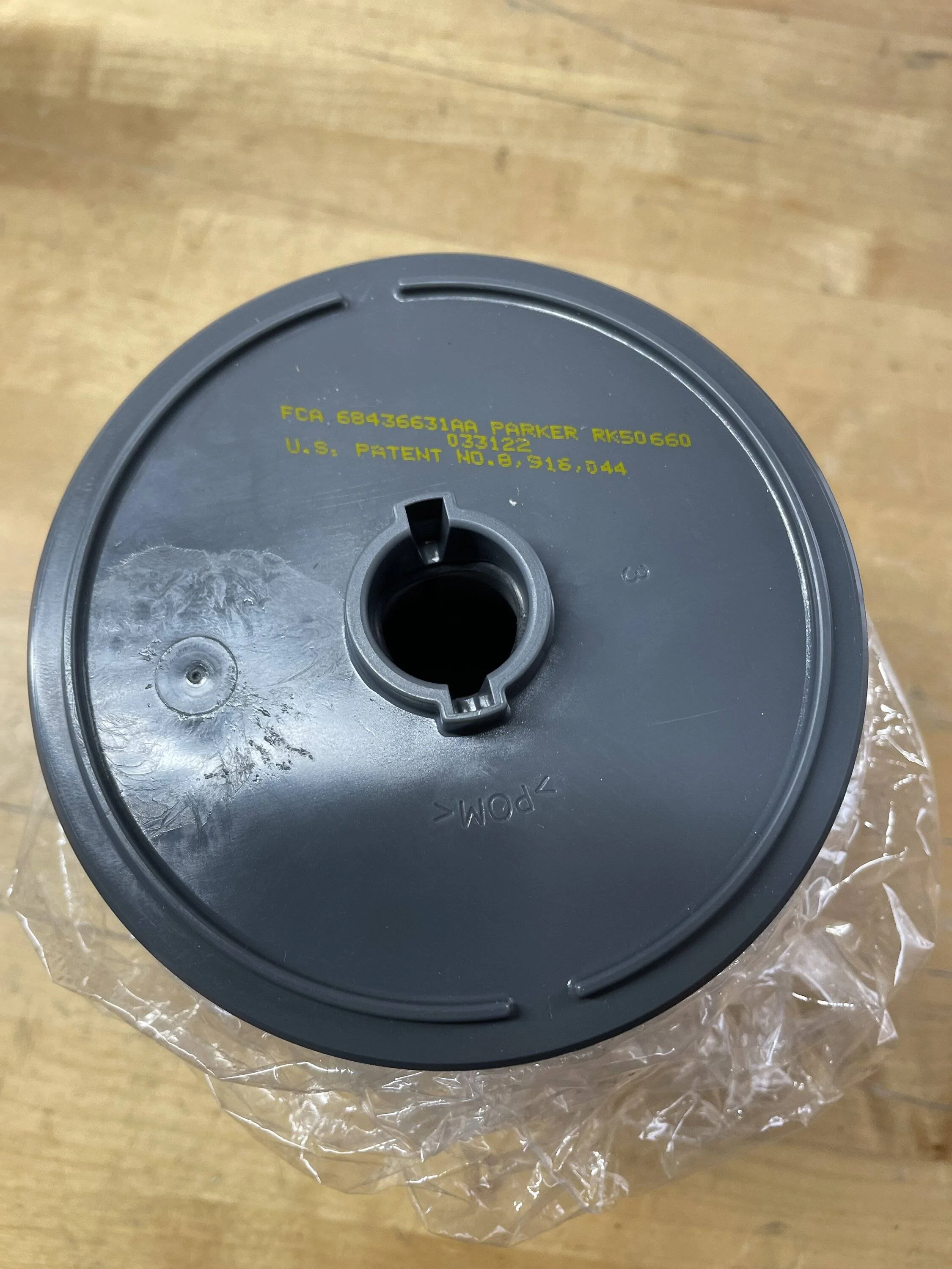

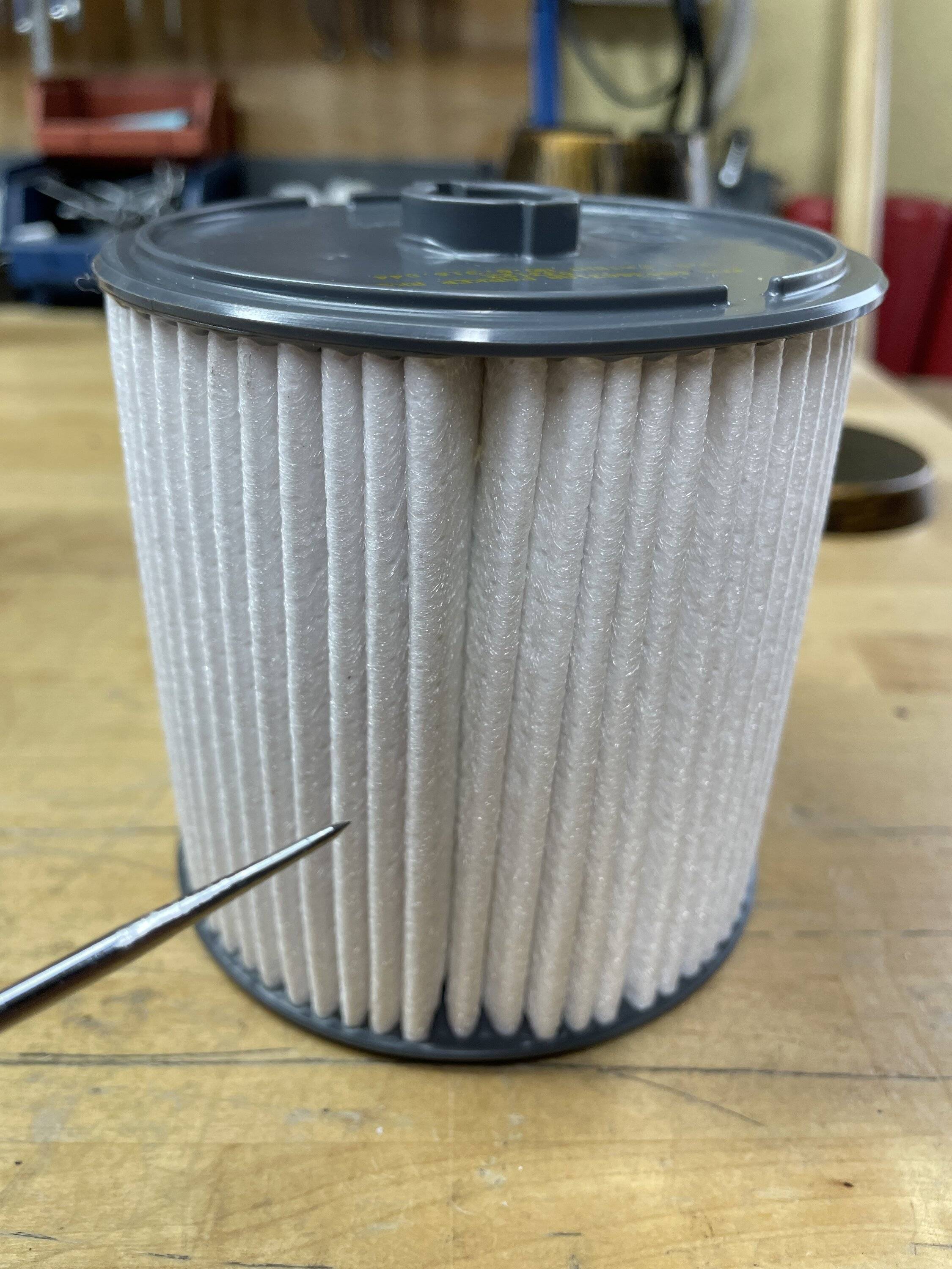

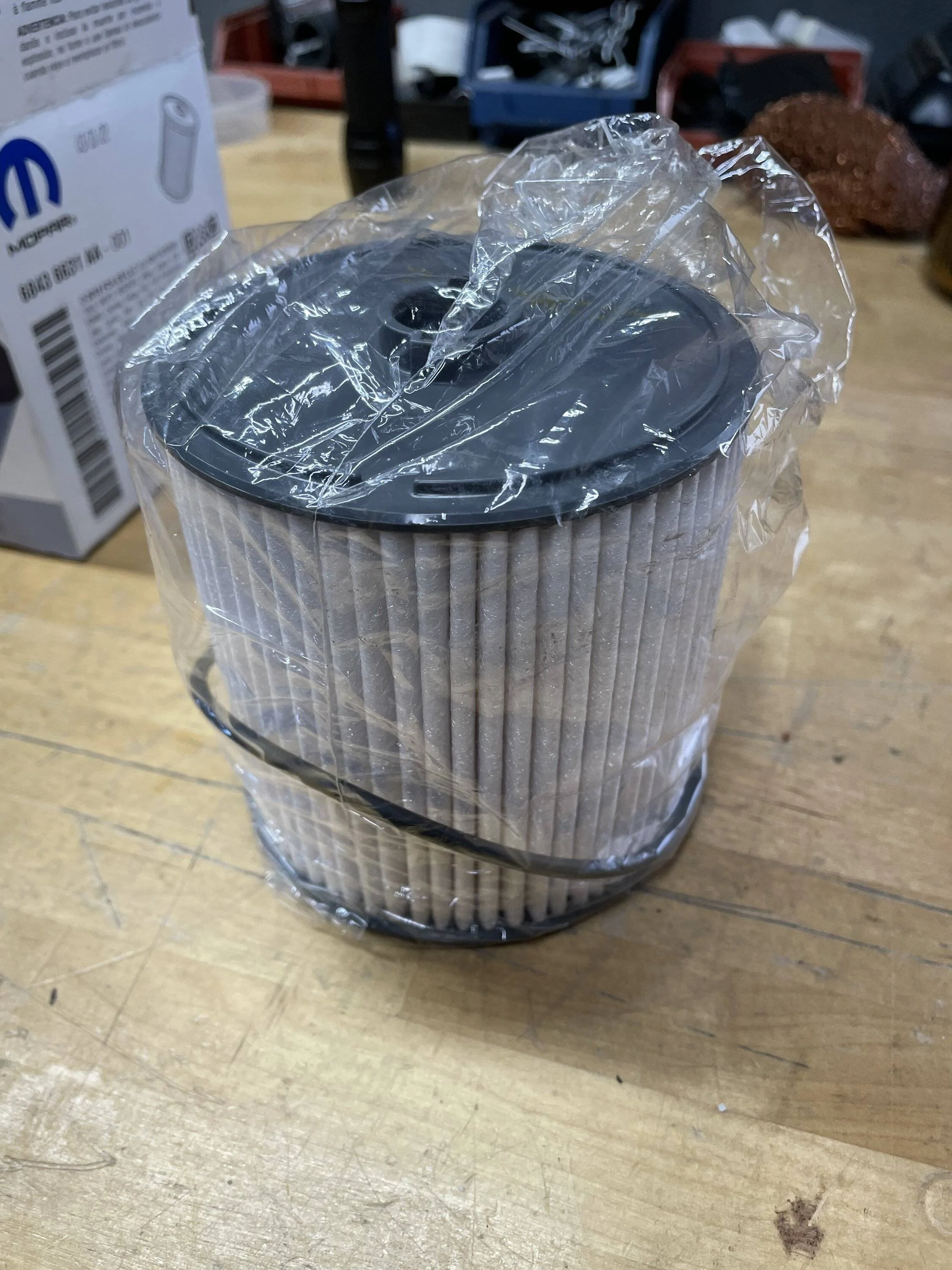

Incase someones are interested. Below are the genuine fuel filter.
Loosely shrink wrapped.
The pleat has a cotton like texture and unfortunately looks ugly and uneven ?
Does this function as the water separator filter as well ? Or is that something separate ? Im not quite sure how our JT system works.
It look to have just one pleat type, so probably not a water separator. Or maybe a single pleat can perform both duty. I'm not sure tho.

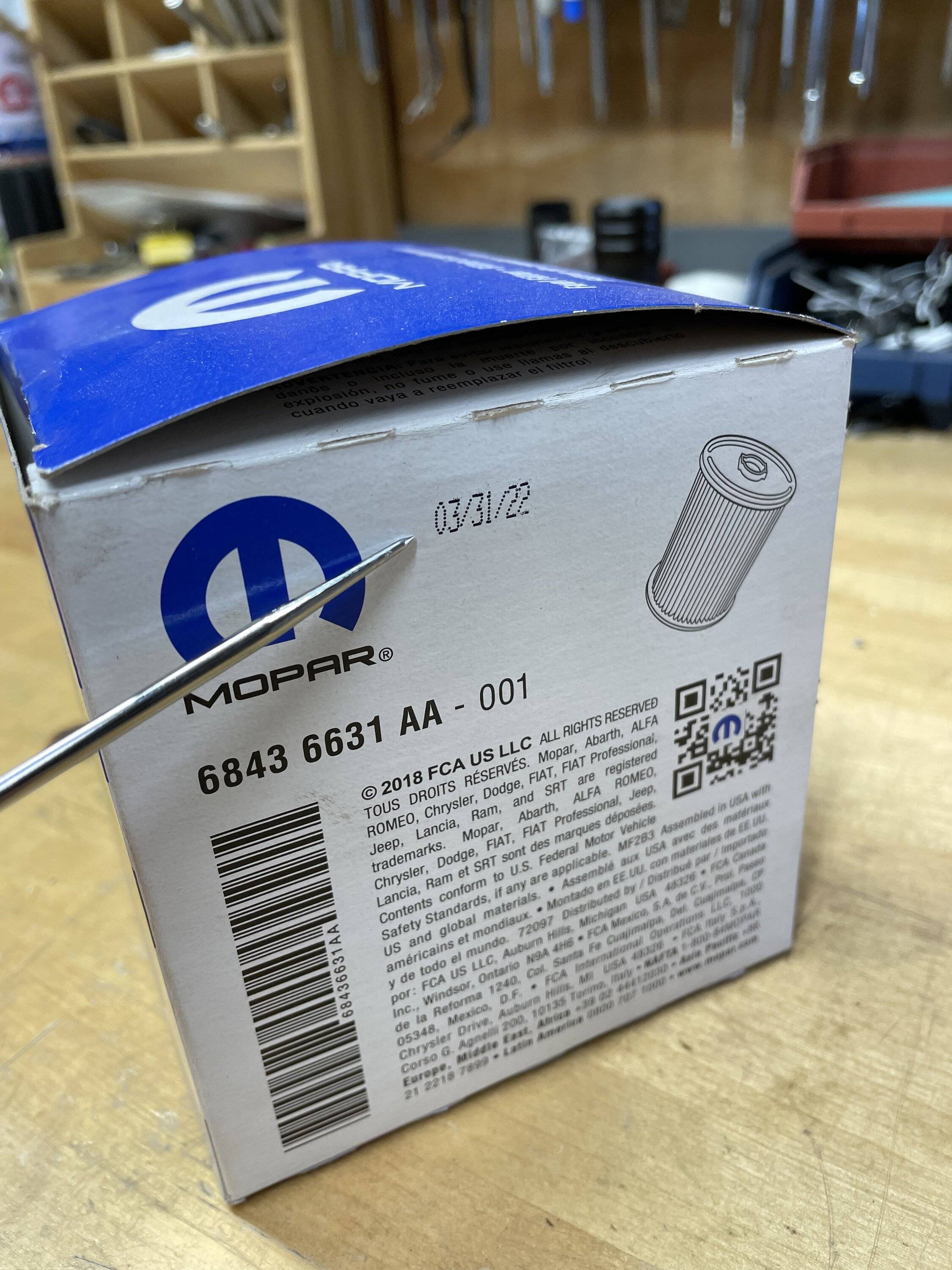

Mine DID NOT come in Mopar packaging(Box), I believe just a plane white box, but they were in the exact same type of loose plastic bag, not shrink wrapped.
I'm willing to bet they were made in the same factory , possibly even on the same line as the OEM.

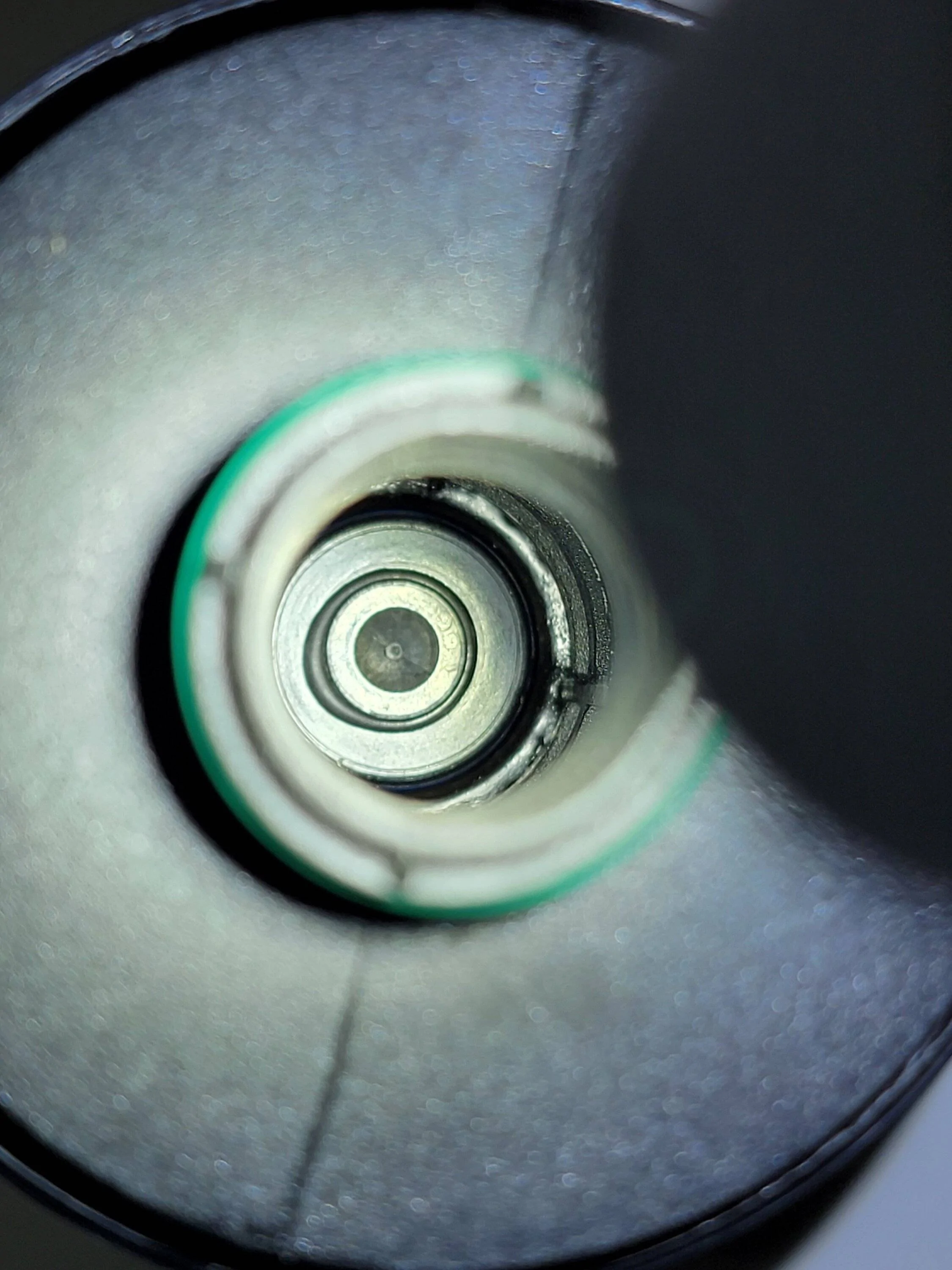

Compare the bypass valve. The 3 filters that i had separated it has different valve designs. Some are screwed into the cap with 4 screws. The factory valve is floating and it act as part of the filter cartridge.
I am actually taking (tring to.. lol) take the same pics you did. To me the valve looks the same, I was going to ask you if you could take a closer look at it though, to see if something is stamped onto it.. mine seems to have some letters/numbers ? (Or something)
See how the bypass oring is ready to pop out and over the plunger? Imaging with hot oil and pressure for thousands of miles. It'll get suck into the engine.
Mine doesn't have any writting on it, just a dimple on the outer ring face and the center plunger plastic is brown/greenist in color.
