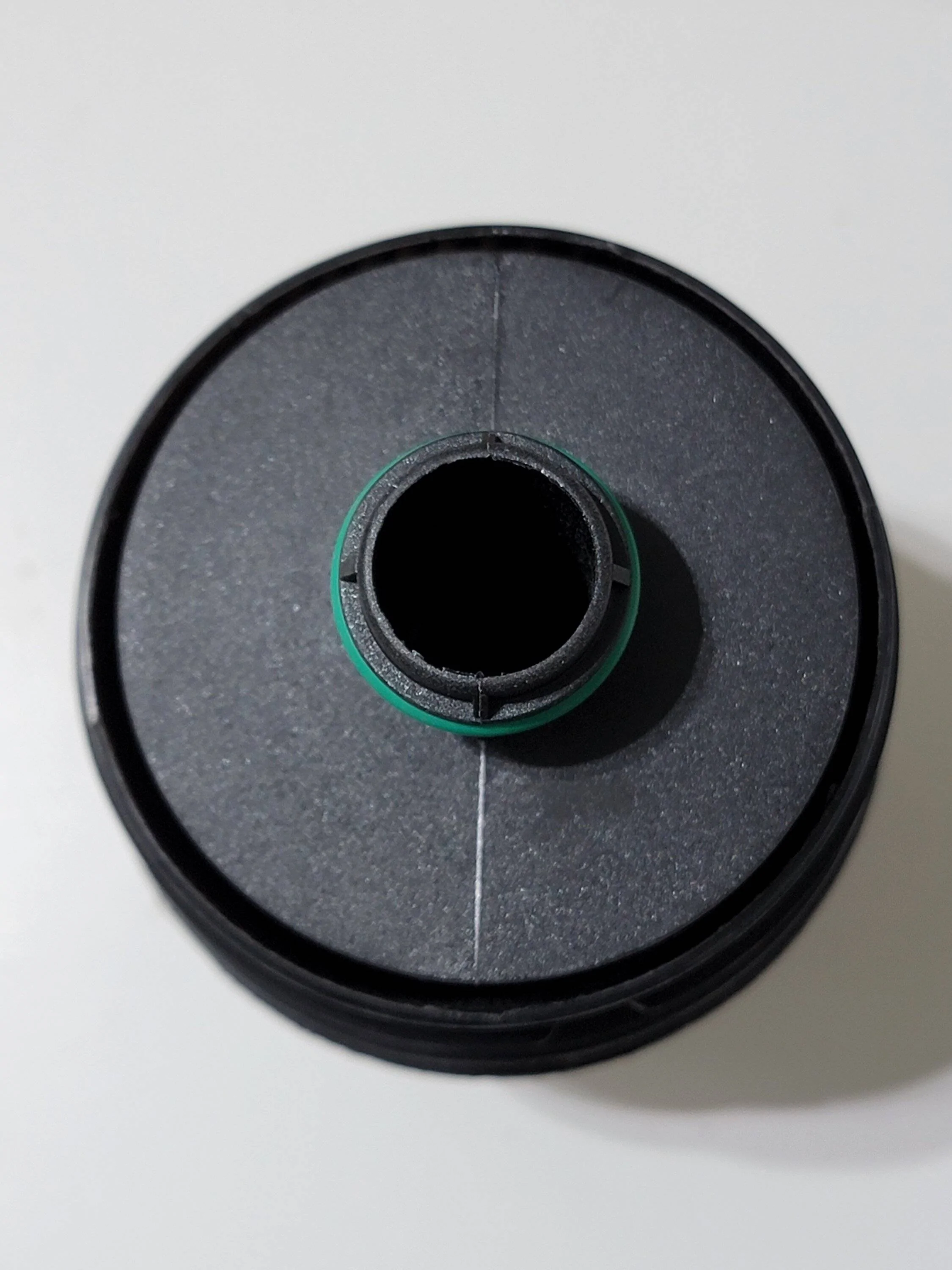

Below are photos of the markings on a genuine filter that those counterfeit might not have.
The packaging date
In a loose bag. Not tightly heatshrink wrapped.
Green marking paint in that exact location.
Gloss plastic outer layer.
Bypass valve has a dimple on top of tge valve.

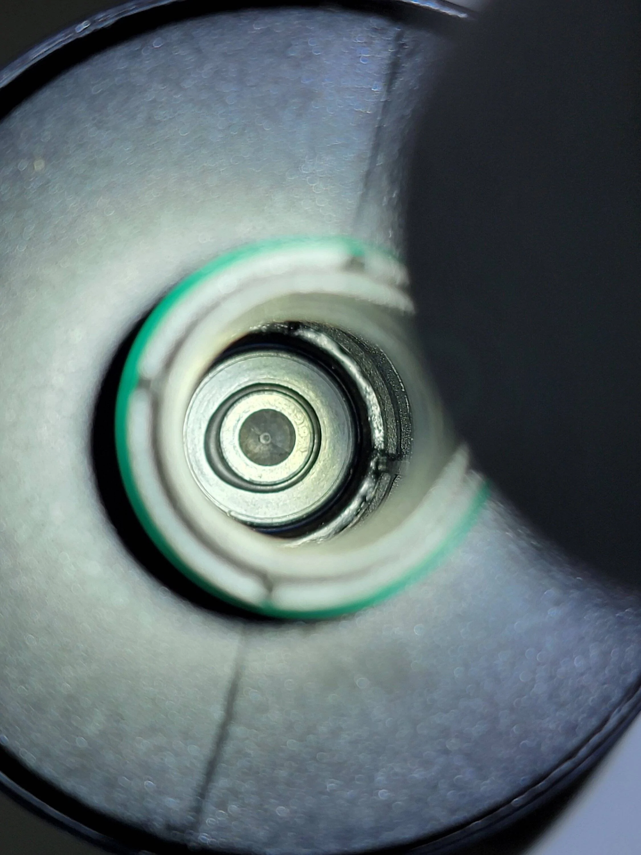

There are (3) tiny raised nipple inside the output port. White dot near the pointer.
Date stamped.
Mold or production numbers.

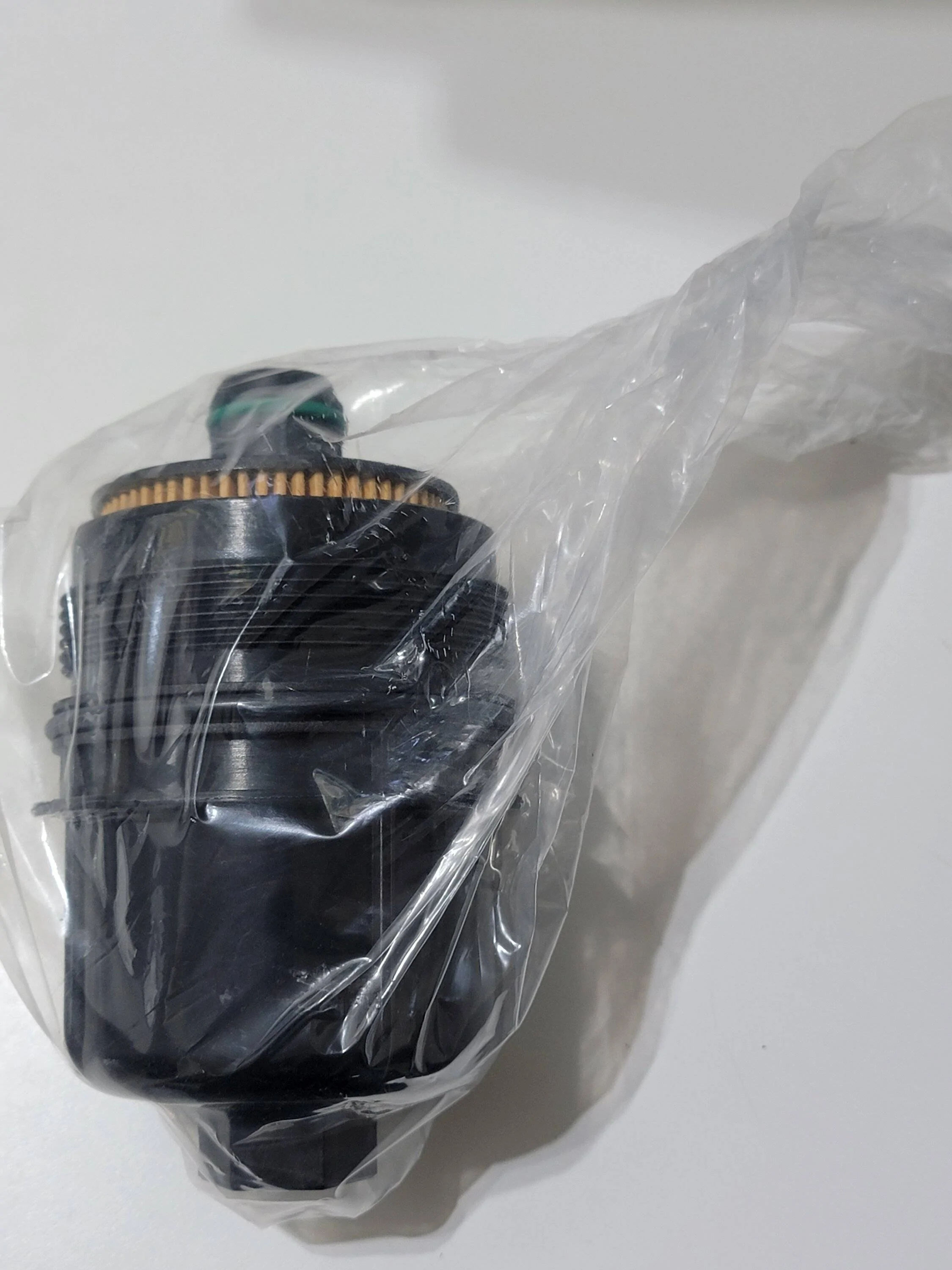

Comparison pictures of a NON-OEM Diesel Oil Filter
Generic Packaging
Jeep Gladiator Diesel oil filter. 20230502_162012
Same plastic bag as OEM
Jeep Gladiator Diesel oil filter. 20230502_162139

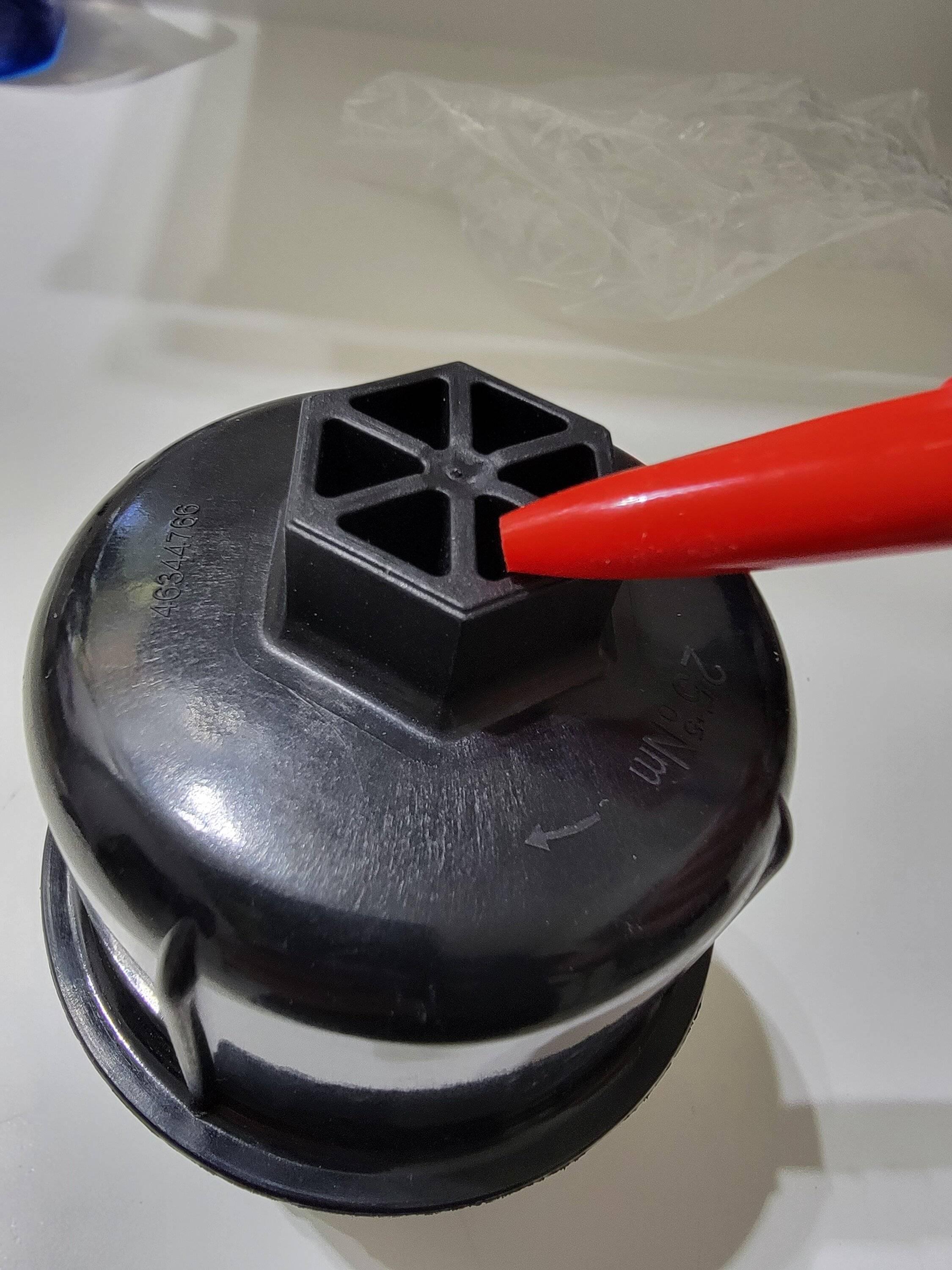

No green markings,
but does have the torque specifications
Jeep Gladiator Diesel oil filter. 20230502_162225

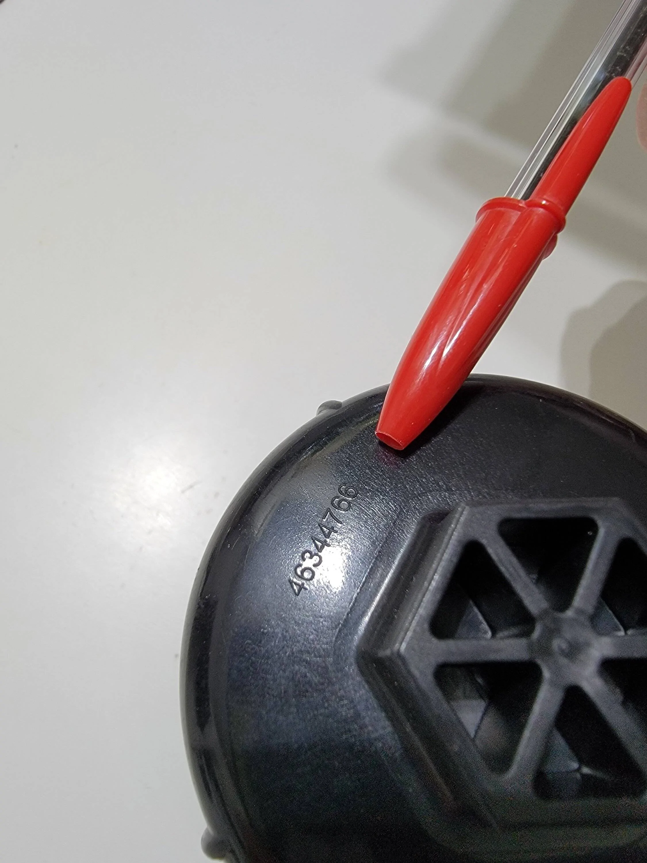

Has the correct part number
Jeep Gladiator Diesel oil filter. 20230502_162348
Has the double layer, but not as glossy as the OEM
Jeep Gladiator Diesel oil filter. 20230502_162410

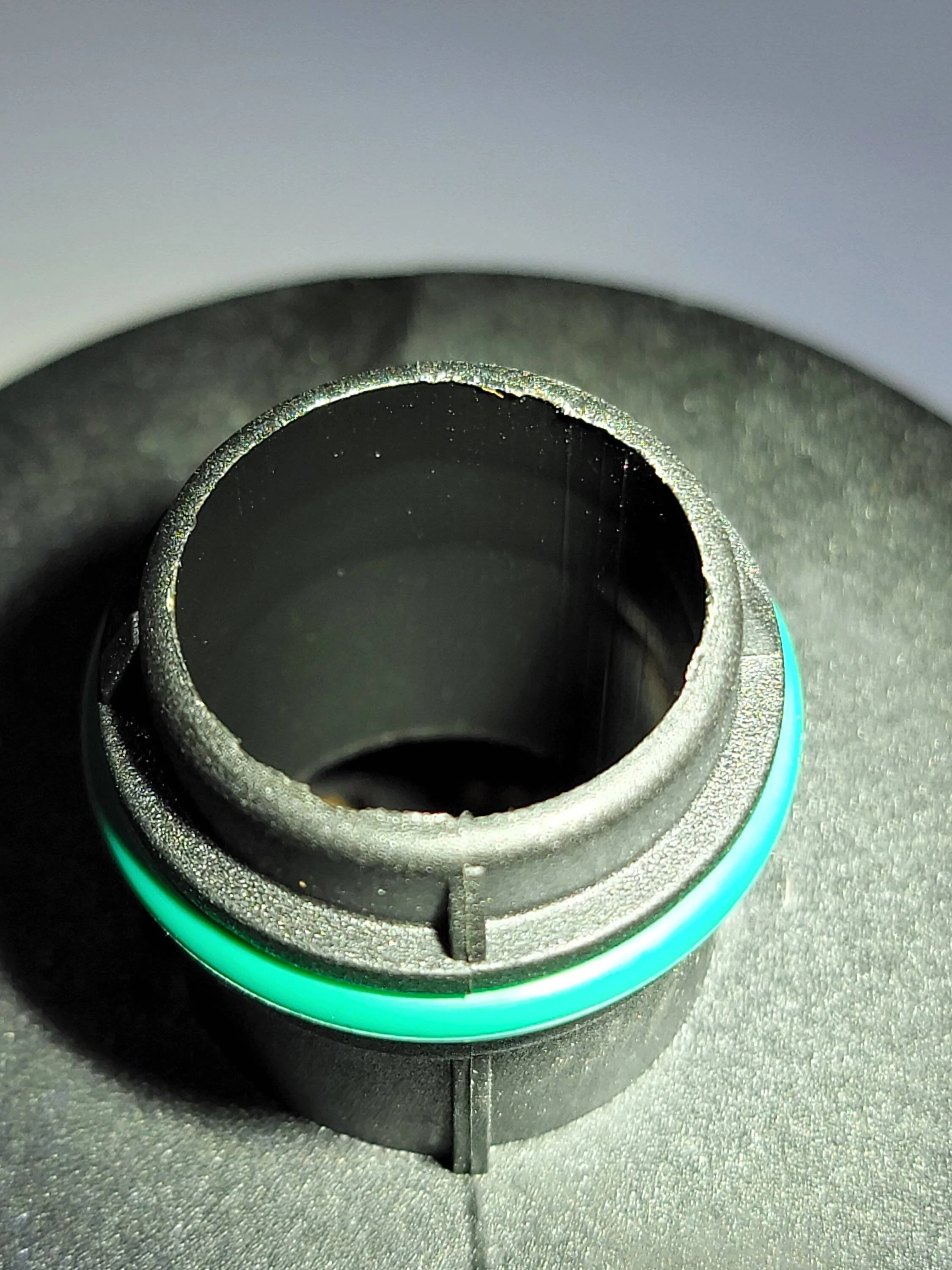

Void of any markings, but retains the OEM casting marks
Jeep Gladiator Diesel oil filter. 20230502_162445
Bypass valse appears identical, has OEM dimple
Jeep Gladiator Diesel oil filter. 20230502_162548
No raised white nipples(three white dots)

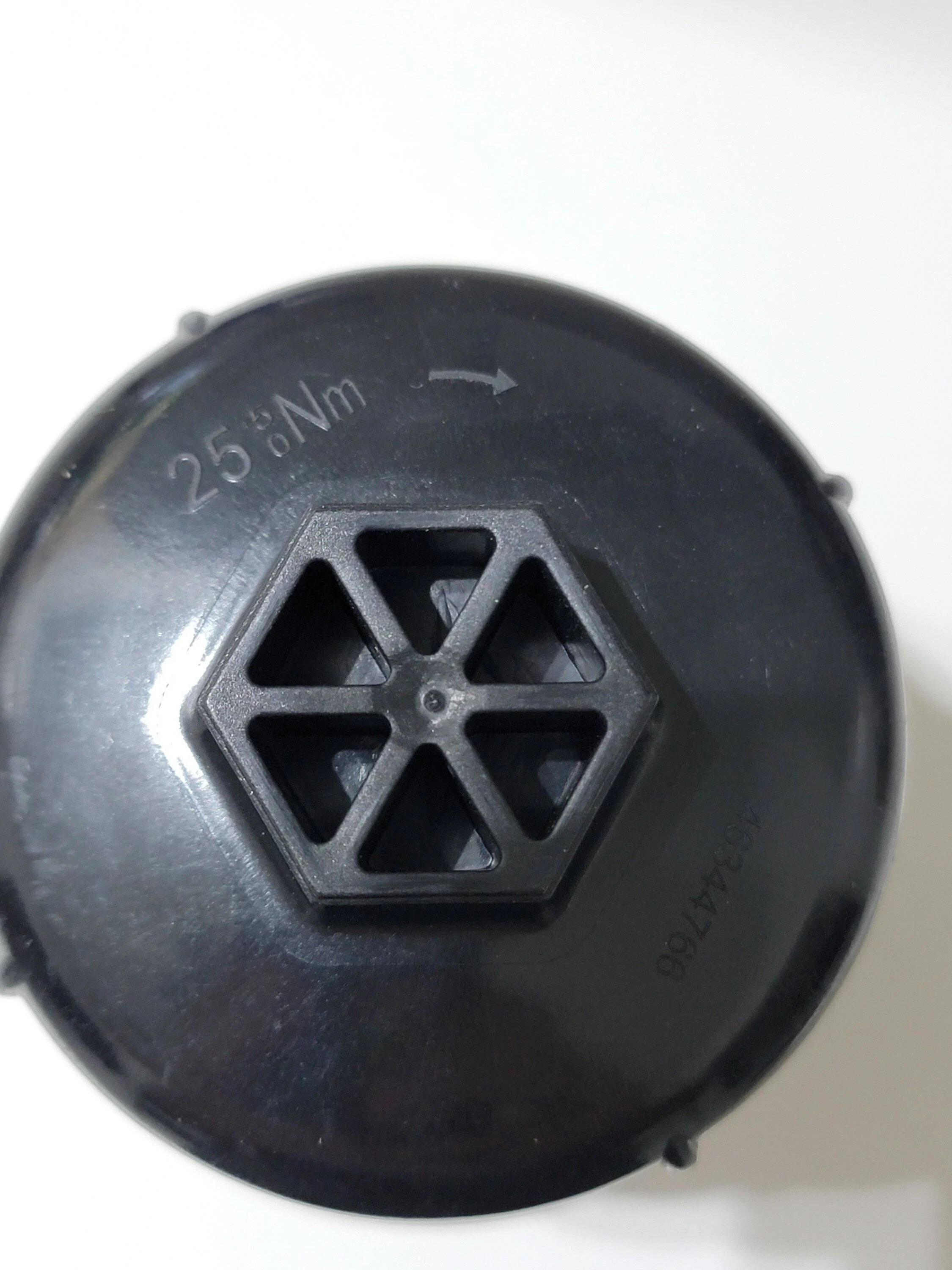

Jeep Gladiator Diesel oil filter. 20230502_163950
No date stamp or mold/production numbers
Jeep Gladiator Diesel oil filter. 20230502_164033
SargeDiesel
michael
Aug 22, 2021
1,914
1,478
35173
Jeep Gladiator Rubicon Diesel
Retired Military

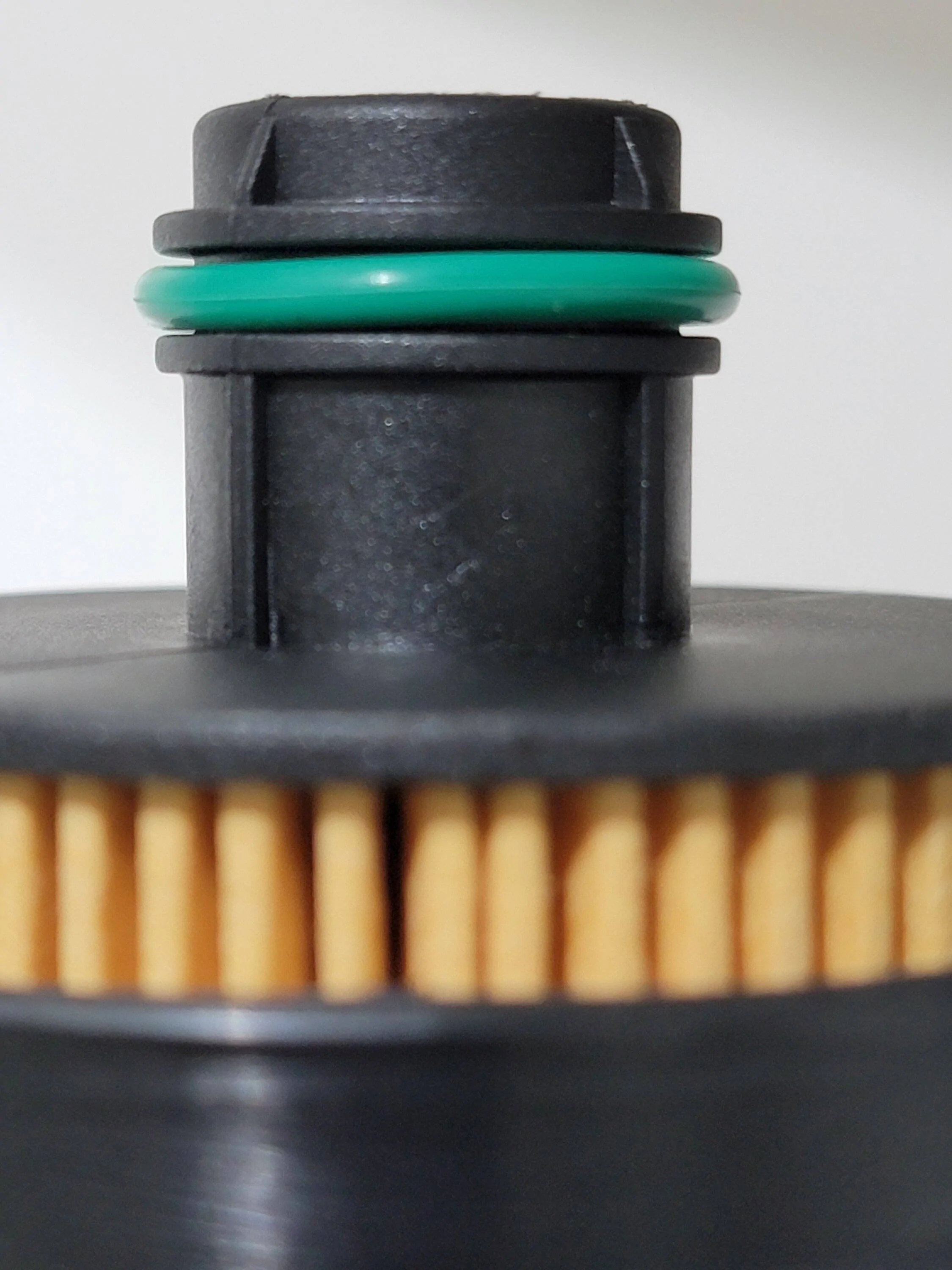

See how the bypass oring is ready to pop out and over the plunger? Imaging with hot oil and pressure for thousands of miles. It'll get suck into the engine.
I think I did that messing with it, to see if it moved around... I will see if it will go back in place and check the other one I have.... good catch !
I was able to reseat it without any issues, I checked the other one I had and it was good.
I also pulled out one of my OEM filters just to compare, and I will say the internals (atleast the bottom workings) seem to be of a better quality, for sure better fit and finish.

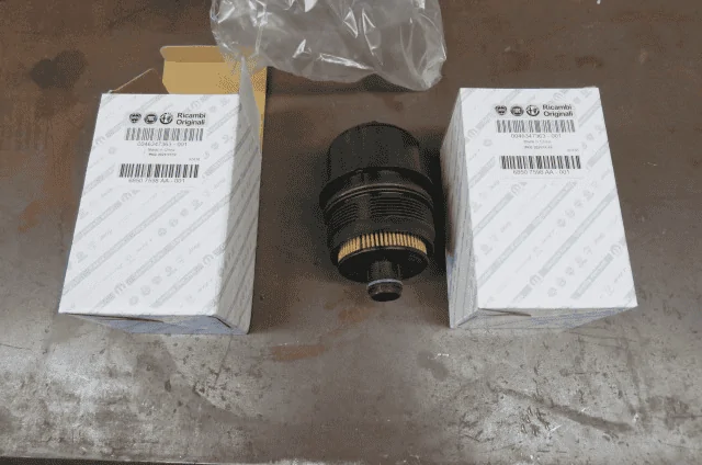

I ordered 2 oil filters and 2 fuel filters a year ago just to use after I used up my free Jeep Wave oil changes. I got everything from Factory Mopar Direct. Here's the oil filter pictures I took last year.
Jeep Gladiator Diesel oil filter. 1683073478500
Jeep Gladiator Diesel oil filter. 1683073510047
