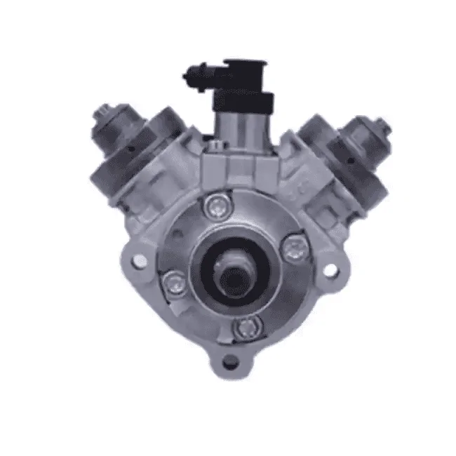

I understand that additives can modify standard diesel fuel an add more lubricity, i get that but i think we are overlooking a deeper issue.
Why are manufacturers designing pumps that dont operate with the standard fuel?
Why do manufacturers specifically say to not use addidtives?
I get your taking preventative measures however I feel this issue shouldn't be the consumers issue.

The CP4 fuel pump is made by Bosch in Germany. They have a different fuel standard for diesel then we do. Their diesel is a bit more lubricity than ours. Don't think they took that into consideration when designing the CP4. Wouldn't be the first time that something designed in Europe and used in the US had problems because they didn't do their homework.
Touche.
Seems like a pretty careless oversight. It will intresting to see how the new replacement pumps will differ.
Intrested to see how the new pumps will solve the slight variation in fuel lubricity, we'll see soon enough.
I'm even more interested to see how the dealers will inspect and analyze the rest of the fuel system to determine long term effects of the failing pumps. I feel like its neccesary to put an extended warranty on all fuel system components after the recall is completed.

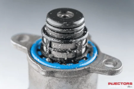

To check to see if the pump is starting to go. There is a fuel pressure regulator That sits on top of the pump. If you remove it, and inspect it. If the screen has particles on it. The pump is failing. It sits in the V of the pump.
