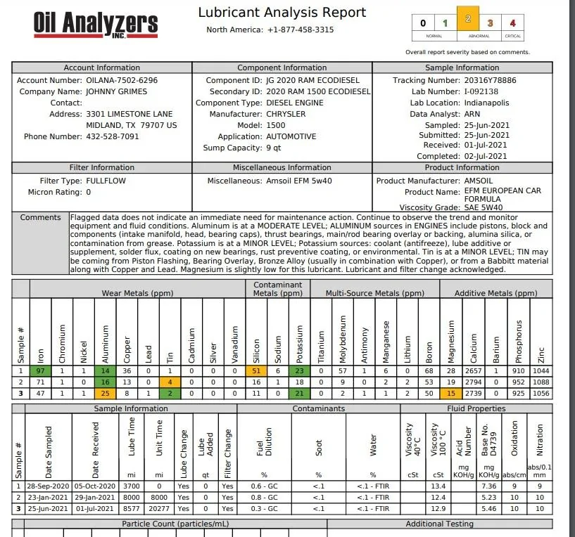

Well, if you look at the oil analysis reports you'll notice that the Amsoil fan-boys are seeing high concentrations of iron and aluminum just like the others who don't run Amsoil. These Gen 3 diesels just seem to produce a lot of metals, relative to other engines.
If we were to run oils for 30,000 miles, you may then see the benefits of the "luxury" oils like Amsoil, Motul, etc. But since we're required to do less than 10,000 miles, ANY oil meeting spec will perform exactly the same.
If I come across those Amsoil reports that guys have posted again I'll copy them over to this thread.

Here's one that I just saw. Notice that his iron was at 47 ppm. This particular lab doesn't flag that at 47 ppm but Blackstone labs does because my iron levels are exactly the same and they flagged it as being higher than averages. This guy is getting flagged for aluminum and tin content as both of those are high.
This is one example of many you'll see on other forums and social media, particularly on the Ram owner groups with this same engine. But it at least shows us that Amsoil does absolutely nothing that an oil 1/3rd the cost won't do.
Personally I think the true answer would be a proper diesel engine oil rated CJ or greater....but the warranty won't allow that.
