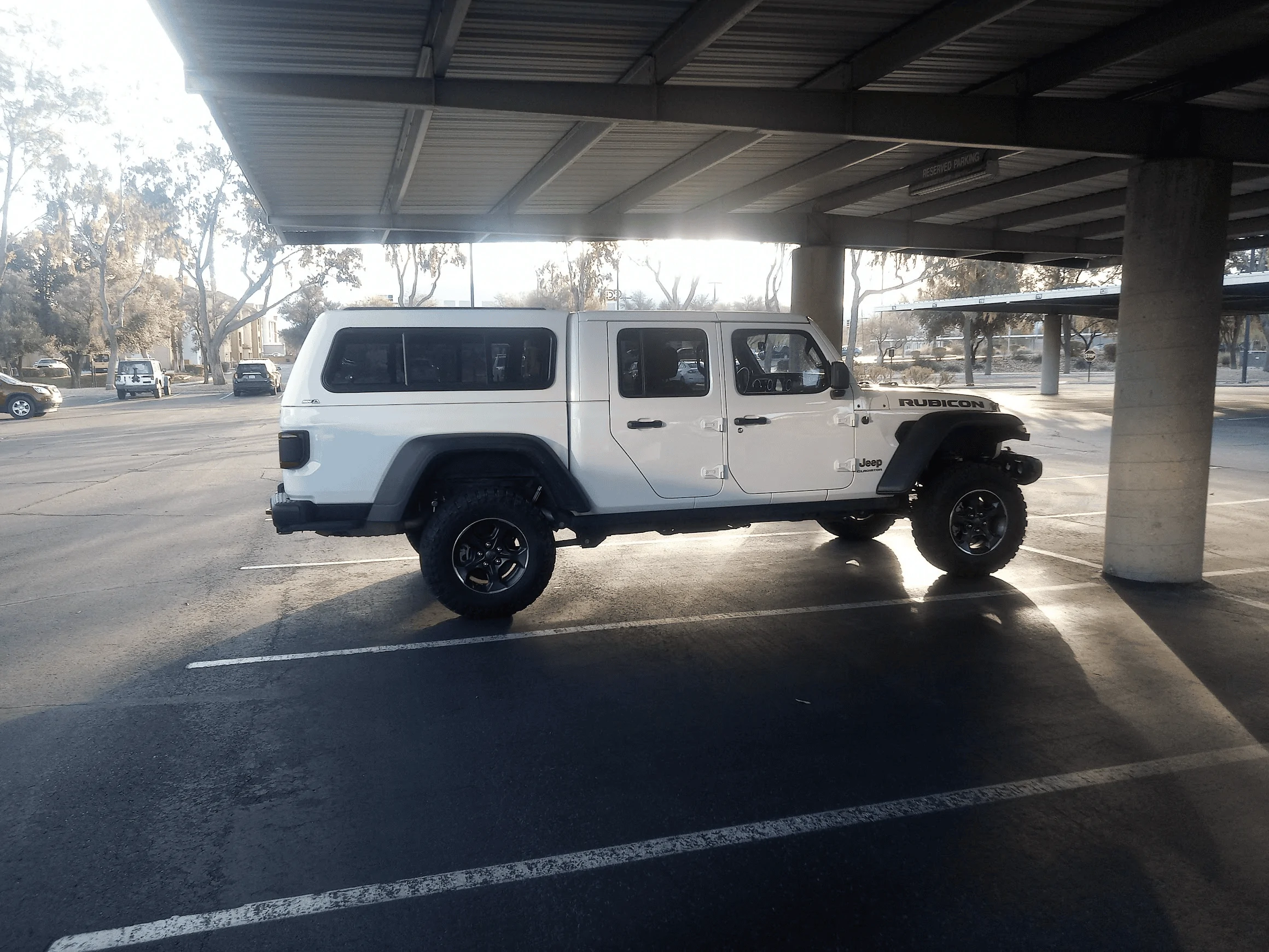

Shocks are actually more important than the springs! EDIT: They are equally important in the suspension package, but in our particular bottoming saga, I feel it's the shocks.
I've made 3 different spring swaps (Evo 120ish lb, 3.5 Clayton Gas 188lb, 3.5 Clayton Diesel 216lb) and the bottoming continued until the shocks were properly valved for enough mid speed damping to control the weight. Even the added Fox hydraulic bumps weren't enough alone to damp the bottoming.......
I've also had 3 different shocks with dozens of different calibrations installed! Premium shocks like Fox 2.5 Elites did not make much difference until I added the mid speed valving changes.
I think most manufacturers if not all are using a "If it fits, it ships" philosophy in this regard.
