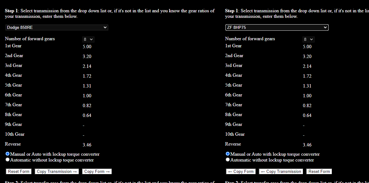

I cannot find a definitive answer.
Trying to find the ratio’s of each gear for both transmissions to compare
3.0 has the 8HP75
3.6 has the 850RE
A lot of sources folks are claiming that they are the same…. But they are different units- so I would imagine the ratios are different for several reasons.
If anyone has this information, please post up, and if possible supply a source.
Thank you in advance for any assistance.

I agree that I have found comments saying that they are the same, but I have not found anything definitive that shows what each gears ratio is for each trans. Given the power band differences I would expect there to be a difference in ratios.
Especially since the manufacturer opted to only offer the diesel 8HP75 to be furnished with the 3.73 gearing in the rear end.

I was looking for this information to make a decision on differential gears. Totally understand the torque rating differences/ overall differences. The challenging part was sourcing the gear ratios- both of these transmissions are used in so many applications it makes it challenging to know what applies to the JT directly.

http://www.grimmjeeper.com/gears.html
has both transmissions to select from to help pick gears.
