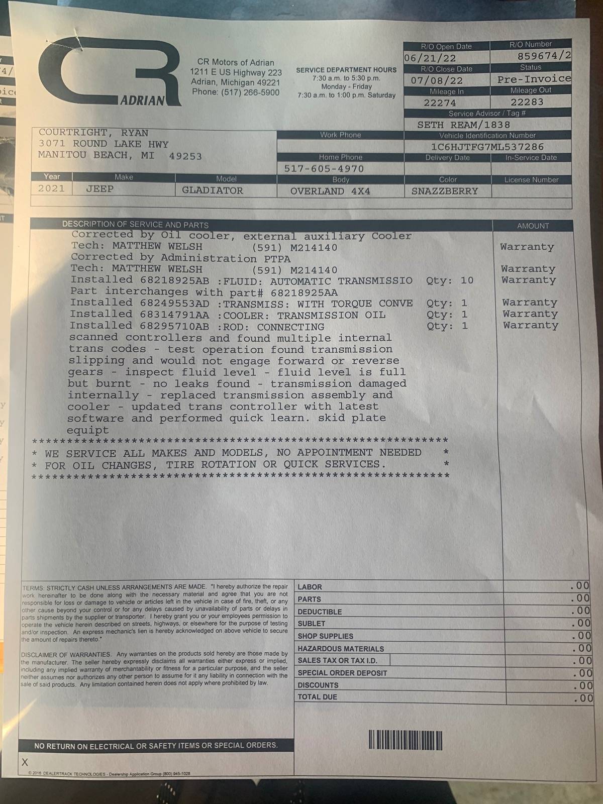

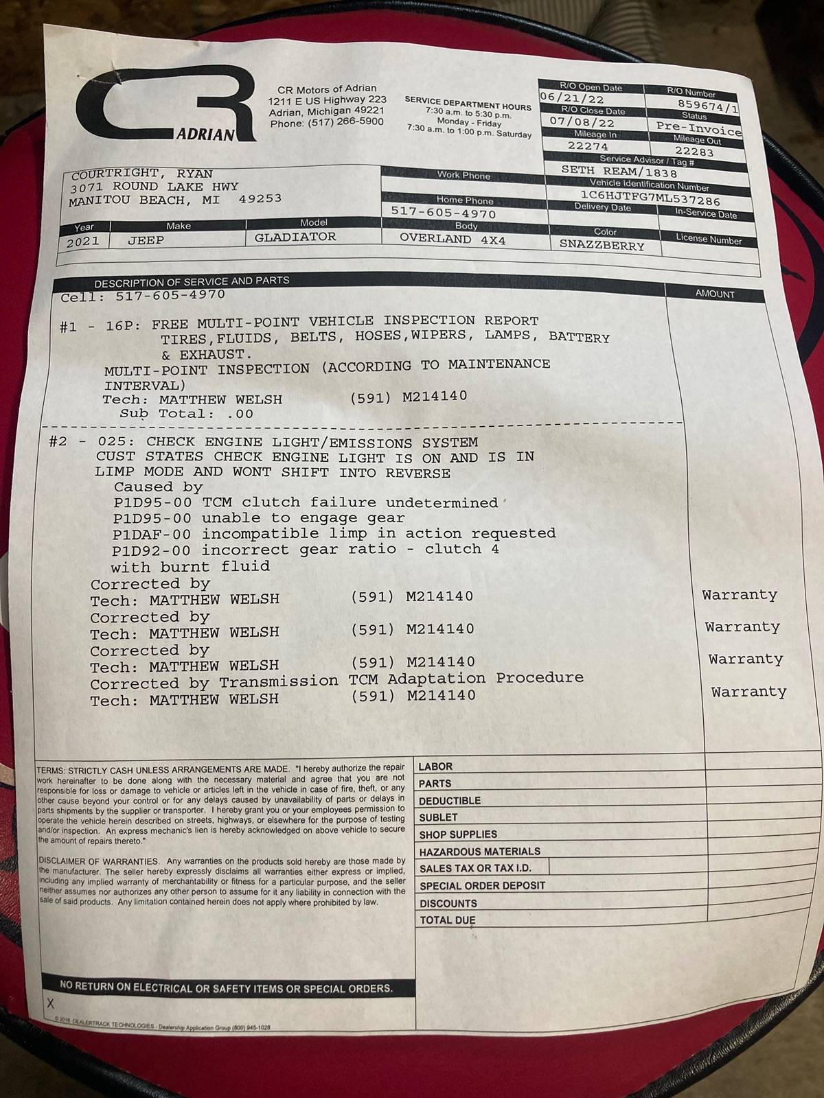

Mine got a new 8 speed auto at 22k miles. 35s with 3.73 gears from 7k-22k miles. Probably just a fluke. Here’s the RO:
Jeep Gladiator Longevity of 3.6L gasser, automatic transmission with 37" tires 67959711327__4BF339C4-3CC4-4564-839C-B62D86071F25
Jeep Gladiator Longevity of 3.6L gasser, automatic transmission with 37" tires IMG_5160

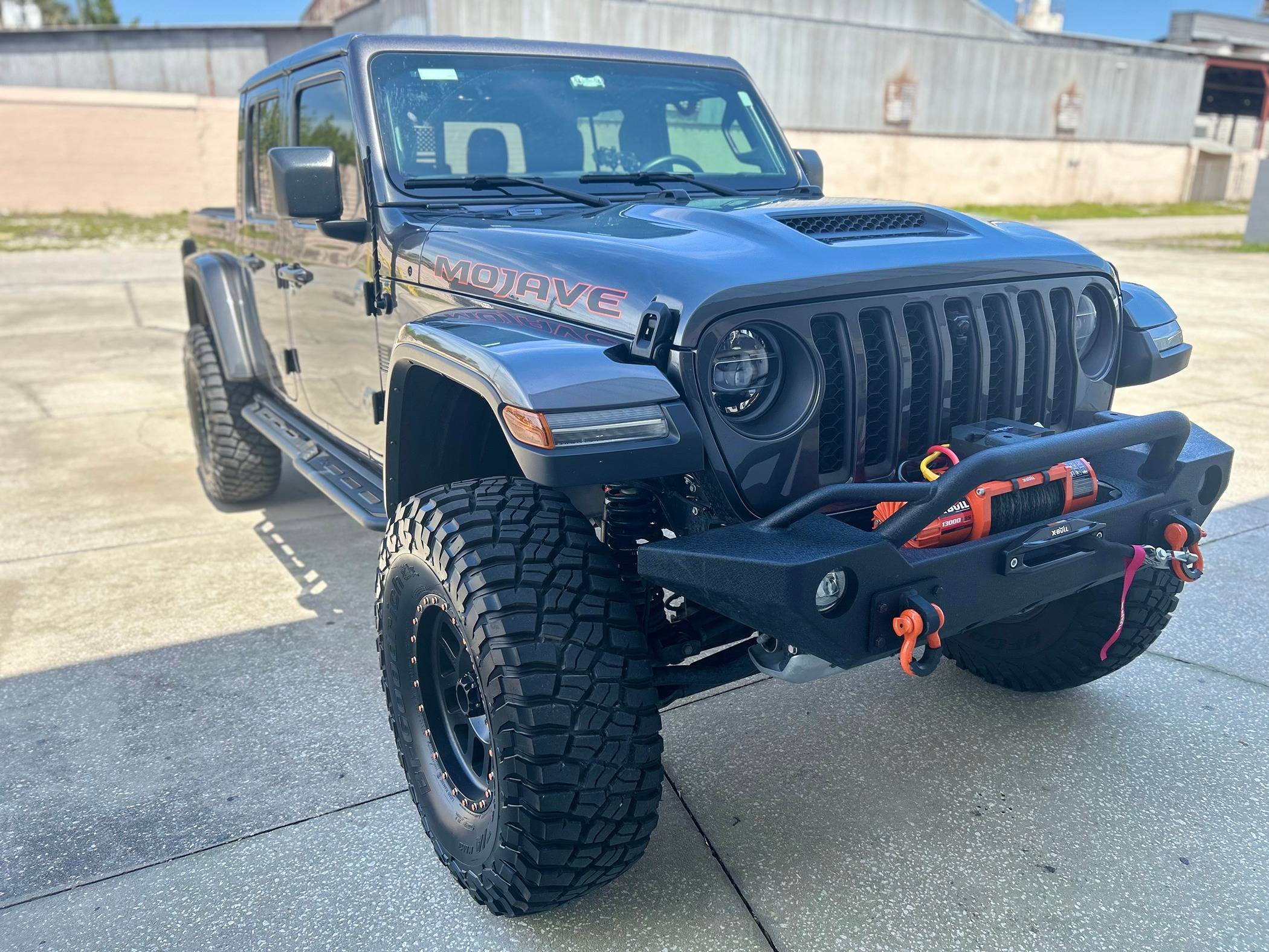

I'm hoping to get first hand experience from those of you that have the 3.6L gas engine, automatic transmission and running 37" tires.
How many miles do you have with that combination?
How many miles overall? (maybe you did first 30k miles stock, then upgraded to 37 and have put 30k on those, 60k total)
Type of daily terrain you drive and off-road "abuse"?
Any major issues so far?
I'm in north TX, so pretty much flat and it's my daily driver and I intend to do moderate to difficult trails ~6 times a year.
Thanks for all good feedback. Not so much the snarky stuff I know I'll get :)

I have the Method Racing 306s with 4.75 Back Spacing, 0 Offset, 17 x 8.5. 3.5 in Redi Lift. No rub ever. I’m a moderate trail guy, nothing crazy.
