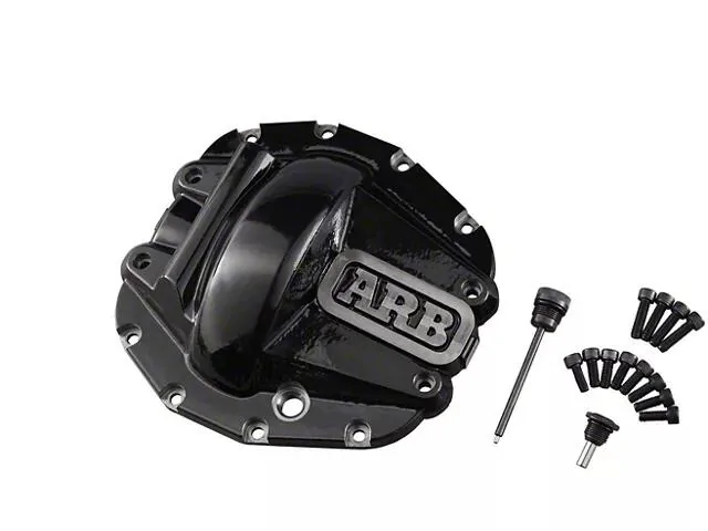

Had to laugh - why are they "the very best of the best, period, hands down" ?
What makes them "special"?
I have installed and used several different brand covers over the years. If the vehicle owner wants something better than the stock cover, I recommend ARB because of my experience with them and their attributes.
The big pluses to me are; Cast iron, recessed bolts, internal fluid flow design which is close to stock Dana design, and a dipstick.
I know from your posts that you are a cover removal everytime-guy so the dipstick will mean nothing to you.
*Taken shamelessly off of the ARB website:
"Features & Benefits
  • Iron Structure Protects The Differential And Ring
  • Tensile Cap Screws Are Recessed For Protection Against Obstacles
  • Computer Optimized Cross-Brace Design
  • Approach/Departure Angle Optimized
  • Prolonged Carrier Bearing Life Due To Extra Support
  • Additional Housing Strength
  • High Quality And Strong Neodymium Magnets
  • Magnet Location In The End Of The Dipstick
  • Low Profile Drain Plug Design Resists Damage From Obstacles
  • Cover Is Powder Coated"
Now, @ShadowsPapa , if you don't like them and laugh at them, that is your prerogative. There are thousands of Jeepers that would disagree with you. Sir.
Be well. Jeep on.
Eric
249
40,586
54,245
I asked, you answered.
I would only use a cover that maintained the stock fluid "flow" inside. Never a cover that it just plain round or has a flat internal back.
Dipstick doesn't really mean anything to me - I'm more of a pull the fill plug and check the level with a finger person.
I'd not like the fill, check, fill, check bit. Fill until it's at the hole or just below.
(I have a pump type dispenser for hypoid lube)
That would be a negative to me - top filler without the rear hole but that's neither here nor there. Personal preference.
Most important is a cover that is designed to maintain the internal flow pattern, and doesn't easily distort.

As for aftermarket diff covers, please check out this older video if you have the time...
And check out what the competition rock crawlers and rock racers use. 50% use ARB.
I am a "Buy North American if I can" kinda guy, but the Aussie company, ARB, has nailed it.
And I prefer electric lockers over air lockers. But ARB is first class either way.
Be well. jeep on.

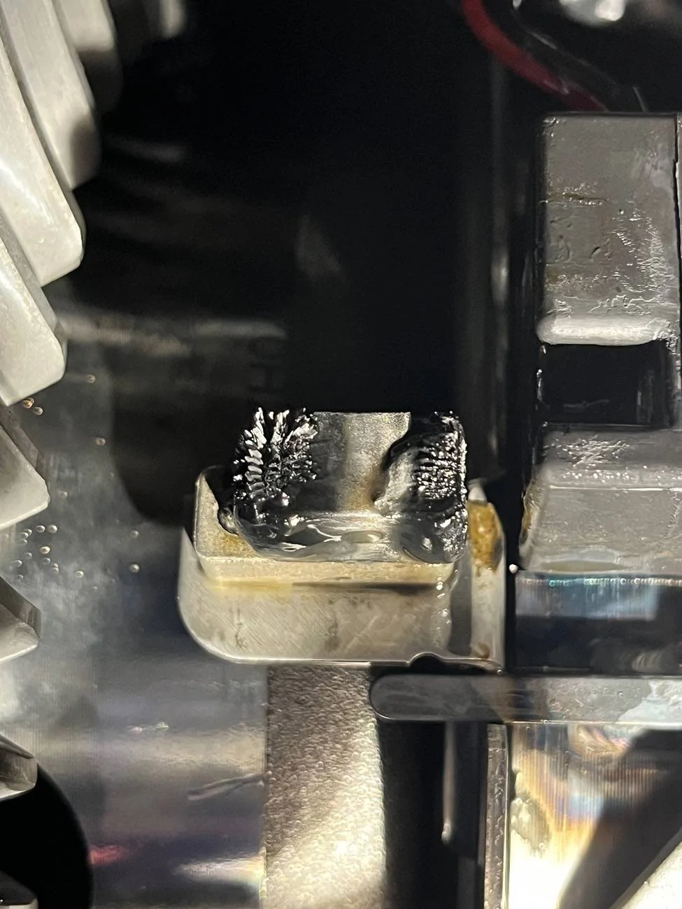

You can "use" whatever you want, most of the time I've just wiped out the housing after letting it run out. Then check ring gear teeth and look for metal in bottom and drain pan. I'm more concerned about having some juice in it that will break down seals, and gear oil or cause corrosion. You could use WD-40 even, I may have a time or so.
