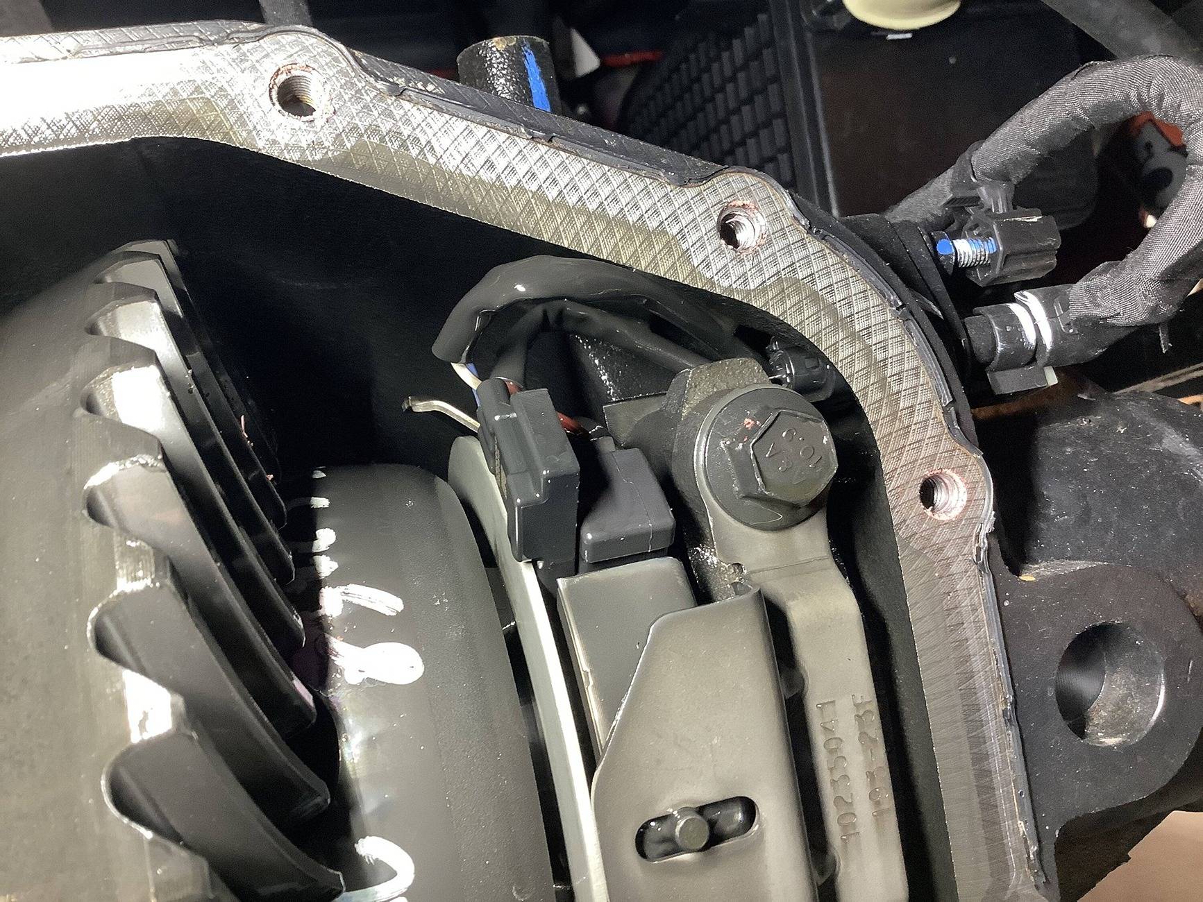

DO NOT USE BRAKE CLEANER! Brake cleaner WILL degrade the plastic on the locker sensor! You will end up replacing the locker sensor.

Inspect your locker sensor for oil intrusion, just one small Torx screw holds it in. Pull it off the sensor magnet and clean the magnet off. If you forget the cleaning the magnet, the responsiveness of engaging and disengaging your locker will slow down and eventually stop working.

Wouldn’t using brake cleaner be ok if you stay away from the electrical bits? I’ve only ever used brake cleaner on my diffs and not sprayed the sensor or harness and been ok ..so far. I’ve also potted my sensors and are still the original ones (21 JTR)
249
40,505
54,086
Keep it away from wires, SEALS, and the other electric bits and you'd be ok. It's nasty on plastic and rubber, seals, wires, and so on.
The potting will depend on what exactly is used. I've tried to take apart potted electronic parts of the past (voltage regulators and so on) and brake cleaner doesn't even phase that early stuff. Today's parts? I can't say.........

They redesigned the locker sensor. Was phased in November of 2022 for the 2023 model year. Should not have the gear oil intrusion.
https://www.jlwranglerforums.com/fo...or-potting-dana-44.59581/page-53#post-2464557
I was thinking more of the cleaning of the magnets for the current models.
I'd hope they used the different sensor in 2025s since it has been available for a while now.
When I clean those things out, I want to get everything out I can.

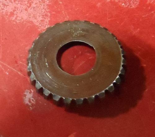

Imagine pulling a cover, scraping out the bottom of the differential housing and having this drop out into the drain pan.......
GM 10 and 12 bolt rear ends were famous for the bolt that holds the cross pin backing out, or breaking. Letting the cross pin to came out and lock up the diff.
249
40,505
54,086
Yeah, and when you wanted them to come out, they weren't always easy.
I remember those bolts with the long stem that went through the spider gear pin.
If that shaft worked loose - destruction often followed.
I replaced a few of those rear ends. Either a hole in the diff cover, or the pin wedged inside the housing.
