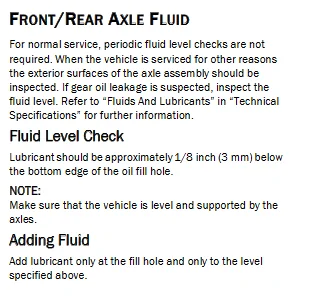

The Owners Manual is very clear that the proper oil level is 1/8" below the bottom of the fill port. DO NOT go by someone on the interweb posting that it is OK because of information "found elsewhere".

Note they use "approximately" in their verbage.

Look at the first sentence - you may go along and have it 1/2" below the hole for thousands of miles because they say checking isn't necessary - you are saying you are at grave risk.
