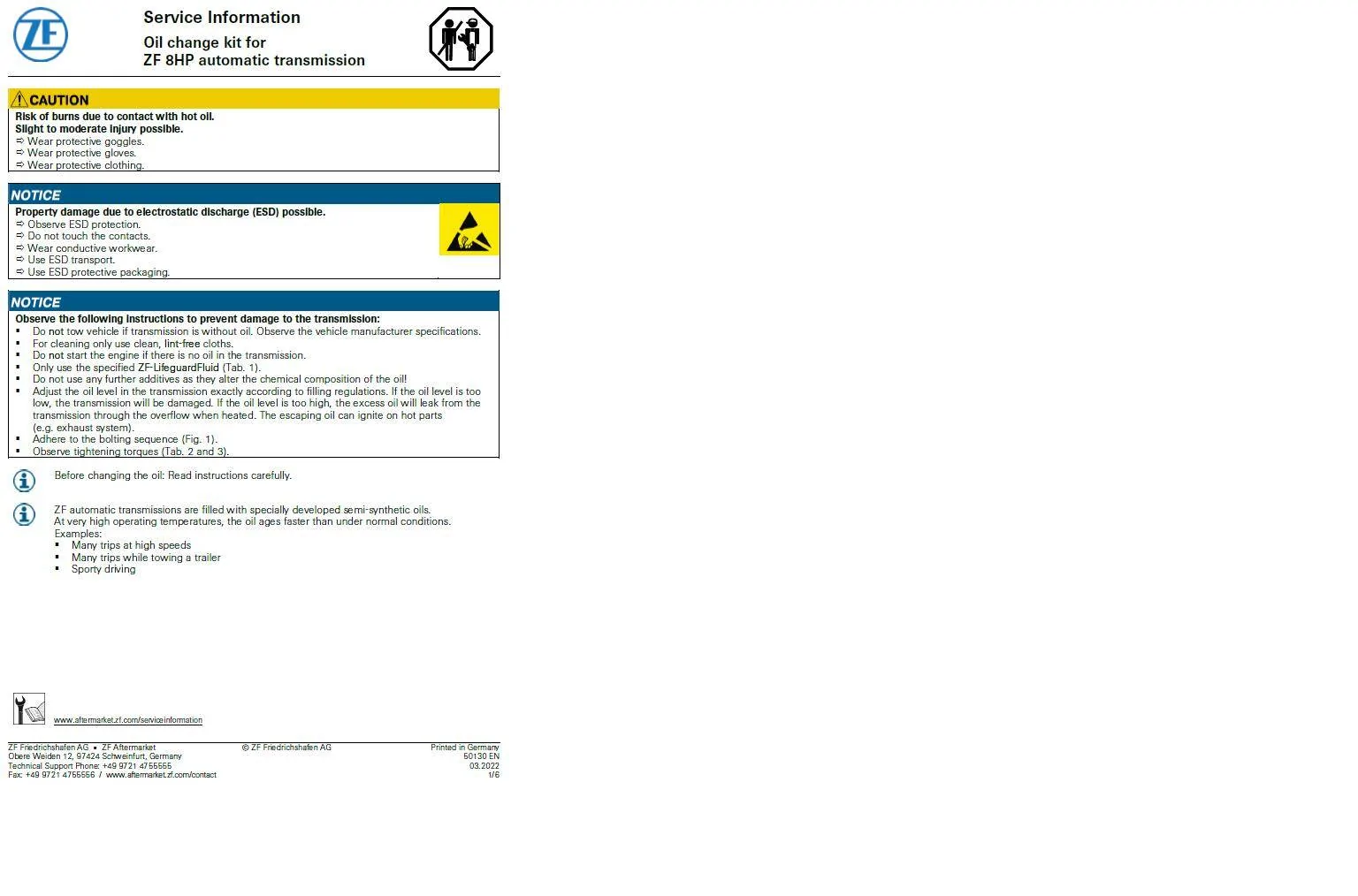

Attached is a ZF document I have dated from 2016 on the 8HP and fluid changes. They recommend an 80,000 km (50,000 miles) to 120,000 km (75,000 miles) “depending on driving style”, listing high temperature towing, high speed driving and sporty driving.
I interpret that as normal service would be the 75,000 mile recommendation with severe service being 50, 000 miles if not sooner.
Here is the same doc published 6 years later.
In 2016: ZF included guidance on distance (km) and duration (years)
In 2022: ZF removed guidance on distance and duration (this doc is attached to post #29 in this thread, and has been added as doc #4 in ZF docs); page 1 of 6 is shown below
In 2021 (reposted on ZF website in 2025): ZF published the product data sheet for LifeguardFluid 9 (as we know, MOPAR 68218925AB is an exact equivalent) with service interval guidance of 150,000 km (93K miles, for normal driving); see doc #2 in ZF docs; also see Key Info for guidance on shorter service intervals (42K miles +/- 5K miles) for off-road, trailer towing, etc....
Page 1 of 6 (doc #4 in ZF docs):
Jeep Gladiator If its lifetime fluid why is this needed? PAGE_1_ONLY_SOURCE_GladiatorPilot23_FILE_NAME ZF oil change kit.pdf

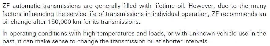

The issue is that Jeep appears to disregard everything after the first sentence below. Also see doc #2 in ZF docs. 150,000 km = 93,000 miles (for normal driving).
From page 1:
Jeep Gladiator If its lifetime fluid why is this needed? 1744309628029-

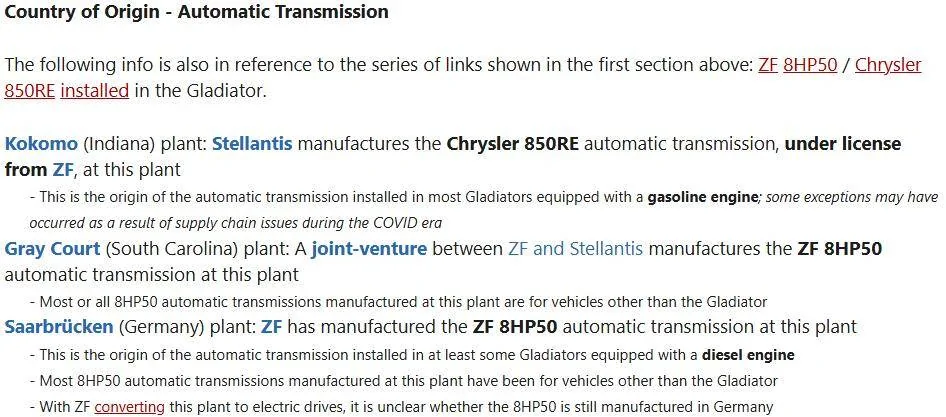

100 % right. I just looked it up.The auto trans for the gas job JT is built in Germany, shipped to the U.S. and installed in Toledo Ohio. The artical say's it's one of the best and strongest transmissions around. The American built one is in the diesel. The German built one is better.
The transmission behind the 3.6 is made in USA. The reason is ZF couldn't keep up with the demand. So FCA licensed the rights to make it here.
The diesel version is made in Germany, as well as the 4xe version. (even though Jeep EXPERT and master tech Scotty Kilmer says they are made in Austria)
Thsts correct it is a licensed (inferior copy of the 8HP50 made by ZF , licensed to Chrysler as the 850RE ( Royal Error...thats a joke) ,

Seriously? I guess you have no idea how that licensing and the rights work. FCA has to follow strict design parameters and manufacturing methods. They are required to contact ZF with any proposed changes before they were made. Since FCA used a plant that already had equipment to make transmissions, they did have to make some changes to the case to allow FCA equipment to work with that design. Otherwise, they are restricted to what ZF says.

This is part of what I wrote in post #7 in this thread. It appears that ZF has stopped / will stop making the 8HP50 in Germany.
