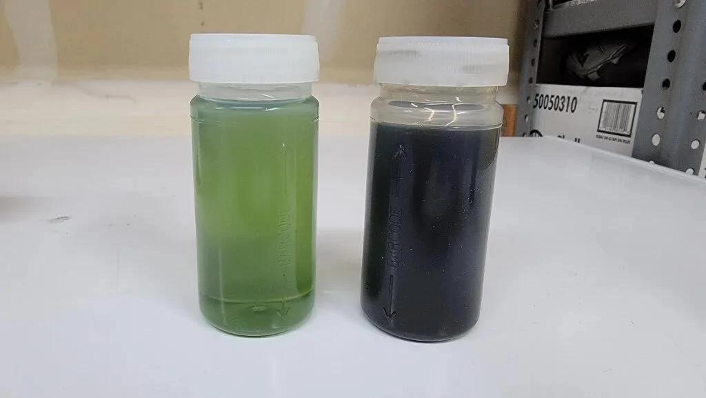

100k the trans will make it for for sure and pass the warranties period as well. It will however be with significant permeant wear. It will be real real black when drained. ZF released a memorandum which says 80KM or 50K Miles and on the subject and a video I have seen on youtube talking about it at 100KM or 63k Miles. If you off road and tow even sooner. A drain and fill at least every 30k if you want long life. Keep in mind, most of the oil still stay when you do a change. That's why 30k miles at least.
New on the left 50k miles on the right
