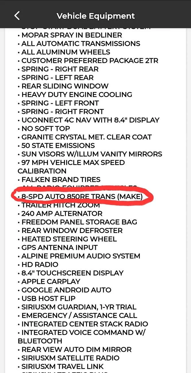

See 👀
Jeep Gladiator If its lifetime fluid why is this needed? Screenshot_20250217_125544_J

Your right ,I looked at my maroni lable. it list the auto trans as the 850 RE. Figures Chrysler artical was BS , they don't even know whats in there trucks. But all in all, it is a smooth trany.

Your correct 850RE made in Toledo. If it was the German version it would say 8HP50 on the build sheet .. there are just a few Gas that have one. 99.999% have the knock off version.
It's sorta like finding a diamond ring in a parking lot taking it to the jeweler for an appraisal to get cash out of it and finding out its a Cubic Zarconia !!
