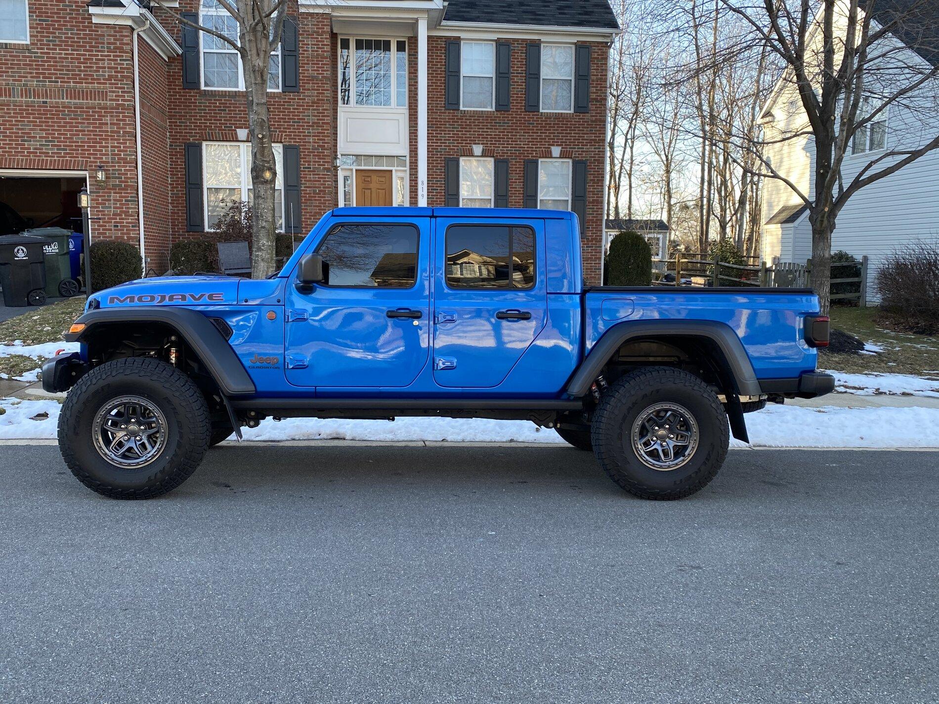

@Maddaw My truck has AEV wheels, a full @Clayton Off Road control arm kit, 37s, AEV geometry brackets. No rub so far at full lock.
Have not dont full lock and full stuff yet; but i dont expect an issue. I think my axles are wider though, if you arent max tow
