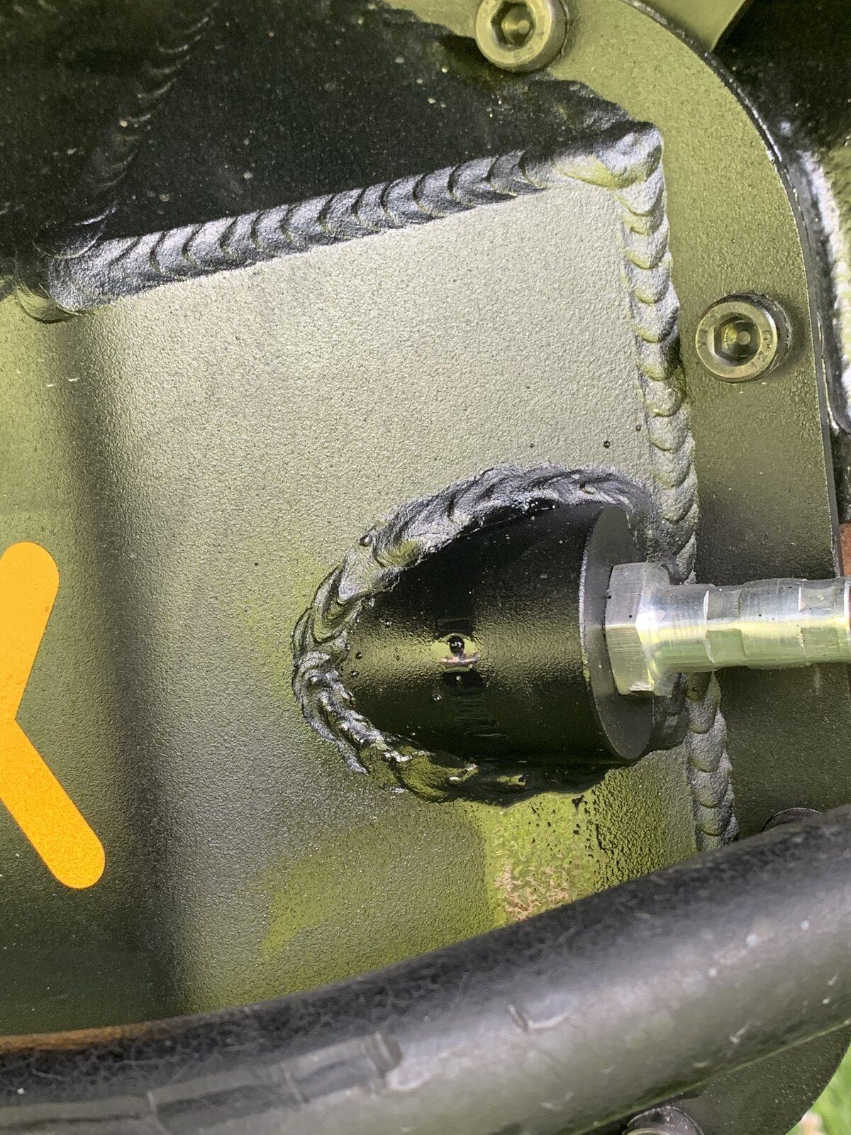

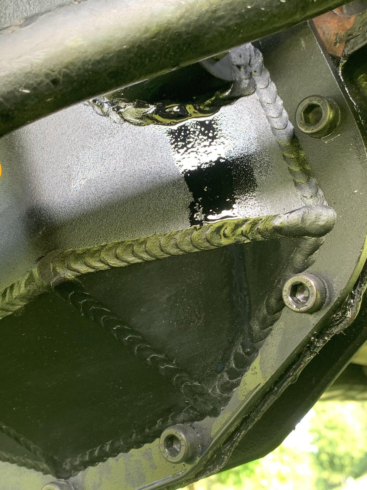

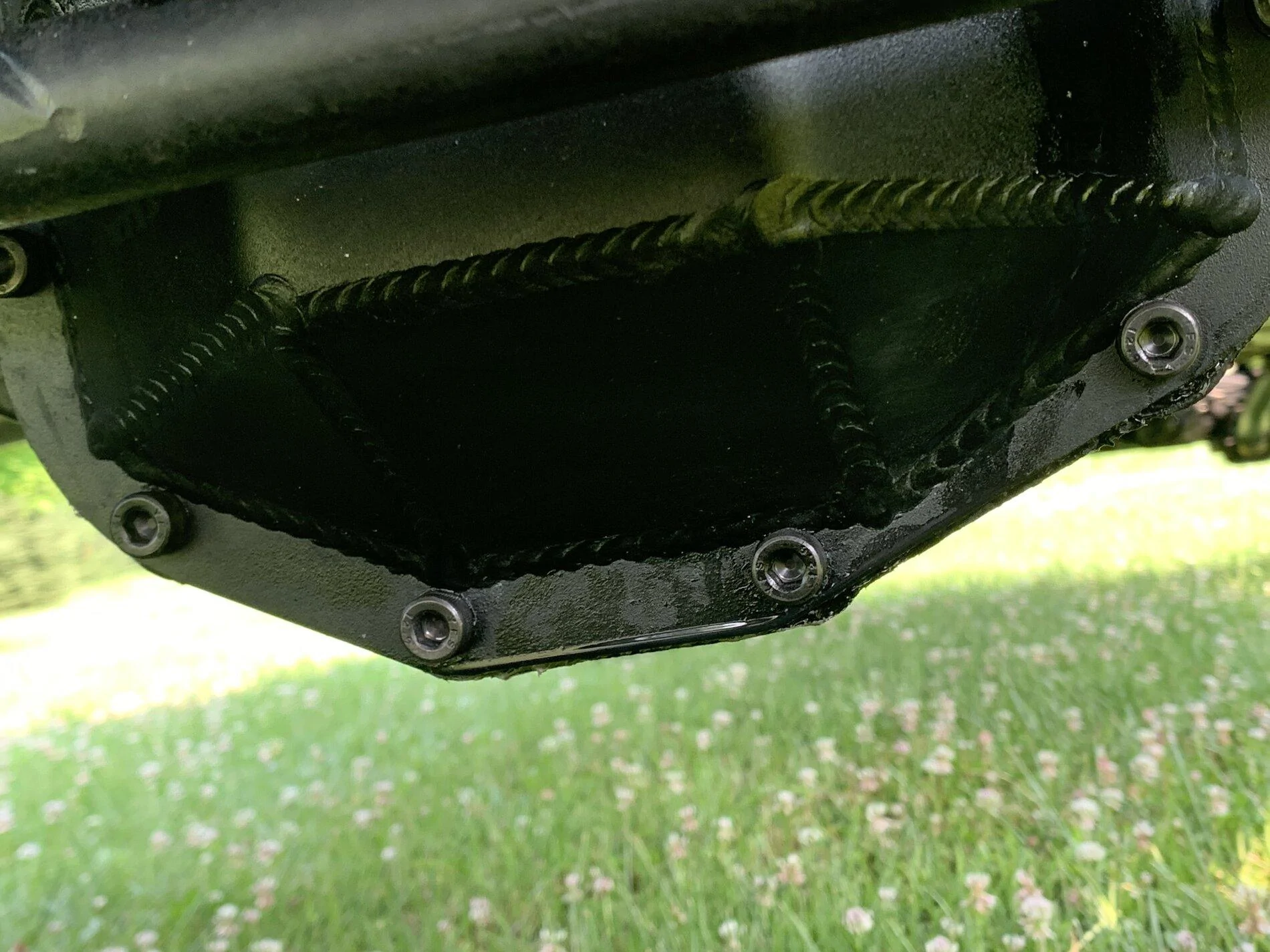

Thanks for the information. I drove my Jeep to the store today to pickup some stuff. When I got back it looks like more is leaking out then I think, maybe. But the drip pattern is weird. Either it is leaking from a weld on the cover or it’s riding up.

Leaking from one or both of the craters dead on top. The weld isn't tied into the bung.
Keep an eye on lube level, when you go for lube change inform the shop and show them where it's leaking.
Yeah I’m going to park it on a hill so I can get the proper pinion angle to fill the axle and check the level tomorrow. I did fire an email off to OX locker showing them what is going on.

The welds do look great everywhere on the axle cover except for the bung. Looks like it was done all with tig welding. I could take it to work and have it welded by one of the welders who does excellent tig welding. Will have to wait to see what OX says though.
Yeah that looks like someone needs to give OP a new diff cover.
That's all MIG welding, wire feed. Whoever did the bung was having a bad day, or is still learning. From an Inspector's view, there are too many issues with the bung weld.
MIG would explain the splatter that wasn’t cleaned up before powder coating.
Whoever welded that said some,"HmMmN mEh lUkcs gOud tOo mE "??
Yeah no problem to be seen lol.
I’ll have to wait to hear what they say tomorrow since they weren’t open today. They did email and text me though. So we’ll see what they will do for me.

That looks easy to fix if you have access to a welder. Remove the cover, grind the bung weld at the top and make another pass. Should be sealed up after a good pass
Taking it down the road to get TIG welded today.

Got it welded and the welder botched the cover. OX is getting me a replacement cover which is cool.
