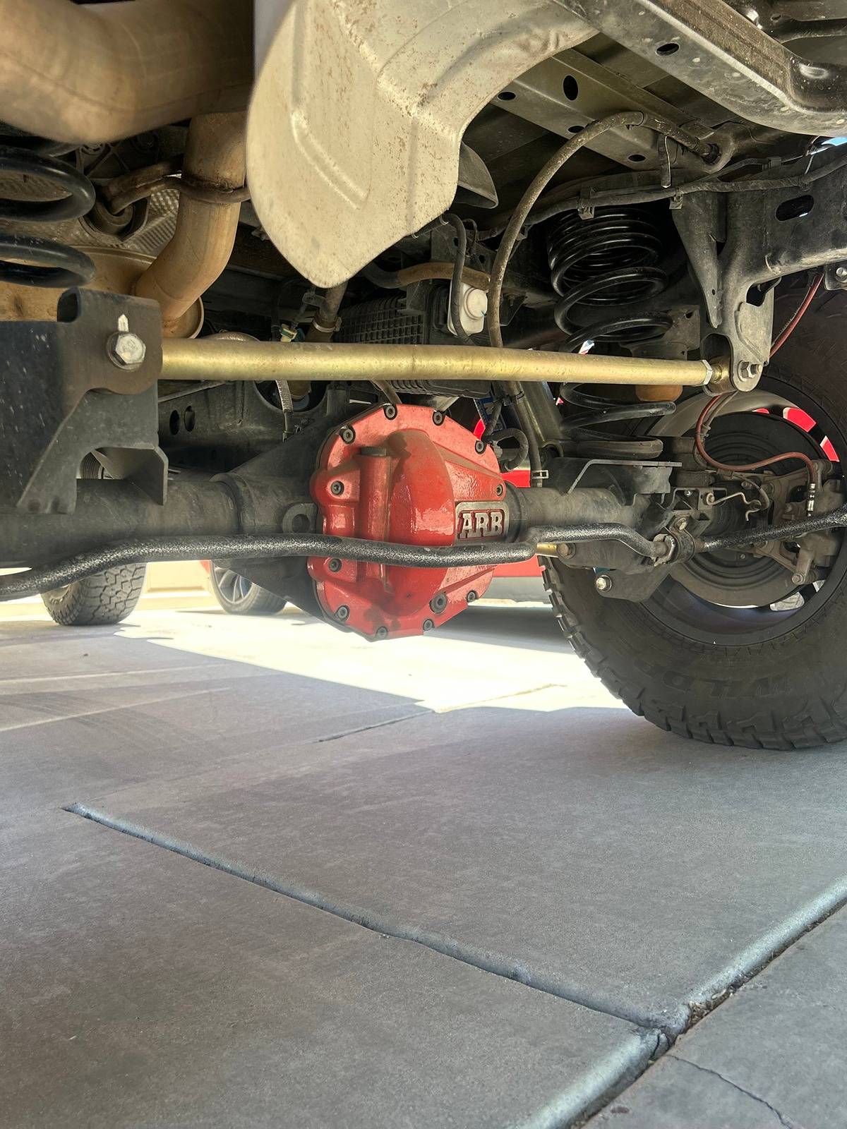

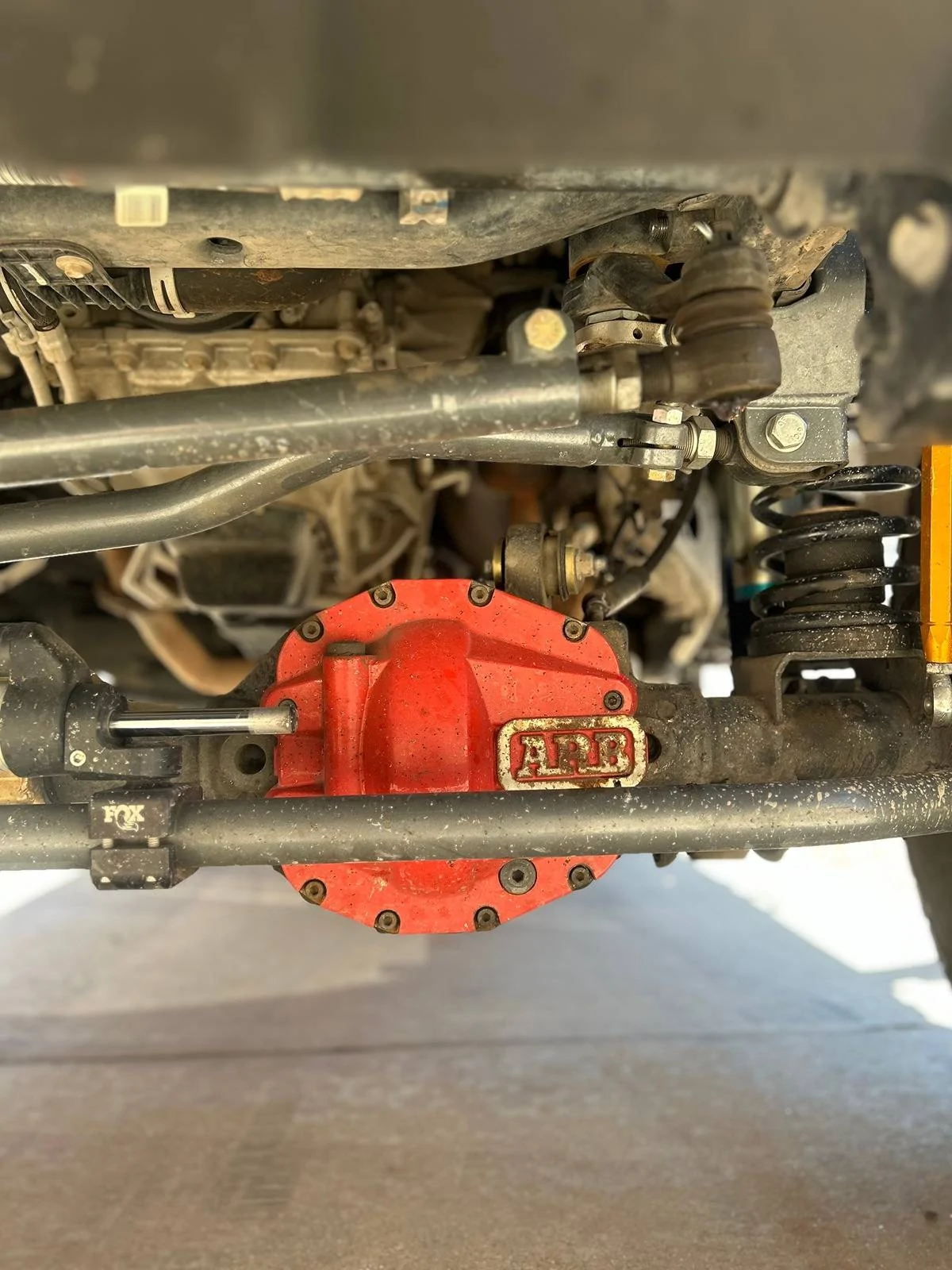

I have the nodular iron Dana covers. They have the same inside shape as the stamped oem covers.
Just about any iron cover is better than the oem cover, off road.
Did you need a spacer for the rear sway bar/any clearance issues on front trackbar?

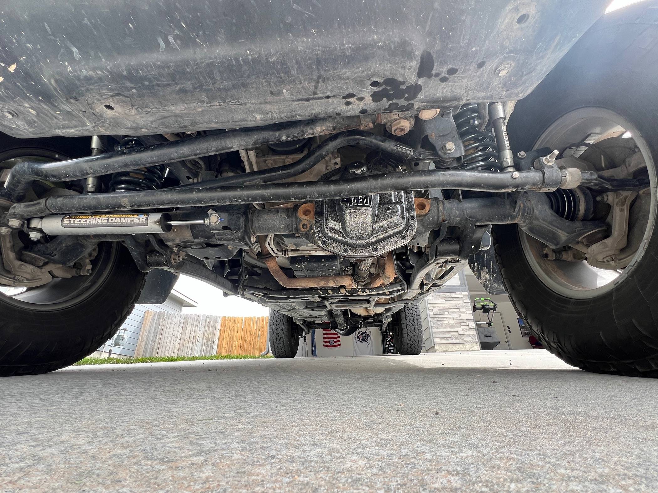

Josh, did I miss which skid you have or both? Not sure which I would buy first but think the rear would be my choice between that long wheel base.
Look at hjdca's pictures of his diff, in the picture I see a solid skidded setup, front control arm skids, rear control arm skids, oil pan skid, rear shock skids and a sway bar system high and safe. I choose to not lift and won't put bigger then skinny 34'" tires on so I'm skidded everything just short of a full belly skid., and even my oil pan skid is a New Venture Modular that later I can fully belly skid the bottom by adding to it......Jack
No spacers in the rear. The front cover clears the Core 4x4 track bar.
Great point... lol... You cannot tell in the pictures because all those skids have been painted many, many times. especially the rear control arm skids... You may be able to see some dents if you look closely enough... No matter what your lift kit and tire size, I recommend a full set of skids for the control arms, shocks, skids, diffs, etc... ; and if you are going to do the Rubicon trail, I would also get the engine, tranny, transfer case skid.... I did not get the exhaust skid and I already tore up two mufflers.... lol... --- and i have a 3.5" lift with 37s.

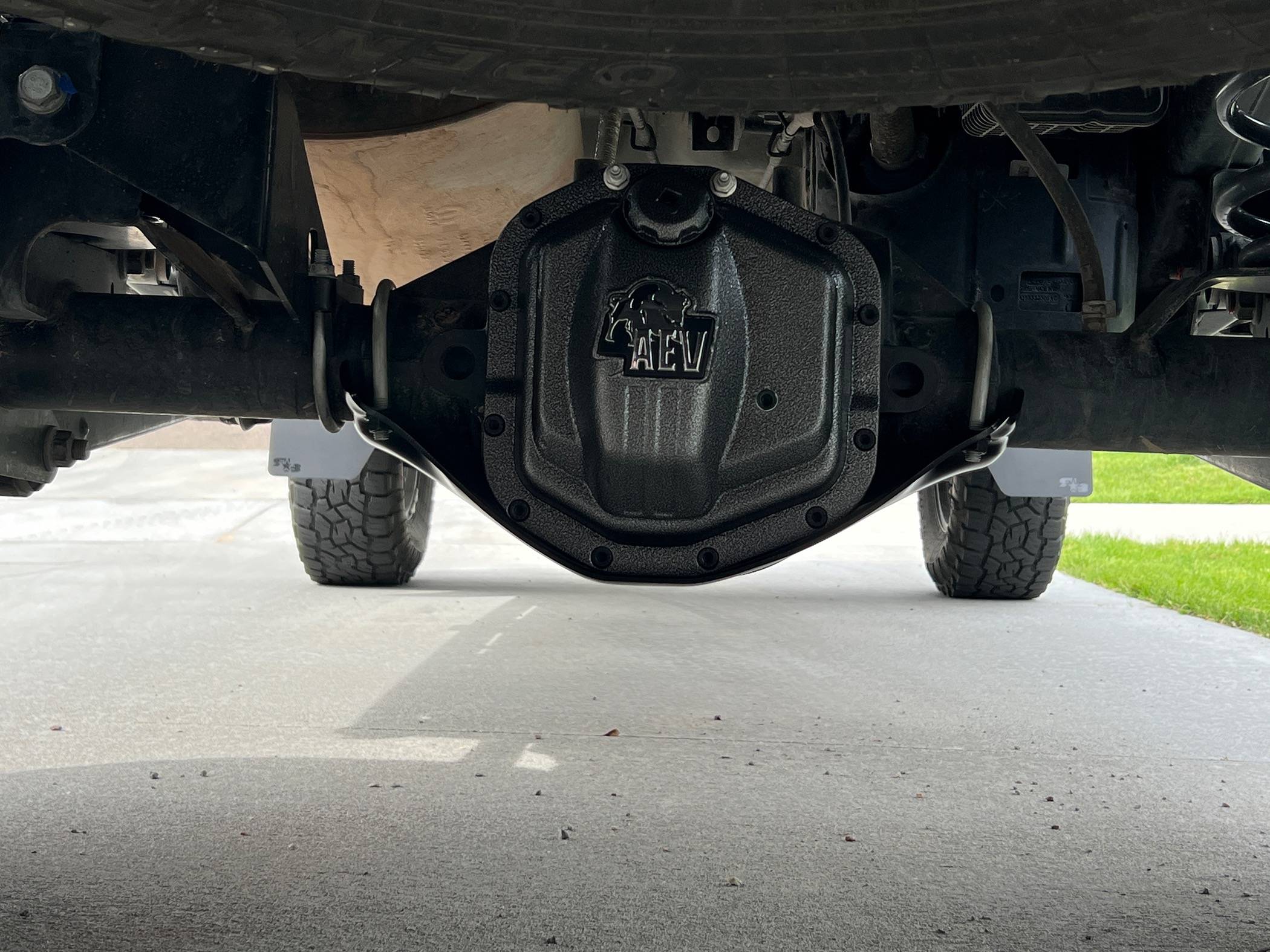

AEV covers are in!
Do have a clearance issue with the skid, have spacer coming that I hope addresses that.

I would definitely do the front and rear skids and covers. Protecting the pumpkin is important to me personally from damage and scrapes.
I’m doing the AEV coverage right now. One cover is a little bit ugly in the casting with deformities in the material. I heard some complaints from other people. It’s too bad. It’s a cool cover with a big inspection, fill Port I love. I’ll send aev a message.
The other problem is, there’s no magnet like OEM fill plug? I’m pretty shocked that they did that. I’m trying to figure out what kind of a plug and I think I might have figured it out after all this trial. 1/4 inch pipe plug. I’m gonna order it now from gold plug. If anybody is interested, let me know and I can post back if it worked.
EDIT: Drip plug magnet. For AEV Cover.

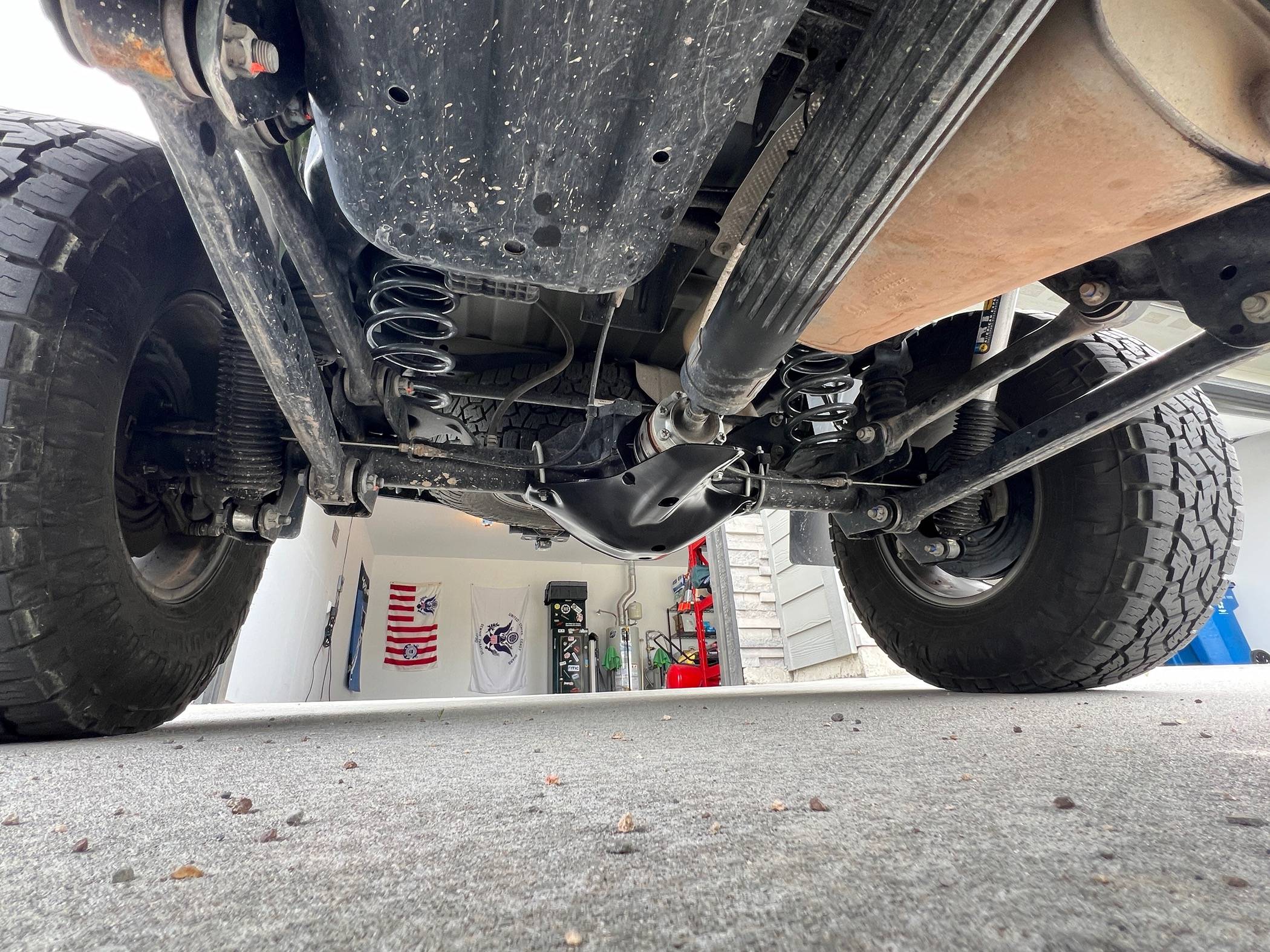

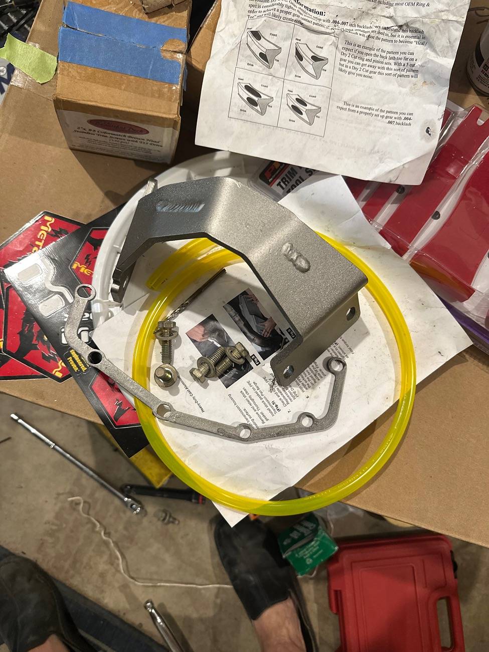

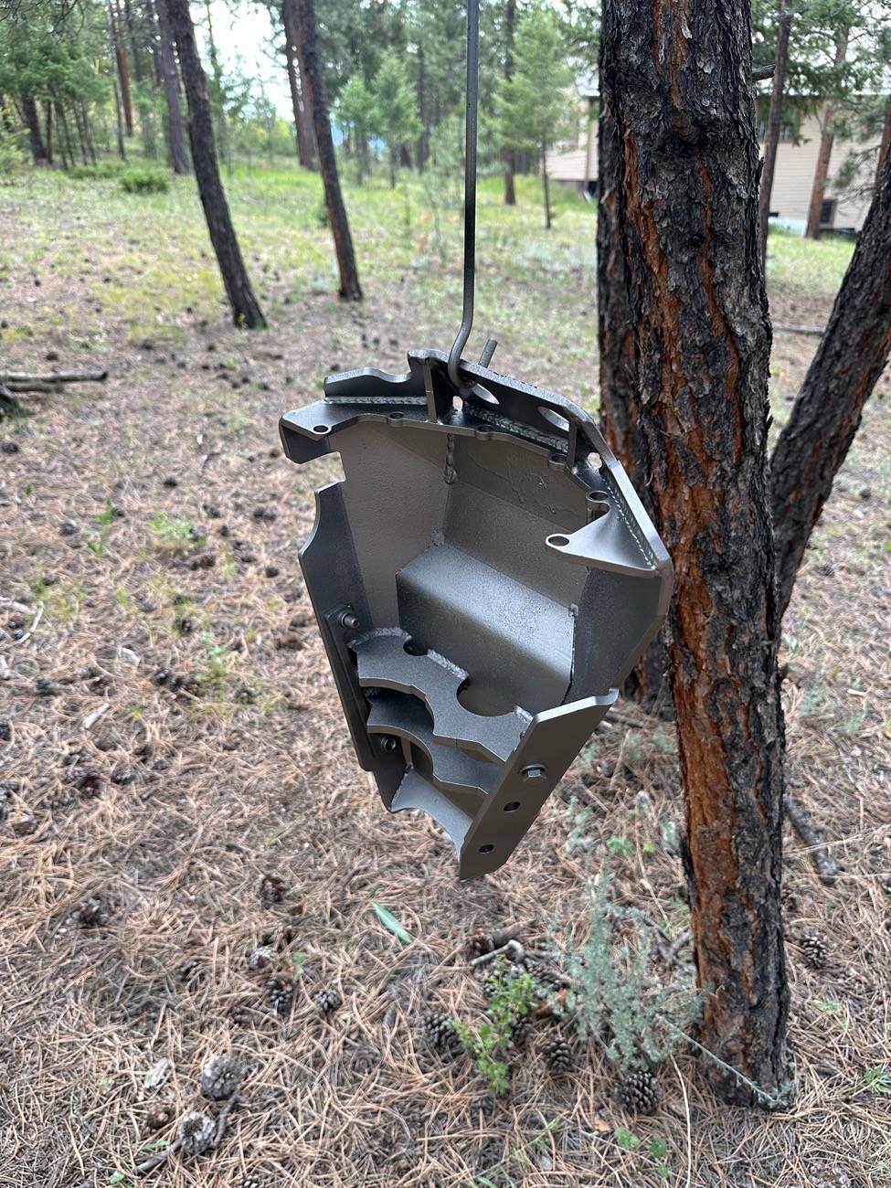

I think you’re fine with factory covers. I just wish I was ordering now. I’d absolutely get the zinc coating. I just got done repainting the front skid, and the rear is next. You can see the spacer in the first picture.
Jeep Gladiator Lets talk Differential Covers! IMG_3043
Jeep Gladiator Lets talk Differential Covers! IMG_3048
