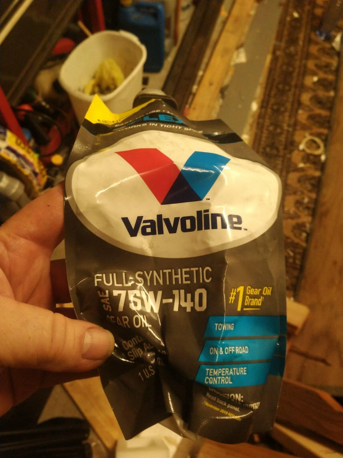

I replaced the OEM fill a short time back with synthetic 75W-140 Valvoline.
One reason the bag of gear oil is easier to use. But I do normally use synthetic oils is it better, I don't know. I've not seen any problems with regular or synthetic in axles. Next change might be factory recommend wt. if I can get it in a gallon jug. I used not quite 3 qt bags.
