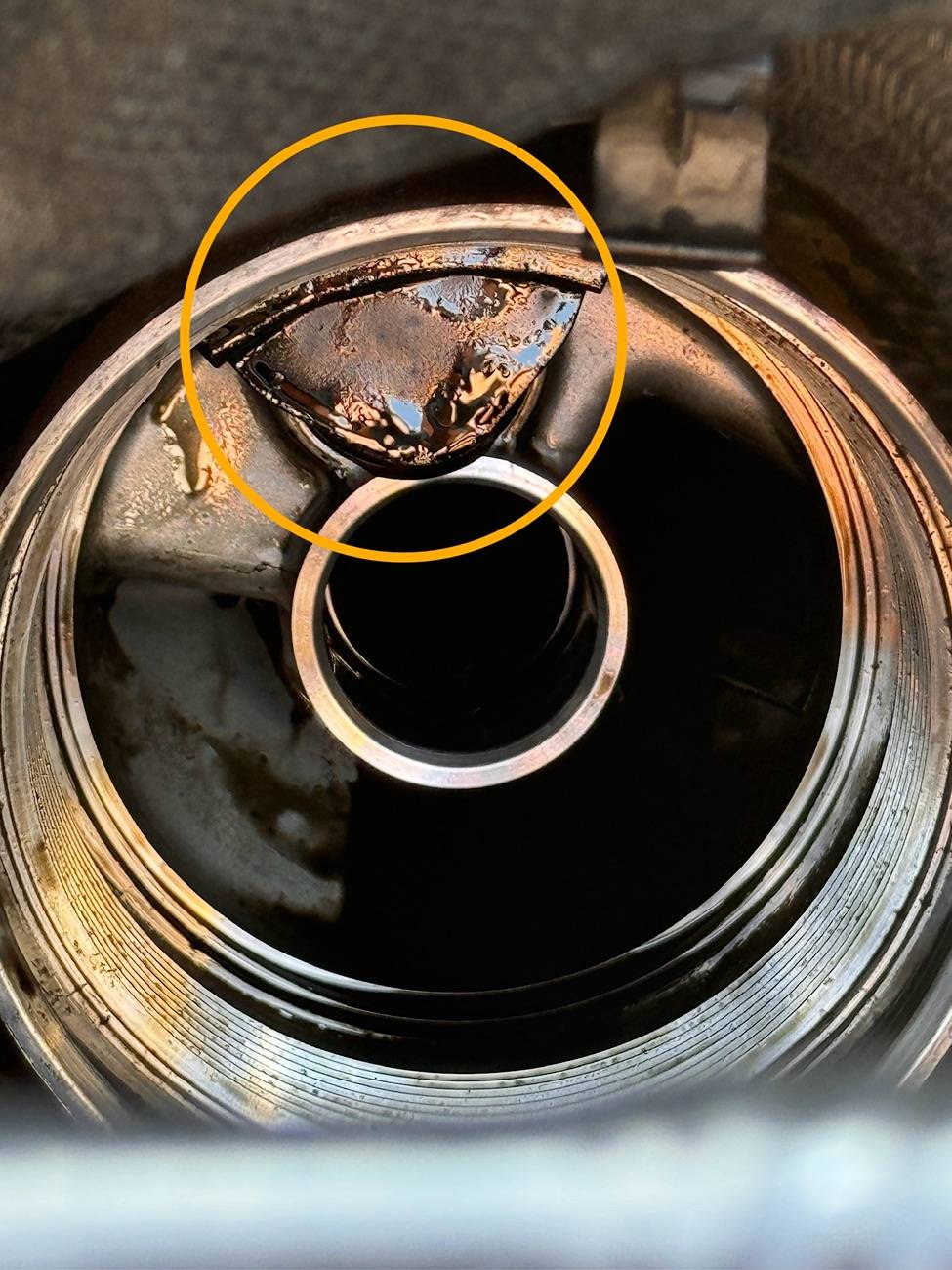

Did another oil change today. This is my final attempt to eliminate the random intermittent low oil pressure warning before I replace the oil sending unit and then attempt to get the oil filter housing warrantied.
I noticed the following:
  1. I takes forever for the oil to drain out. Maybe I’m being ultra sensitive because I’m now expecting issues. But it continued to drip steadily for over an hour. Yes, the filter was out the fill cap was off. I don’t remember this the last time I changed the oil.
  2. This plastic doohickey. It’s spring loaded and pushes in presumably when you screw in the filter. Mine is gritty and flimsy feeling. I’m curious if this is part of the issue. I do know, that the only parts you can buy are the sensor/sending unit, filter and the whole large filter cup assembly. I’ve been told that it’s covered under the power train warranty
    Jeep Gladiator Low oil pressure warning after oil change. IMG_4797
  3. When you torque to 25NM, the ridge in the cap is perfectly aligned with the ridge in the cup as others have observed. However, I went a little farther after the torque wrench clicked and there’s a definitive stop about another 3 degrees past that point. I wonder if this is the issue, stopping at the specified torque setting is still not fully seated even though the ridges line up.
  4. Upon startup, I had a low pressure warning. I let it warm up, stopped it, started again and the warning was gone. I observed the same behavior last time I changed the oil, and then didn’t have another warning for several months until the intermittent problem started.
