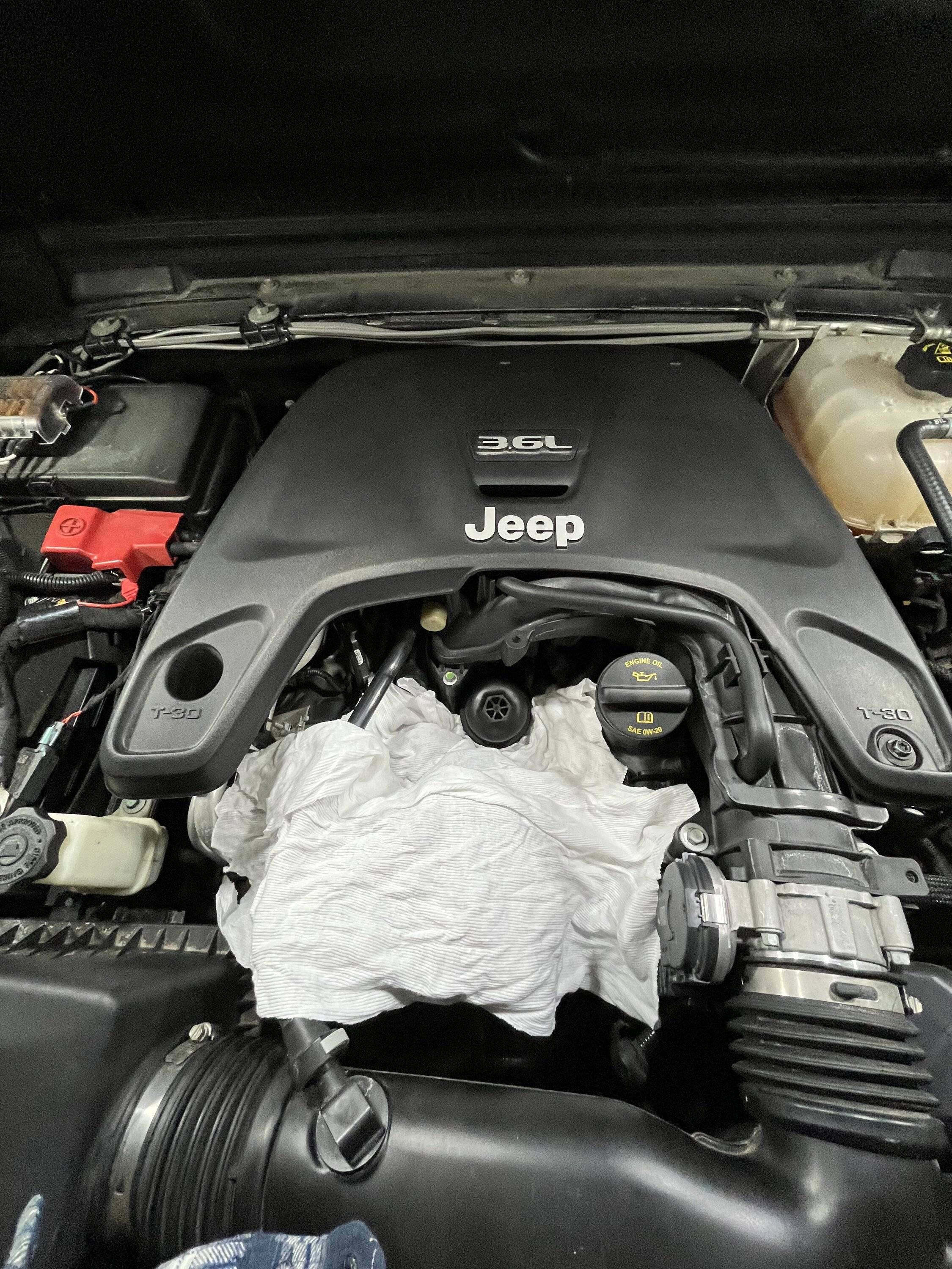

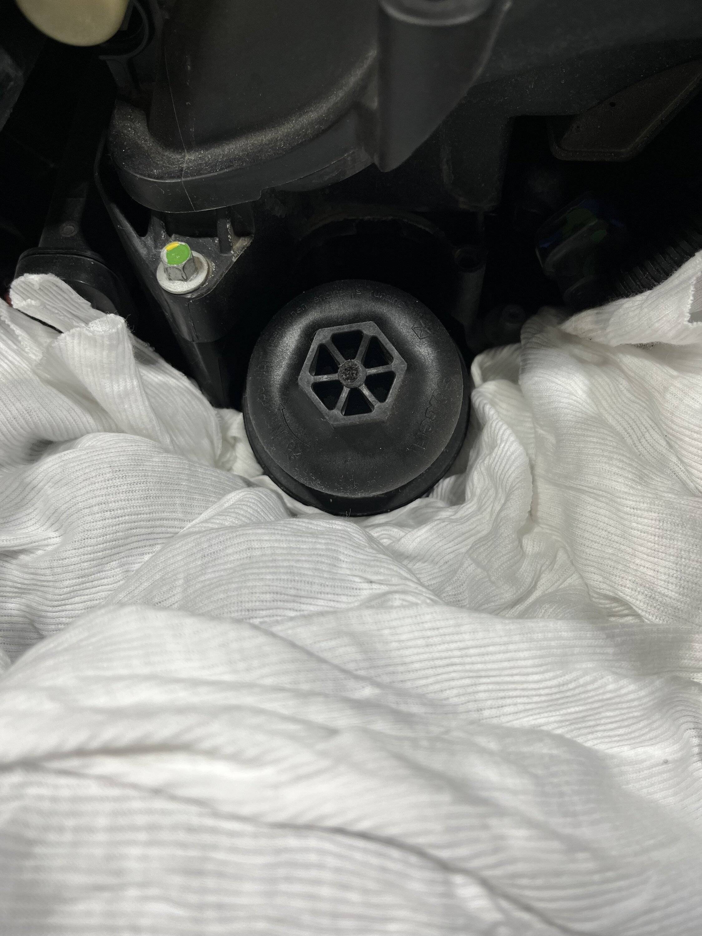

It’s a good idea to place rags around the base of the oil filter cap to catch the dribbles. Before pulling off the filter cap from the threads, just undo it and let the air in but leave the cap in place to drain a few min while you work underneath. By the time you’re ready to pull the cap out, all the oil would be long drained back to not the engine and there won’t be any mess.
Once the new filter is in place and cap torqued down, spray brake cleaner around the base to clean up the oil that drained down the sides and made that mess.

The ridge you have highlighted does sit flush with housing. I will try and provide picture tomorrow.

I didn't have the filter tightened enough... there was a gap between the top ridge of the oil filter and the oil filter housing base of about 1/4. This must have caused a small amount of oil to run down and cause what I thought was a leak.
Today I cleaned the area were I thought it was leaking thoroughly, removed the filter and applied a small amount of high-temp grease around the threads of the filter and the o'ring... this time the filter went on with ease... no binding and no scary creaking noises... lol. I was easily able to bottom out the filter housing to the oil filter ridge... I did try to torque it , but it seemed way to tight and I wasn't feeling safe to keep going until my HF 5-80lb torque wrench clicked... so I tighten it about a quarter to one half turn passed when it felt good-n-tight... I'm thinking about buying a digital torque wrench or a digital adapter to reseat and torque it... I just don't trust the HF wrench.

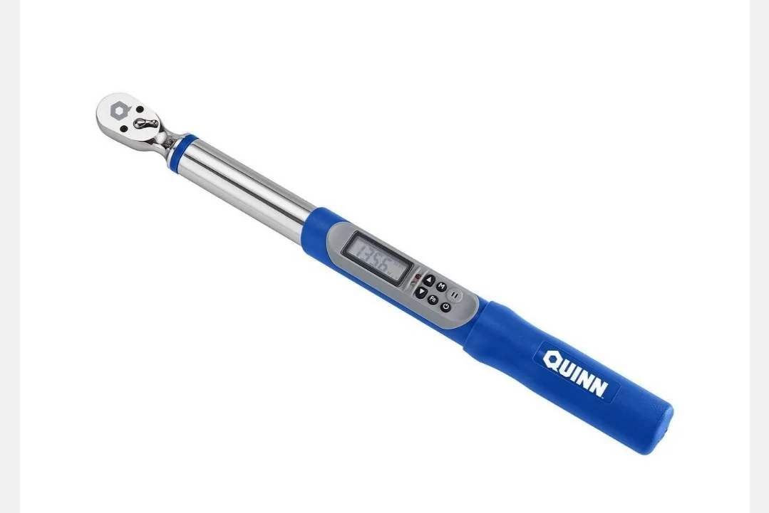

Looking at ones like this (thoughts on these ?)
Jeep Gladiator Low oil pressure warning after oil change. Screenshot_20231106_210613_Chrom
Its about $40 and torques between 6-60lbs

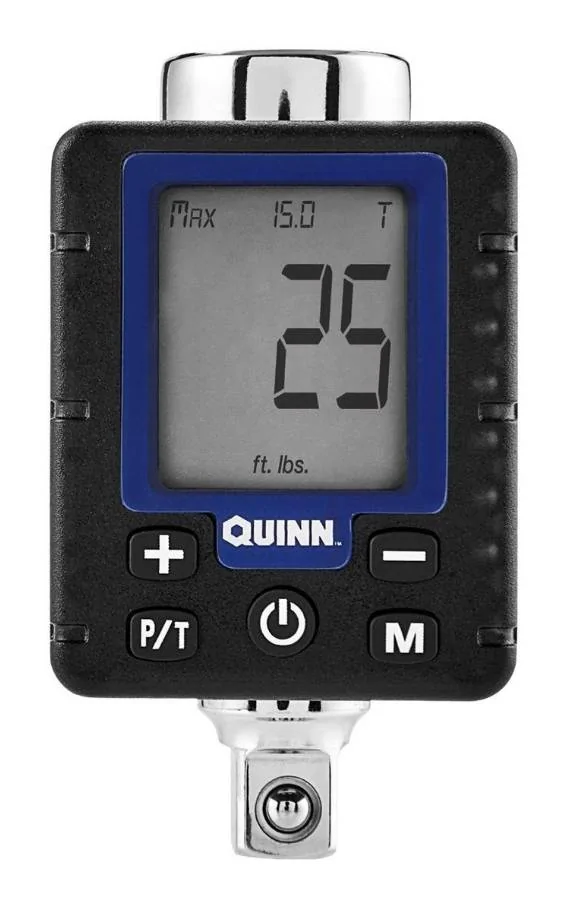

Update #2
I picked up a 3/8" digital torque wrench adapter. Like this:
https://www.harborfreight.com/38-in-drive-59-59-ft-lb-digital-torque-adapter-58705.html
I will say, if this adapter is correct , which I think it should be since 18.4 ft-lbs is close to its sweet spot (5.9 - 59.9 ft-lbs torque range)... I had the oil filter over tightened... not by much, but definitely more the the 18.4 ft-lbs thats called for. Actually, the correct torque isn't much passed the filter stopping once it bottoms out on the base of the filter housing and the support ridge of the oil filter. Maybe a 1/4 turn...

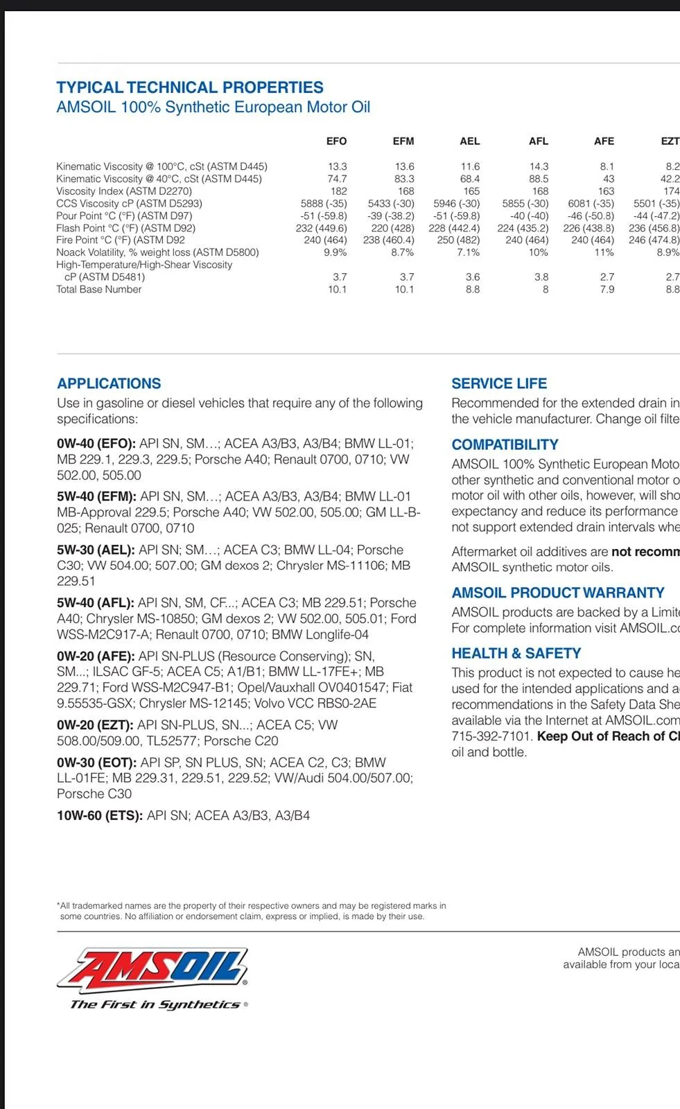

Have you used this oil previously for this JT? I have had this same low oil pressure after doing my own changes. Once was from an over torqued filter and the other was after using a non MS-12991 syn oil. I looked up the Amsoil data sheet and I didn't see MS-12991 spec listed. This engine is so finicky who really knows. I attached the data sheet
Interesting. I would think that if viscosity grade was the same between the oils used, oil pressure would not be that much different regardless if one oil lacked manufacture spec.
