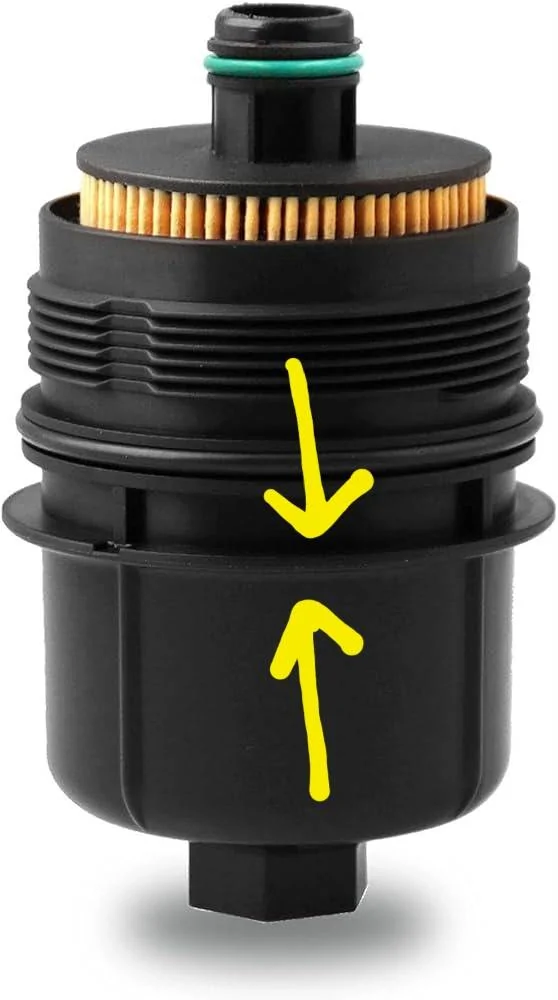

I know this post is a little old.... but I just did my first oil change and I didn't have a 3/8" to 1/2" adapter, so I couldn't torque my filter....
Would you mind taking a pic of your oil filter from underneath the vehicle, unless you can get a side shot.
The reason I ask is, on the oil filter , there is a ridge above the threads where it screws in the housing. I'm trying to figure out if it is supposed to be flush with the oil filter housing or if there is a gap.

I just did my first oil change and I didn't have a 3/4 to 1/2 drive adapter, so I couldn't torque my filter....

Pic of the ridge I'm taking about.

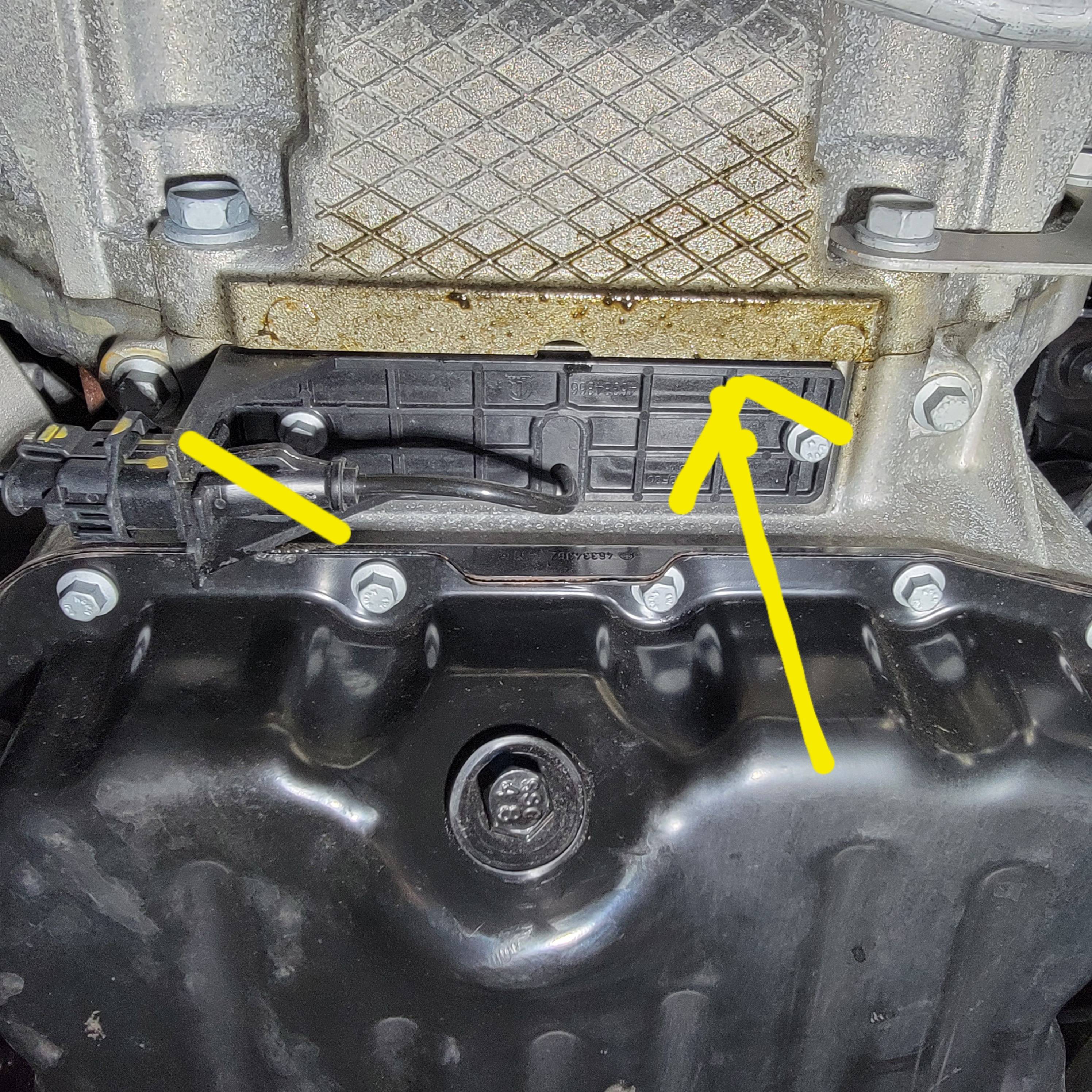

Did my first oil change, and I noticed this leak afterwards, but I don't remember seeing it before. Can someone please tell me what part this is ? Looks like a heat sensor to me....
but
could changing the oil even cause a leak here ?I looked for oil spill from filling and any that might have spilled from removing the oil filter, but I didn't see any and I really dont think it could migrate to this location.

Also can anyone tell me if the ridge above the threads on the oil filter are supposed to be flush or is there a gap between it and the oil filter housing ?
but
The ridge you have highlighted does sit flush with housing. I will try and provide picture tomorrow.
but
The ridge should be flush with the housing. The 18ft lb torque is against that ridge and the housing.

I didnt want to over tighten... I will put a torque wrench on it tomorrow... just a little nervous on first change.. to many cracked housings. Thanks for confirming..
Hopefully that might be the cause of the oil leak... possibly a small amount is coming out... I just didn't think it could reach that location from were the oil filter housing is... but now that I zoom in on the pic, it looks like it migrated from the sides of the trans housing.
I will clean the oil where the leak is and torque the filter.. need a 3/4 to 1/2 socket adapter first.

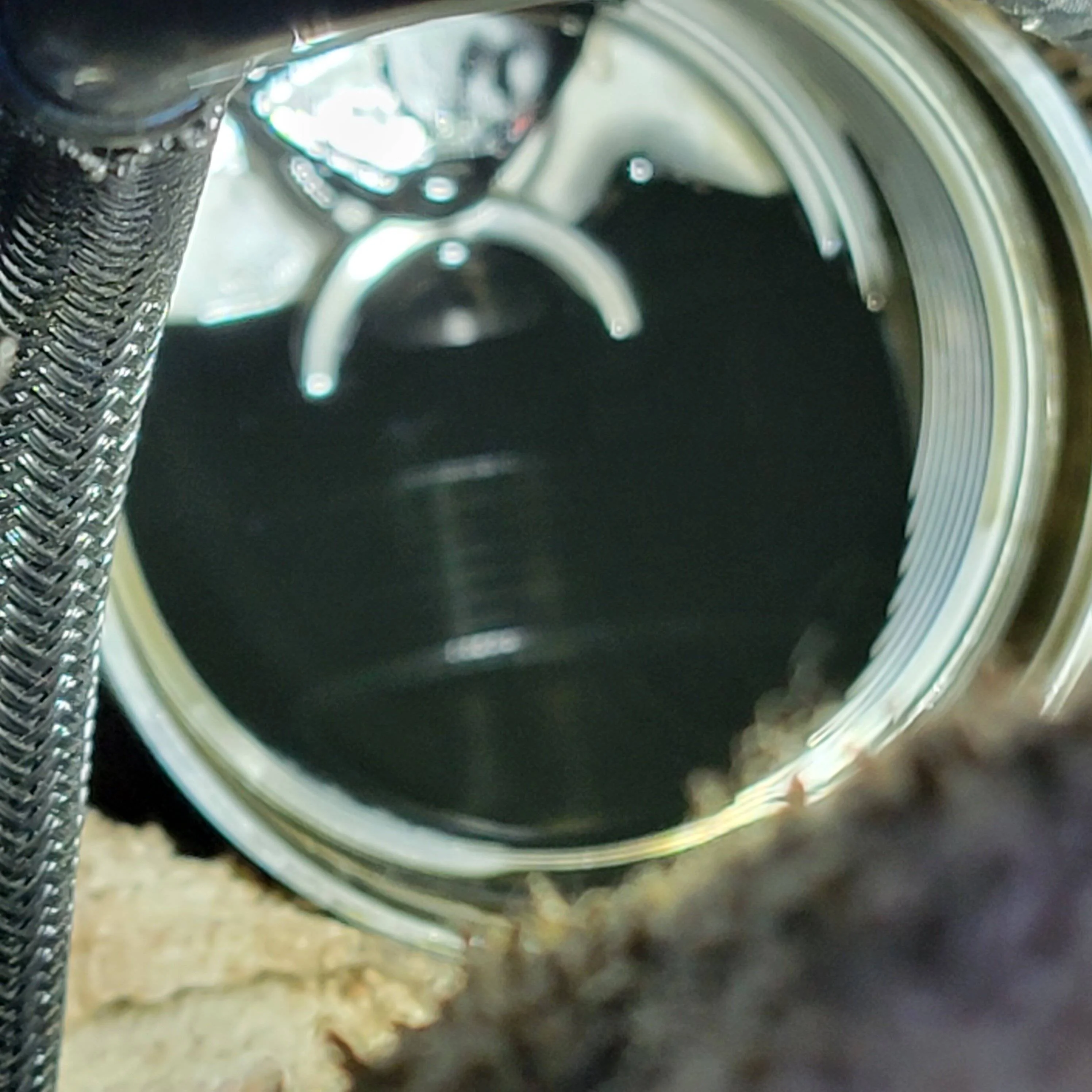

Is it also normal to have a small pool of oil left in the housing when you remove the filter ?

The oil pool. Mine had it.
