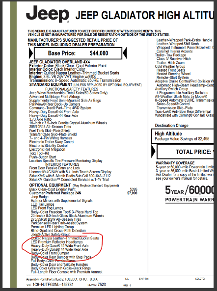

Grounds manager
I'd look around for more pictures of examples of what you want before buying. HA to my knowledge has wide axles, which means -12 is going to be more than most people's definition of "a little" poke. I'm at +6 on 315s (which would be equivalent to -9 on 285s) and it's a little more poke than i would like which is why i put XR fender flare extensions on mine.
No only rubicon and sport with max tow package have the wide axles.

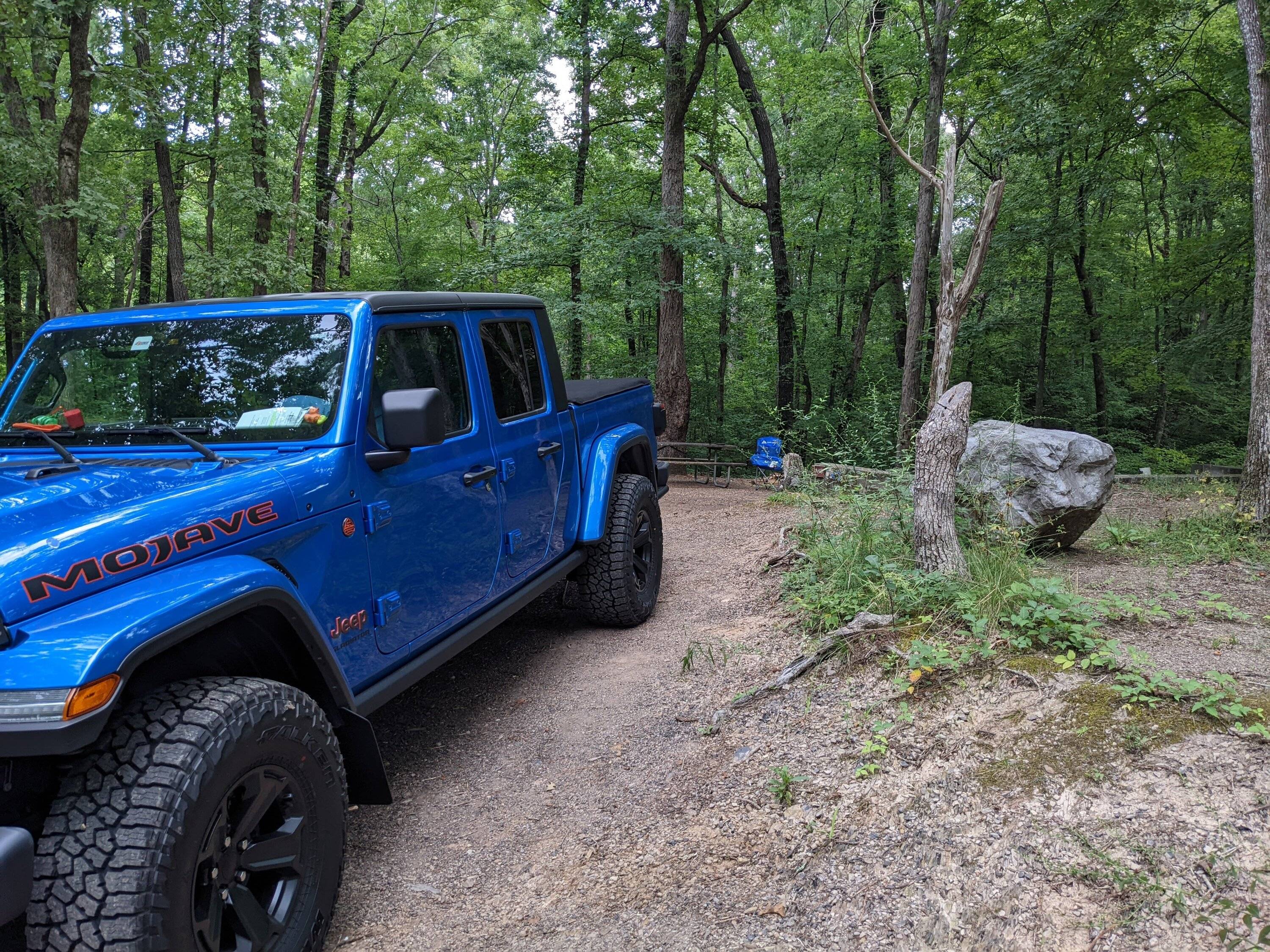

You might keep yours eyes open for some Mojave AT3 take off wheels and tires. Will give you a little more poke and the bigger tires. The good thing is they are generally pretty well priced. I think I sold mine for $1100 and all you need to do is put them on your truck. Good Luck. BTW I run the Load range E Wildpeaks and I like them so much that is what I went with for my 35s. The stock tires and wheels on my Mojave did not give me the poke I was looking for, so I ended up with 12.5 wide tires and a rim that has an offset of +12 instead of the +37 the Mojave wheels have.
Jeep Gladiator Dipping my toe in the modding water PXL_20220807_121126448
