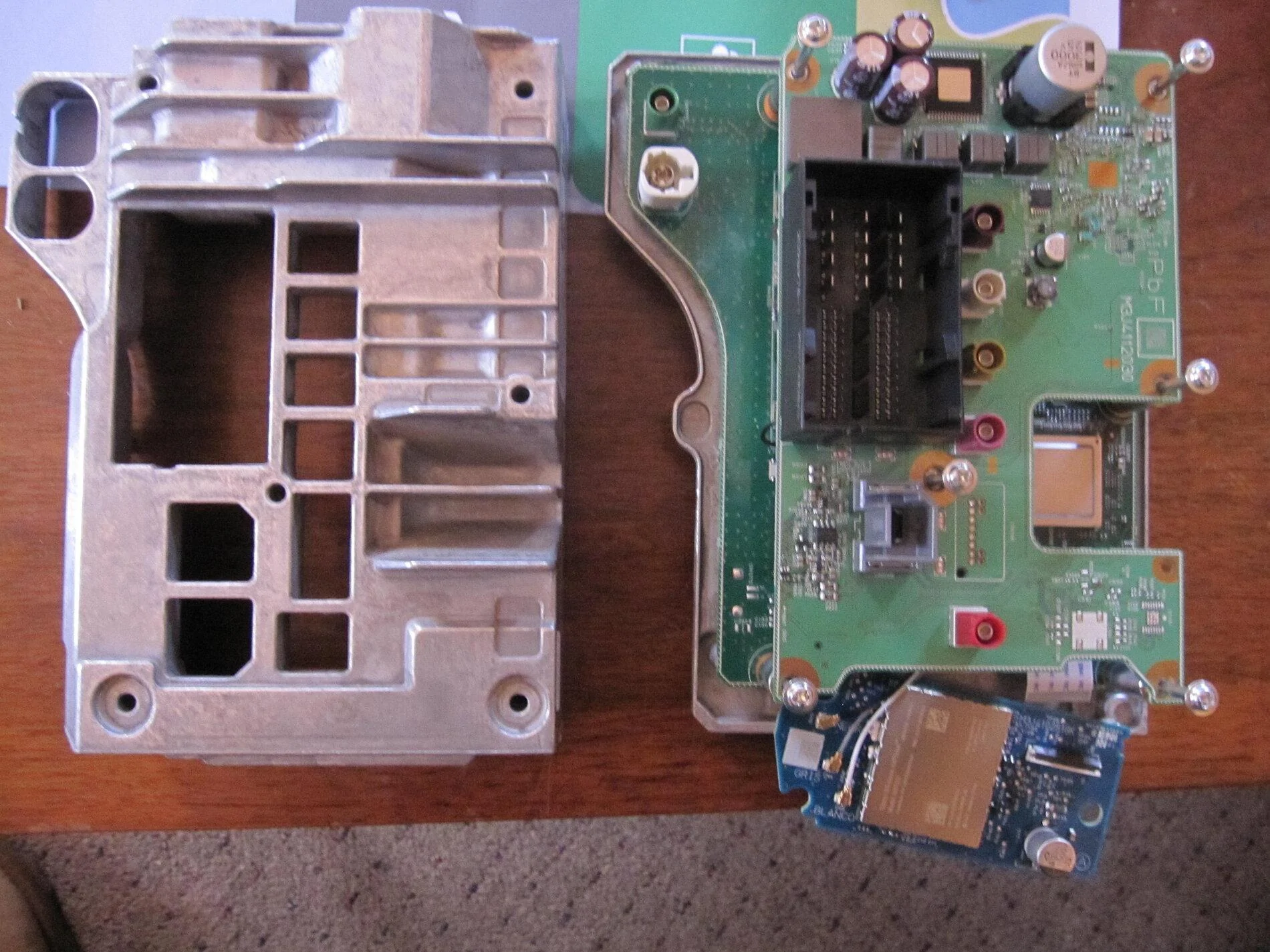

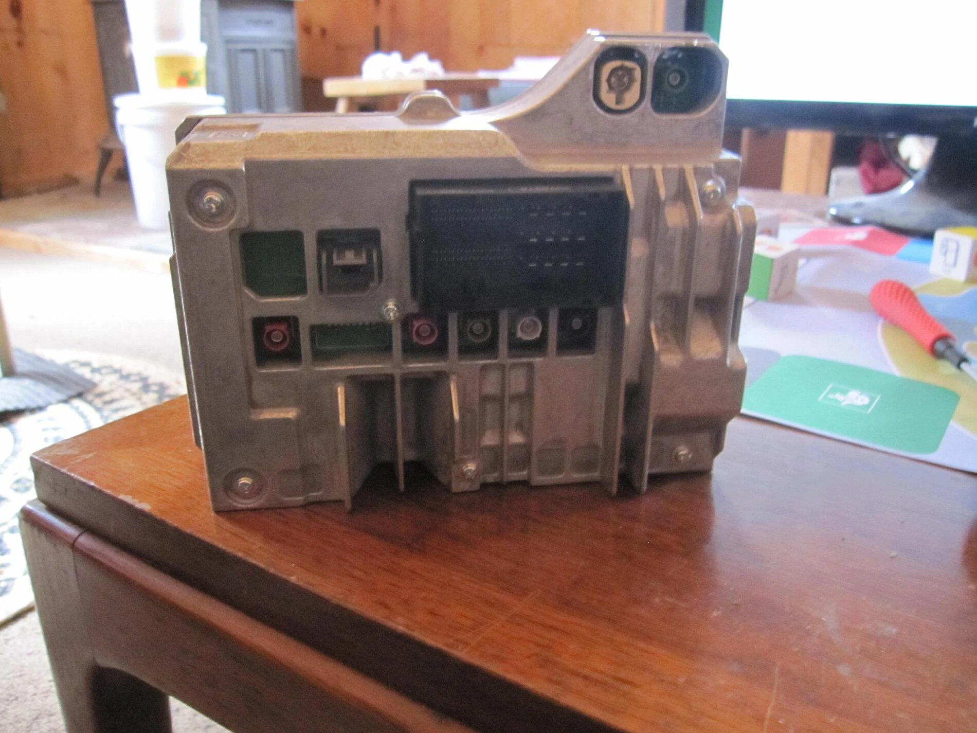

Hi,
Interesting thread. I just bought a 2021 Grand Cherokee and I'm going through the process of disconnecting it from the internet. A few points regarding what I've read here so far:
1. Disconnecting the antennas in back of the radio will not stop the 4G modem from hooking up to the cellular network. It will reduce the effectiveness of the modem, but the modem will function without external antennas, just like an iPhone or other smartphone will work without external antennas. If you're in an area with strong cellular signal, the modem will connect.
2. Tin foil won't help either. The modem is inside the die-cast casing of the radio head unit, surrounded by metal, but the signal gets through anyways. I have seen conclusive proof of this, from someone who disconnected the antennas and attempted to shield the unit. The 'bars' for the modem meter, which are buried in the Settings of the display application, showed that the modem was connecting anyways.
3. There is no way for the user/owner/consumer to turn off the 4G modem from software.
Therefore, the only way to disconnect 4G is to remove the modem. I purchased a spare radio unit, see photos below. The 2021 unit is from Panasonic, which includes two boards, with the following chips:
  • a Panasonic radio chip model j3bbzzb00074 that supports AM / FM / HD / Satellite, GPS and (apparently) Bluetooth and Wifi
  • a main controller, or 'computer chip, which is a Texas Instruments Jacinto DRA752, model APP2ABCQ1
  • a Sandisk 'secure data' flash memory chip, SDINBDG4 - 32GB. This is where the operating system (I think it's Android, it might be some other form of Linux) and applications live.
  • a Sierra Wireless AirPrime AR 7552 4G modem, connected to the upper board by a ribbon cable, probably a USB cable. This modem supports various cell phone networks as well as GPS. This means that there are two GPS chips in the unit, one in the Panasonic radio chip, the other in the modem. Removing the modem should not kill GPS on the nav system entirely. It should just make the navigation function less 'smart', like an old Garmin (I hope).
  • There are three antenna connections: 'primary', RX2 ('secondary') and GNSS (GPS).The antennas feed both the Panasonic chip (by traces on the circuit board, and a single point-to-point wire) and feed the AirPrime modem by three point-to-point wires.
  • A few other chips, like an NXP audio digital processor, a TI audio amplifier, what appears to be a big RAM (random access memory) chip, and some mystery chips that are unmarked or under covers.
The Panasonic unit for 2021 is separate from the touchscreen display. It comes apart with 6 screws. Carefully open the case, the modem is in the side of the case under a metal clip secured by three screws. Remove the screws, separate the modem from the case, unsnap the antenna wires from the modem. Then remove the USB ribbon cable from the connector on the upper board, and remove the three antenna cables from the upper board.
See photos. The modem is the blue thing with the shiny chip in the lower-right.

Unfortunately the results of the above experiment are not satisfactory at this point. Although the climate controls work fine, and no errors came up on the screen, or on the dash, or anywhere, the radio and XM aren't quite right. The sound will come on for a second or so when I touch the screen, and then silence. I'm going to swap back the original radio and attempt to debug the modified one.
Feb 21, 2021
USA
Grand Cherokee 2021, Ram 2500 2001
Actually, I was wrong. It's all working fine. No Nav/GPS, but that's OK. Sirius and FM are fully functional. I don't know what I did to 'fix' it, there must have been some sort of mute function invoked, or maybe it was the park-sense, or something else that needs to use the audio channel. Dunno. For now, I'm happy and there's no modem spying on me.
