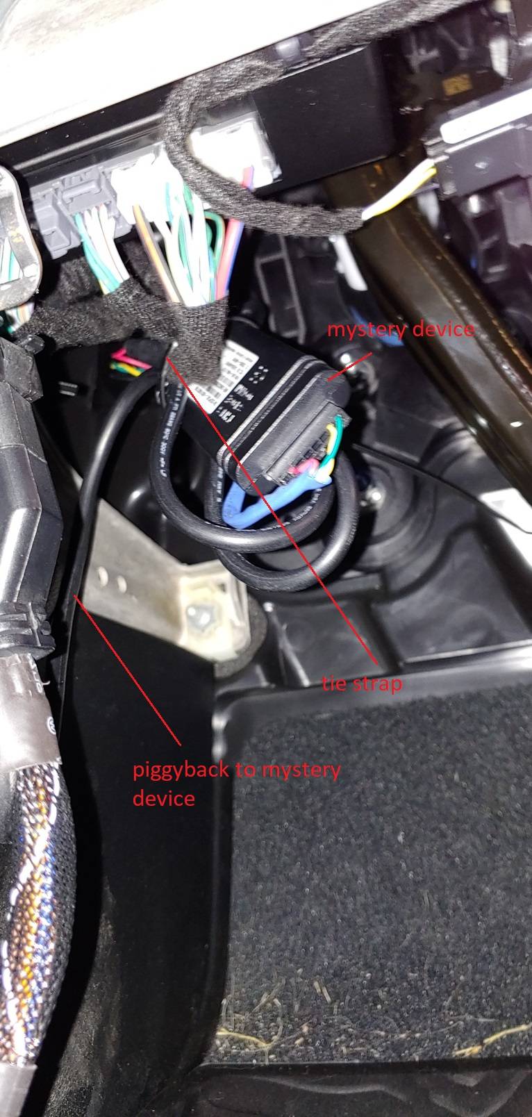

My dealer also installed a GPS tracker and wired it into an OBD pigtail. It was part of the $3,600 “protection package” which I laughed at and refused to pay.
Seeing as how its permanently powered through the OBD port, I suspect it is a constant parasitic drain on the battery while parked. I unplugged it and its sitting in a shoebox in my garage.

Found it...will have to pull the wiring out later today when I have more time.
It was certainly active, as when I was moving it around, it would flash from green to red.
That's identical to those I have locked up in my cabinet.

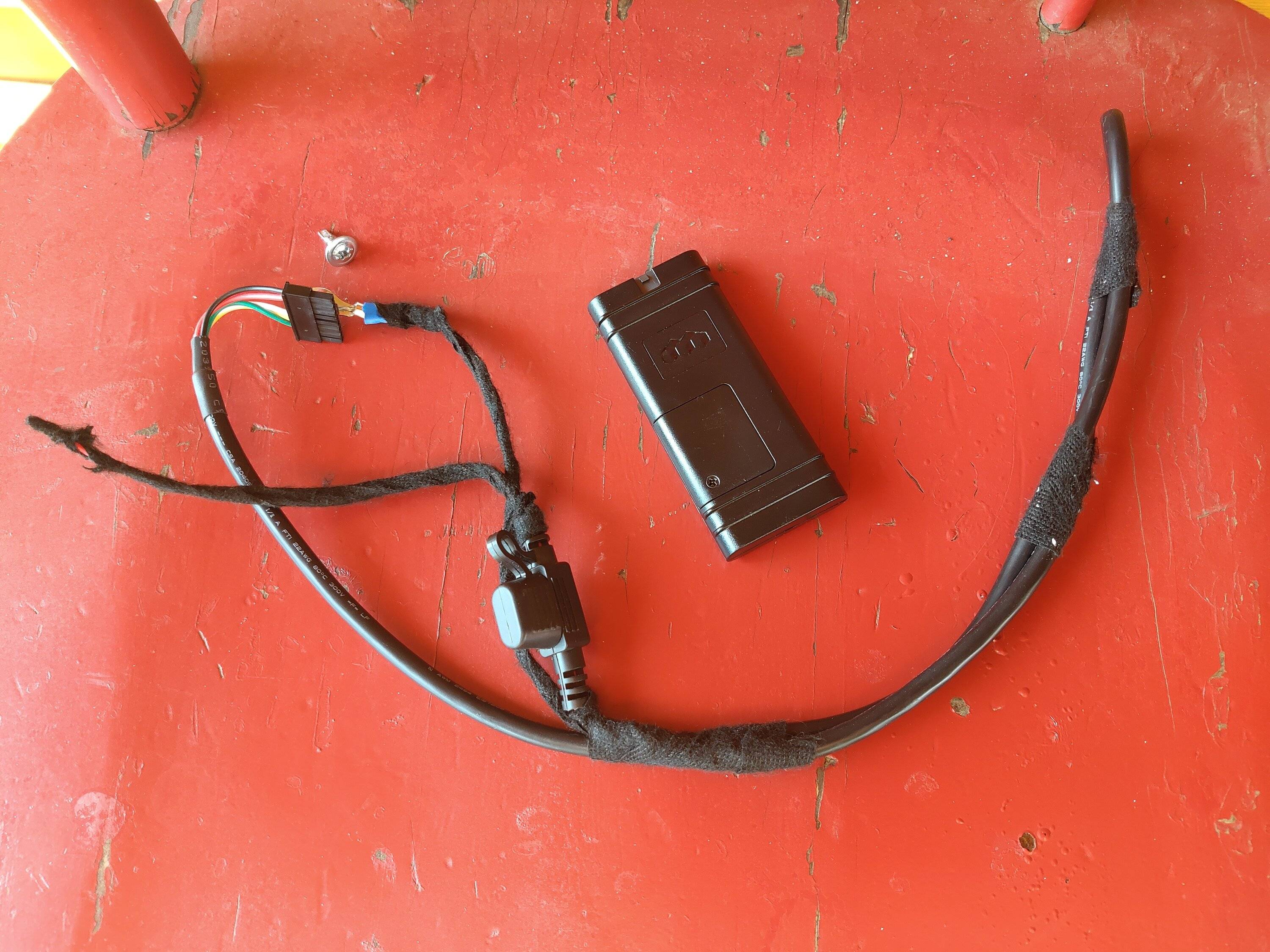

I plugged it back in to make a better video and the lights were flashing from green to red when it was moved, so it was certainly sending info outbound.
The red wire was spliced into a gray wire on the back side of the OBD-II port and the other wire was grounded to the front of the OBD-II mounting bracket.

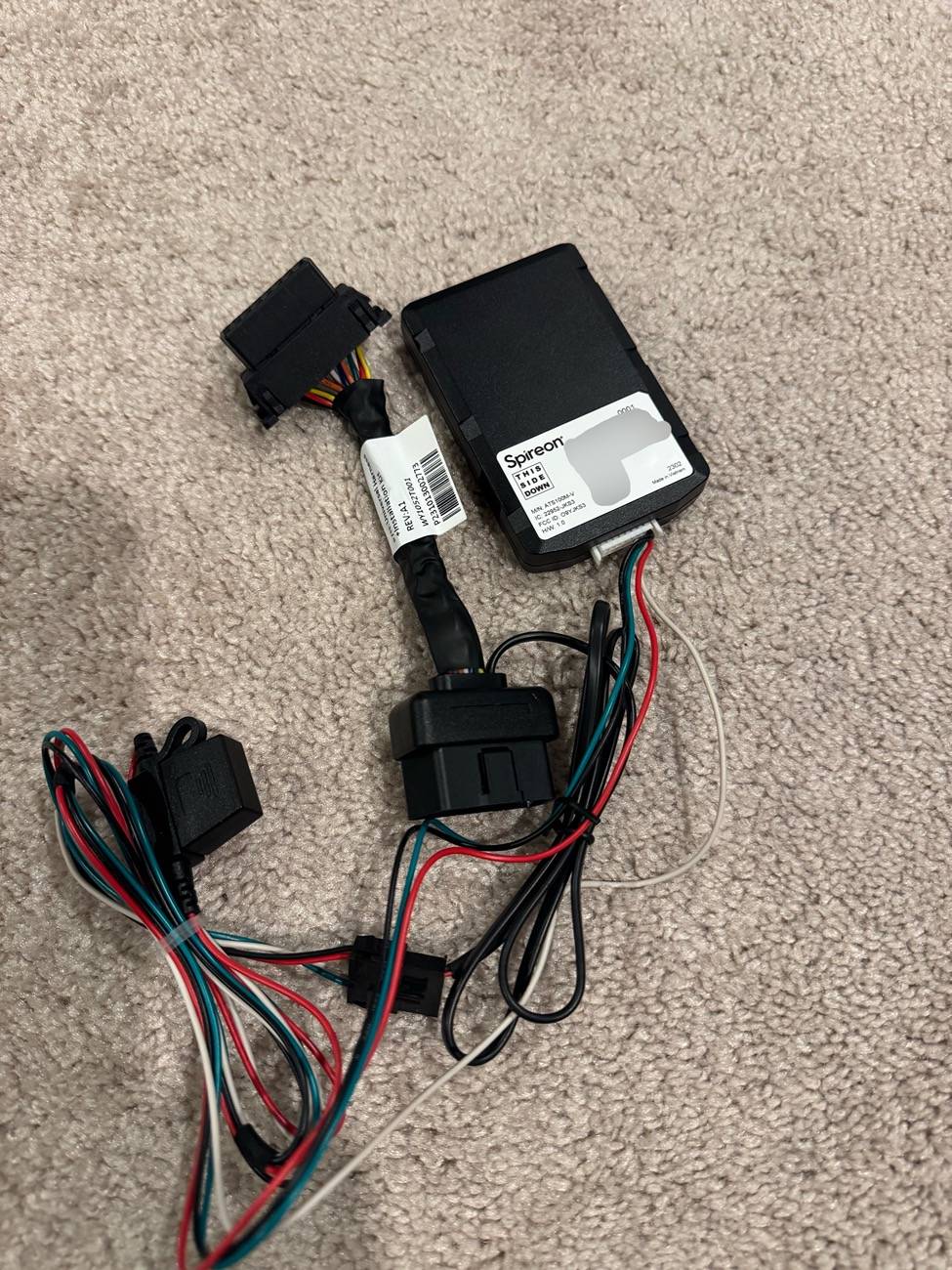

Mine came with LoJack that dealer said couldn't be removed, even though I refused to pay for it.
Luckily their install used a harness to allow it to plug inline so it was a 10 second removal job and everything is back to stock now.
