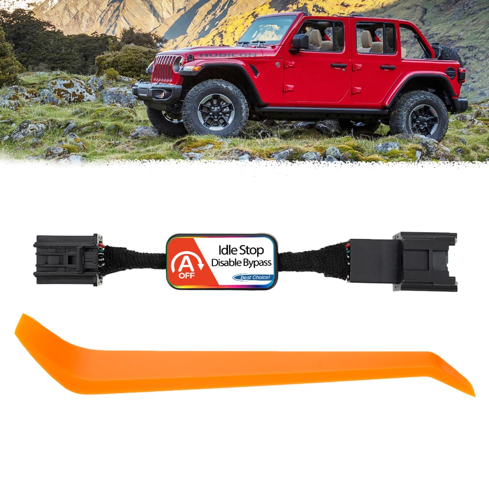

You still have to push the button on the dash or buy a gizmo that you install under the dash so ya don't have to push the button every time you start it.
All you did was take the little battery out of the equation.

ESS is part of the system, it cannot be disabled. All you can do is prevent it from turning off the engine when it calls for it. Get one of the devices that connects under the dash and remembers whether you want ESS on or off.

Just unplug the hood open plunger under the hood. Sure, you’ll get warning on your dash but doing it the way you want to will also cause warning lights all the time. As Mr. Bill said, the aux battery is there for a reason. Honestly, as much as you don’t want to hear it, you’re better off getting the module that turns it off for you or just hit the button. Disconnecting the aux battery just disables it because the truck thinks something’s wrong.

@DiehardTory sure, it's easy enough to press the button but it's also an annoyance, hence the disabling harnesses and Tazer.
@OP: Welcome to the forum.
When you physically remove the aux battery, the aux positive lead needs to go back up to the main battery's positive post. You'll need to bend the tabs on the aux cable terminal to make it work. Then tape up the negative really well.
I couldn't fish the positive up via the fender access. I wound up doing it from the top. You'll remove the main battery, then the fuse box, remove the access panel and pull the red wire up. It's a tight squeeze but doable. [Banned Site] on Youtube has a great video on how to get to the aux from up top.
After all that if you want to permanently disable the ESS you'll need an auto stop eliminator. They range from about $40 to $100. Same goes for a Tazer but they're about $300 but they can do a ton more.
You can install either of those with both batteries intact and it will bypass ESS but be aware the aux can and will draw down on your main battery and can leave you stranded. Jump starting my BMW nuked mine.
Chances are your 2020 has the OG batteries and they're likely to need replacement. I replaced mine with a larger Group 94/H7 Odyssey. It fit perfectly fine in the OEM spot. They're about 350-400 and others are less money but Odyssey's are worth the money.

Ok. I'll take your advice and get a Tazer or a similar gadget. 😉 Thanks

Hint the tab you need to press to release the stock cable from the box is on the firewall side of things. The plastic tool for prying panels apart does a good job of pressing the tab in while you pull down to unplug the cable.
