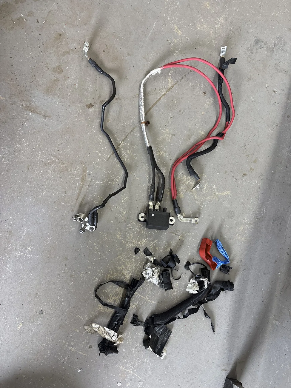

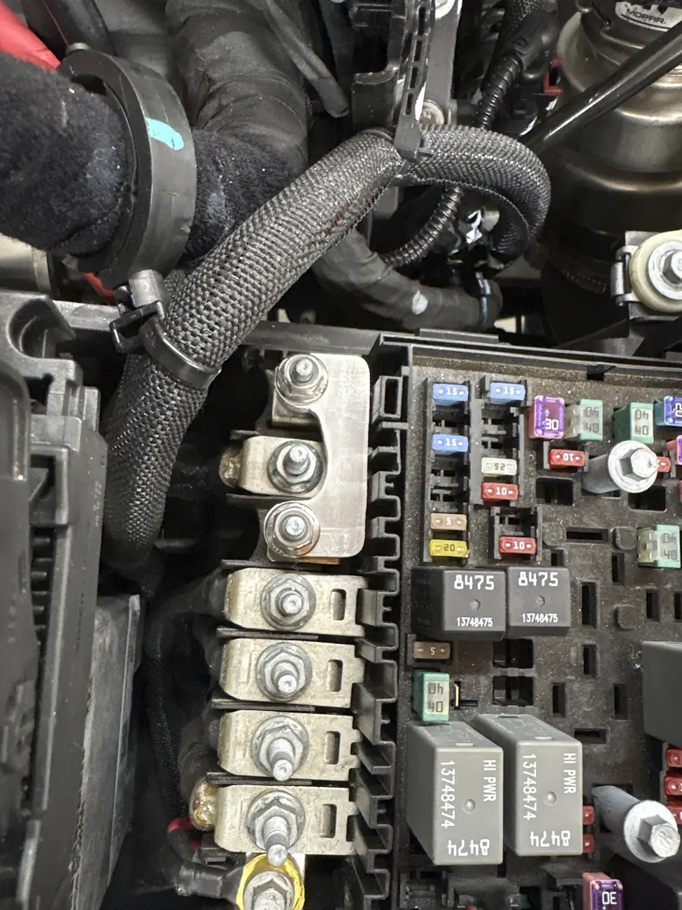

Here is what I did, as well as disable it with the Tazer, nice and clean under there.
Jeep Gladiator Disabling ESS IMG_1713
Jeep Gladiator Disabling ESS bus bar
