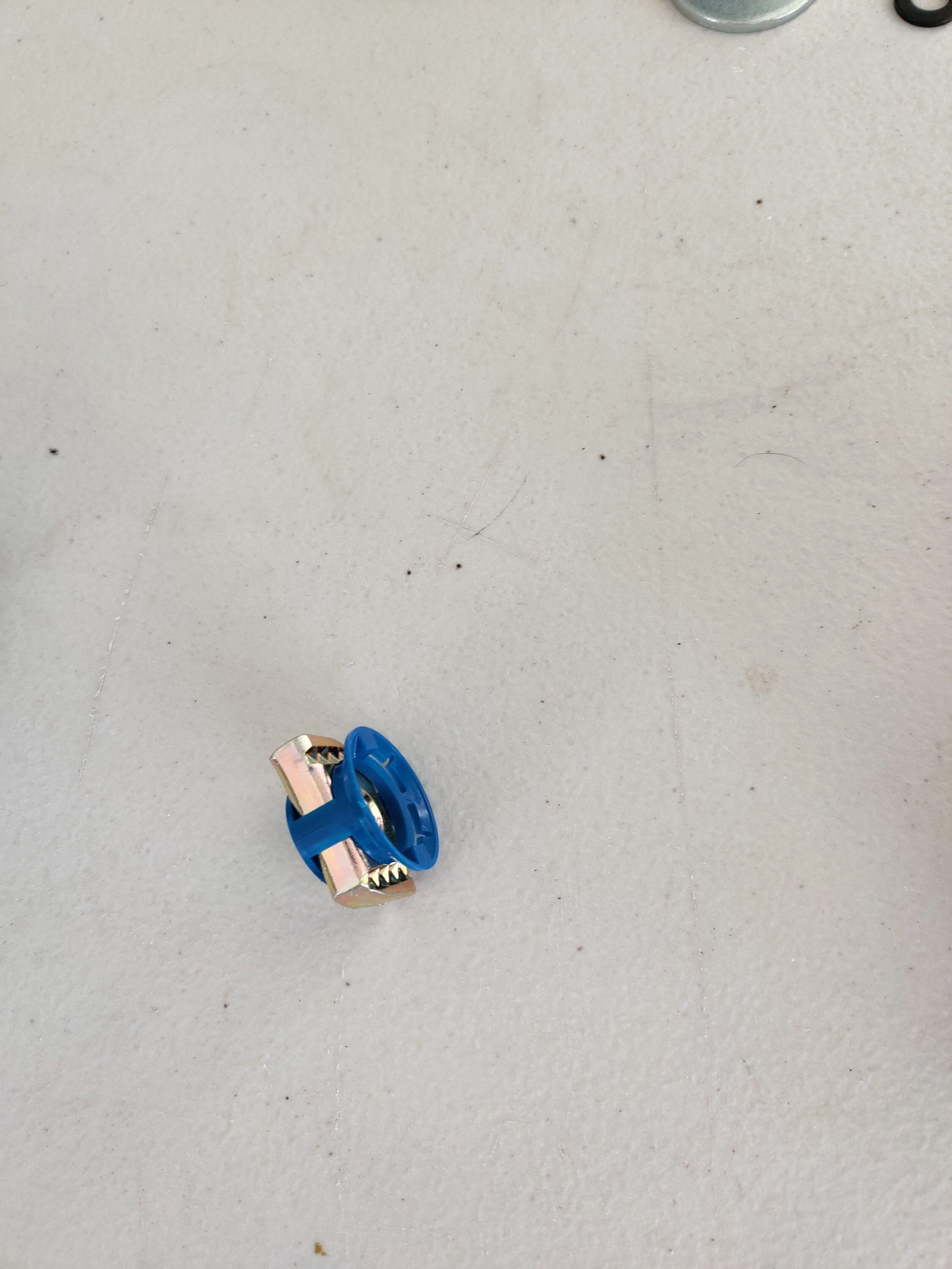

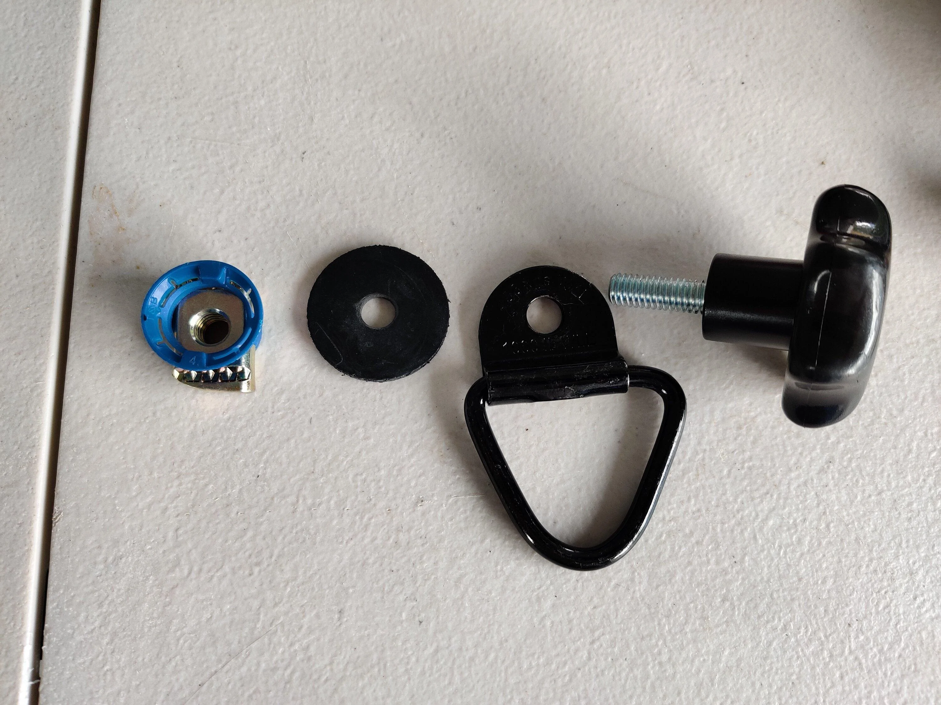

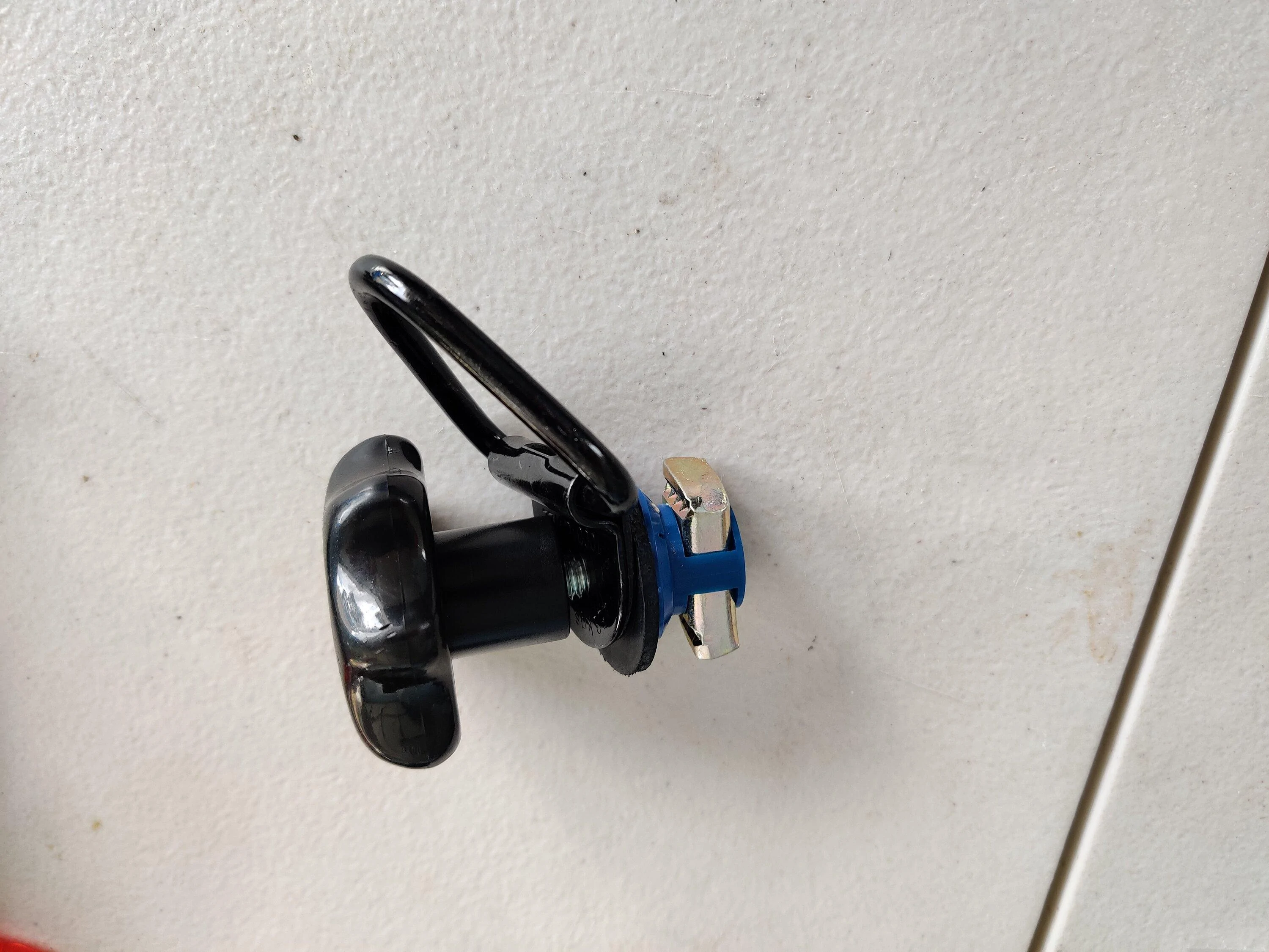

I did exactly what you're describing, and these fit perfectly:
Amazon.com: POETRYXIAO Tie Down Bed Cleat for Toyota Tacoma 2005-2021 and Tundra 2007-2021,Compatible with Deck Rail System Truck,Replace #PT278-35160#PT278-35112#PT278-0C010#PT278-35111 : Automotive
These also work nice, but I put a flat washer behind them just so they don't muck up my powder coating:
Amazon.com: 4PCS Bed Rail Mini Tie-Down with Hooks PT278-35075,PT278-00160 Compatible with 2005-2019 Toyota Tacoma, 2007-2019 Toyota Tundra : Everything Else
These are a nice finishing touch, and a good way to stop from gashing your hand on the corner of the unistrut:
2"Inch (50mm) Square Plastic Hole Plugs Insert (20 Pack), Heavy Duty Black Hardware Plugs and Unistrut End Caps for Square Tubing, Glide Insert for Pipe Post, Chairs and Furniture by Prescott Plastics - - Amazon.com
Here's a pic of my finished product. I'm not sure if it's as good as the Mopar product, but it holds groceries and bowling balls in place, which is all I need.

Loving it, would not advise just painting the uni-strut, mine is chipping. I may try to get my rails sprayed with bed liner material and re-install. But the struts and the tie downs I love. Able to move them around with ease.
Even the cross bars I can add to the truck as needed and tighten with the hand screws.
