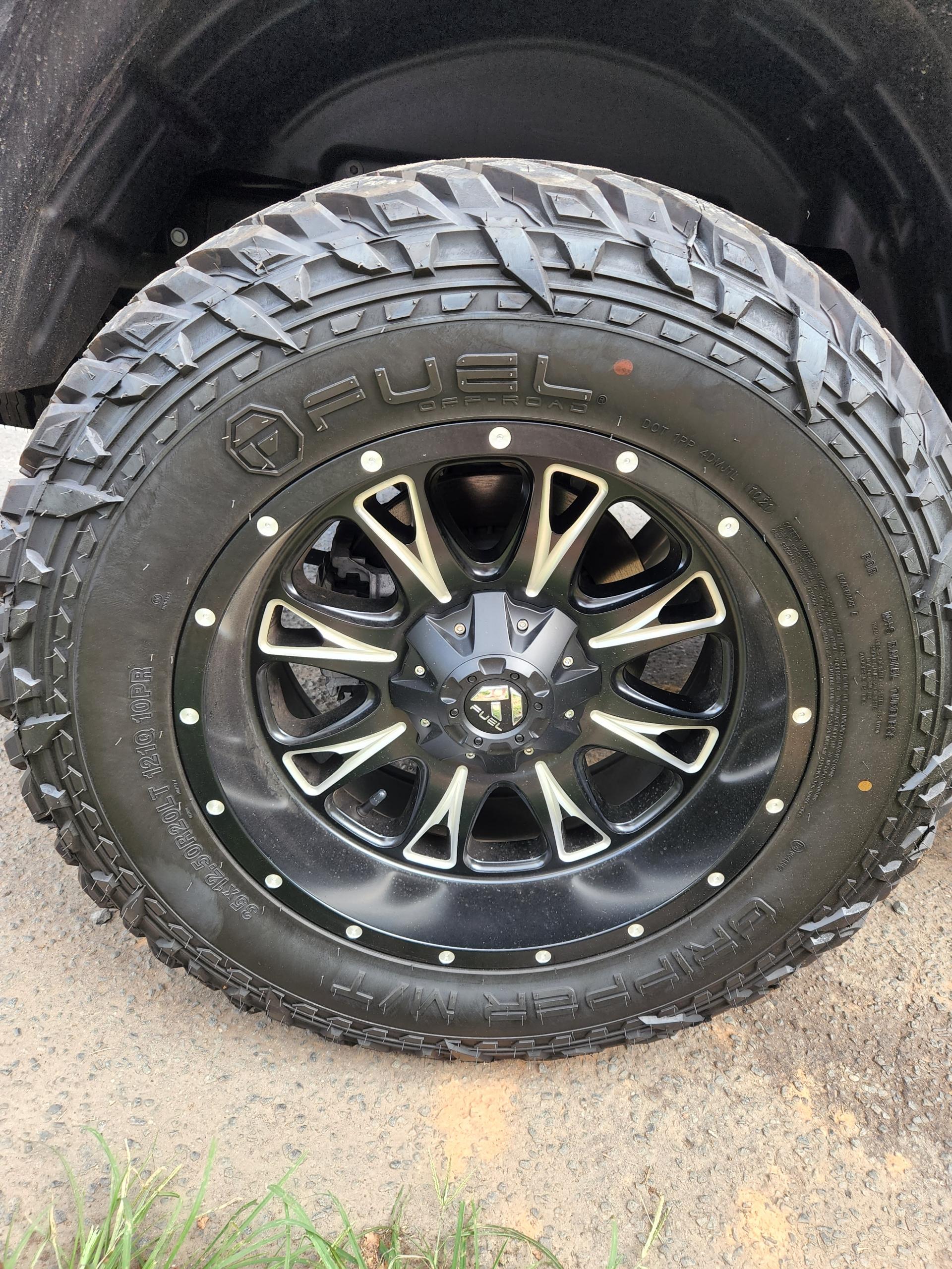

Measured 1 tire with level and tape measure
Keep plugging you'll eventually get it.
What I would suggest is the toothpaste method.
- Run a bead of toothpaste across the tread of the front driver tire.
- Drive forward till you leave two marks on the pavement.
- Measure the distance between those two marks.
- Divide that distance by 3.14
That should get you closer
