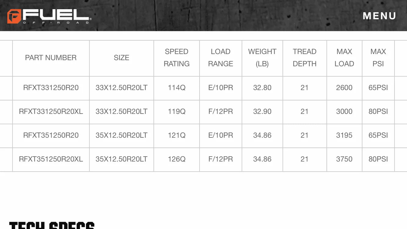

One thing for sure, those tires are LIGHT, 35lbs for a 35 x 12.5??
I bet the specs are wrong and that in kg's
