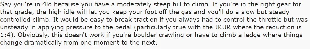

It's for low RPM crawling over obstacles where using the foot could cause too fast a change in speed. It's specifically for crawling over rough ground.
You nailed it - it's a feature for crawling, started with the JK apparently. Only in 4L from all the stuff I've read this AM -
Put it in 4L, leave your feet off the pedals and it slowly crawls (but with limits on the high side of the RPM like I found, it doesn't seem to go over a certain RPM)
What the other guys with the JKs were saying is that if the obstacle is large enough, it won't get over it (like my testing - it's got limits) but for a slow controlled crawl over rough stuff within those limits, it's a feature for crawling.
As long as you know it's there, and are smart - it shouldn't cause trouble on ramps as you should always be hovering over that brake pedal anyway in such cases.
This isn't really connected to anything else, and I suspect if you used the automatic's manual mode, you'd have some nice control over it.
It's about crawling, KEEPING up forward motion - not about not stalling as nothing with an automatic is going to stall anyway. They just don't, no matter how old, even with carburetors.
I've found other references where tuners have given more control over it and taken advantage of the feature. I found people who just got into the JK from other Jeeps complaining about it - then JK owners explaining it.
PS - you can't stall an automatic - it's not about stalling.
