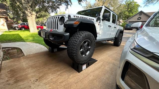

I didn’t need any throttle at all, climbed right up on its own which was pretty neat. My driveway is inclined plus the ramps. Pic for fun:

Right, the low gearing does a phenomenal job at multiplying the torque coming out of your engine. That is really not an obstacle, but what I’m getting at is that if you hit something bigger it won’t just idle up it, it’ll need a bit of throttle to complete its climb. For the most part, even in the gasser as long as you have traction you should rarely ever go over 2k rpm to get over things.
