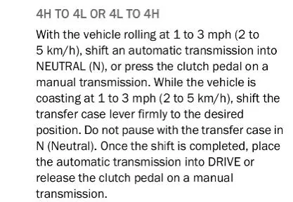

Also another tip. While rolling put the jeep in neutral. as you are rolling pull back to 4 high then shift to drive. Do it again for 4 lo. The more you do it the easier it is. I find almost always its easier to shift into 4wd at a 1-2 mph roll. With things spinning they kinda clink together instead of binding.

Automatic transmission in neutral with jeep stopped level ground. Pull transfer case into 4lo. If it does not go into 4lo. Go back to 2 0r 4 hi. Drive forward or reverse to take any pressure off the driveline. Go back to neutral on the transmission. Shift the transfer case to 4 lo. Use the manual shift on the transmission once you are in 4 lo. Practice a few times on a dirt or gravel surface. Not pavement.
