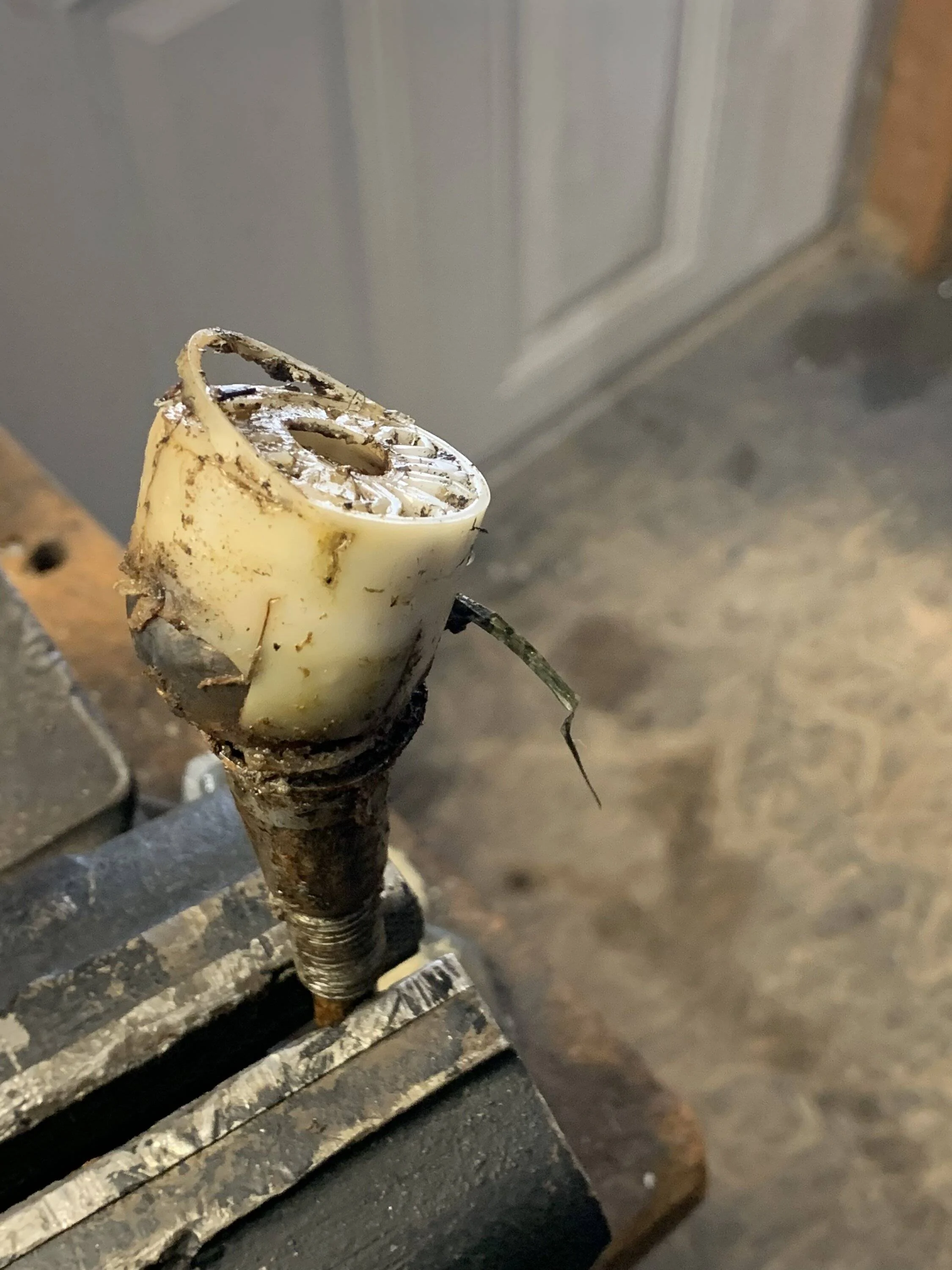

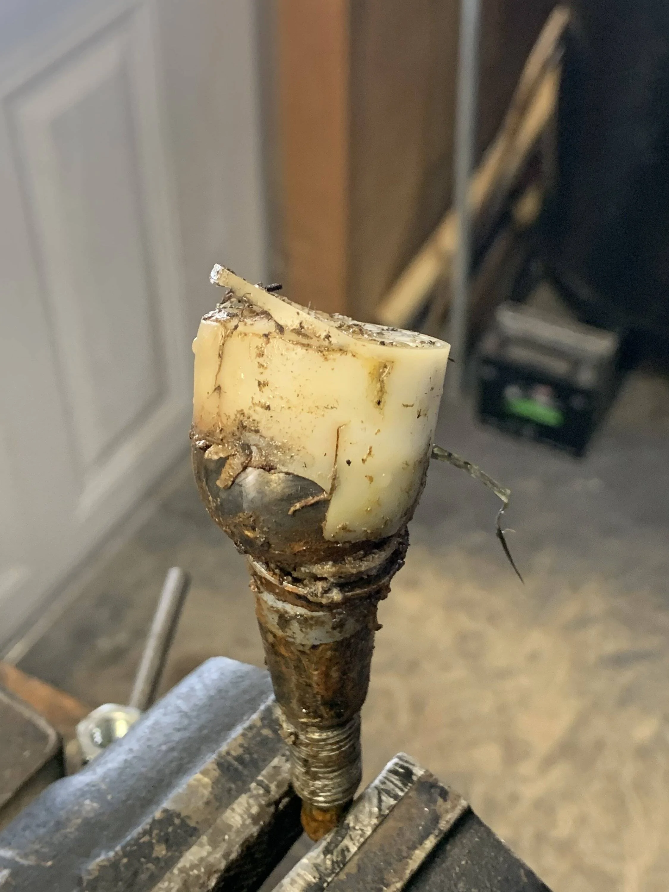

Just as an aside, has anyone seen what a factory ball joint looks like inside? I tried to replace them on my wife’s Grand Cherokee. The bottom lower was a real booger, but doable. The rest, I ended up replacing everything. Upper control arm, and tie rod ends. They look similar to the ones on the JT. This is what’s inside the upper control arm…….Came apart while pressing it out
Jeep Gladiator Does anyone make a press in/ out no-drill top -mount factory drag link ball joint? 90930A39-2BF7-43D2-8991-61ADDF4D2B87
Jeep Gladiator Does anyone make a press in/ out no-drill top -mount factory drag link ball joint? BACFD3D7-BED2-4D29-9419-3FFD5EED6F1B
