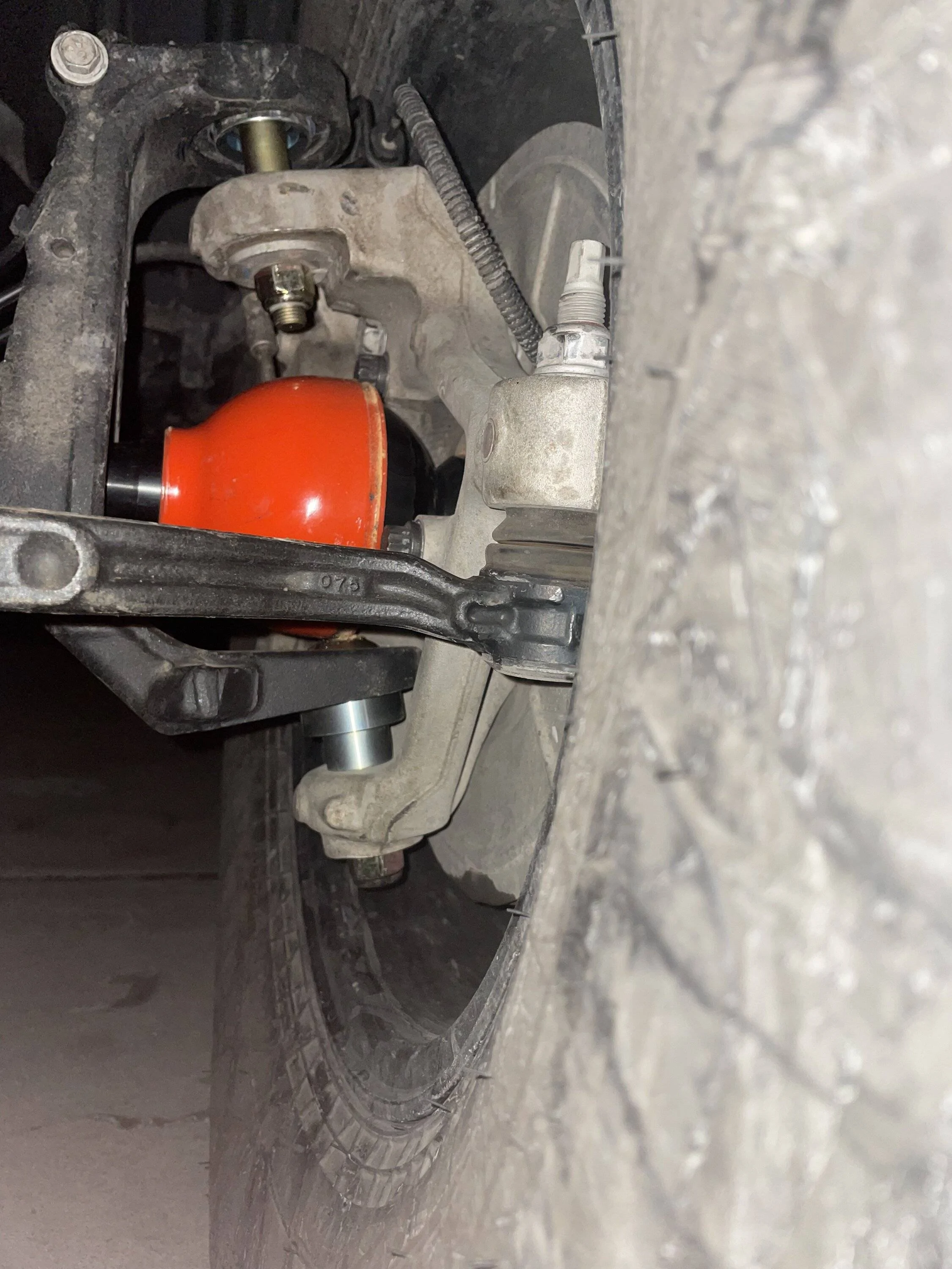

Guys, I had a shop, not naming names at this point, install the American Iron deletes. Drives like shit, and does not look right! Can anyone, @Darkspeed take photos of their setup so I can compare and see what is fucked up here... Looks like they pressed the bottom bearing in the wrong way.
I wouldn't drive on that until it was verified. it looks like it may not be properly installed. im not at home so i cant take photos at the moment. There should be gap between the axle and the knuckle but im not sure it was that big. - i just edited my initial response because i was incorrect
jerjon
JimmyJones
Jan 2, 2023
59
45
Wisco
Mojave, LJ, TJ, SuperTrooper
Magician
Dumbest freaking thing I have ever seen..
American iron adapted an off the shelf uni-ball with long bolts maybe some weird adapter and marketed it for the gladiator.. and are making a profit off unknowing folks..
idiotic.. 1. Uni-balls completely unnecessary for 99% of jeep owners.. solid axles don't need the level of rotation these are meant for.. Uni-balls are Designed for IFS and A-arms..mostly trophy trucks.. they're crap for a DD, garbage.., They wear 3 times as fast.. as an off the shelf ball joint would and With the length of those adapted bolts/spacers.. it's likely much weaker than oem.. Some suckers out there buying this garbage..
