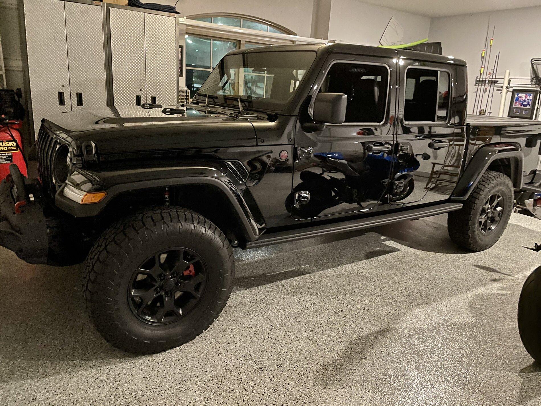

I have a 2021 Overland with a ecodiesel and 34” Toyo AT3’s tires. I’ve been using a Teraflex 1 1/2” front level kit but since adding the Mopar front steel bumper and winch, my front dropped another 1/2” so I’m really only seeing a 1” increase.
Since the Mopar lift is backordered for the diesel I decided to use the Teraflex 2 1/2” springs up front. Their kit comes with a rear 1/2” spacer but I’m thinking of using a 3/4” rear spacer instead.
With the bumper/winch weights in mind, I’m also thinking of adding the 1/2” spacer up front too. I’ll also be installing shock extensions and use Rubicon take off shocks.
I don’t mind a 1/2” rake but that’s about all I want.
I’m trying to get level or with a minor rake. Does this look like I’m going to achieve this?

Today I installed everything but went with adding 1/2” spacers in the front and rear. I have a 1/4” rake from the rear and I’m satisfied with it.
Test drive went well and it rides even better than the OEM setup with the spacers.
