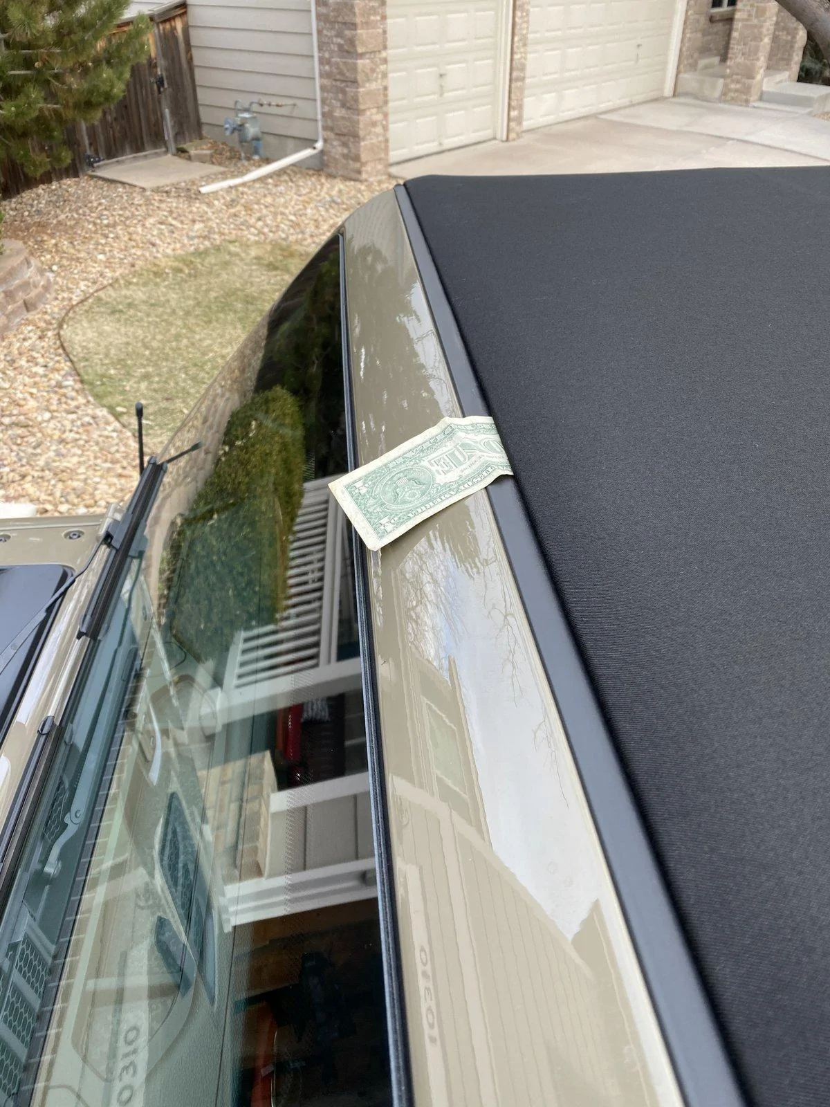

I just swapped to soft top from the hard top in my dual-top kit. Latching down the front it does not seem to eliminate daylight until the last second. I see there is a double row of seals and a channel between them with drains... But I can slide a dollar bill between the top and the rubber seal easily. Not looking forward to rain, especially at high speed that will force water in there.

I don’t have this issue. It’s been raining here the last few days and at times it’s been rather hard and I’ve had no leaks.

Mine came with just the soft top and has always been a very nice tight fit. Do you think you have one part that might not be tensioned down just right? I know my Dad's JK soft top sometimes even came loose on a spring and that was enough to cause it to leak till I re-positioned it.

Soft top here also. No gaps or leaks. Check yours for possible adjustments to pull it down more across the front.

not sure about the gap, but mine does not leak.
Took it through a touchless car wash yesterday....the kind that's basically a bunch of pressure washer nozzles. no leaks.

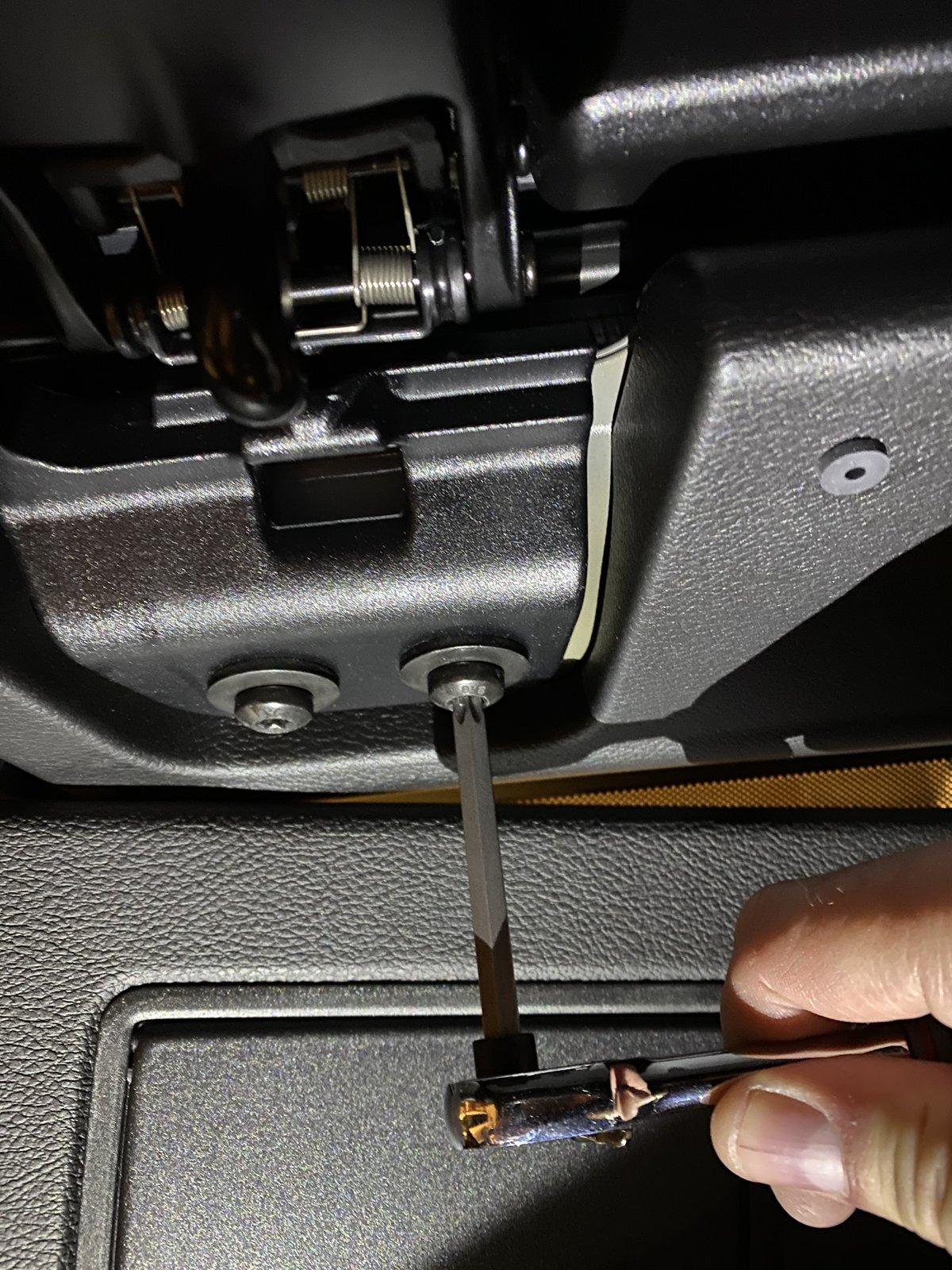

So I pulled the little carpet circles off covering the torx that hold on the header latch contact points. Loosened them up and pushed them as far forward as they would go to create more tension then re-tightened. These have a slightly sloppy fit and a big old washer to cover. Now I get full-contact between the soft top and header weatherstripping rubber all across, dollar will not slip in. This was only a couple mm adjustment. We'll have to see if it affects freedom panel fit when I swap back to hard top. Maybe it will eliminate some wind noise with the tighter fit. :)

I just put my soft top on this evening and I noticed something similar. Did you have any wind noise when driving it? I noticed a bit in mine, I might have to try and make this same adjustment on mine to see how it does.

So to follow up I tried adjusting mine like that, but I can still slip a bill in the middle fairly easy. It gets much tighter near the latches

I also parked in the sun, and squished the front corners of the top down onto the weatherstrip. Also double check your front plastic door surrounds to make sure they are fully seated down near the windshield.

That trick fixed my latch, would pop open because it didn't have enough pressure. :like:
