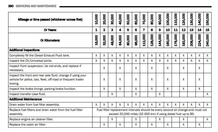

Is it wise to only drain water from the separator if the indicator light comes on? My gut (ignorant) tells me why not just drain it after every few tanks but I was unable to find any mention of incorporating that as part of one's routine.
Do those with diesel experience just wait until warned or is it a good practice to clear any water regularly? Thanks in advance for any advice!

The owner's manual mentions every 10,000 miles to drain it. FWIW, I haven't drained mine, nor has my SO's father who has a Gen 2 with over 100,000 miles.
Jeep Gladiator Draining water from separator ONLY when warned? Screen Shot 2021-09-20 at 12.51.27 PM

turn the drain every 10k if worried or wait till the computer tells you it's a issue.
