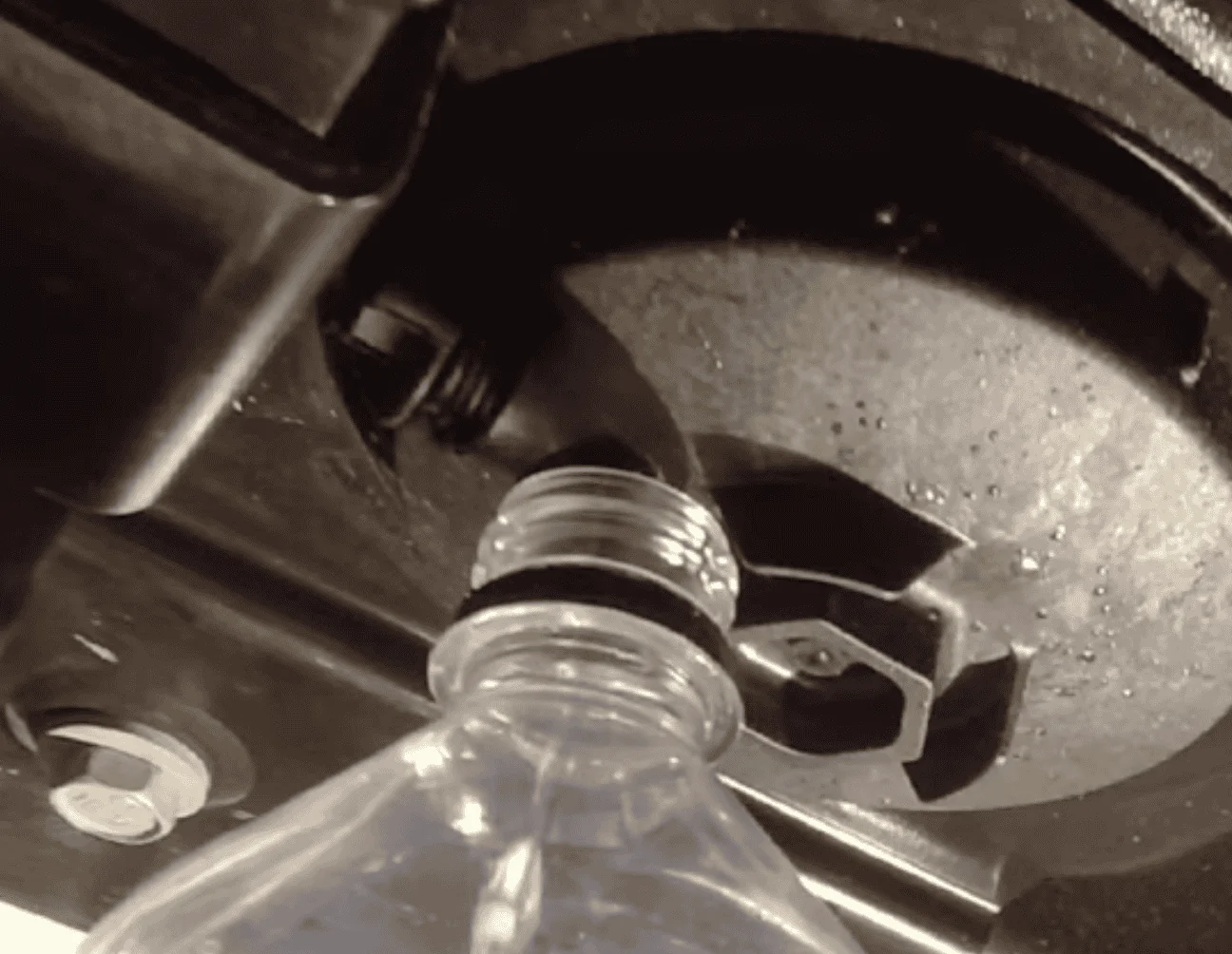

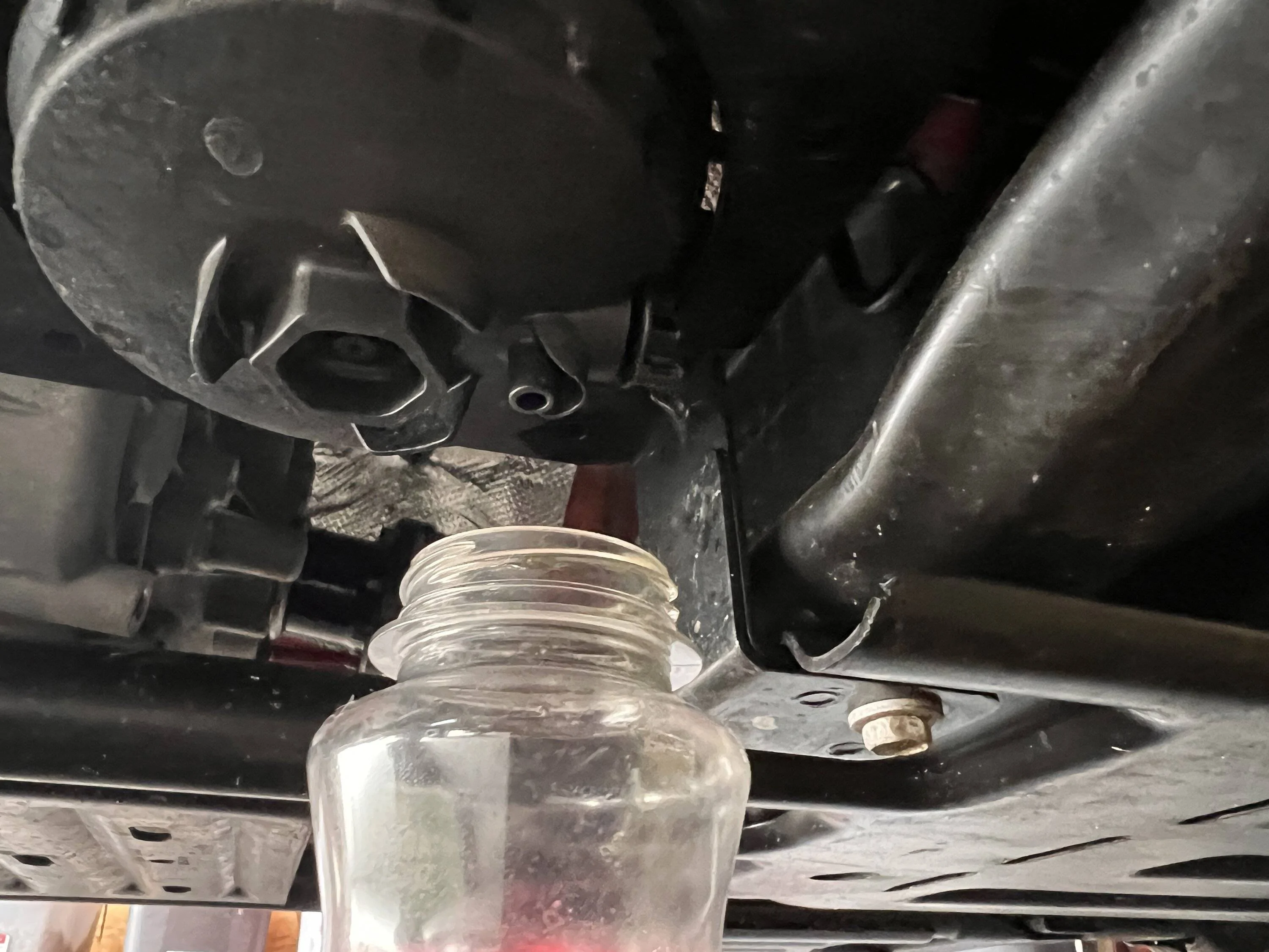

I keep see everyone holding bottles up to the drain, why not use about 2 foot or so of 3/8" fuel line , run it in the bottle and open the drain plug, seems like it would make life a little easier.
Yeah, this. I used a peice of fuel line and drained the filter housing into a bottle when I changed my filter. Also, a Fumoto oil drain petcock is amazing. Get some hose, run it to oil drain pan, open petcock and no mess at all.

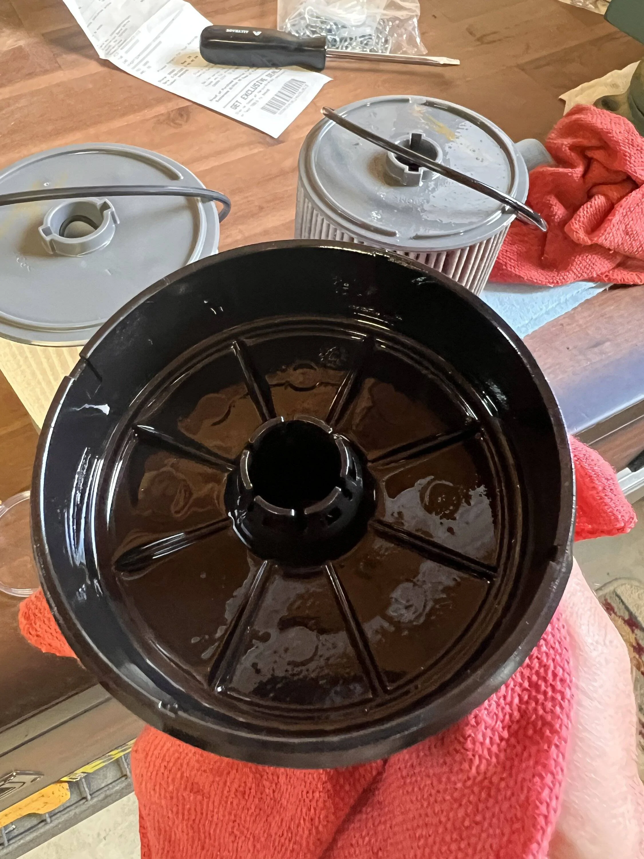

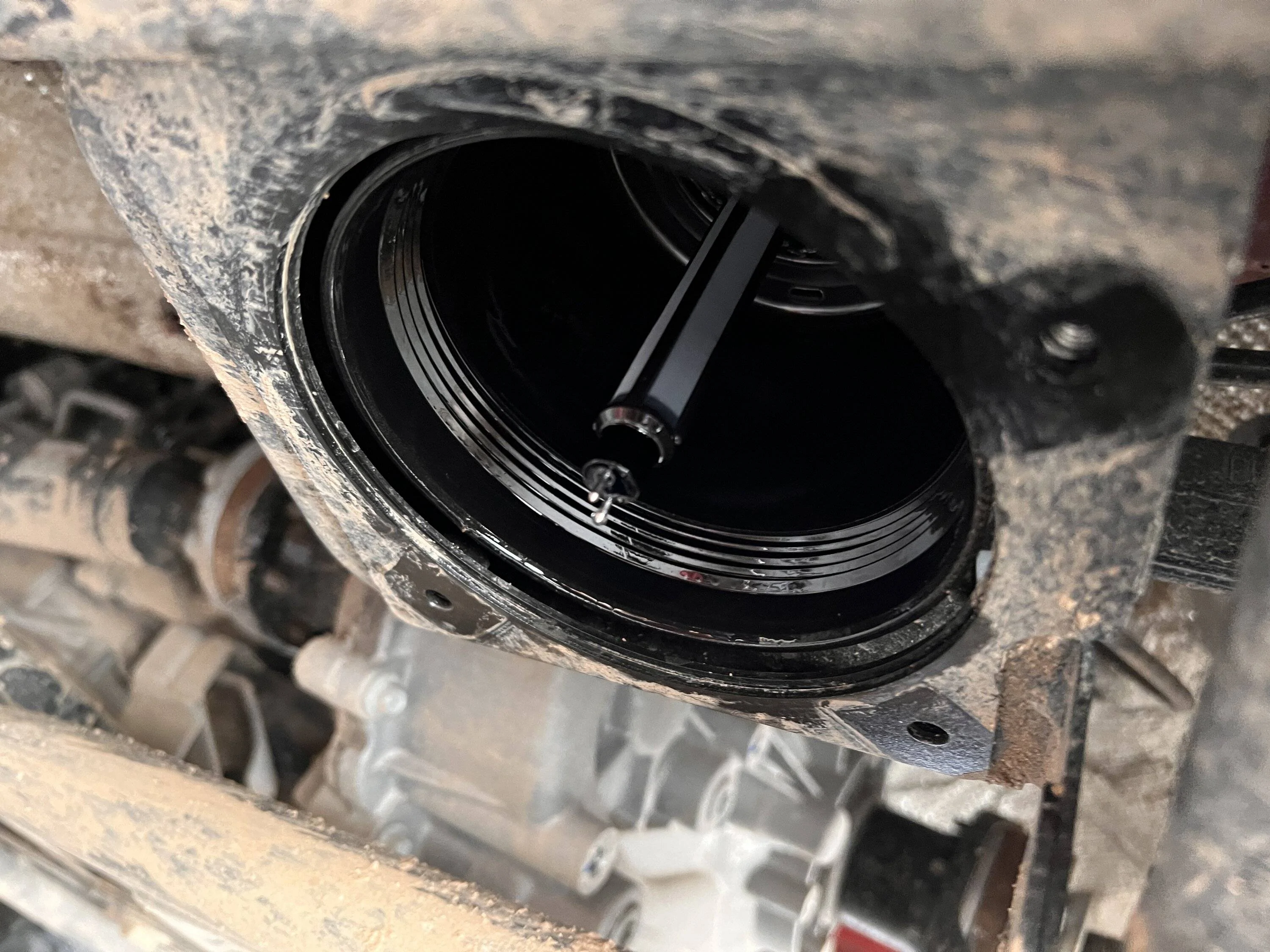

Changed my filter today.
In looking at the cap design - The cap has a lower section under where the filter sets - that's only open from the center hole. So once fuel drains down to the top of the center hole level, there's still about an inch sitting in the cap that won't go down the hole. (be aware when unscrewing it - you will have to dump out more fuel once it's off).
I do see the 2 electrodes sticking down also - assuming they are the water sensor.
Yep, the 2 electrodes sticking down are for the the water sensor. They work off of conductive in the water.
This is what I did. I placed the 20oz coke bottle on the ground and cut the hose to where it went 1/2 way into the the bottle. Opened the drain and let it run until it stopped draining. When done I set it aside over night to see the result, which was a tiny amount of water that collected in the footpads of the bottle. I ended up carefully pouring about 80% of the fuel back into the tank.
