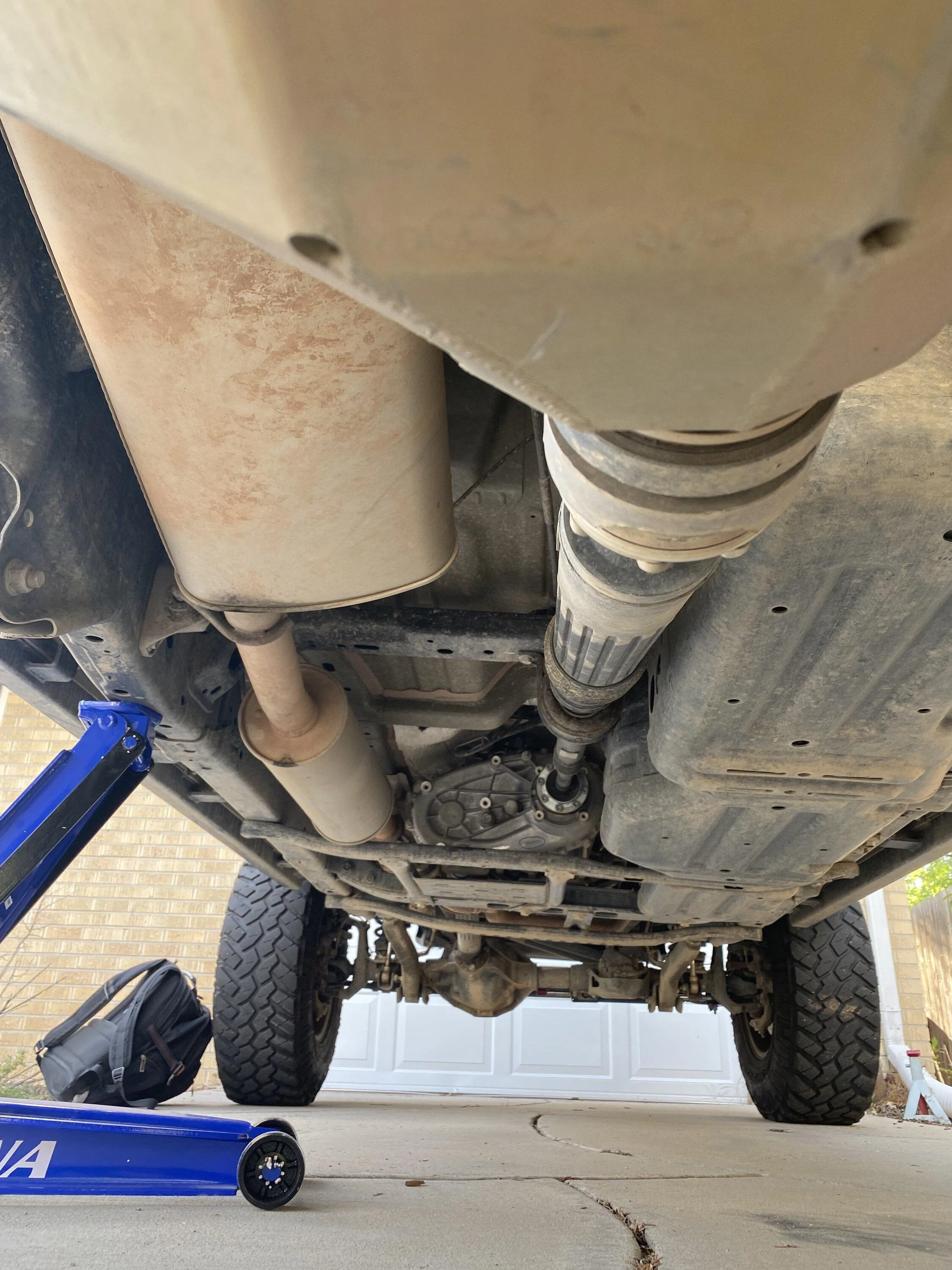

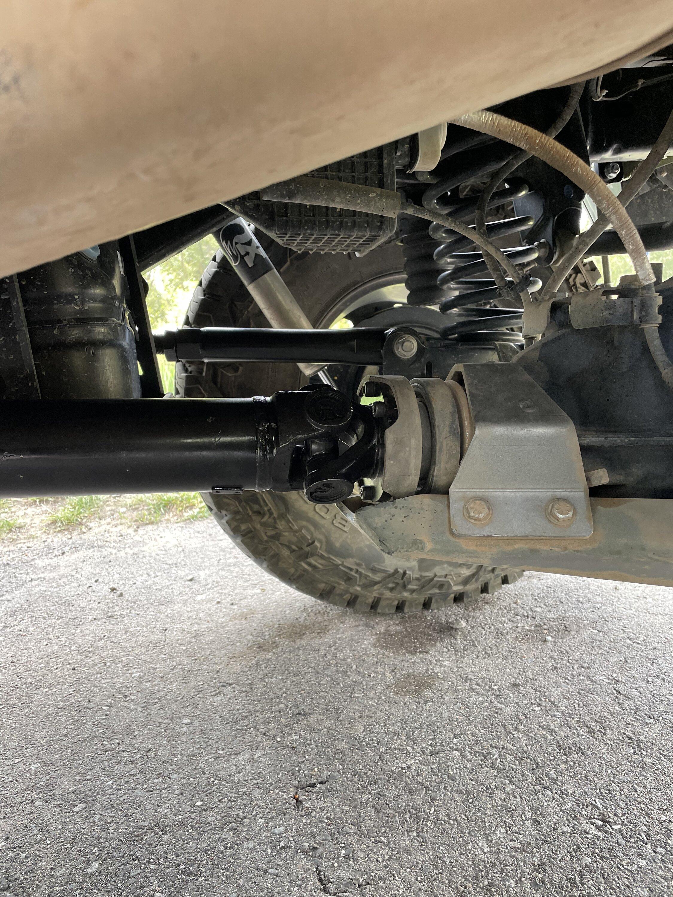

Was crawling under my JT looking at a few issues.... Noticed my driveline. It's not straight. Is this normal?

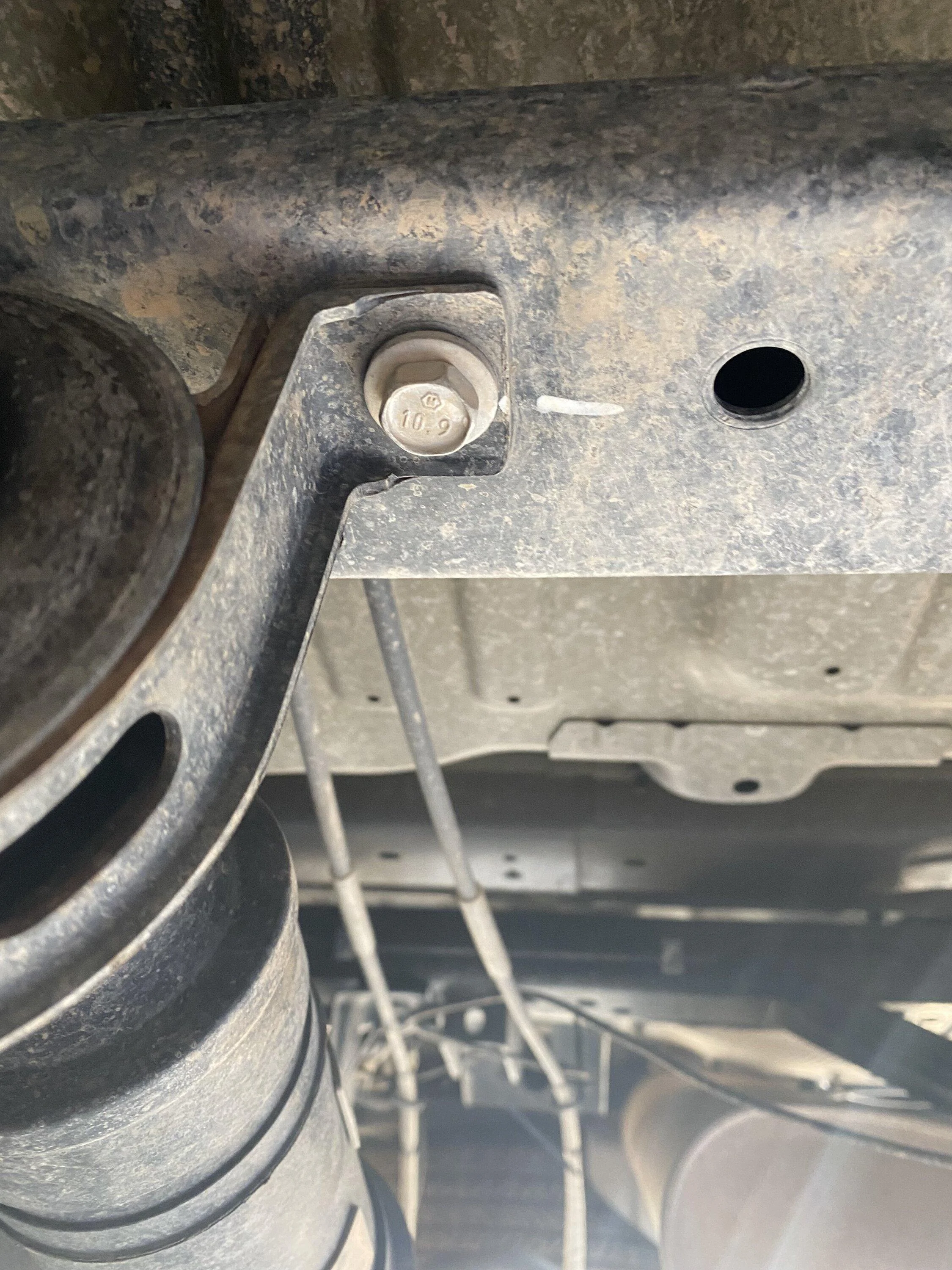

It looks like someone moved this bracket. See the white paint and the break in it?

Your center support bearing bracket did not move. Just a skip of the quality inspector paint pen when they marked it.

Having replaced my driveshaft, I can confidently say that there is a bit of play between the bolt diameter and the holes in the bracket. The CV joints are designed to handle small vertical and horizontal angles, so you’re not damaging anything. But I prefer my driveshaft to have as much clearance from the gas tank skid as possible. This is important when stuffing the passenger rear tire. It gets pretty close with that 4” driveshaft. With your lift height, I’d add a carrier bearing spacer (recommended for lifts over 2” by Dana), and before tightening the bolts position the bracket as far to driver as possible. It’s only got about an 1/8” of play, but when I had the stock driveshaft I was easily able to get the driveshaft within an 1/8” of the gas tank skid with full articulation. I zoomed into your bracket picture and can see a circle where tue flange bolt used to be, indicating that it probably has moved a bit. The torque spec is pretty low (25 ft lbs if I remember correctly) on those bolts, so it would be easy to have one loosen a bit with heavy off roading.

I agree with Summitdan, looks like it has moved towards passenger side by the mark by bolt and putting on a drive shaft spacer at same time is cheap insurance, is driveshaft rubbed at all? Kudos for checking after that adventure you had recently…..Jack

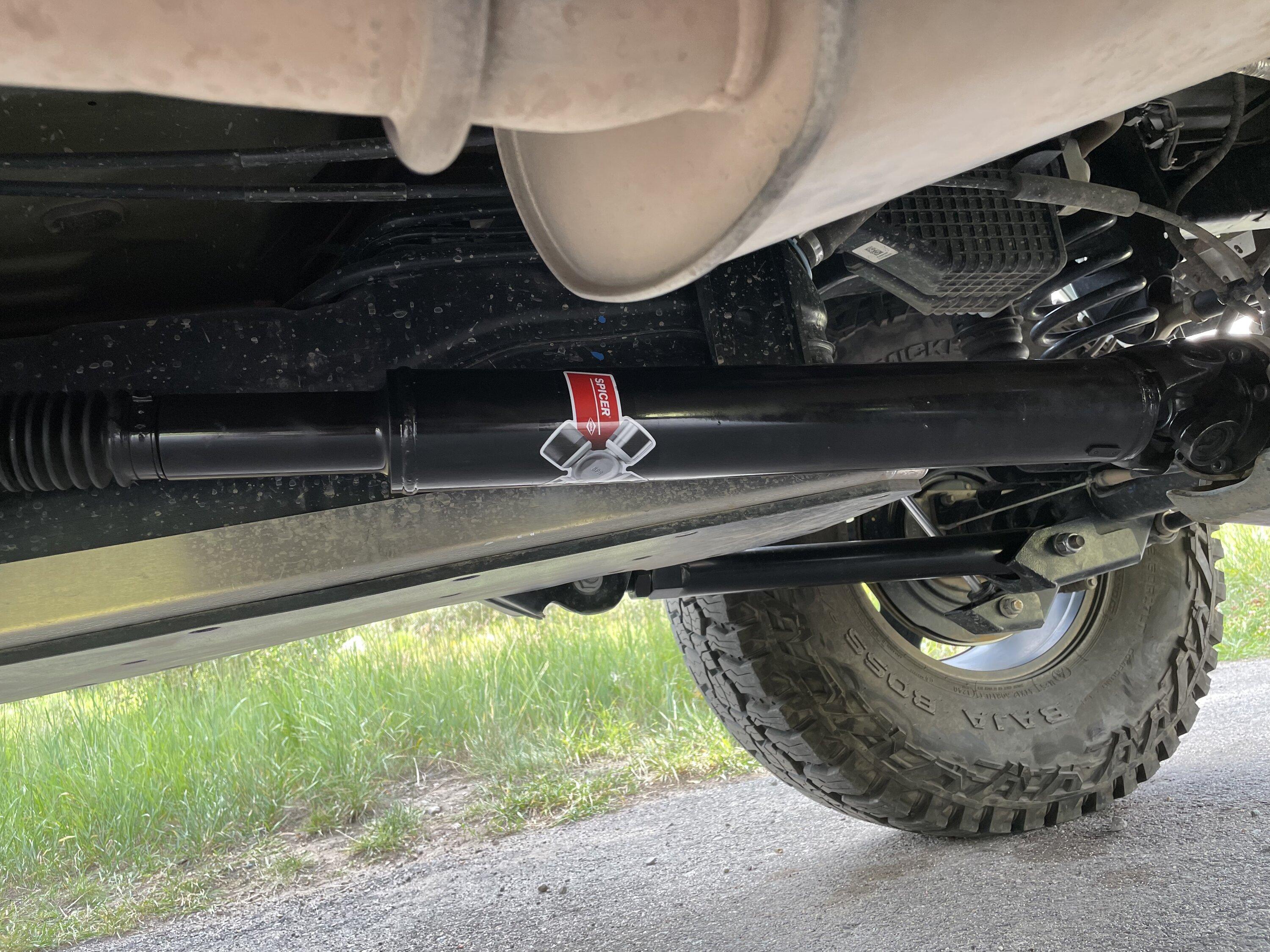

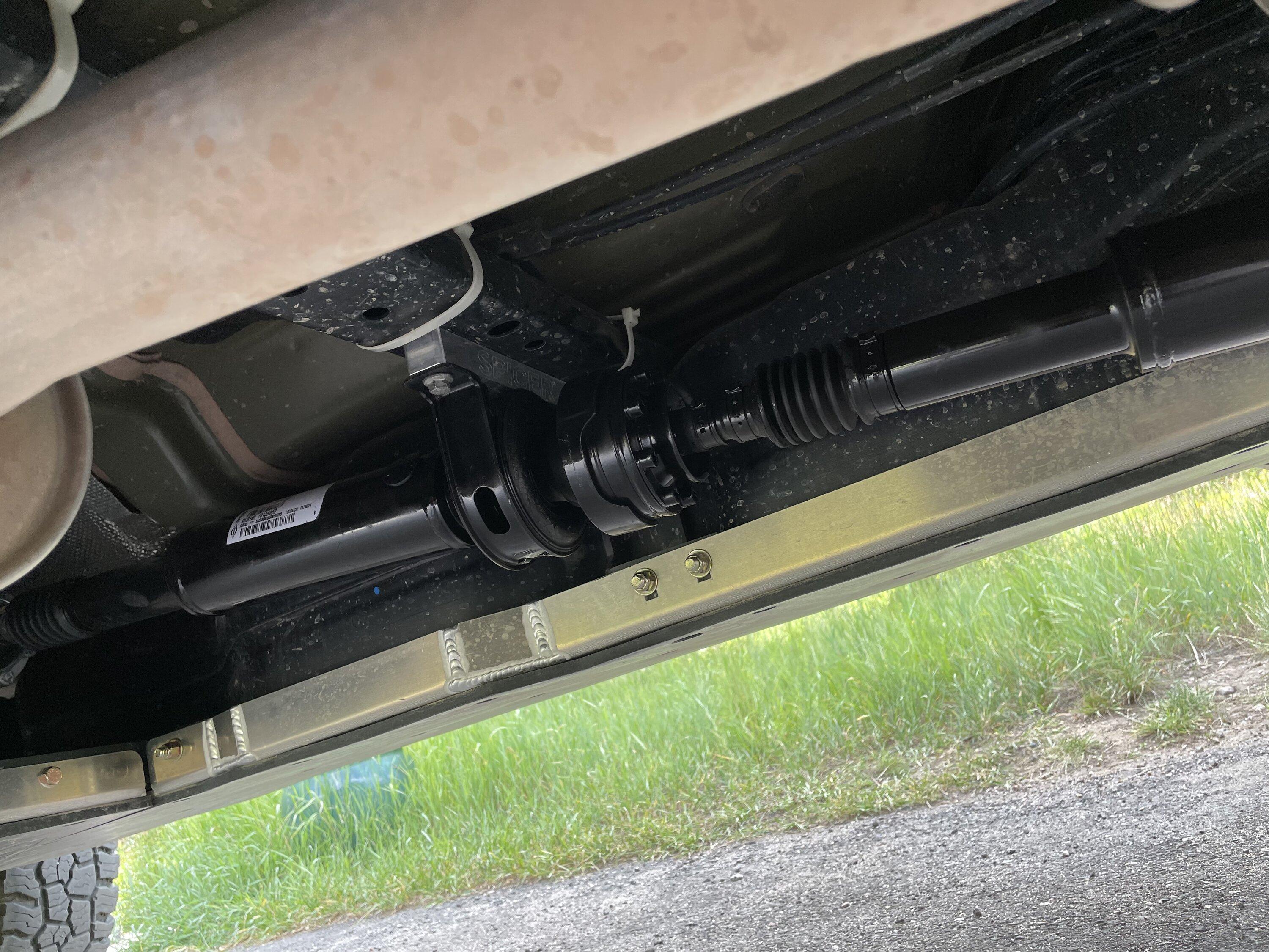

Jeep Gladiator Drive Shaft Alignment 872DDBCB-3E29-423C-82CD-3CF20AD36615
WILDHOBO
Sep 24, 2021
73
11,683
17,786
2021 Gladiator Rubicon
Network Engineer
Old picture. Same spacer, but OE driveshaft.

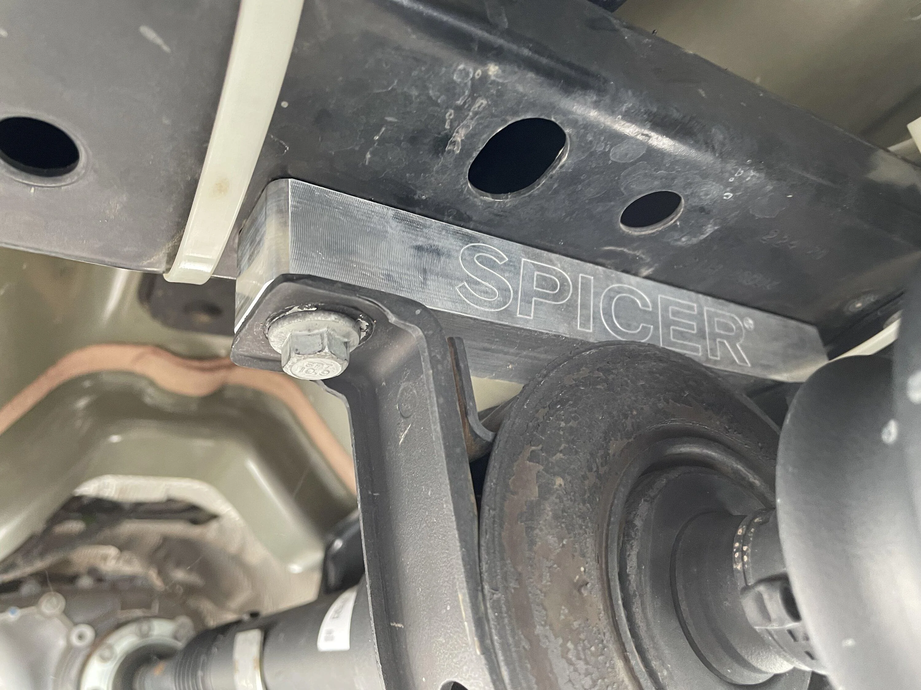

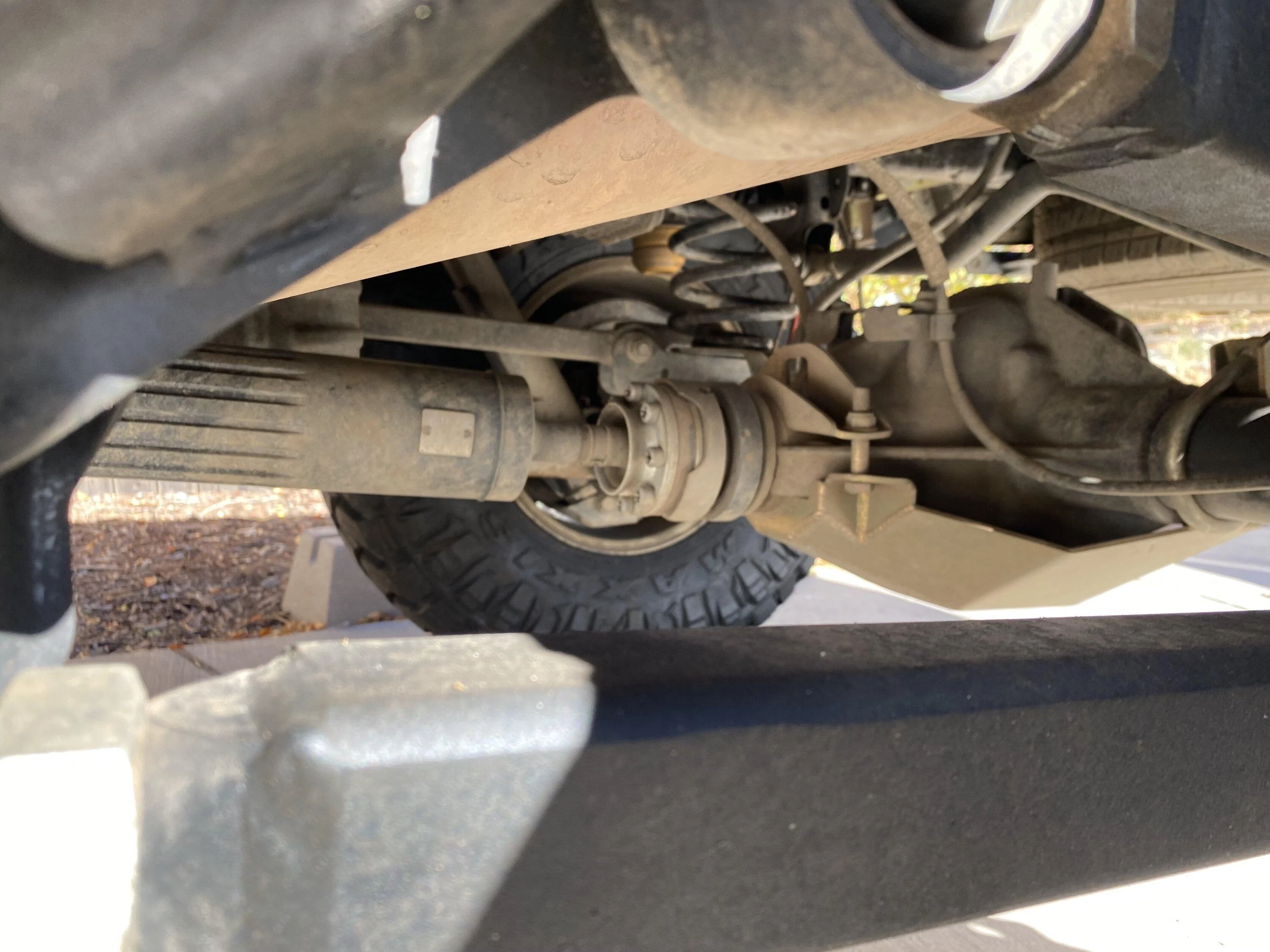

Jeep Gladiator Drive Shaft Alignment 97AC9504-473F-4247-931D-4DB9EC28FB9E
with new shaft.

Less clearance and I wanted to maintain the perfect driveline angle into the transfer case. This one is from Dana spicer. It’s also 100% bolt on with no yoke changes. 3” OD steel and rated for up to a 6.5” lift. The rear joint is 1350 to the axle. It handled the rubicon trail with zero issues, and I can drive 80mph on the interstate with zero vibration issues. Not many people seem to have them, but I’m really happy with the choice. It’s also an inch smaller diameter than stock, so better clearance with the gas tank skid.

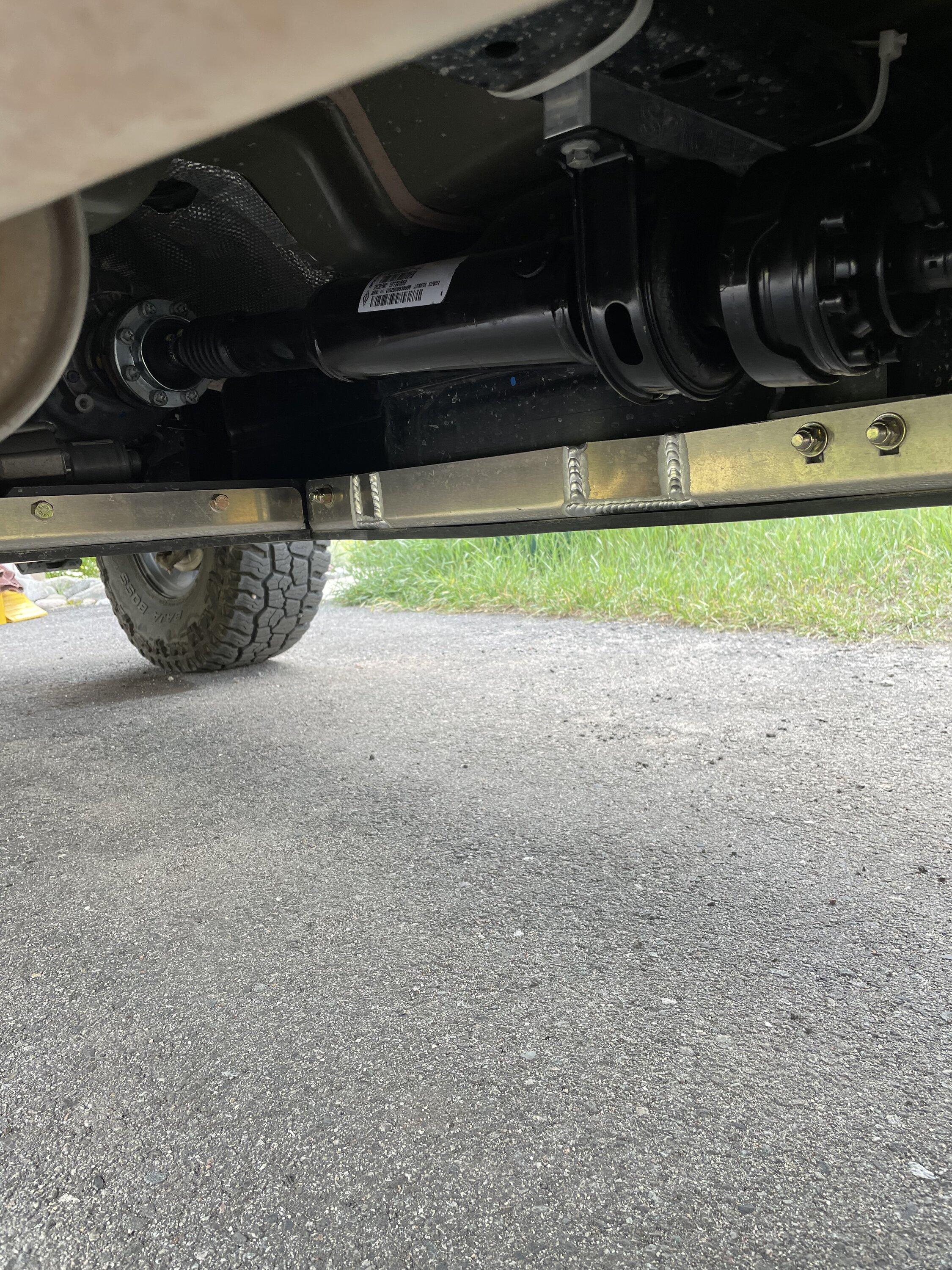

Jeep Gladiator Drive Shaft Alignment EAE0E068-E9B3-4888-845E-EDF115E3A07E
Jeep Gladiator Drive Shaft Alignment 8D8A9DDF-E629-4B63-B6E8-85F2FE610F0F
Jeep Gladiator Drive Shaft Alignment 31D2AD55-E421-4AE6-9B72-3C313951221F

Mine is like this as well. Slight angle to the right (drivers side) if you were looking at from underneath the vehicle. I added the rock jock bearing spacer but it was angled before the install too. If it’s not like this from the factory my only guess is my rear axle is off to the right (looking towards the rear) by less than a half inch.

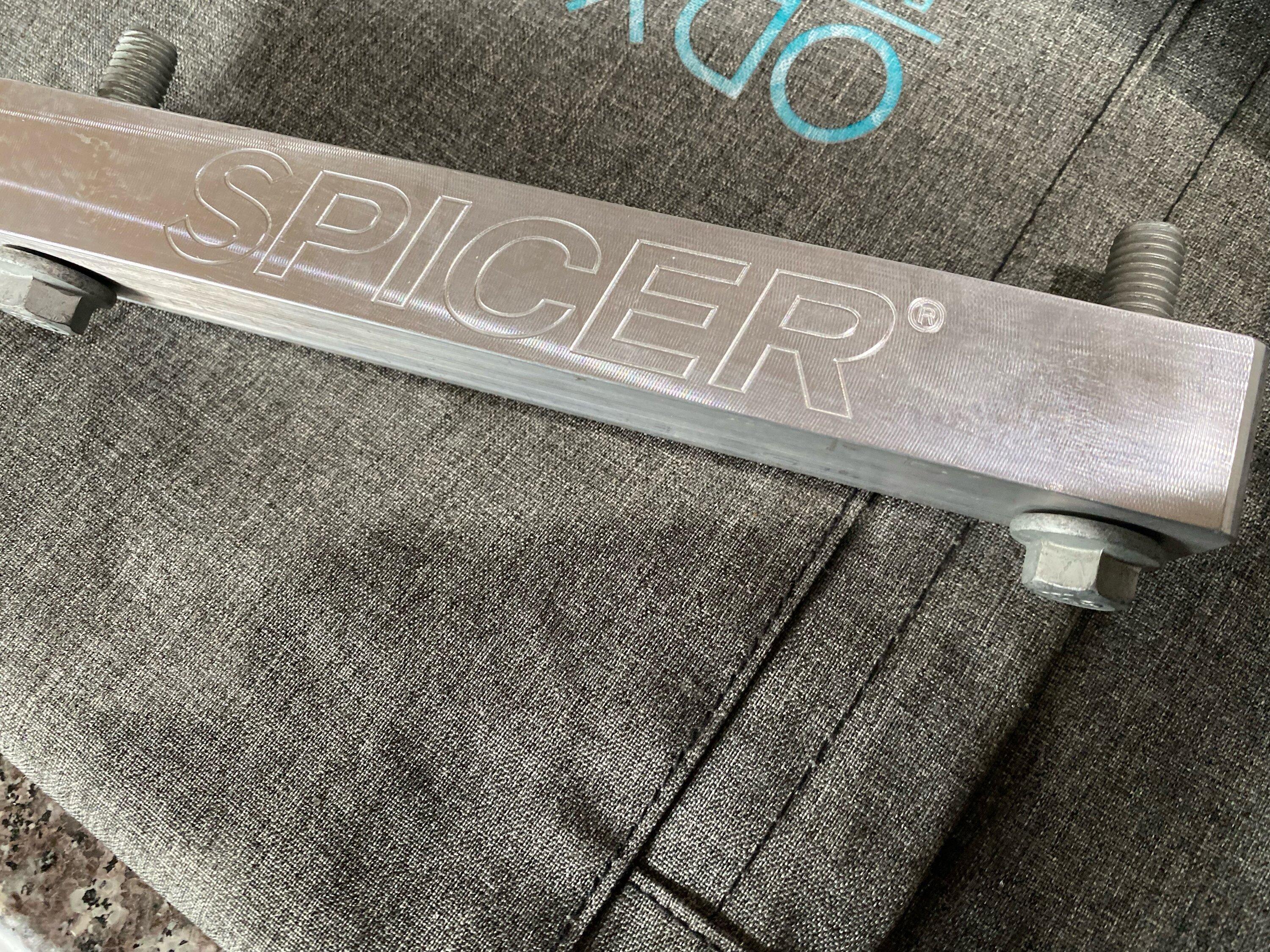

Dropping this in tomorrow when I finish my ball joints and Reid knuckles.

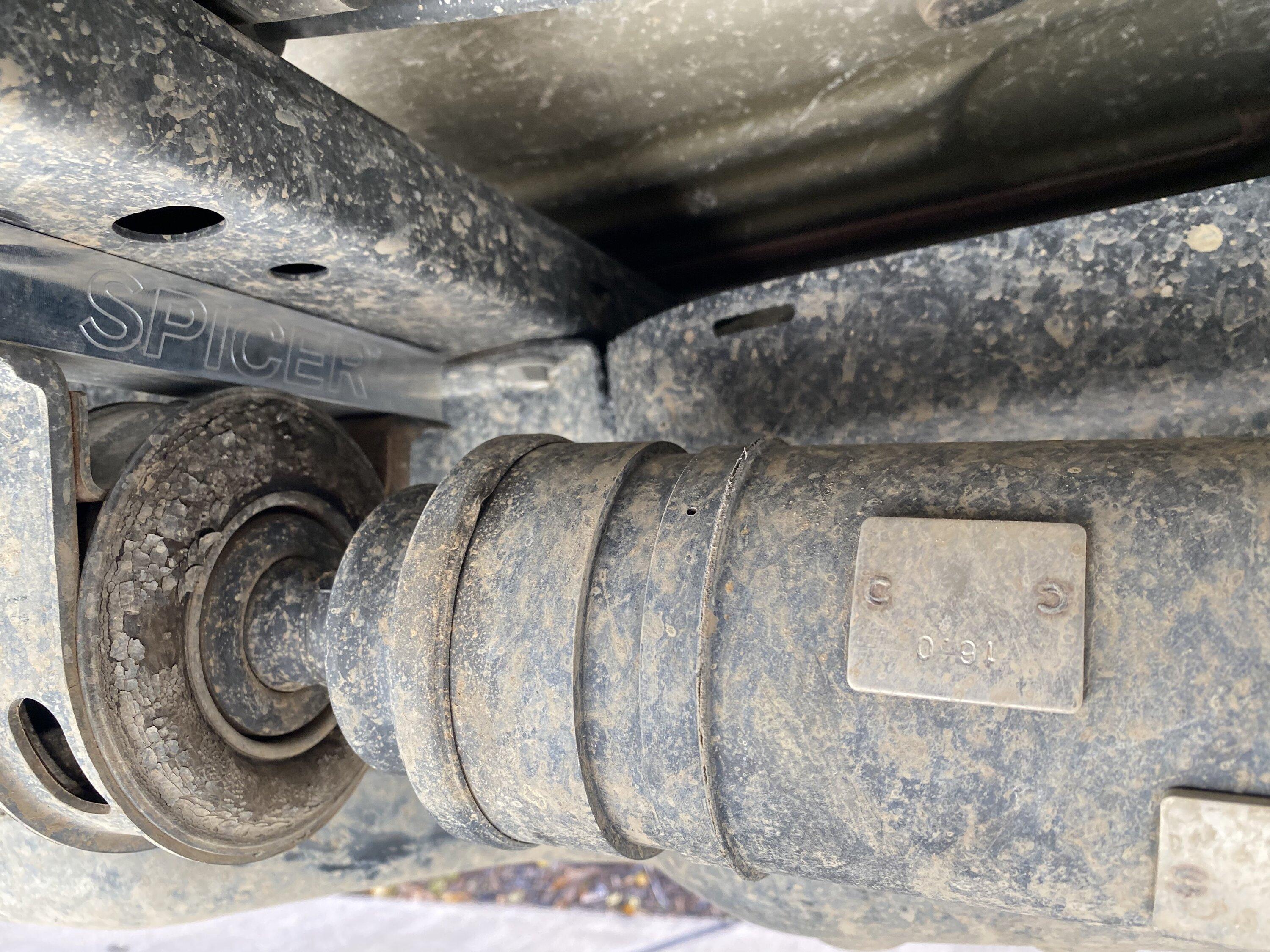

Part of my Sunday work.
