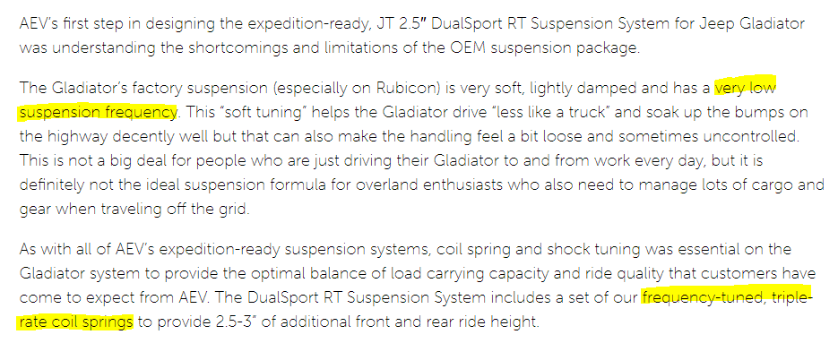

AEV always touts their "frequency tuned" springs for a front > rear balance but I've never personally ridden a JT with these to know if they control the "bounce/bucking" any better.

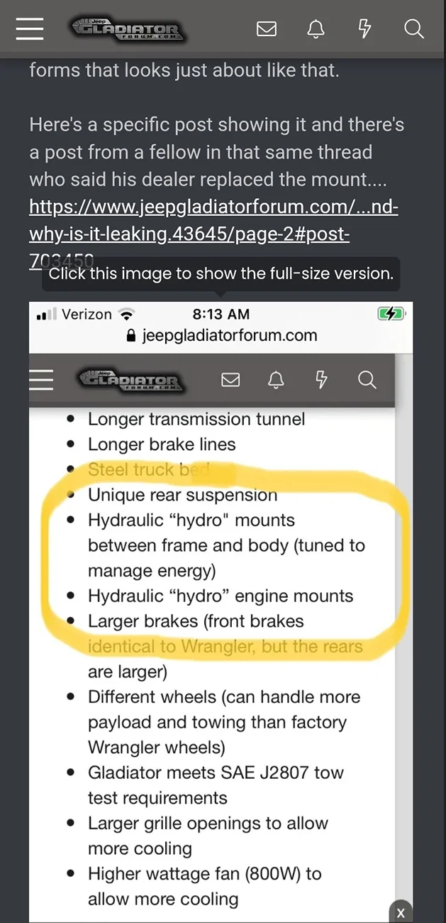

Has anyone considered or replaced the Engine and Bed body mounts? I read that they are Hydraulic and some wear out prematurely.
Jeep Gladiator Driveline issue...Jeep bouncing Screenshot_20260129_083916_Chrom
