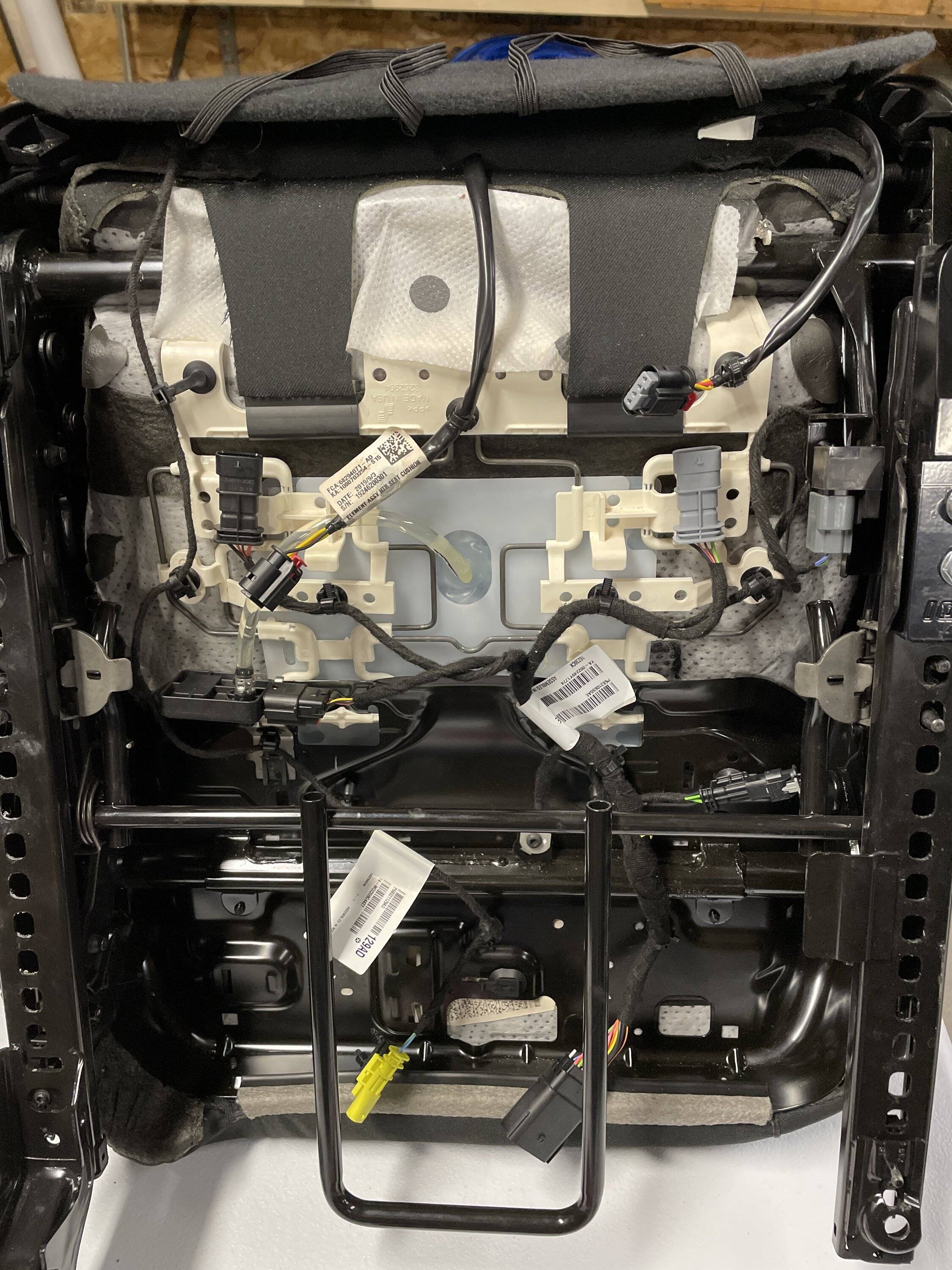

I have checked the fuses and pulled the seat and checked to connectors, no change.

I would start at removing the connector under the seat so the heating elements are not connected. Then try the switch and see if it stays on , If it does you know you have a problem with the seat element and if it still turns off look from the connector to the switch. To eliminate the switch you could swap with the passenger switch.

Connectors removed and no change.
I’m not sure which connector under here is the heat element, but the main plug disconnected makes no difference.

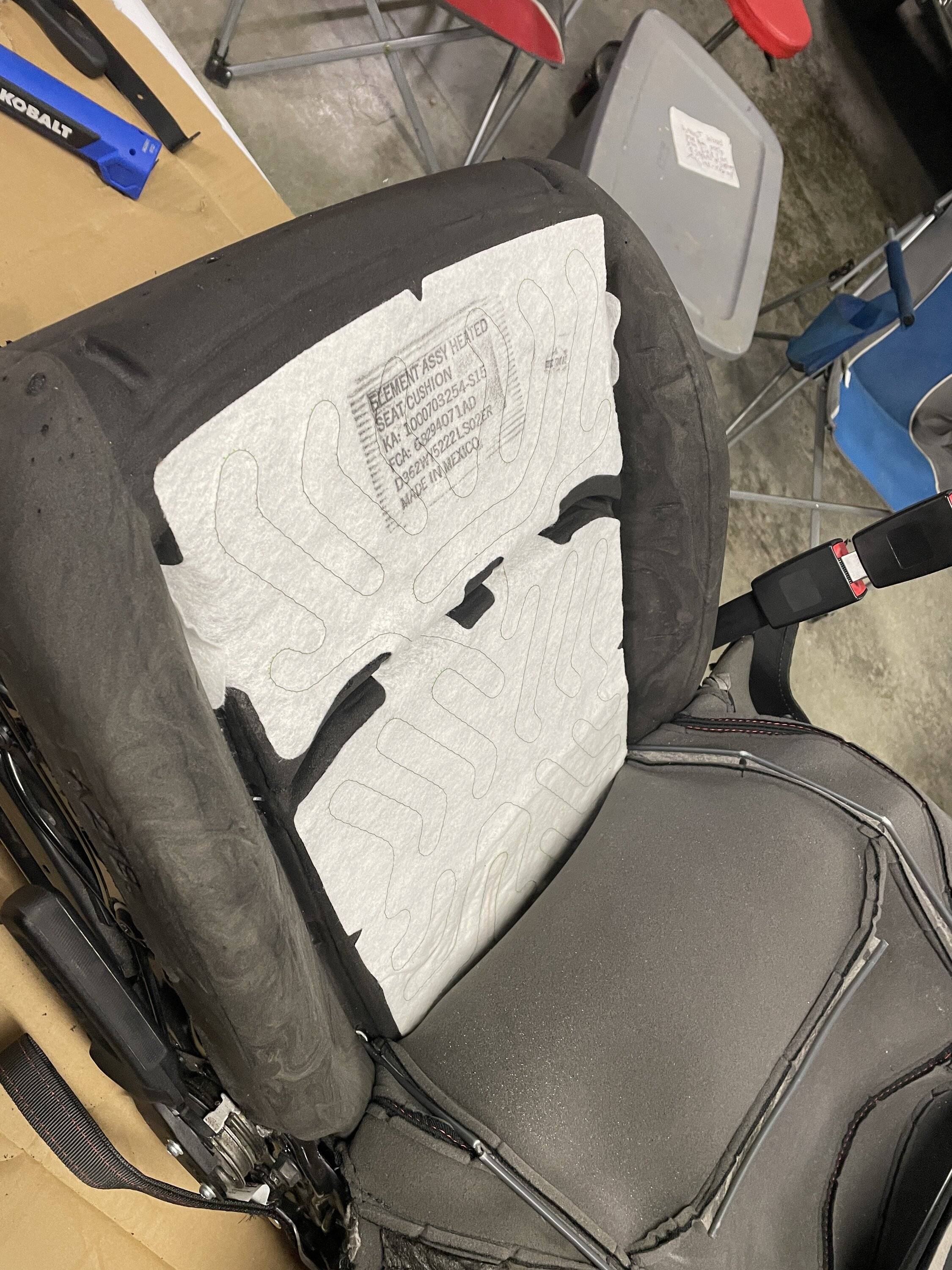

Pulled the seat. Have no resistance in the bottom heater and some resistance in the back heater. Leads me to believe the bottom one has a broken spot in the grid.

Replaced the bottom element.
Back in business.
