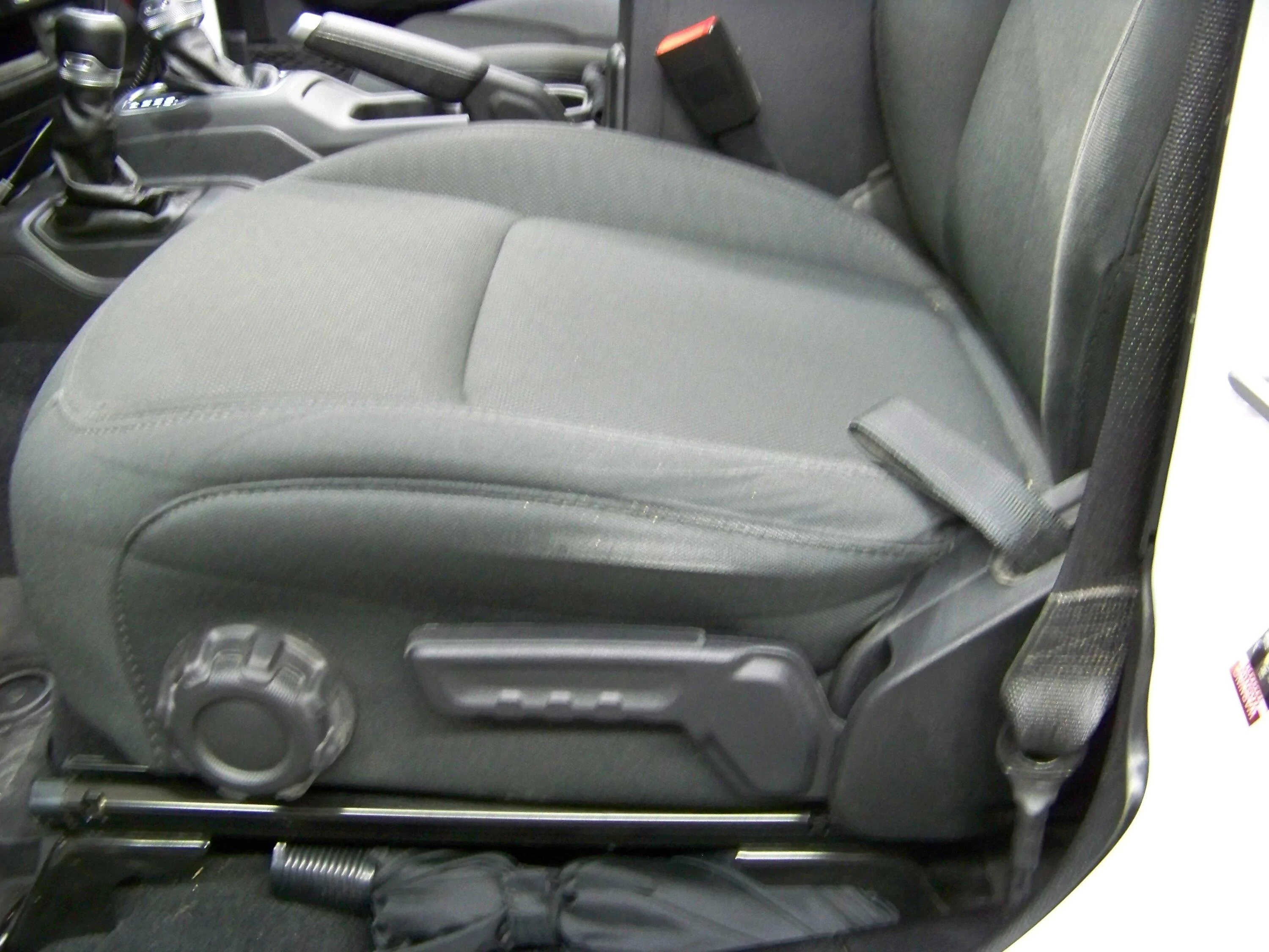

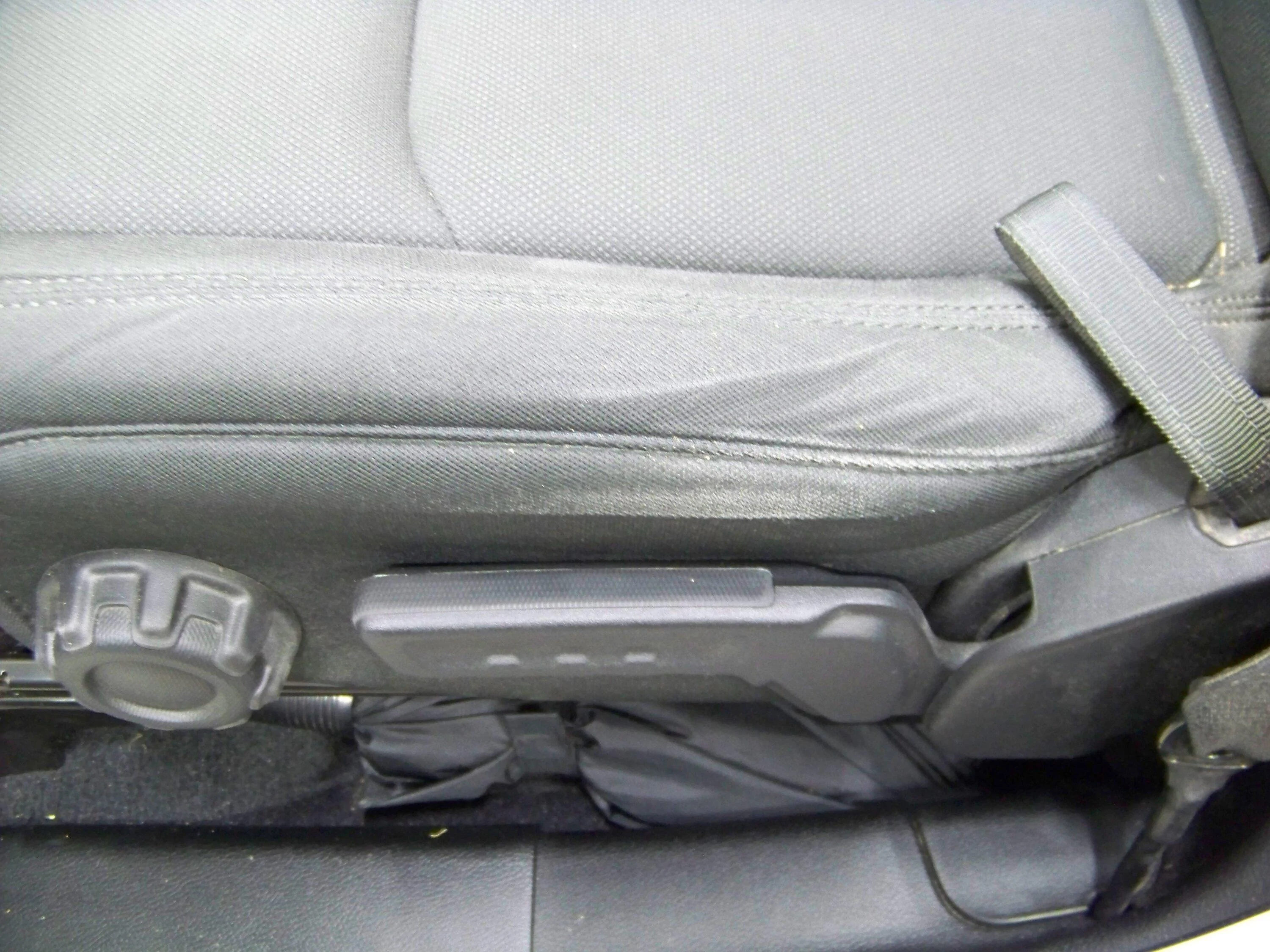

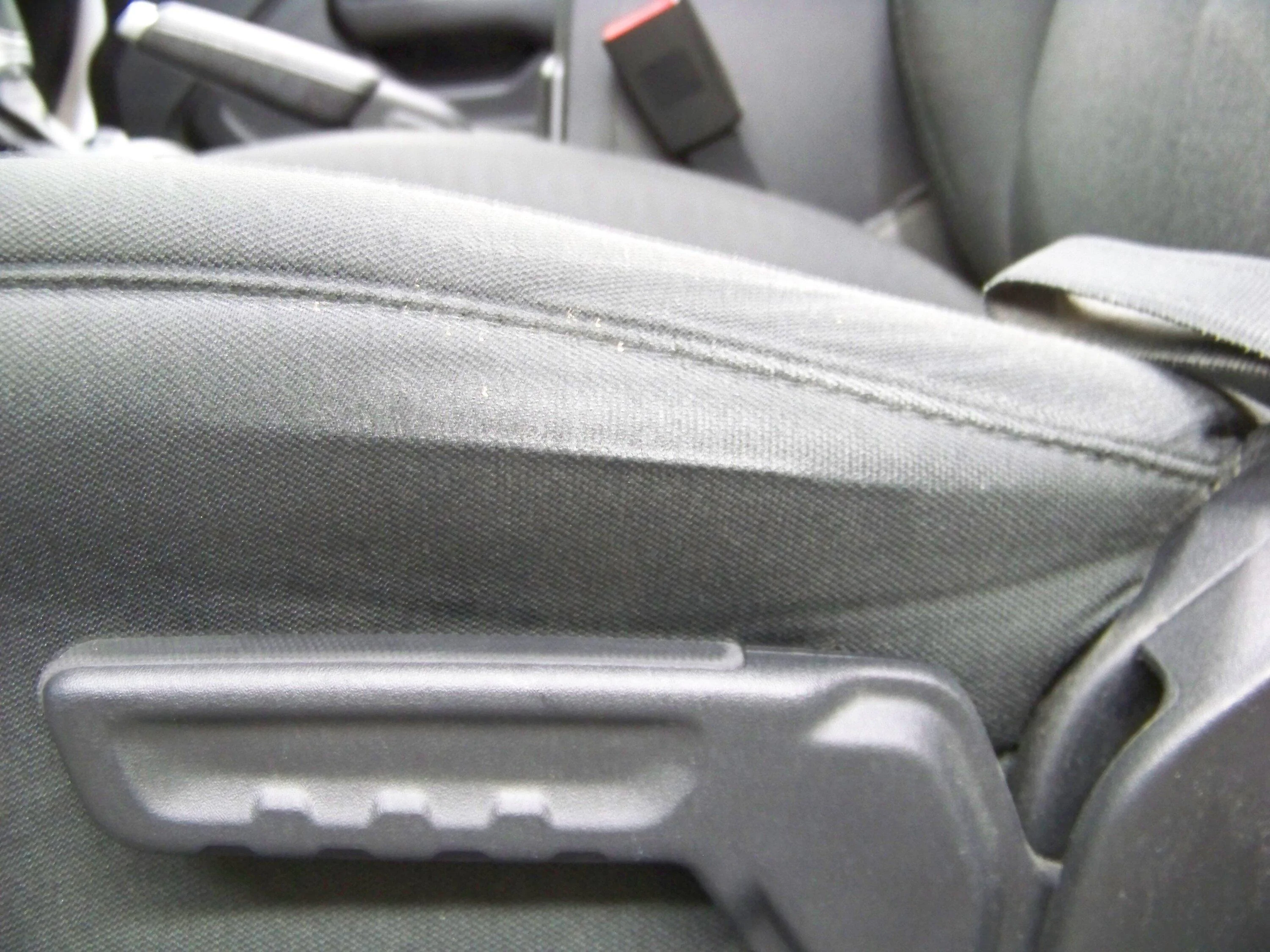

2020 Sport S with 26,000 miles cloth seats showing premature wear on the outside edge of drivers lower seat cushion. Anybody else having this same problem?
